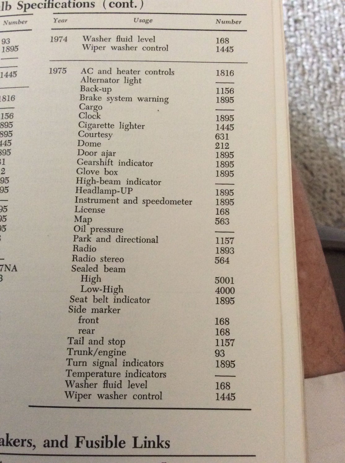

Does anyone have a list of the bulb numbers on a 76 vette? Thanks

My old Haynes book only goes up to 75 but it can’t be much different. Here you go.

Gott em, thanks
