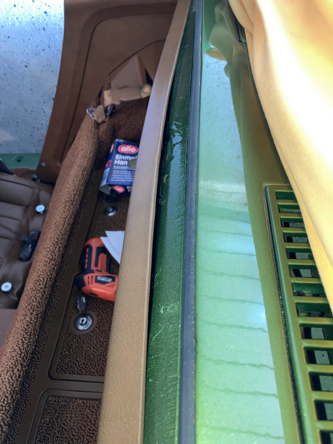

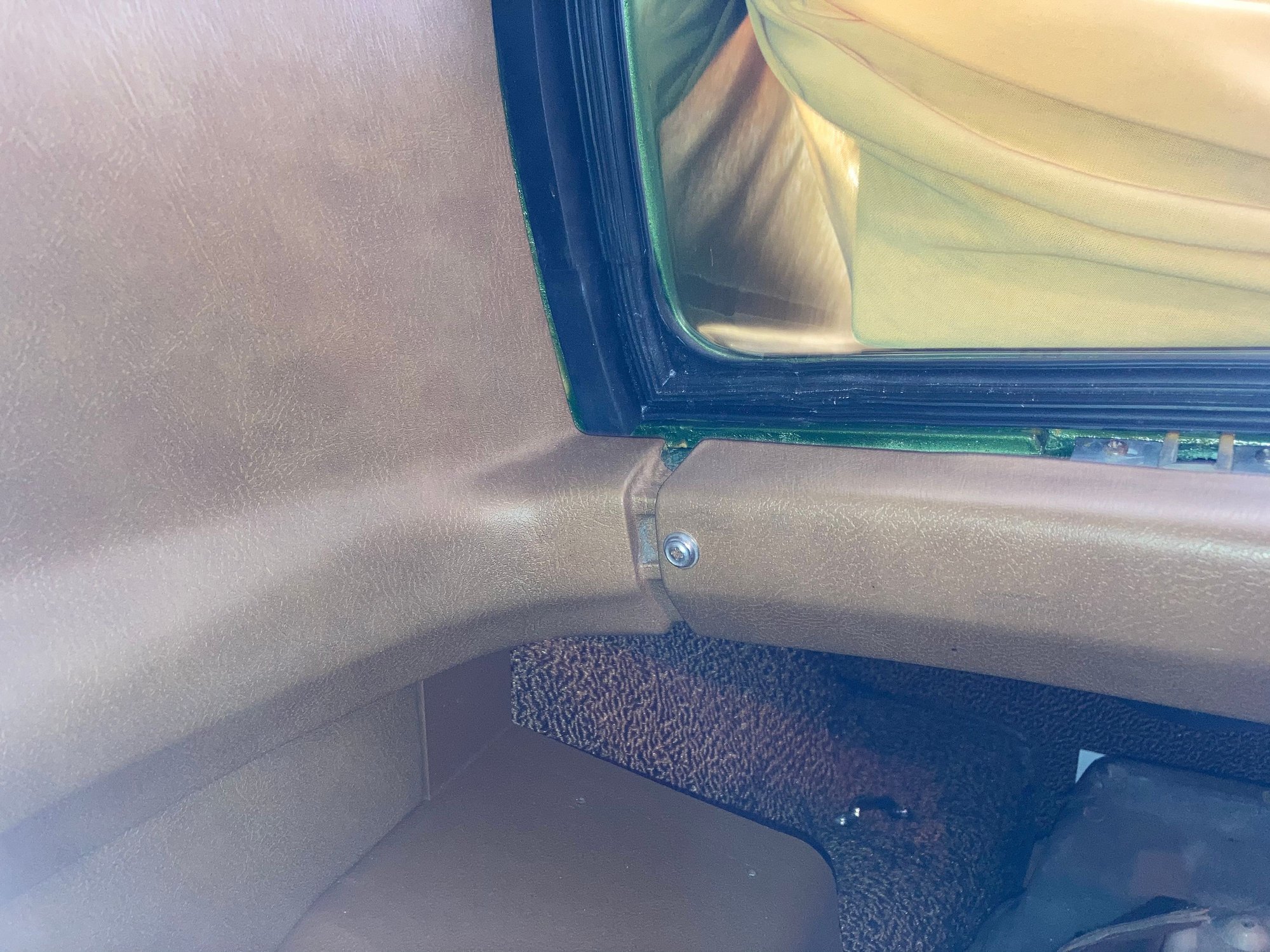

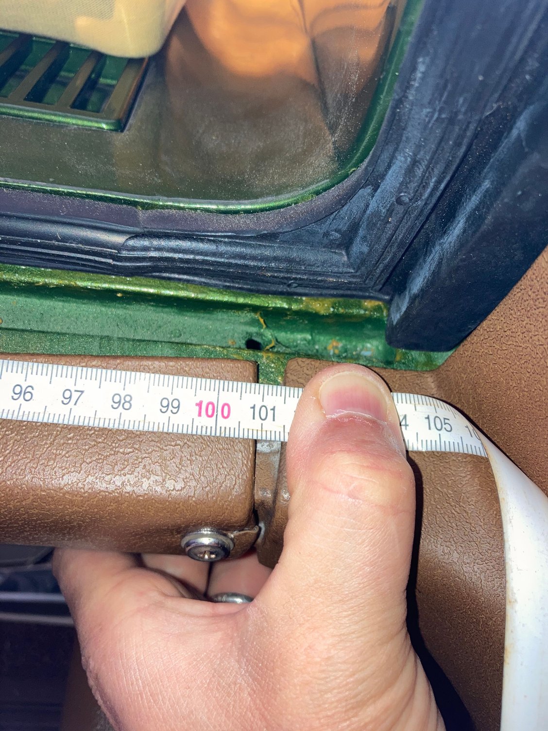

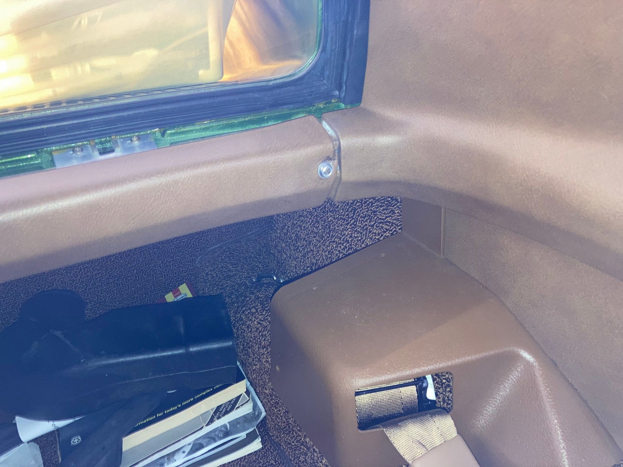

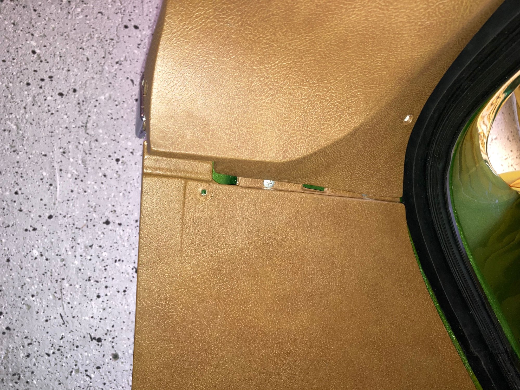

Yesterday, I‘ve reinstalled the moldings around the rear window. My problem is, the parts do not fit. There are but gaps between them, it seems they shrink.
The car itself was found by the preowner on a junkyard, where it baked in the sun for unknown couple of years...
Is there someone else here, who has this problems?
I‚ve uploaded some fotos, maybe it explains the issues.

Your rear window lower trim molding is similar to mine, same color, same problem, although mine is a bit better. My original molding was broken, so I bought another original from a forum member. It's a neat-perfect piece, yet it has the same problem.
Considering the age of these cars, some of which have been inoperative for extended periods, some issues are to be expected. I plan to remove my lower molding, set it on a flat surface, see if it will flatten out. If successful, then the ends could be elevated while placing a slight weight in the middle area, not too much, don't want to break it, (this process could take a month or more??) Hopefully, a slight curve can be achieved so it'll match the curvature of the car. I thought about using a heat gun, but decided against it.
Regarding the rear overhead-to-side panel gap, you might consider removing both the overhead panels, also side panels. They possibly could've shrunk? Doubtful. Those rear overhead panels are stout. While you're in there, check for missing u-nuts also replace any missing screws with correct fasteners, The original mounting holes will be a key factor in determining the solutions.

The piece under the rear window is a bit 'short' for almost every C3 coupe that I have seen. Yours looks to have an outward bend in it, or maybe the screw holes are off location a bit, putting it in a bind.
The top and side panels usually fit together well. I suspect that the side panels might be misaligned. If you have new T-top weatherstrips and they are a bit thick or have not been properly compressed, the tops might sit a bit high. But, to answer your question, "No" this is not considered a normal fit for these parts.
