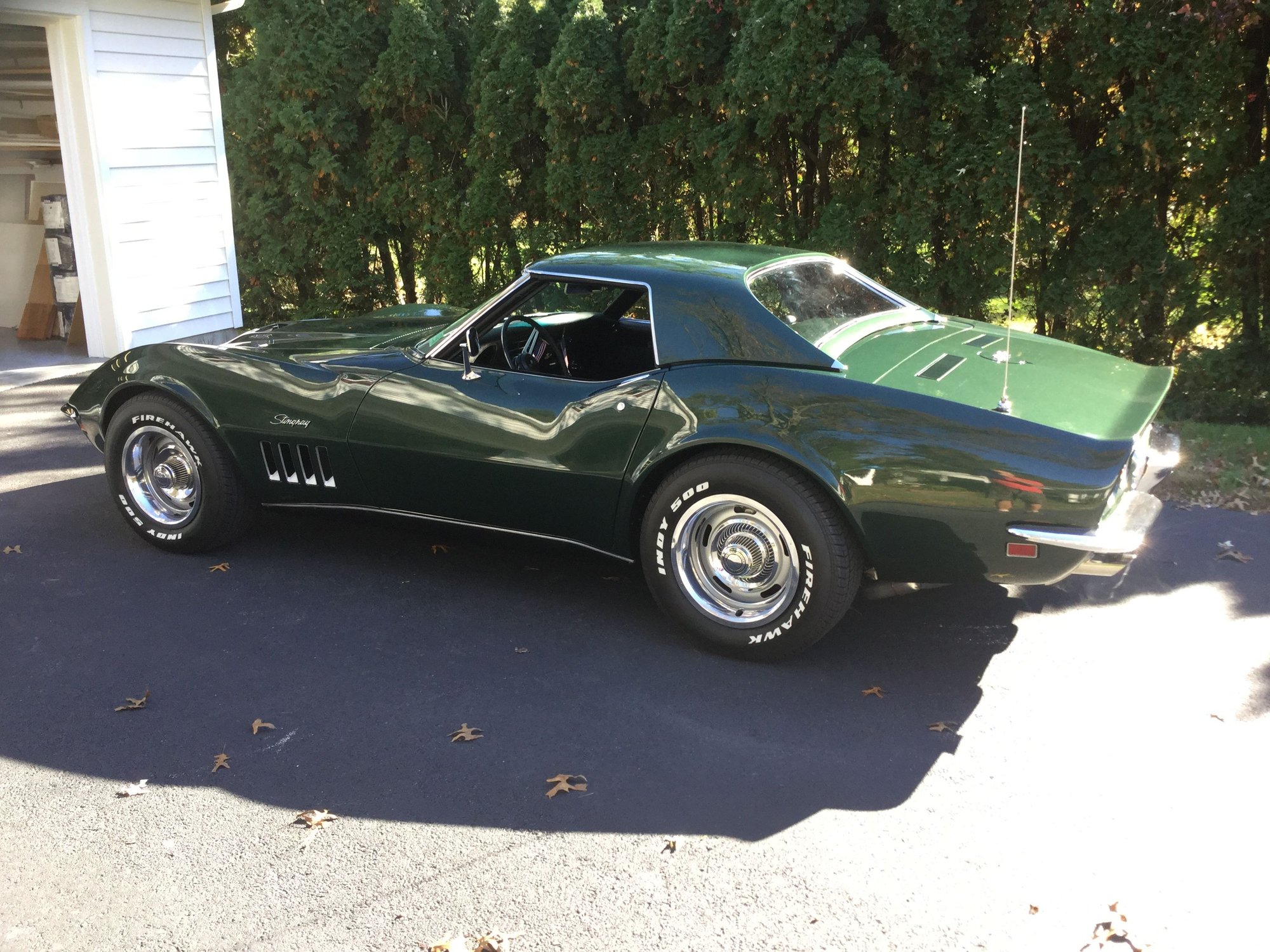

Quick question...With the center hole and the hole over the headrest, does that mean my car came with a hardtop?

Yes... my understanding is that other then 68, all hard top cars had the center hole.

It means your car was fitted for a hardtop at some point.

The chrome receivers behind the headrests were used for both hard and soft tops. The factory only drilled a center hole and put a stainless bezel around it when the car was ordered with a hardtop.
