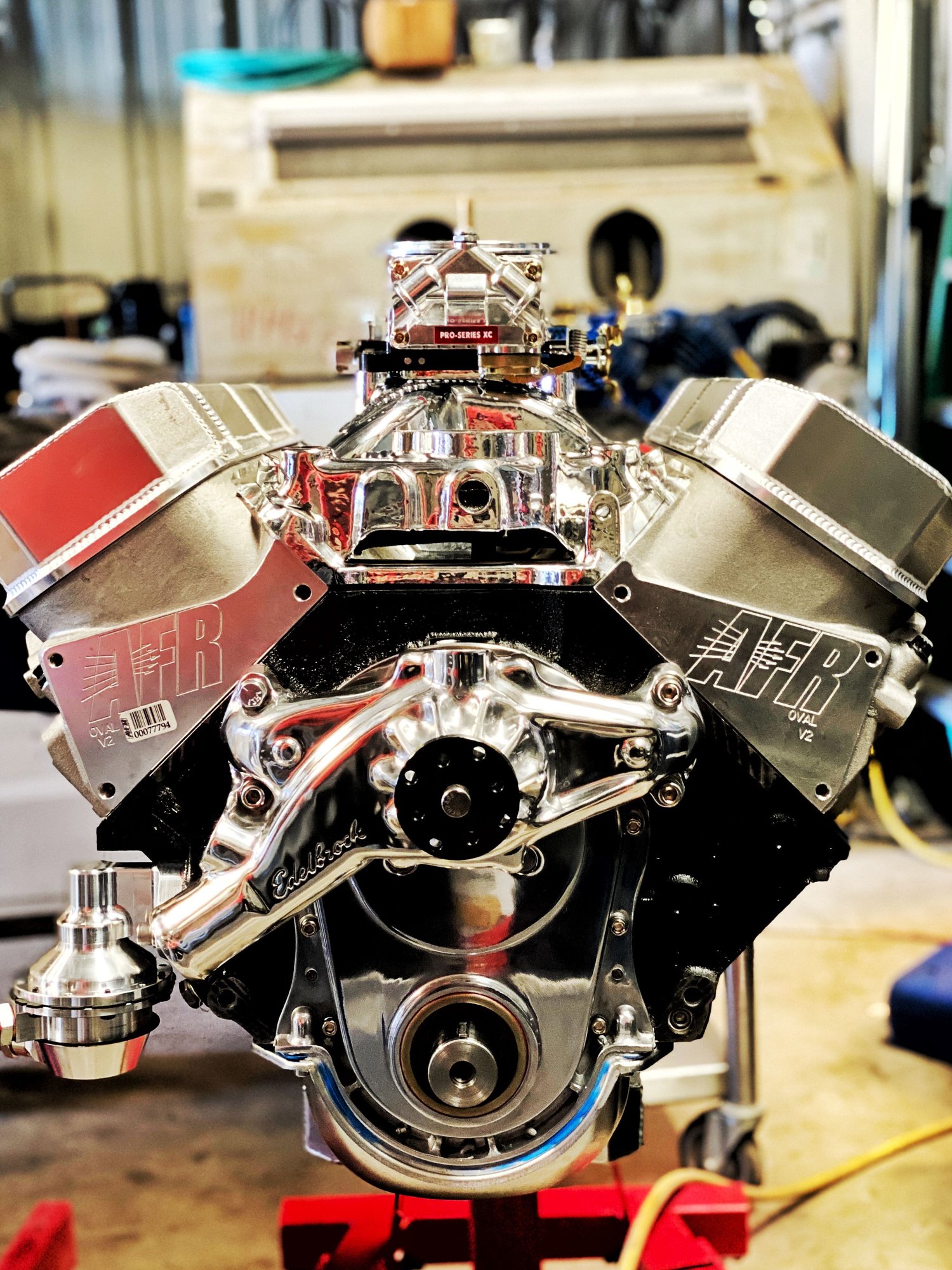

2 years in the making but finally getting somewhere, it’s taken a lot of money and waiting but man has it been a fun time! What do you guys think?

Looks great! What's the specs? Cam? Compression?

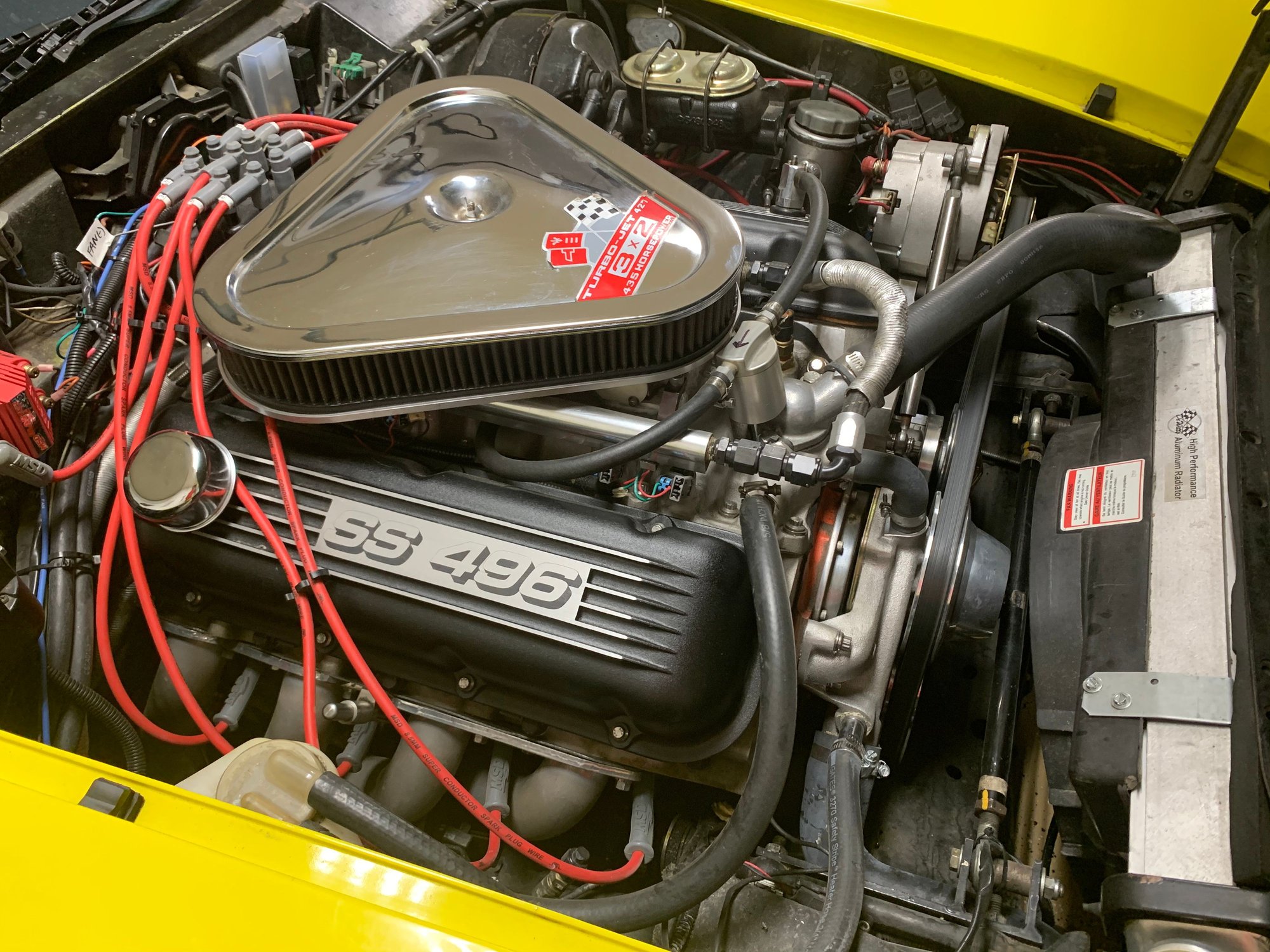

I have my new 496 sitting on a cradle ready and waiting as well.

That’s awesome, yours a crate or did you build it? Compression is 11:1, cam is 258-263 @.050 with 640 lift on a 109 lsa. Nothing too crazy, wanted a little vacuum and drive ability as this won’t be seeing much if any strip time.

I built mine for mostly street use as well.
should be fun.

Everyone told me to go bigger on the cam but I’m solid roller so that helps and Chris straub works miracles. I figure I’m at the boundary of pump gas

I hope it doesnt come apart lol, Lewis balanced the rotating assy and set the heads up for the cam and straub did the cam but I put it together so 🤞.
specs are:
arp main studs
scat forged stroker crank
scat forged h beam rods w/arp2000 bolts
wiseco forged 21cc dome pistons
straub solid roller 258-263@.050 .640 lift on 109lsa
rollmaster timing kit with IWIS chain
AFR 290 full Cnc heads
edelbrock rpm Airgap manifold
pro systems venom vx billet main body carb
moroso billet high volume/pressure oil pump (using the brown spring so it really just has normal pressure)
holley billet hp mechanical fuel pump
msd billet distributor with tach drive
dougs 2-1/8” stainless polished long tube headers wit 4” sidepipes

Wow our engine builds are pretty close.
I’m at 10.4 cr, with a crane roller 234/248 @50, 610 lift and 112 lsa.
My cam comes in at 2,000 rpm and pulls through 6000 rpm.
I’m not sure if I’ll put mine on a dyno, because I’m not a numbers guy, but it should make great power mid range where I wanted it.
I wanted to go with a slightly bigger cam and a little more cr, but my builder suggested this combo for my driving and street use with pump gas.
I also went with a SST 5 speed with .82 5th gear and 3.08’s so I can cruise nice and easy down the highway.

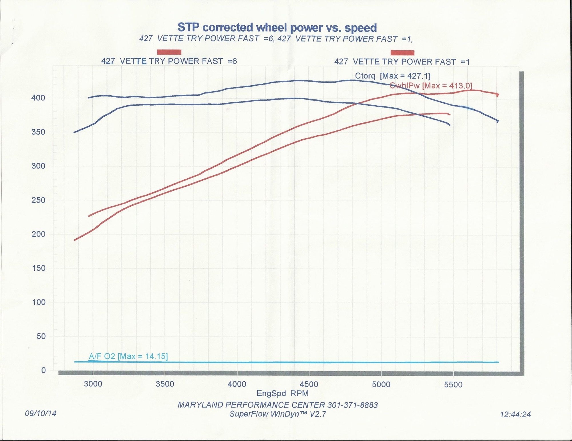

496's are fun. Mine is right at 10:1 compressions with Dr. J Airwolf (ported Edelbrock RPM) cylinder heads. Hydraulic roller at 240/245@.050 with ~.625 lift. Custom 3x2 EFI. Idles at 850 rpm. Pulls hard to 6200 (that is where the EFI starts dropping ignition pulses, cuts fuel at 6300).
Here is my rear wheel dyno chart. T-56 Magnum and Tom's 3.73 12-bolt rear. Upper lines are after the tune. Tuner said my sidepipes with STS baffles (centers capped) where restricting me above 5500 rpm. Could probably get another 50 hp up top but it would be much louder. Wife likes it as is.

Impressive numbers.

Impressive numbers.
Thanks. With the EFI, it will cruise comfortably down to ~1800 rpm on the highway. Very comfortable at 2200rpm and up. I ran both a stock Tripower setup and Mopar mechanical secondary Six-Pack carbs before going EFI. The carbs may have had more raw power (at least felt that way when the secondaries kicked in) but the drivability is so much better with the EFI.
