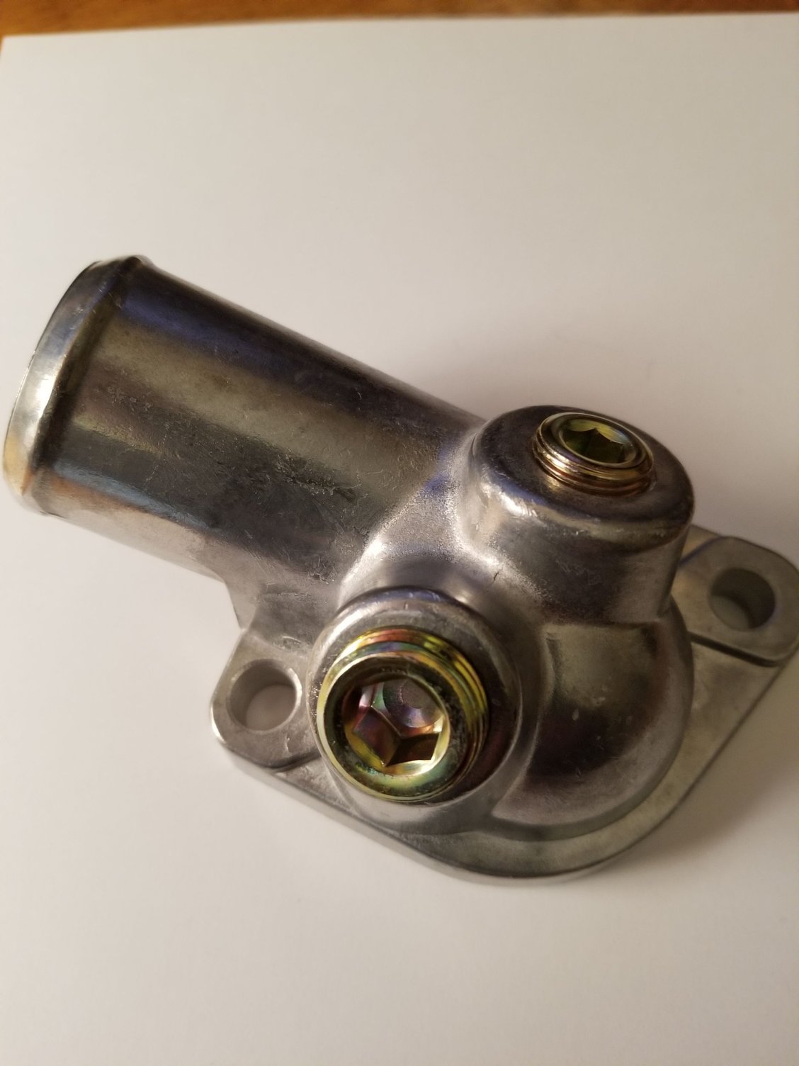

So, I've been thinking about moving my temperature gauge sending unit to the thermostat housing for a more accurate read vs the stock way in drivers head. I think it has too much of a swing in temp especially after WOT. So moving it over to the housing seems like a better way of doing it and I will find out. So since I didn't want any chrome housing I saw this one from Dorman and I can polish it up since it's aluminum. I turned it over and saw how it was machined and thought that this was yet another machined piece of crap by EMS. WOW! not even a round hole, but egg shaped. The pic doesn't show it good enough, but it is noticeably egg shaped. I guess I'll touch it up, but this kind of crap machining even on the simple stuff is unacceptable. It was made in China?
For all the people that have sent me PM suggestions on where to have my manifold pours done and machined, this is a perfect example why I refuse to have it done in China or any other place outside of the USA. I would have ZERO control on the machining again and nothing but issues that I don't want to deal with. It's hard enough being here and having to deal with poor quality machining. Ugh!

you realize GM made hundreds of thousands of t-stat housing with a sensor hole in them for OEM uses.

Yes I remember throwing one of them away. Pretty ugly.
What does GM making tons of these have to do with anything, but I thought for $11...what the heck. Just didn't think the quality would suck like that, but I can fix it. - FIXED already!

Personally, I think you would get more temperature swings there due to the open/closing of the thermostat. Mine is in the stock location for the gauge, plus I have a sensor in the intake manifold crossover for the EFI. They match up pretty closely on readings.

I' m with Steve. Seems like the "simulated" temps would be iffy at best at the water-neck. That housing should be the hottest reading of the entire cooling system because that coolant is on its way to the Rad.
I would think the most consistent and accurate temp readings would be in the head. Those GM engineers were not stupid.
As far as the egg-shape in the housing? Doesn't matter. Could be square, as long as it works. The thermostat doesn't care about the shape.
It is an experiment on this project to see if it is any better, maybe not. I use my IR gun and check temps at the housing and compare that to my laptop temps and the gauge. The gauge is off high, so I got the variable resistor to tweak in the gauge more inline with what the housing temps are.

The one that came on my car actually had a crack like hole in it so I ordered the one you have or one very similar.. The only issue was getting those plugs to seal. you could screw them all the way in and they never got near tight, Combination of RTV and Teflon tape finally did it...
60
I would highly suggest in the future that you use Permatex 56521 High Performance Thread Sealant, it works wonders. No tape required.
I was also just looking at this housing after polishing it up and looking good that I will have problems with the temp sensor sticking up maybe a little high and will have to remake my hard fuel lines. Not sure if I want to do that right now, so I may wait a little on this swap and go with the adjustable resistor on the water temp gauge first and see if that works. If so, great. If not, I will start bending tube again.l. It works like a champ every time.
