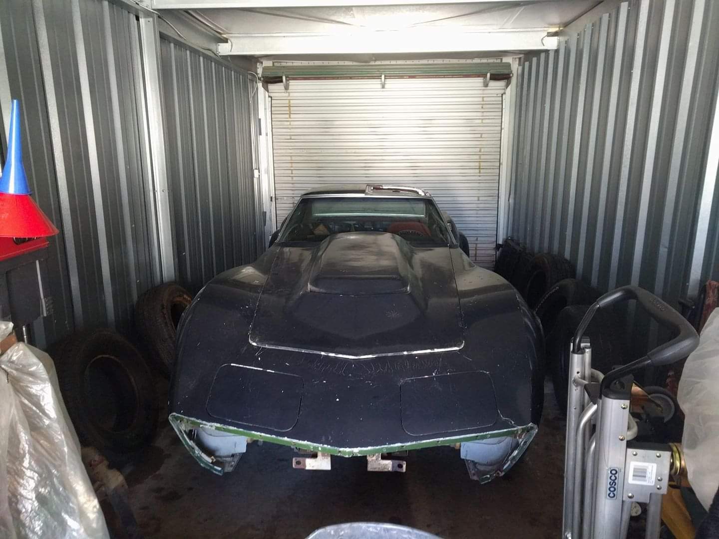

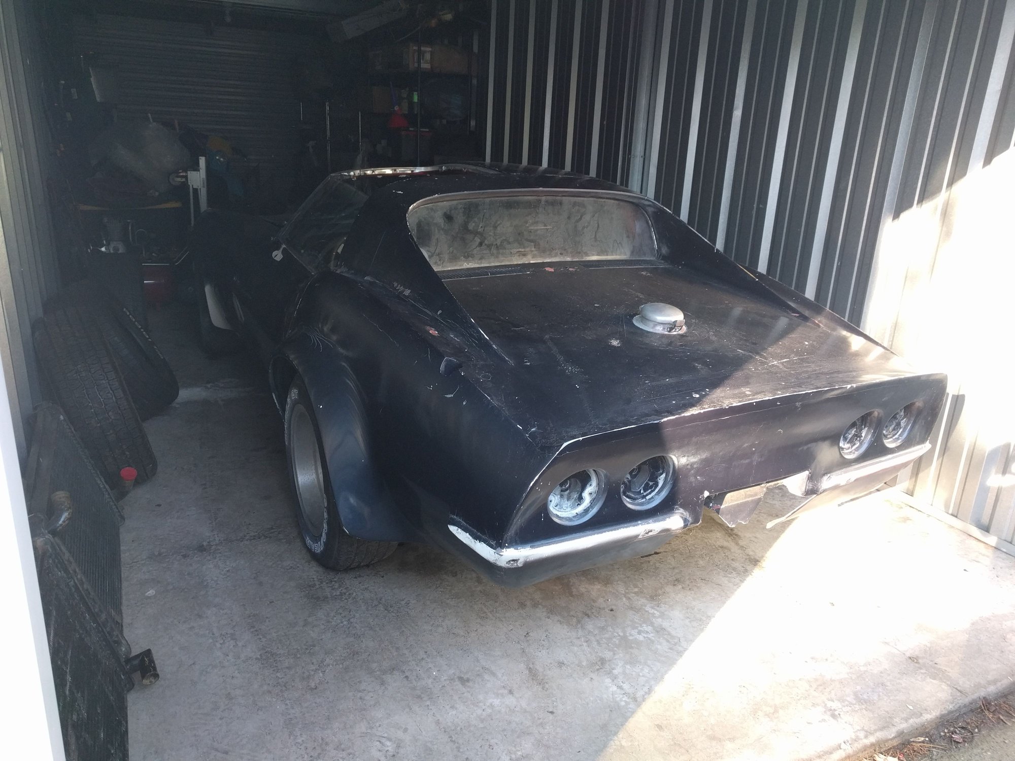

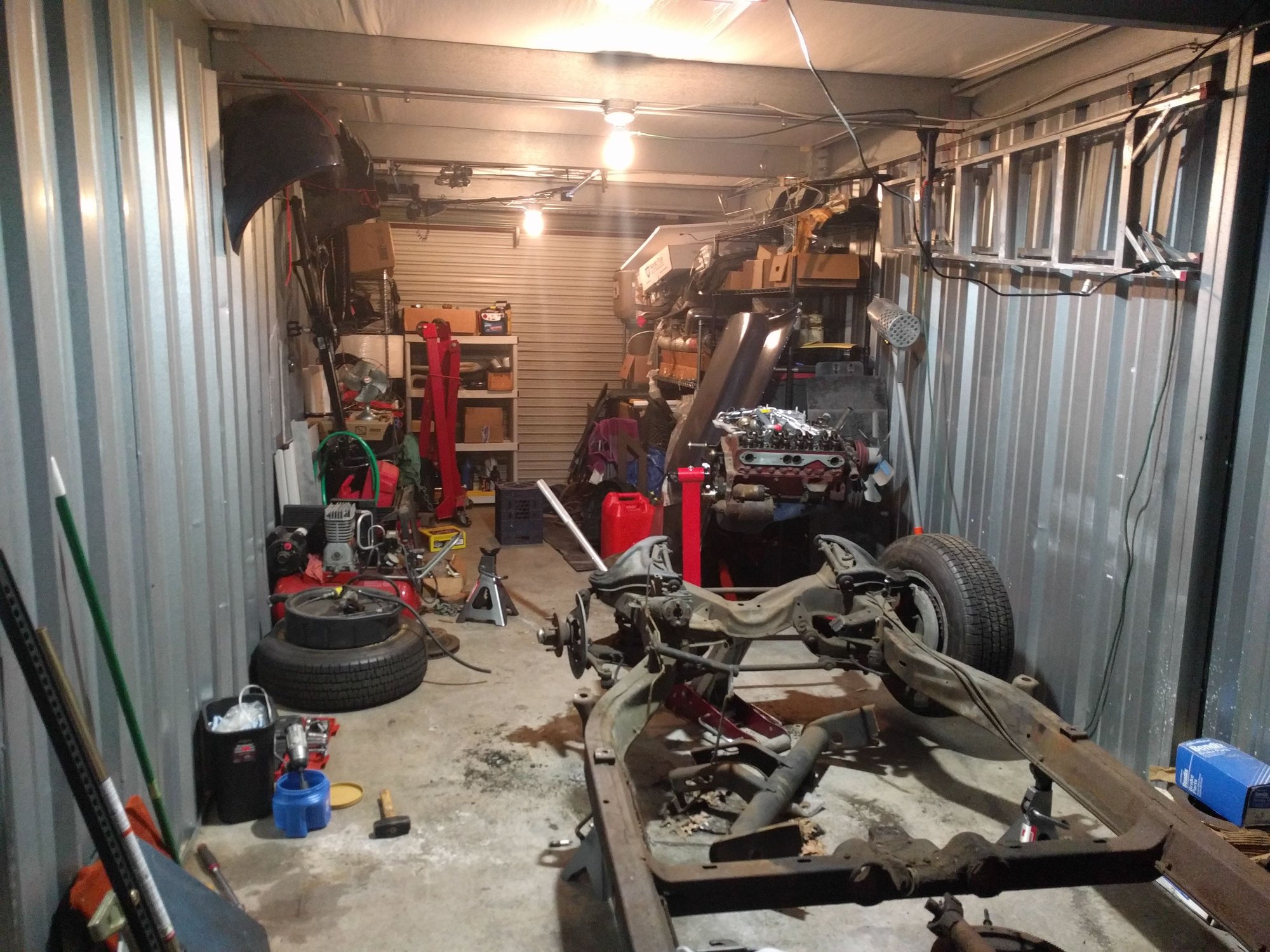

Going to try and start a build thread. Car is a 1969 with a 73' front clip. 4 speed manual. Picked up in 2017
First time seeing it. It was stored just like this for 10+ years. I knew very little about Corvettes but fell in love at first sight.
Old Sep 8, 2020 | 06:45 PM
LINY Kevin's Avatar
LINY Kevin
Joined: Feb 2017
Posts: 75
Likes: 16
From: Holtsville NY

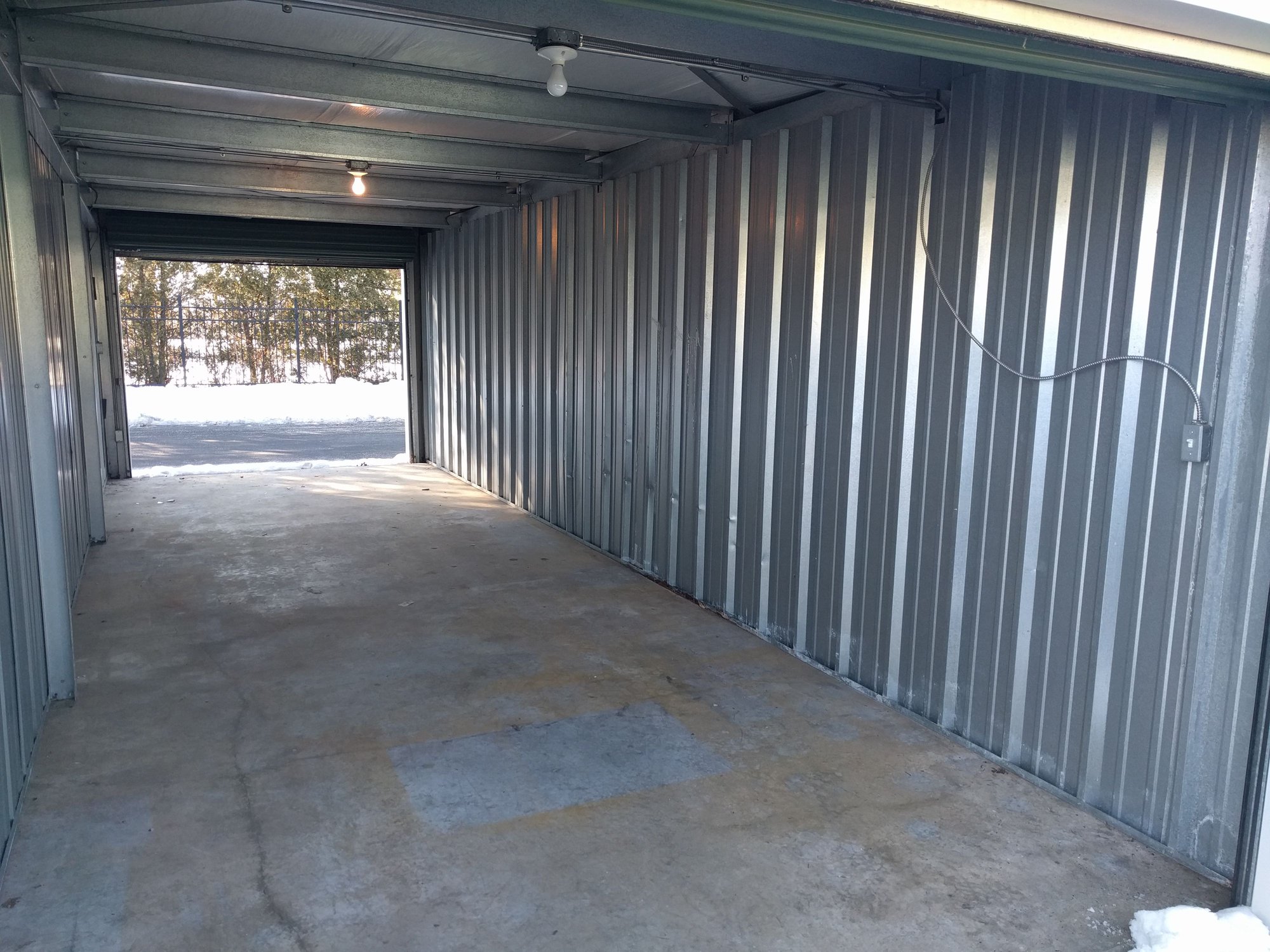

Just getting it to it's new home. 10'x30' storage unit. Need to do some organizing with the boxes of parts and brining my small storage unit shop into the new unit.

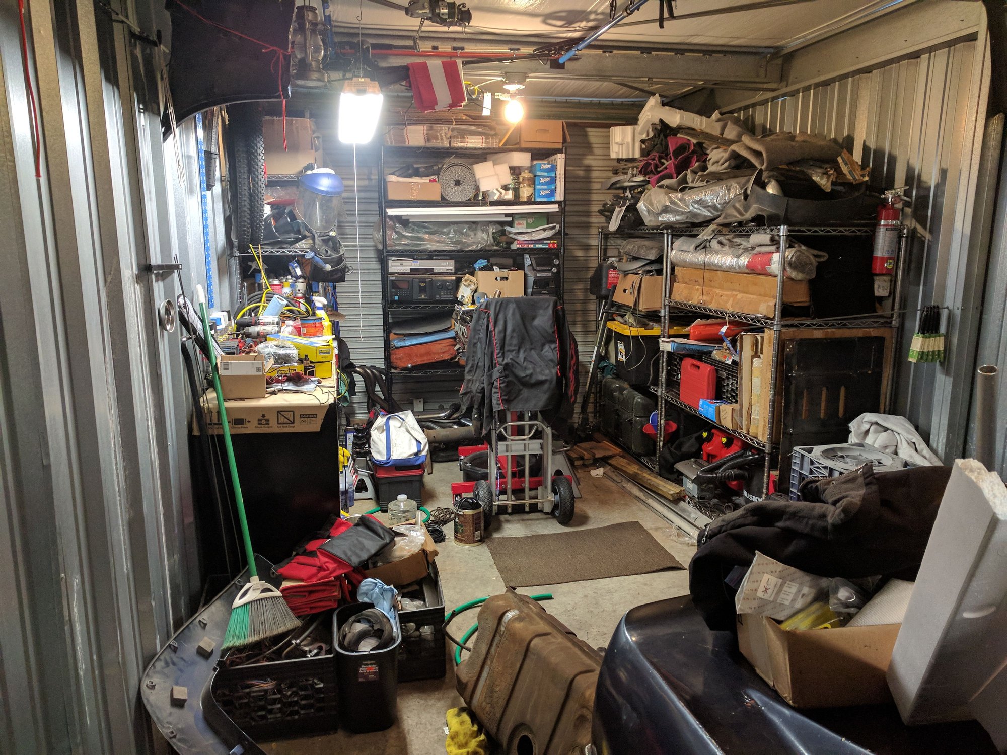

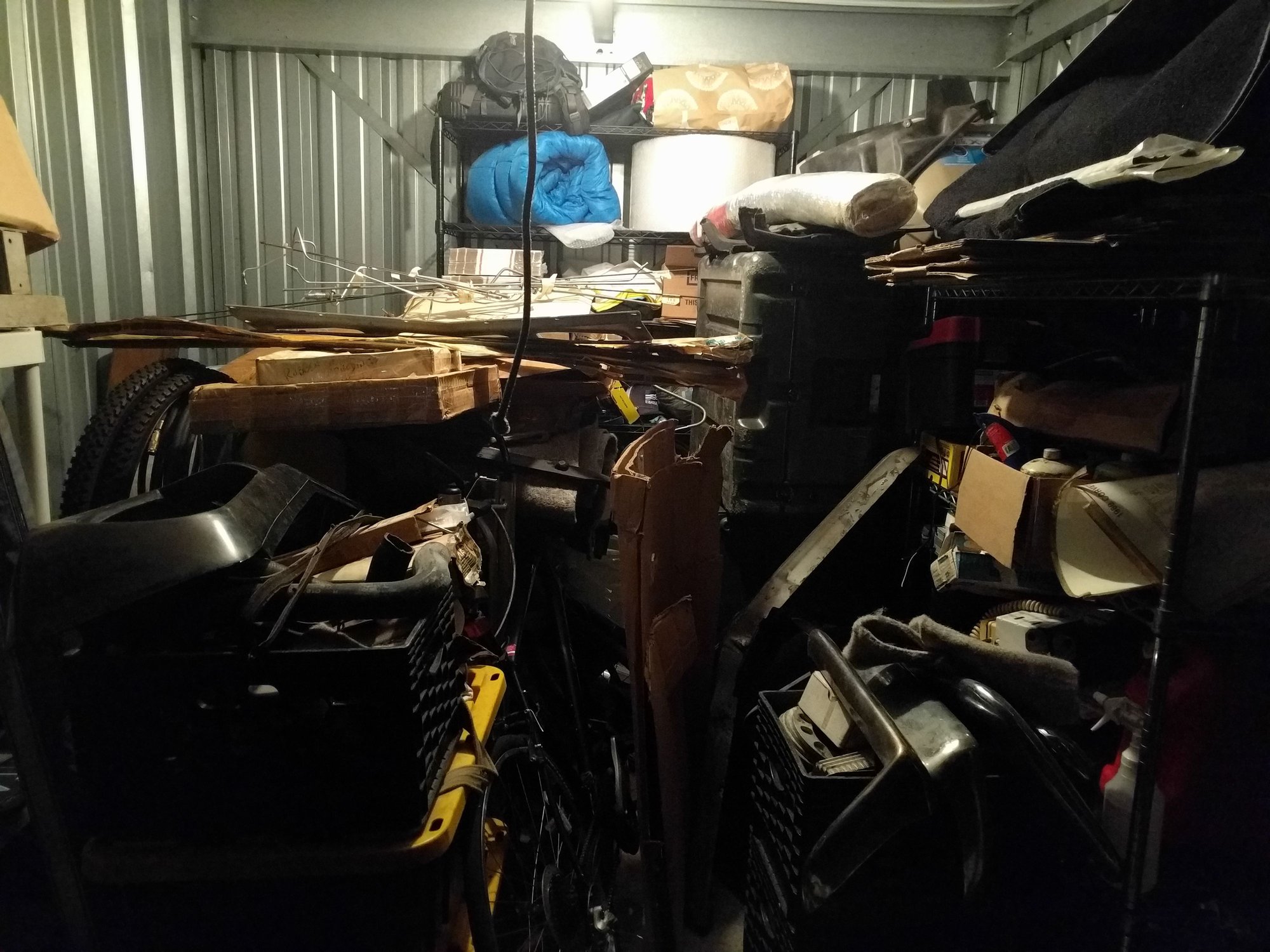

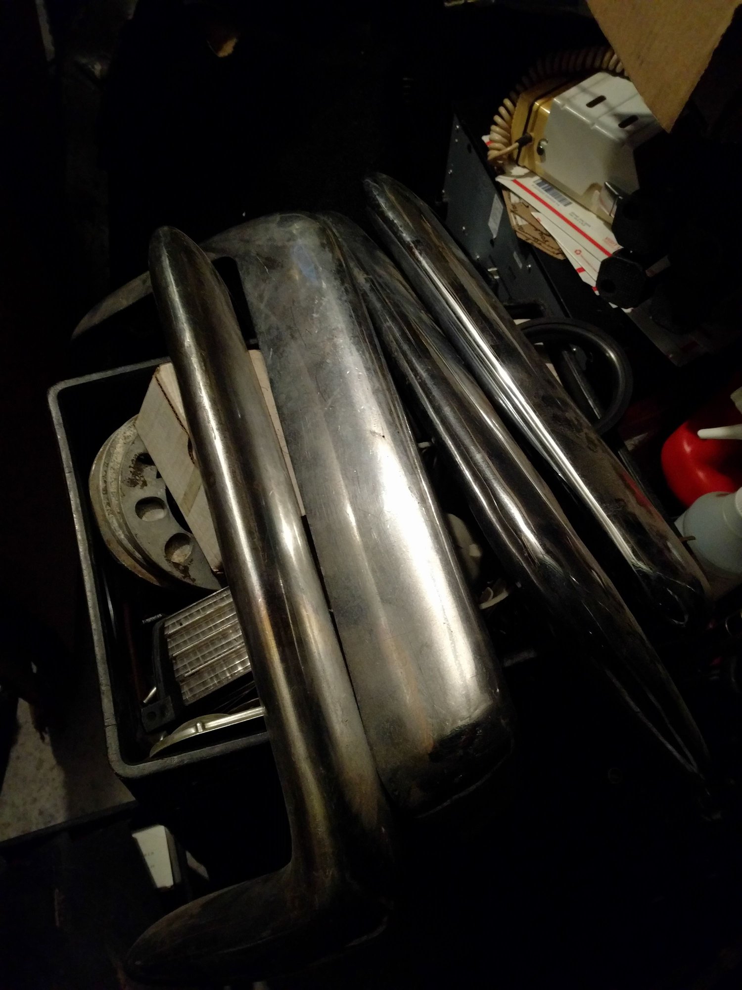

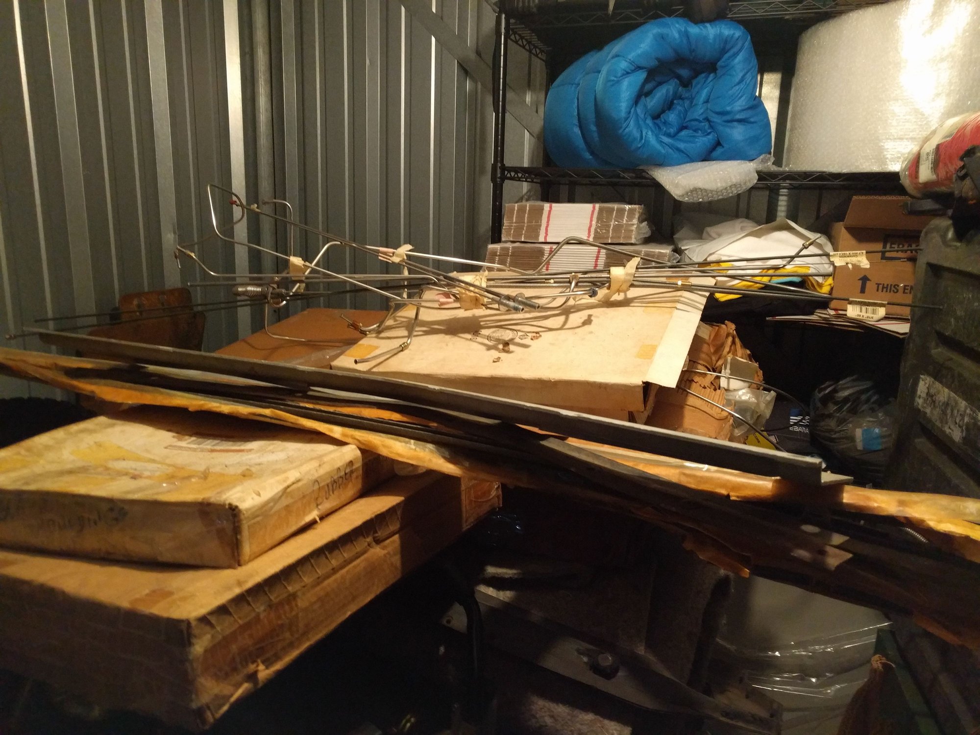

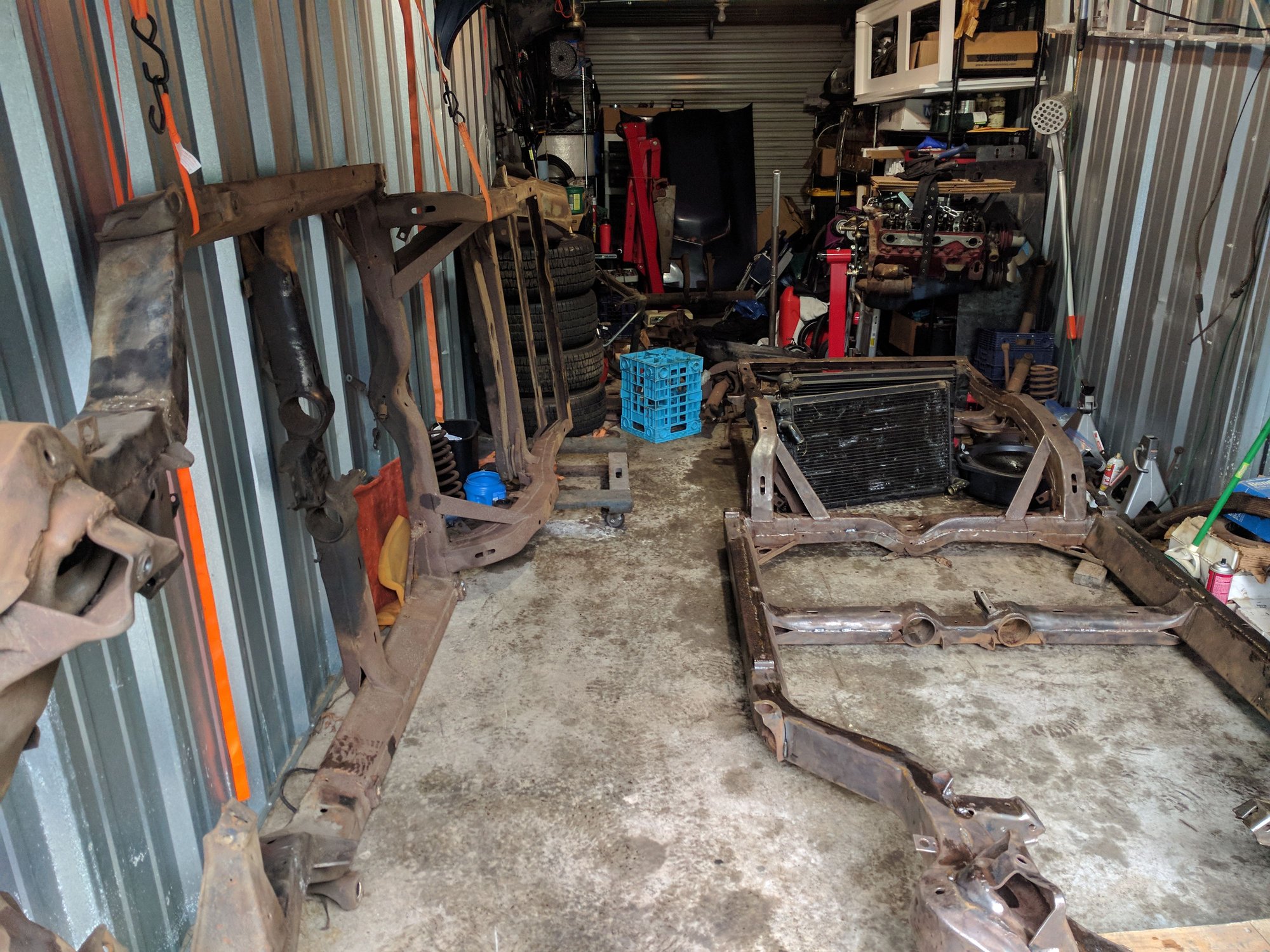

The overwhelming amount of parts I've slowly been picking through.

New 10'x30' home. Filled up fast.

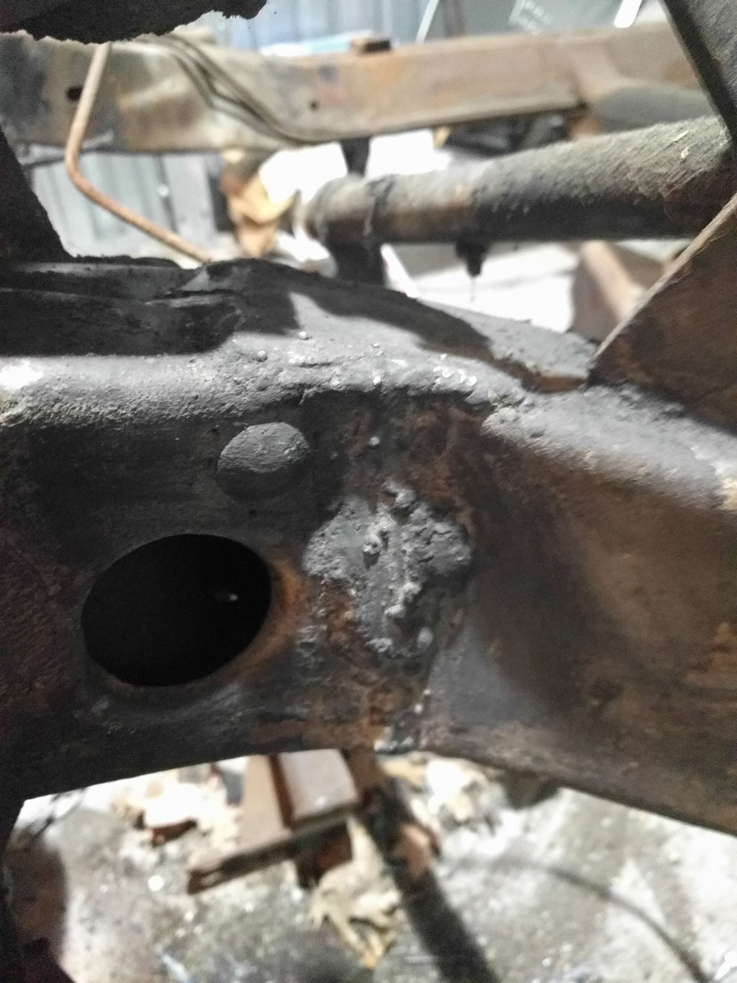

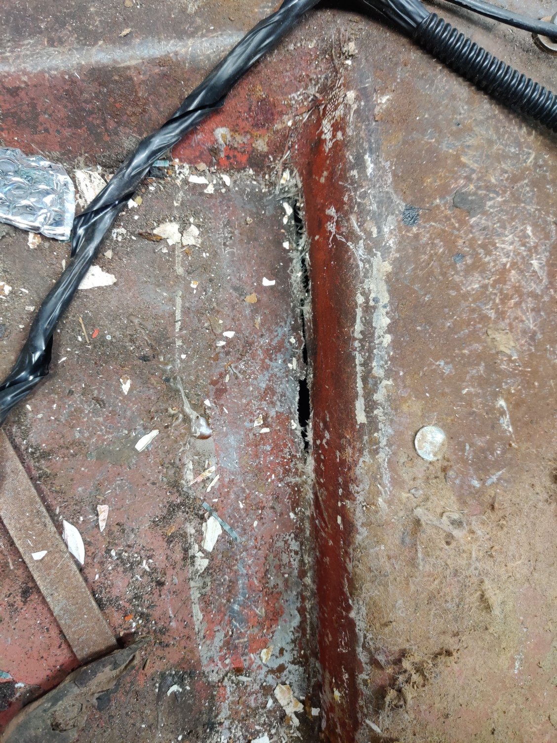

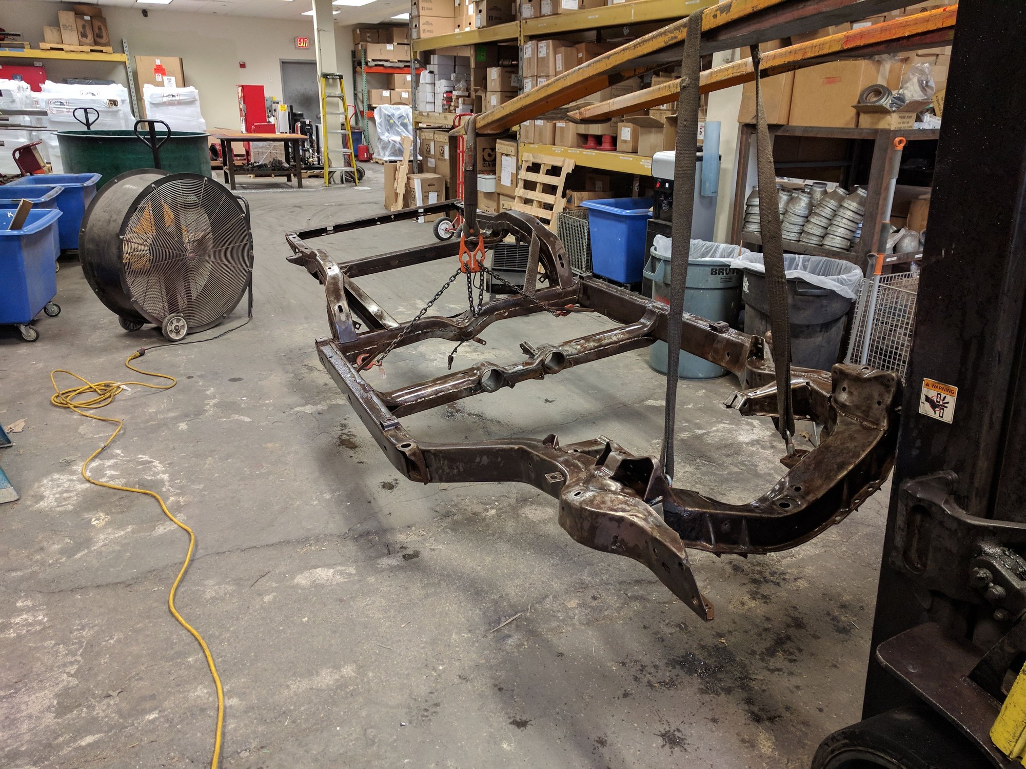

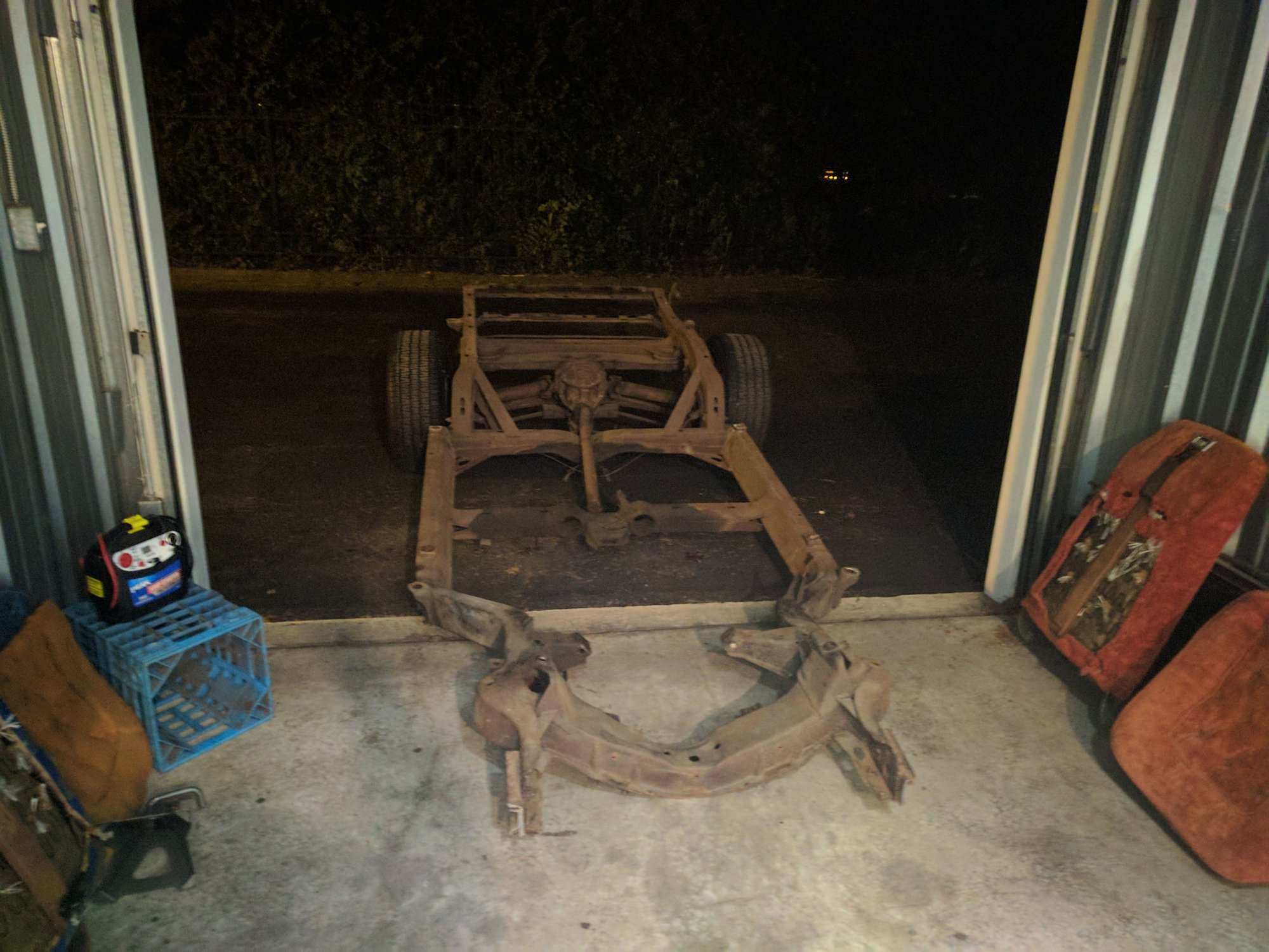

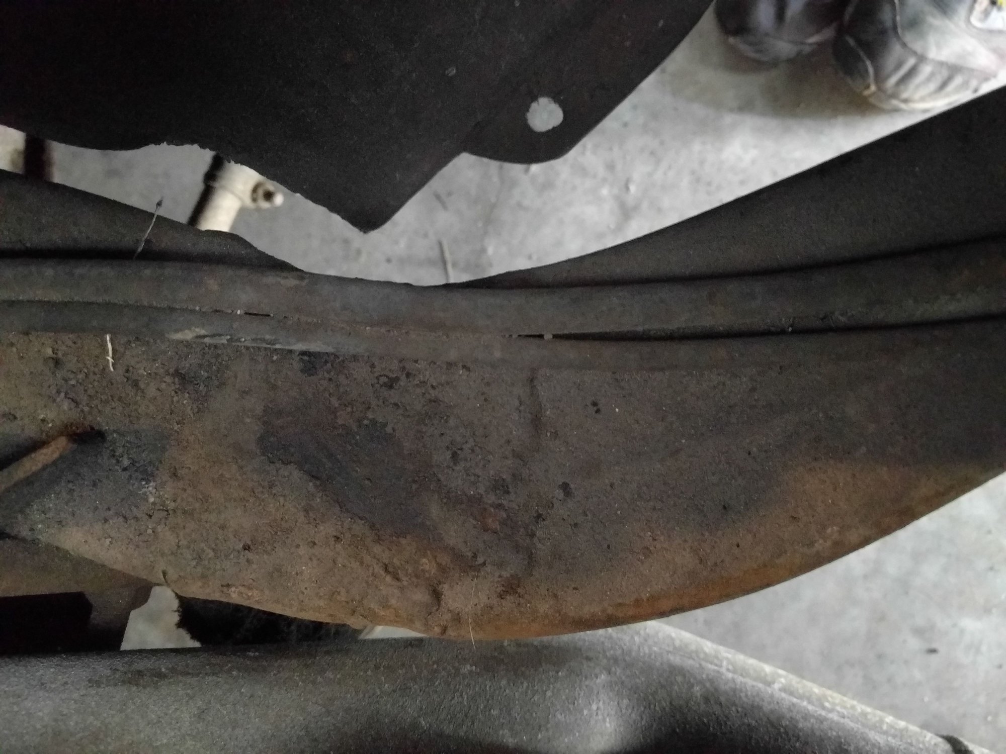

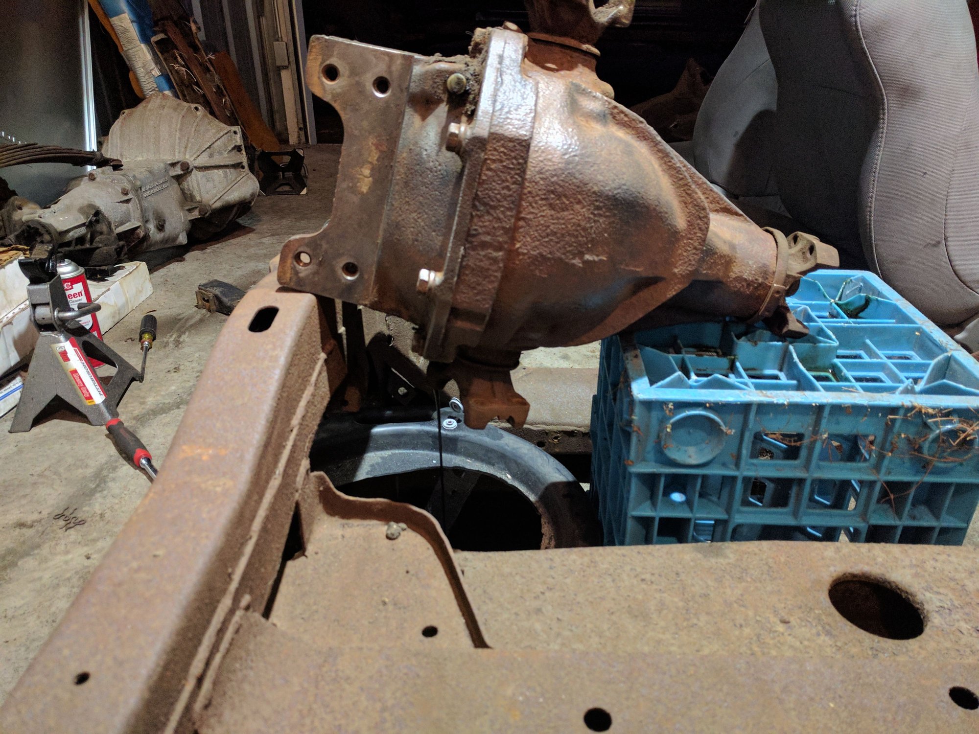

After further investigation, I discovered frame damage that was "repaired". After sitting on this for a month or so not knowing what to do, I decided to pull the body and contemplate some more. Towed the car to work to remove the body and store it in the backyard there for a few months. Brought frame back to storage for disassembly.
Old Sep 8, 2020 | 08:01 PM
LINY Kevin's Avatar
LINY Kevin
Joined: Feb 2017
Posts: 75
Likes: 16
From: Holtsville NY

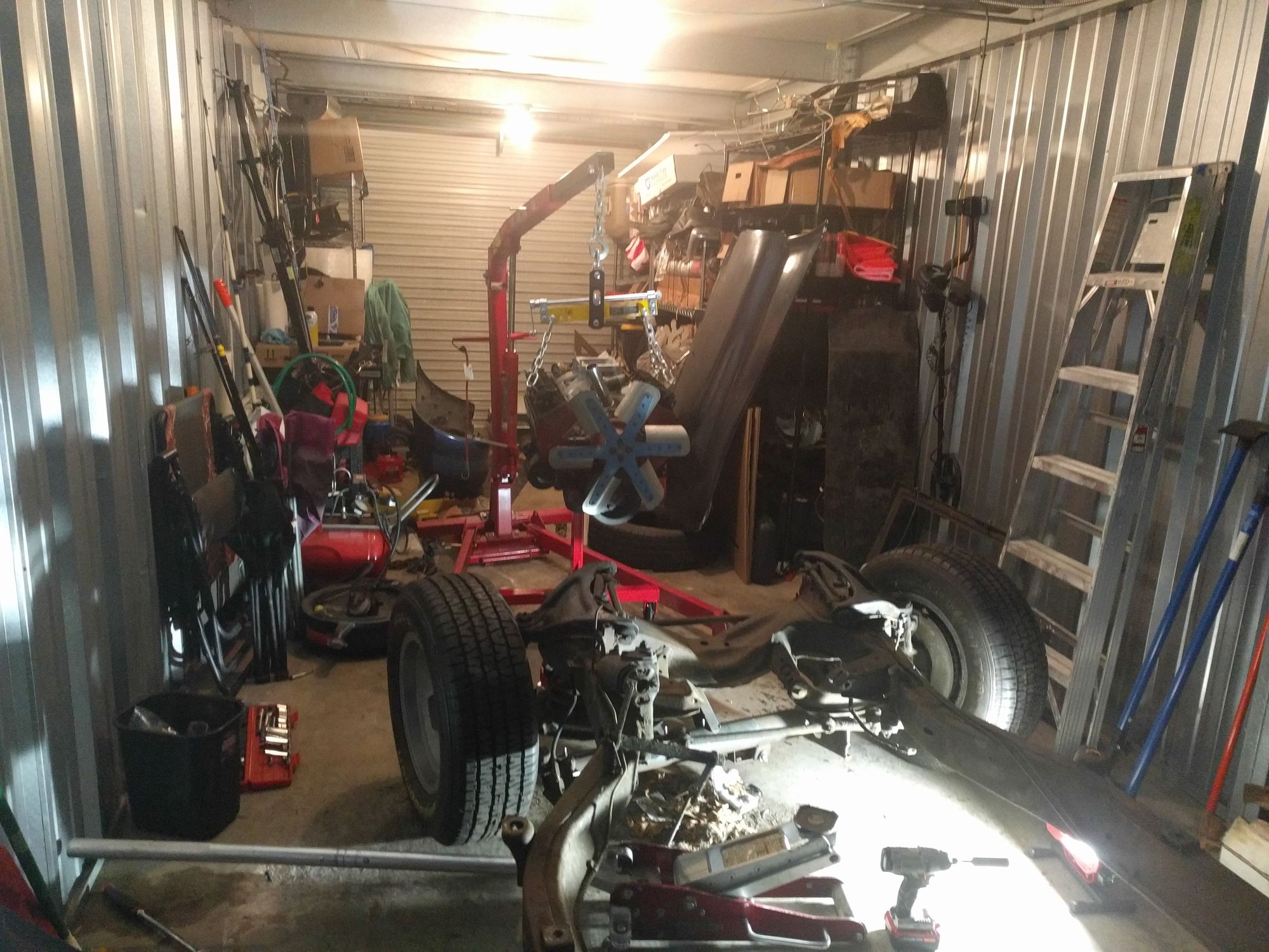

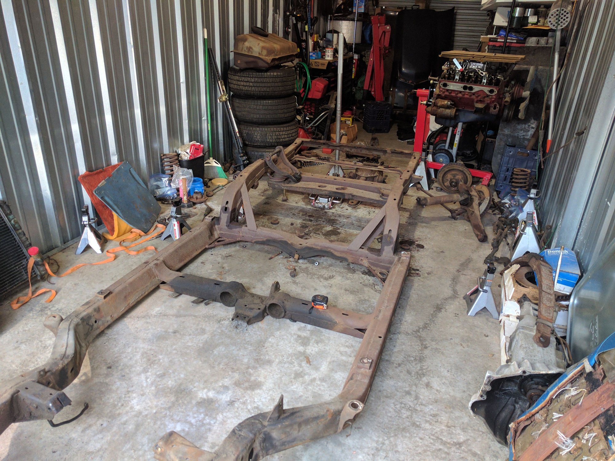

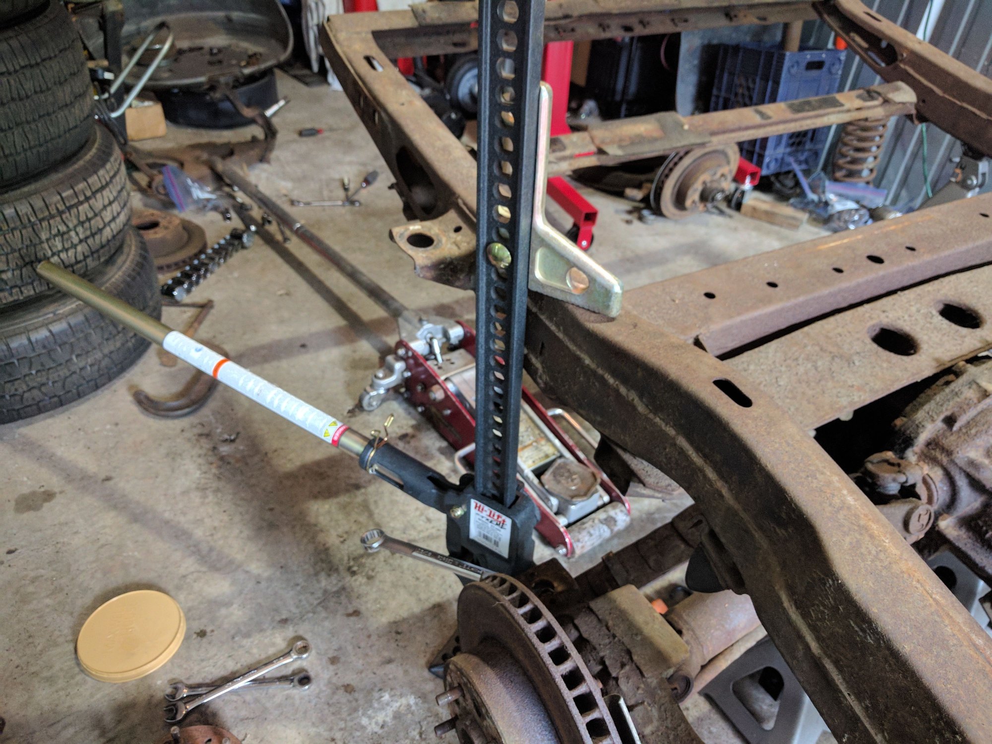

Wishing I was driving instead of sitting on the frame.
Small space, borrowed bent engine lift, but its out.
Ick.
Repair, or replace....

Half way there
Compressing the rear spring with no weight.
Stripped

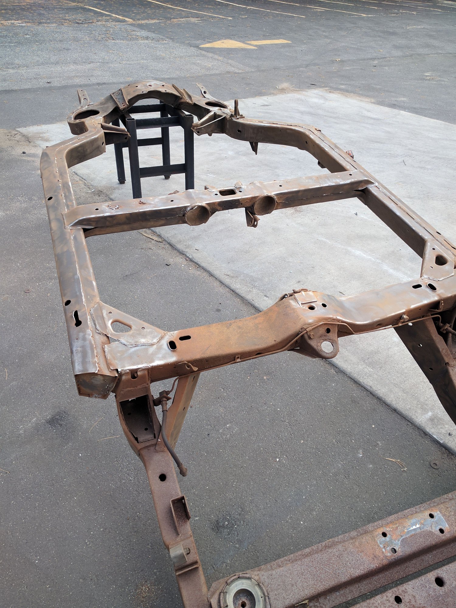

Old Sep 8, 2020 | 08:07 PM
LINY Kevin's Avatar
LINY Kevin
Joined: Feb 2017
Posts: 75
Likes: 16
From: Holtsville NY

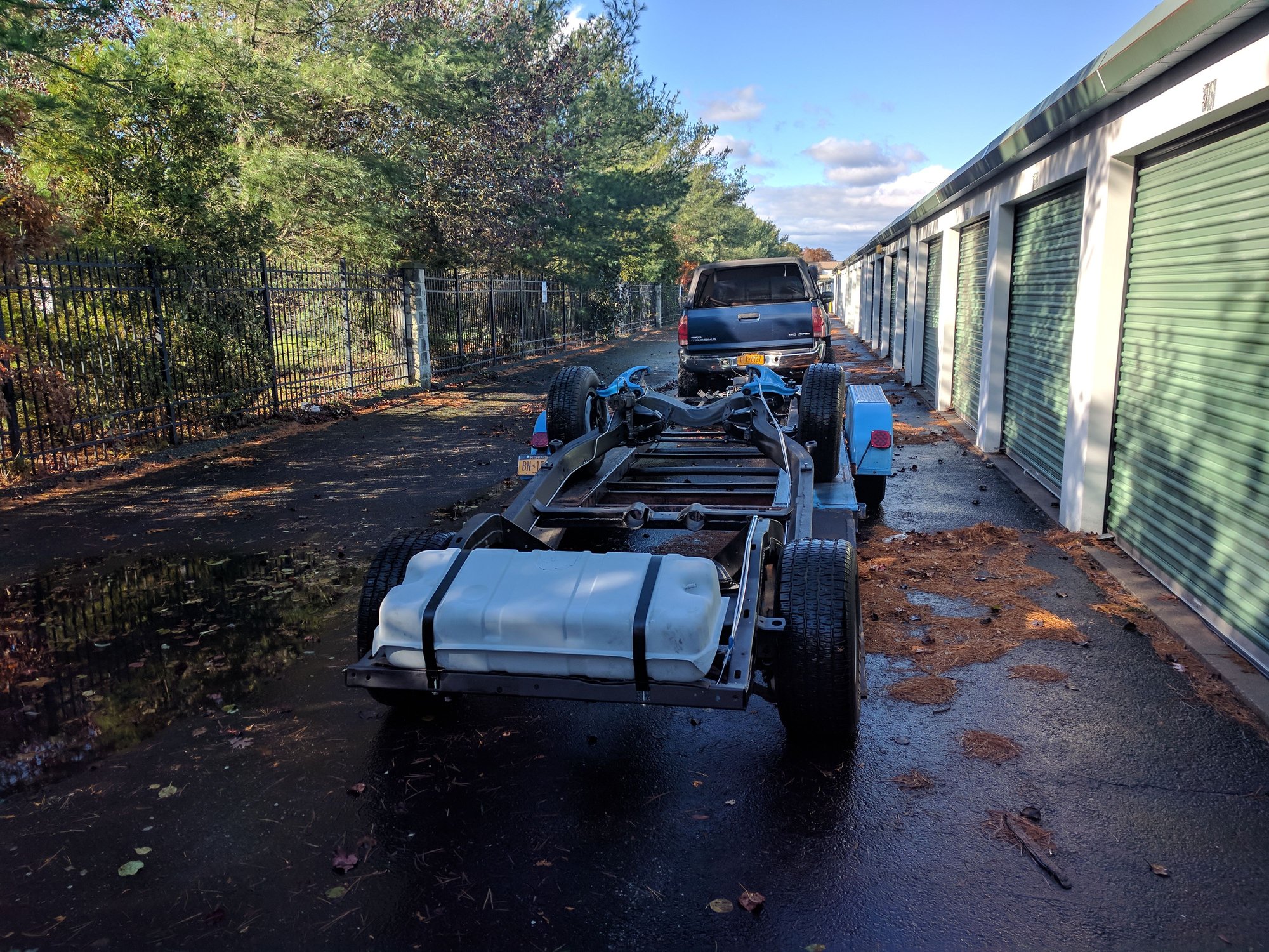

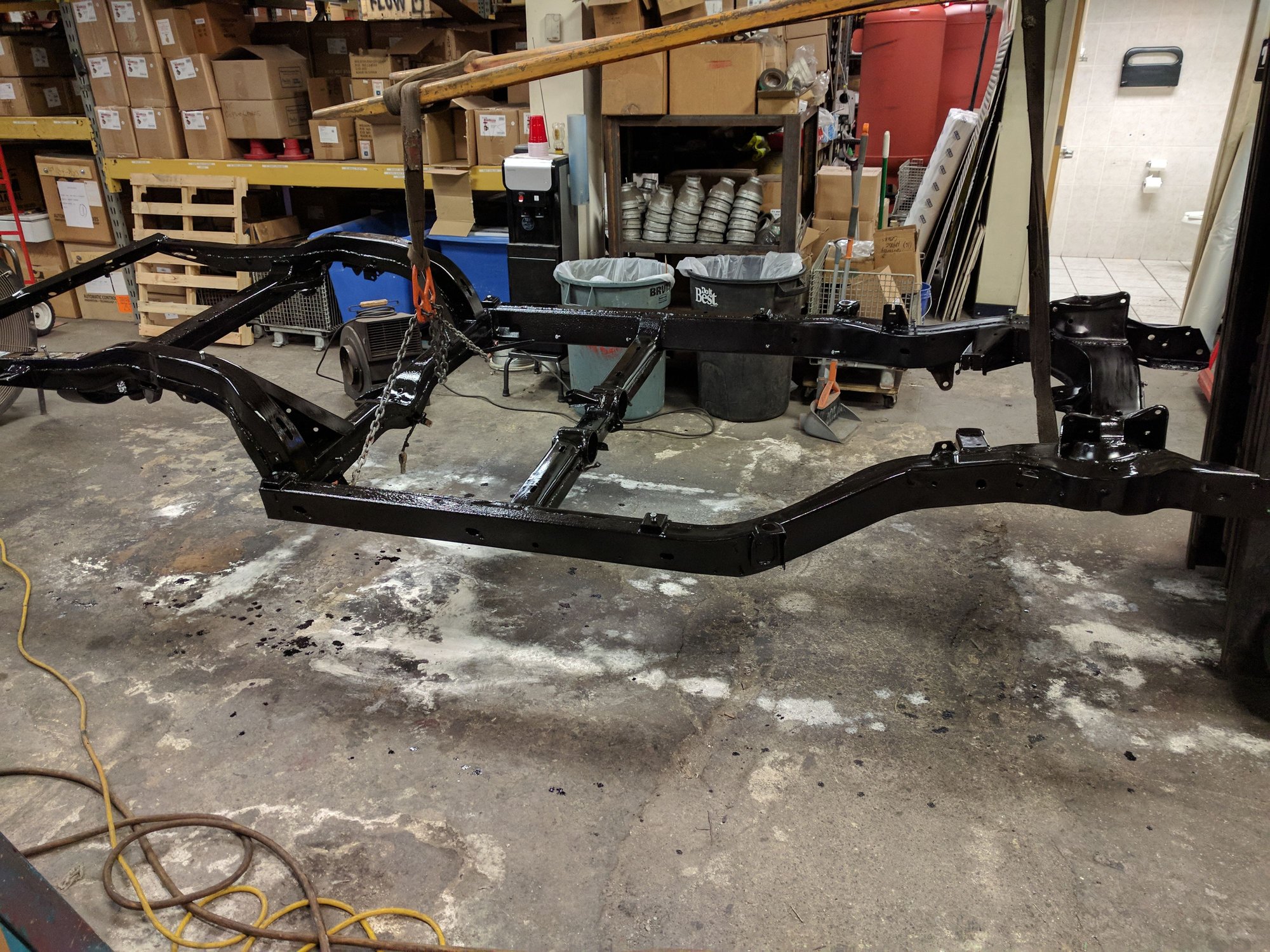

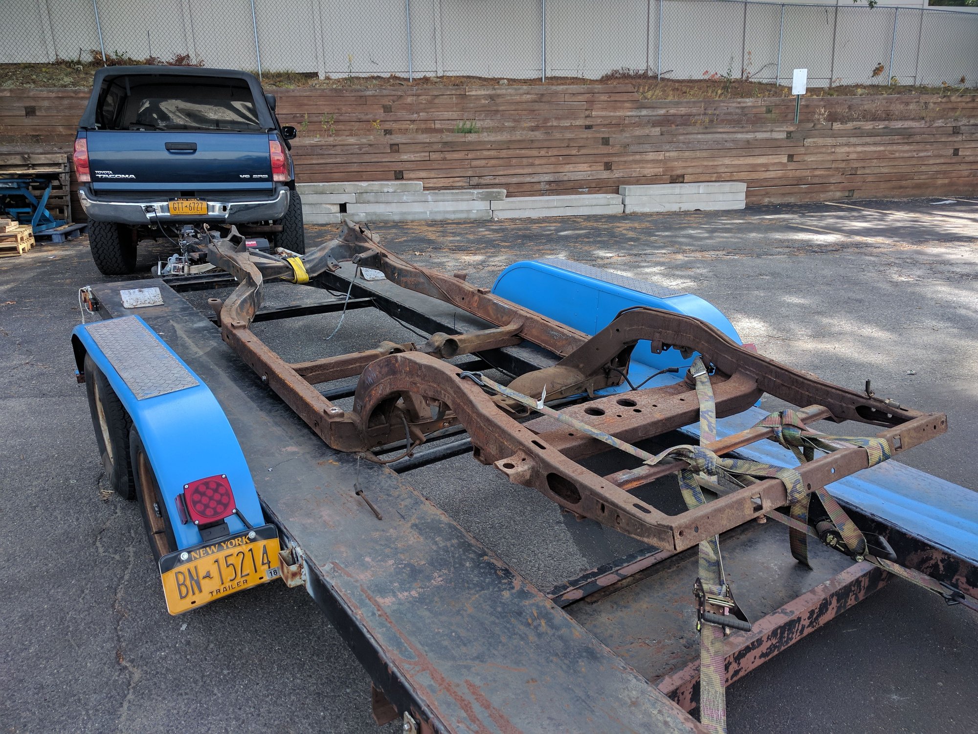

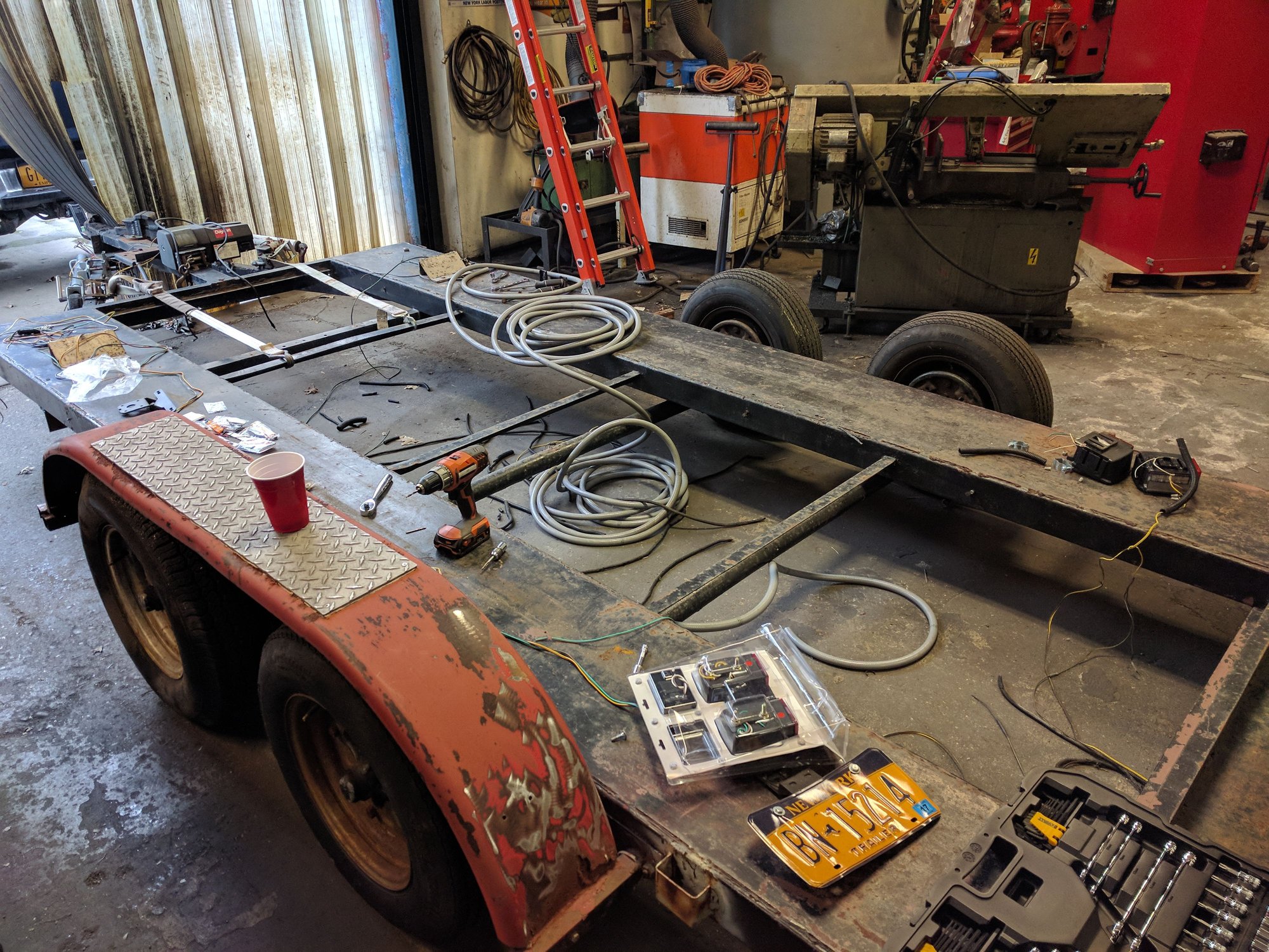

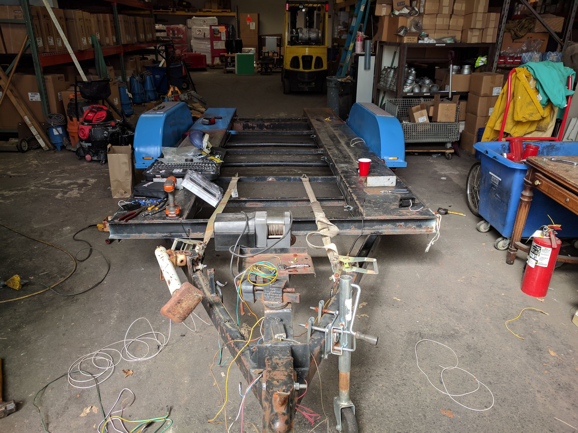

Found me a replacement frame. Now need to make the trailer road worthy to make the trip and not get pulled over
Safety blue looks new.
The big day.
My rusted but solid and straight replacement frame ready for some cleaning.
Old Sep 8, 2020 | 08:13 PM
LINY Kevin's Avatar
LINY Kevin
Joined: Feb 2017
Posts: 75
Likes: 16
From: Holtsville NY

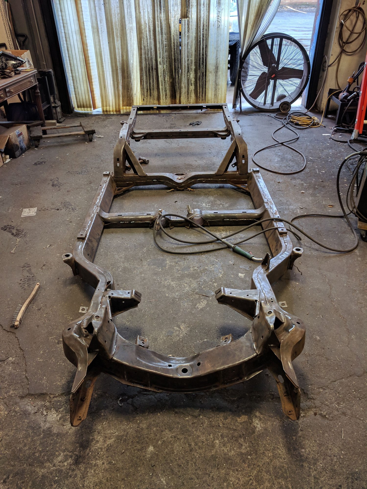

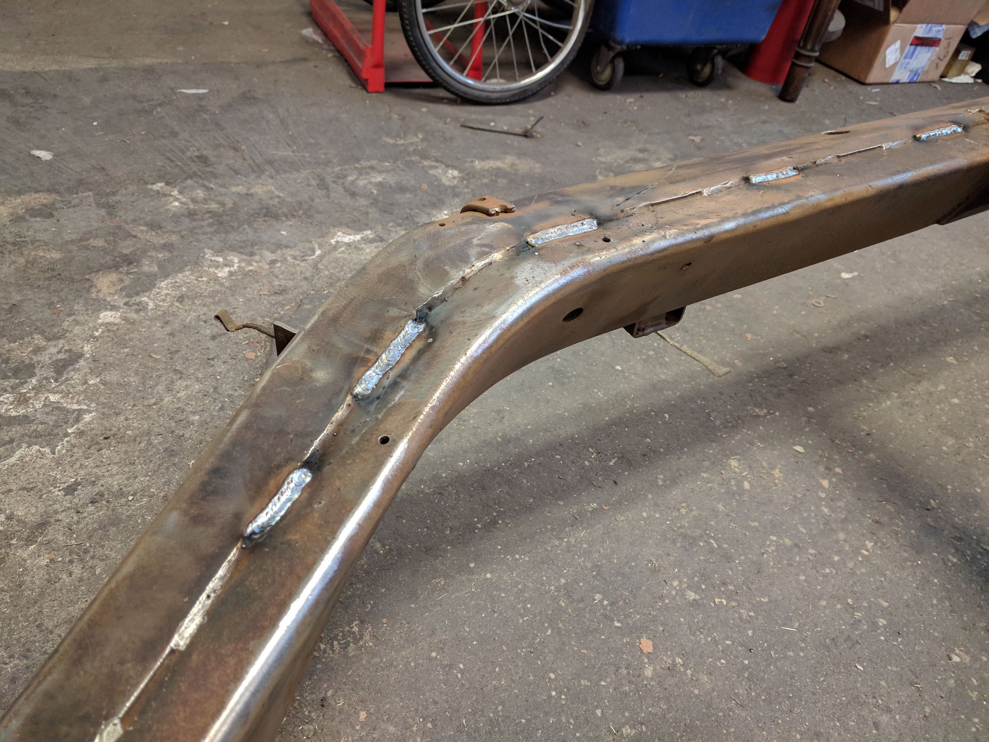

Little clean up before some stitch welding
Few stitch welds
Back to storage for next weekend. Can I say I have 2 corvettes now?
Paint day
Don't put POR15 in a plastic cup. Was wondering why my boots were covered in paint. It will melt right through.

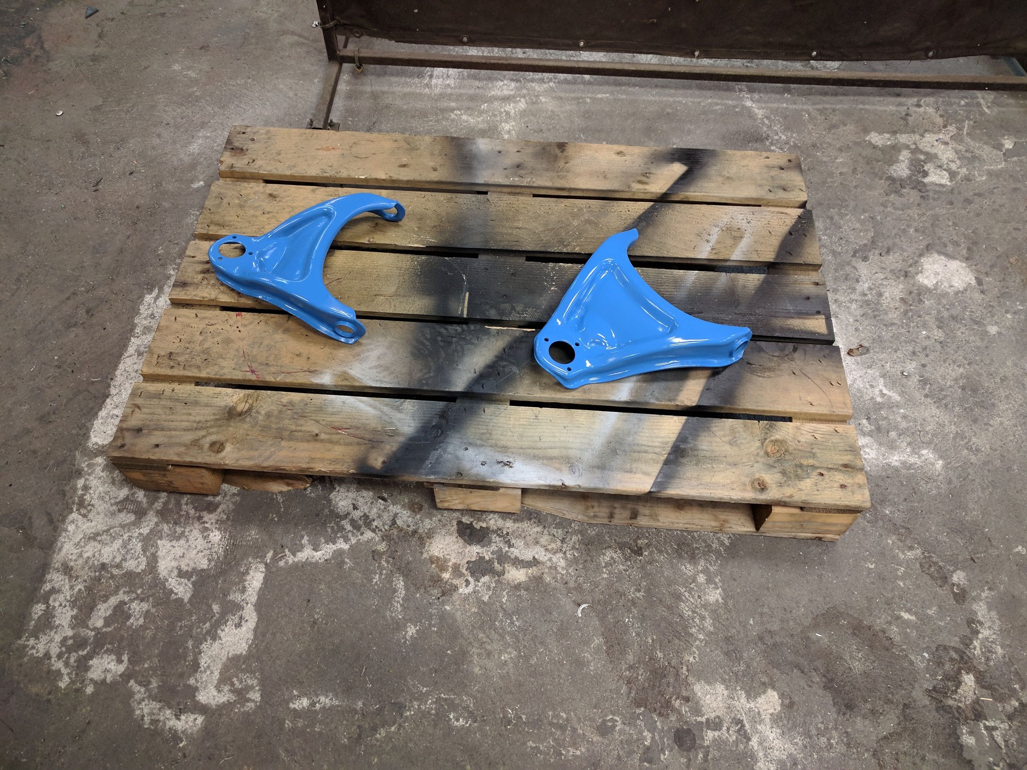

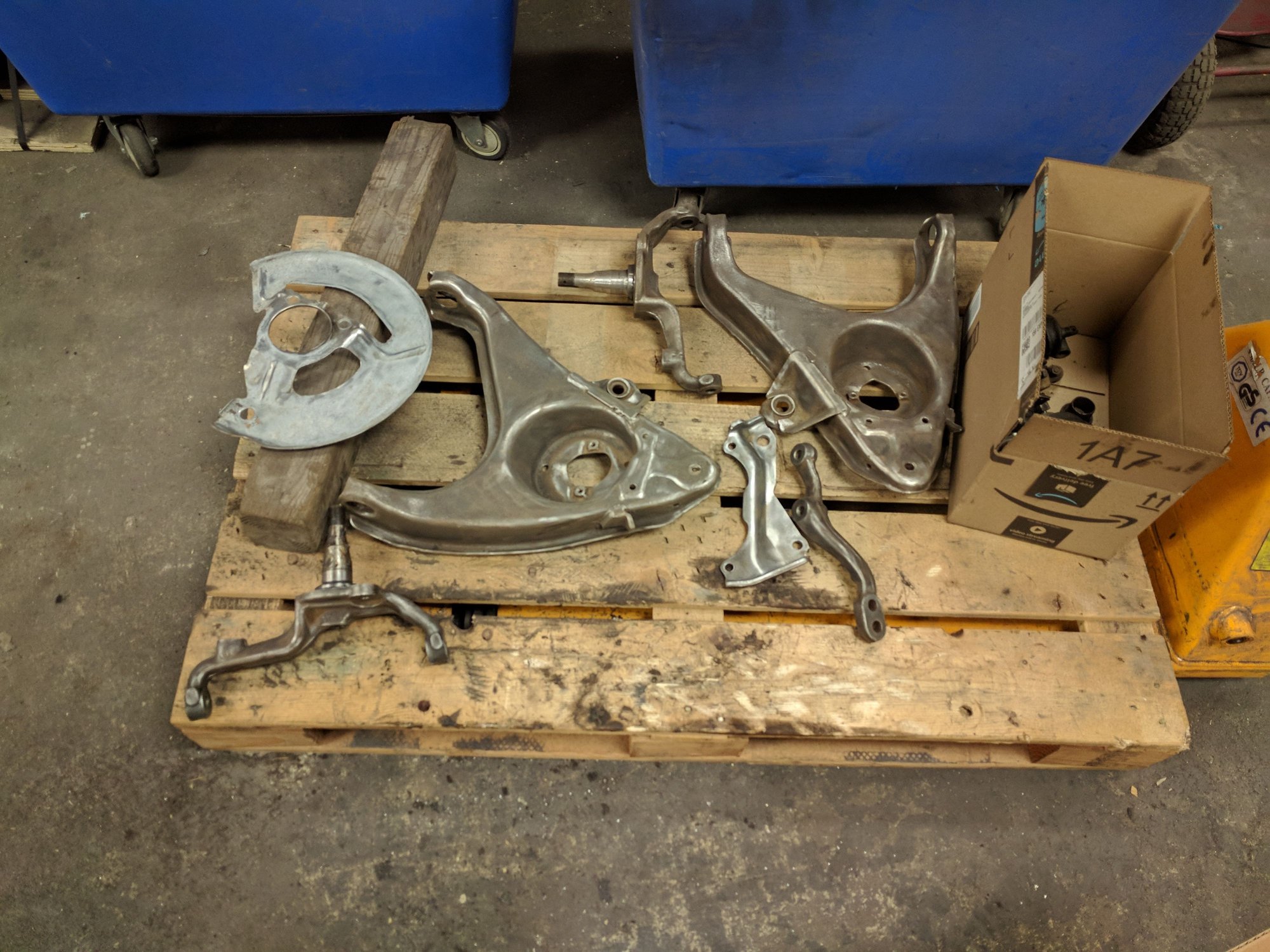

Old Sep 8, 2020 | 08:22 PM
LINY Kevin's Avatar
LINY Kevin
Joined: Feb 2017
Posts: 75
Likes: 16
From: Holtsville NY

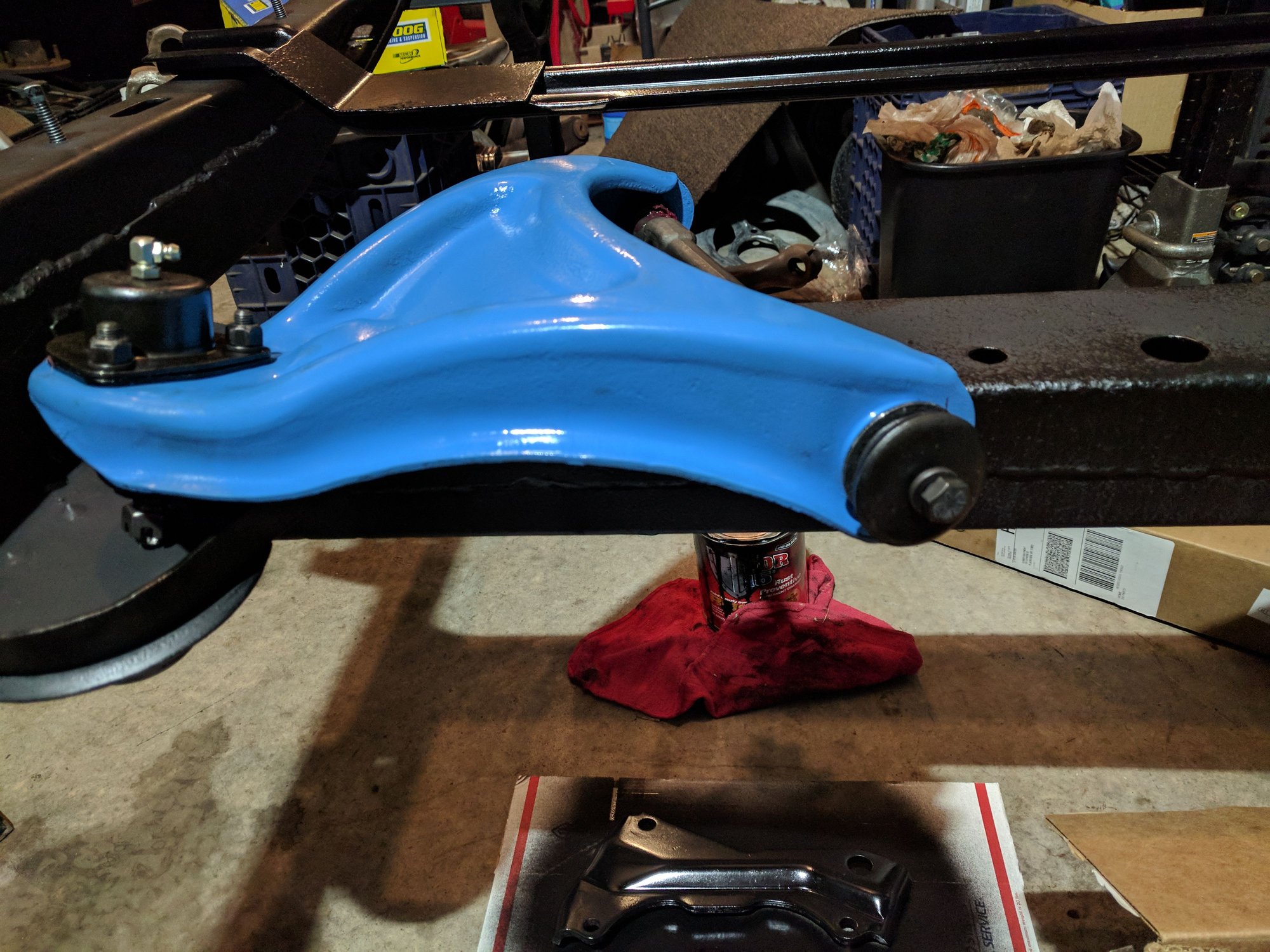

Time for some cleanup and paint
Can ya tell I like Safety Blue

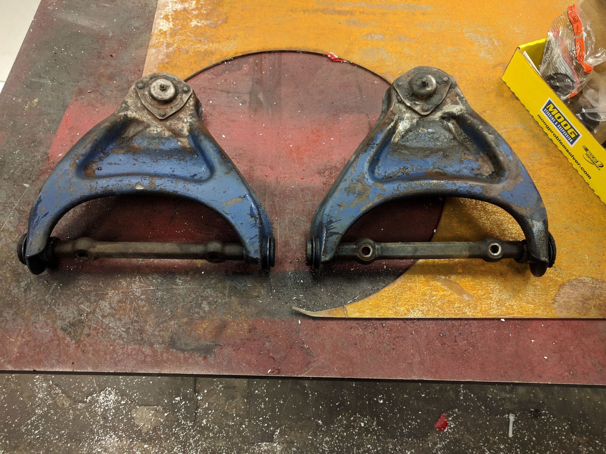

More parts with a wire wheel and angle grinder. No luxurious sand blasters.
Reassembled with new MOOG ball joints and cross shaft bar
More Safety Blue
Getting ready to paint the lowers.

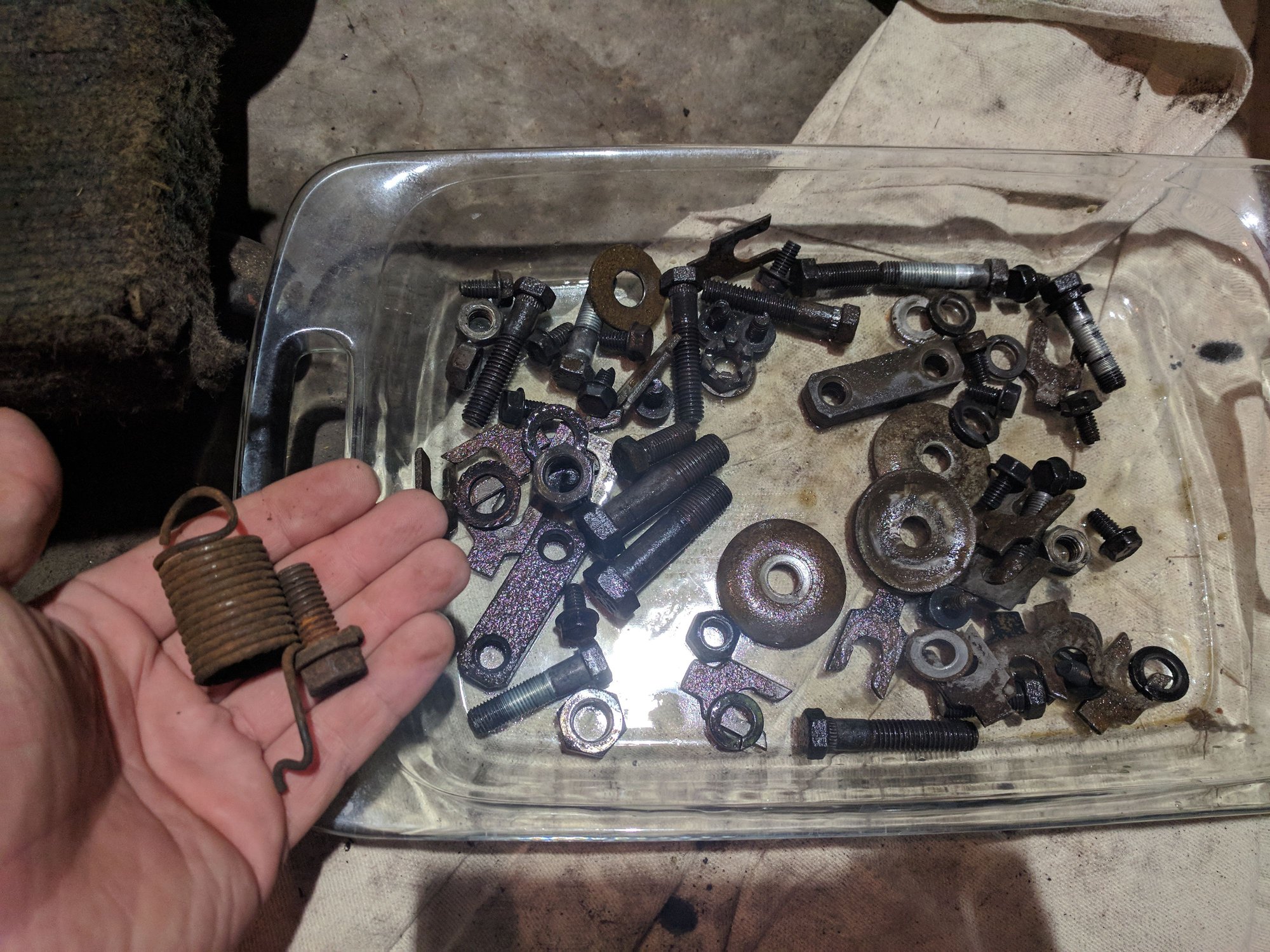

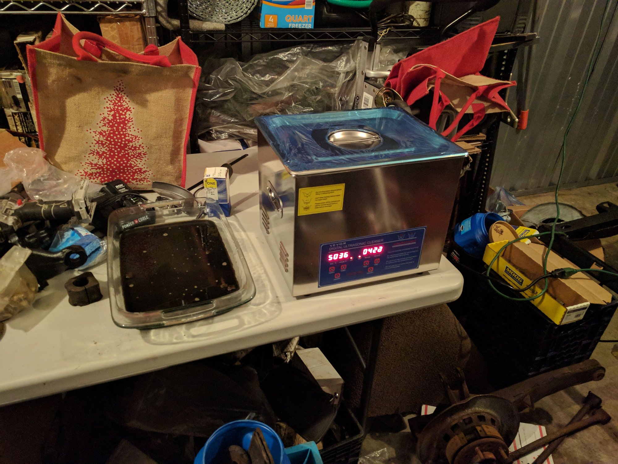

EvapoRust with an ultrasonic heater.
Works pretty good. This hardware looked like the stuff in my hand

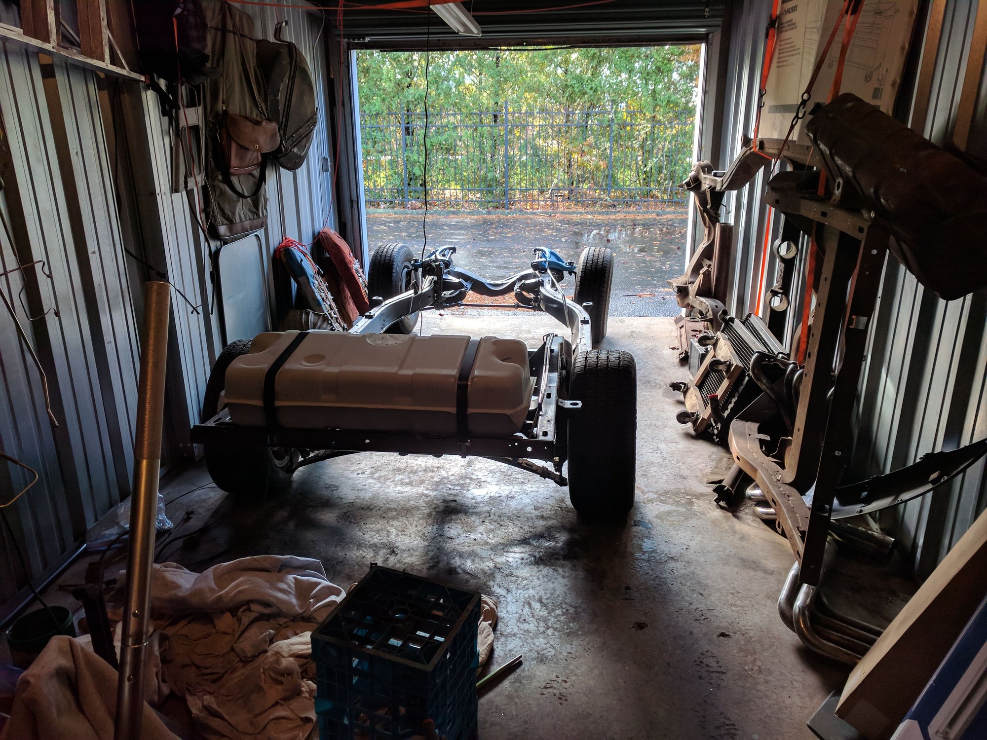

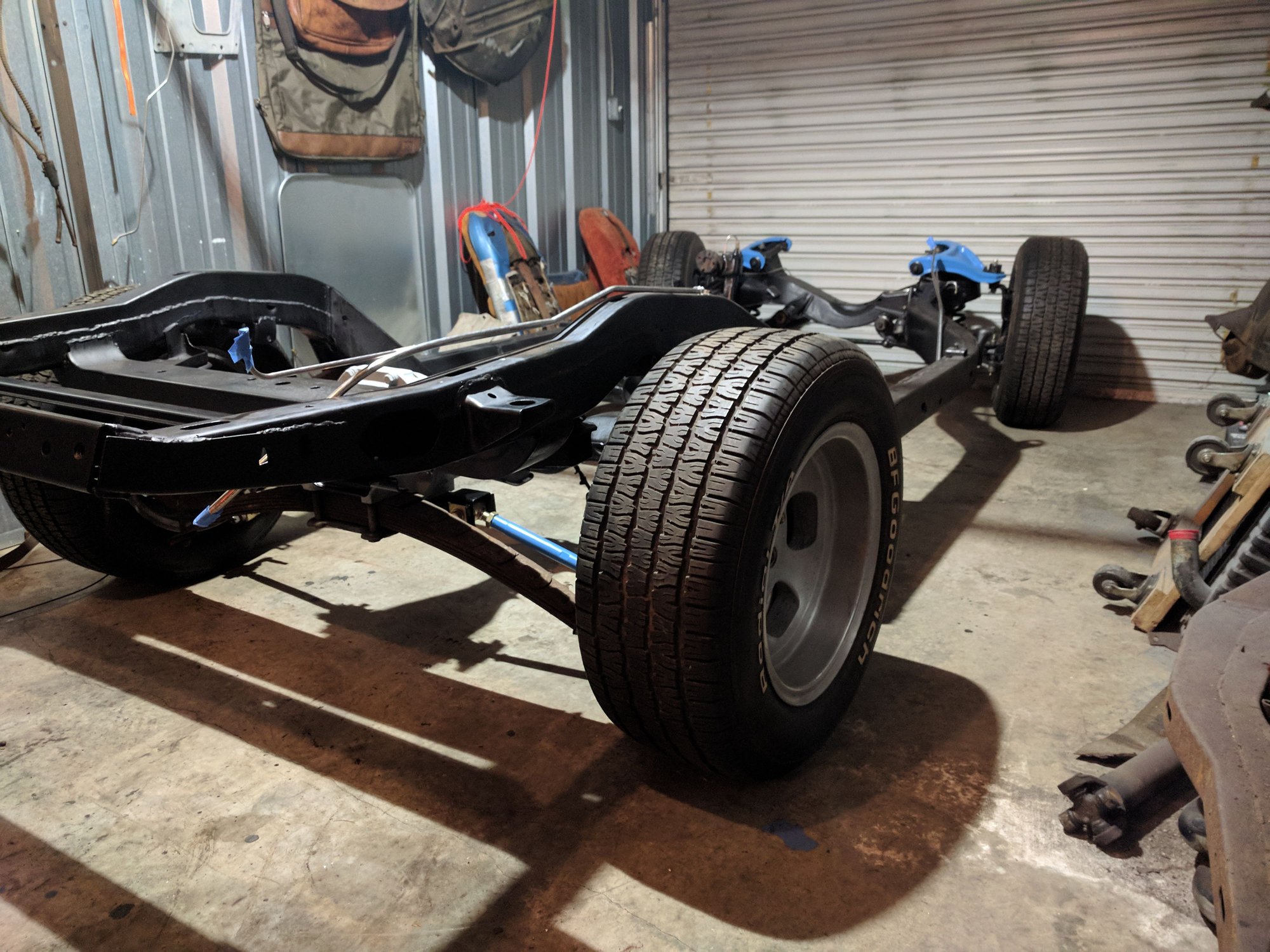

Beauty shot. Stainless gas lines in.
The day the body supposed to go back on. I spent about 3 hours in the morning trying to get the gas tank straps on. Finally found the easy way of removing the gas tank support and spinning the straps into place.
I will quickly learn that the half shafts support the rear trailing arms. Not noticeable here because the spring is strong enough to support the frame with no body.

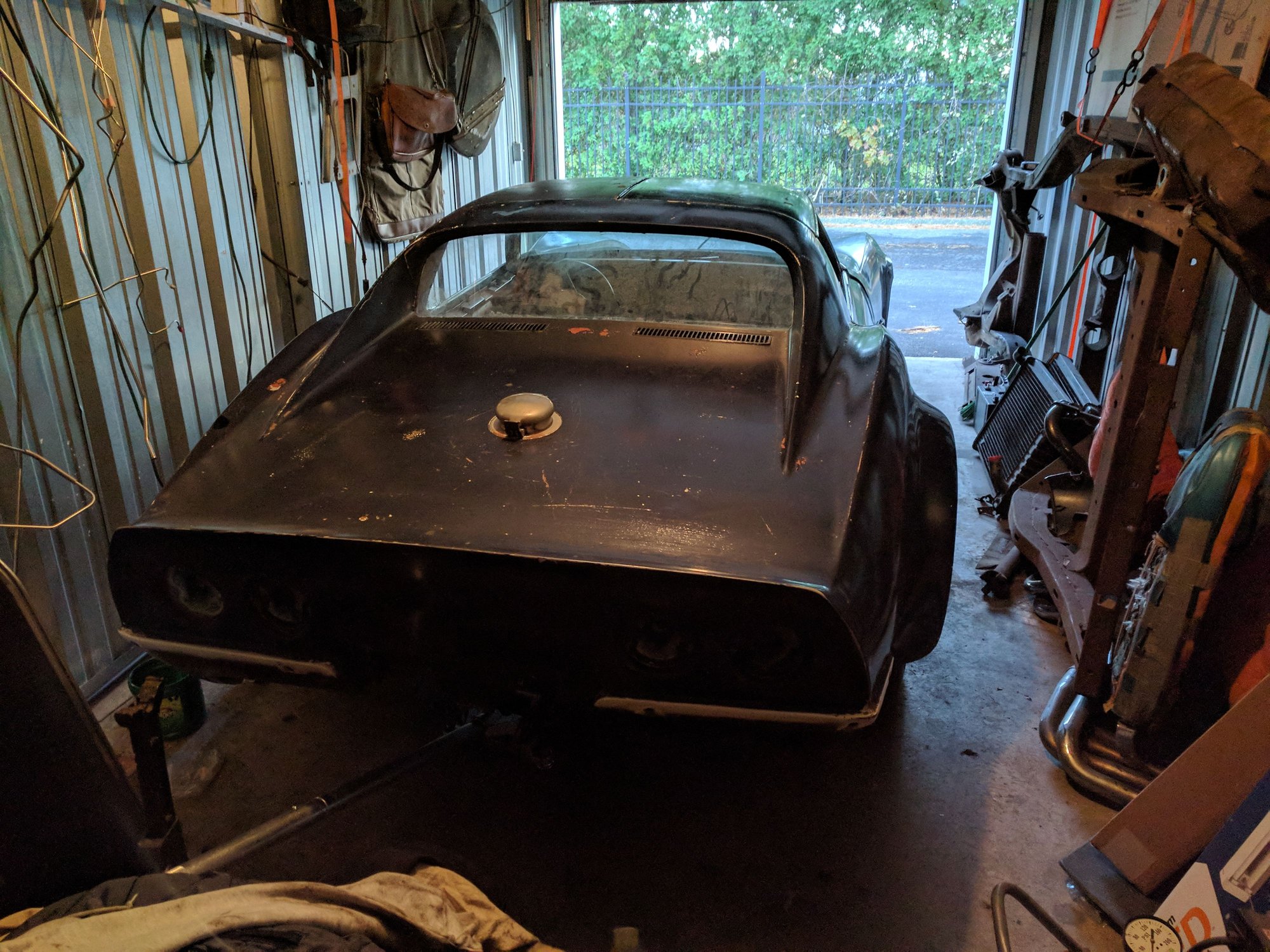

Body going back on just in time before winter. Don't want the snow plow hitting the already beat body.
Back home
Needs some more cleaning up. Wish I spent some time cleaning up under the body, but time was ticking.
Tight fit.
Little rearranging of the shop. I sometimes spend more time cleaning and organizing then I do working on the car.

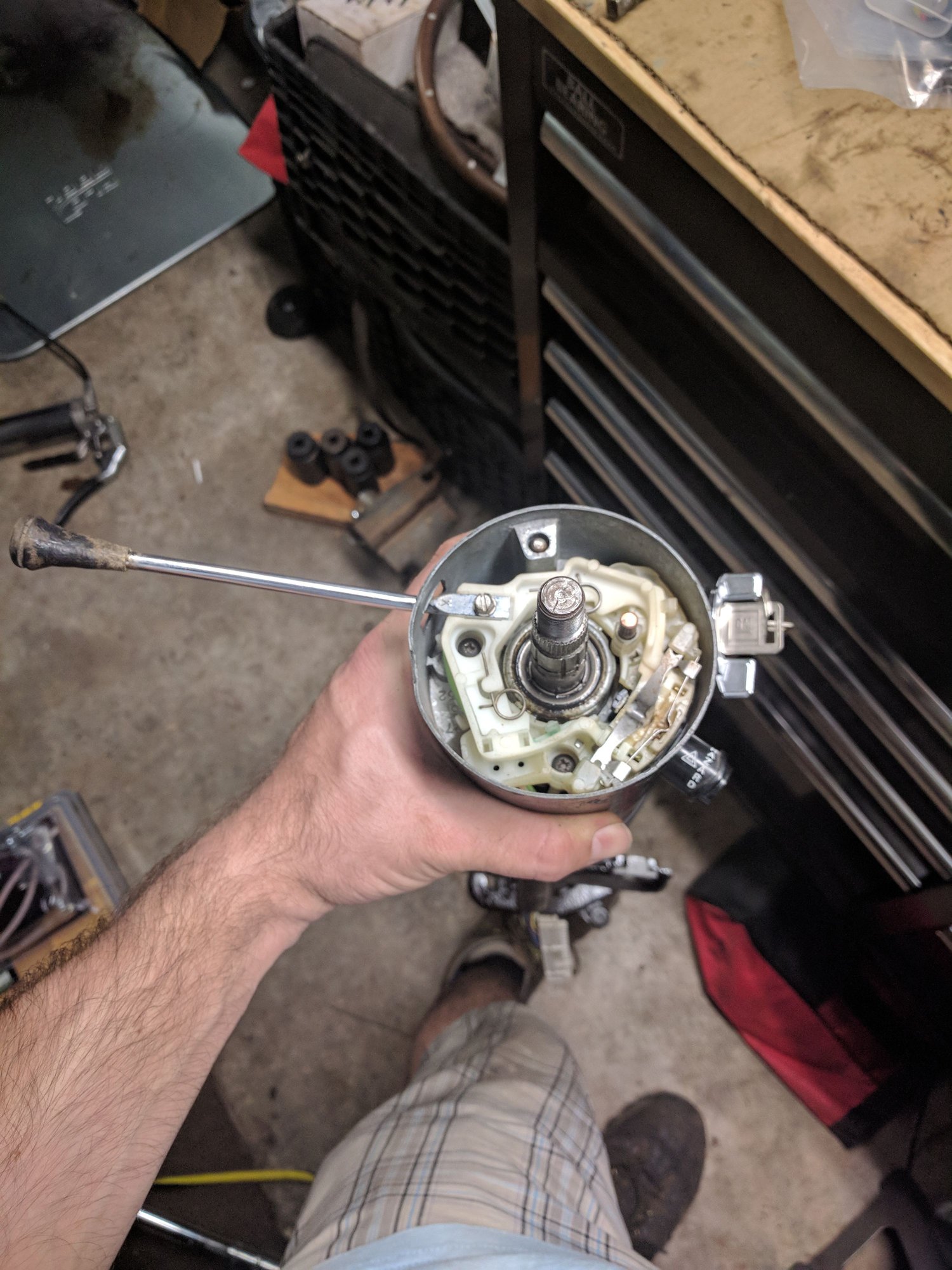

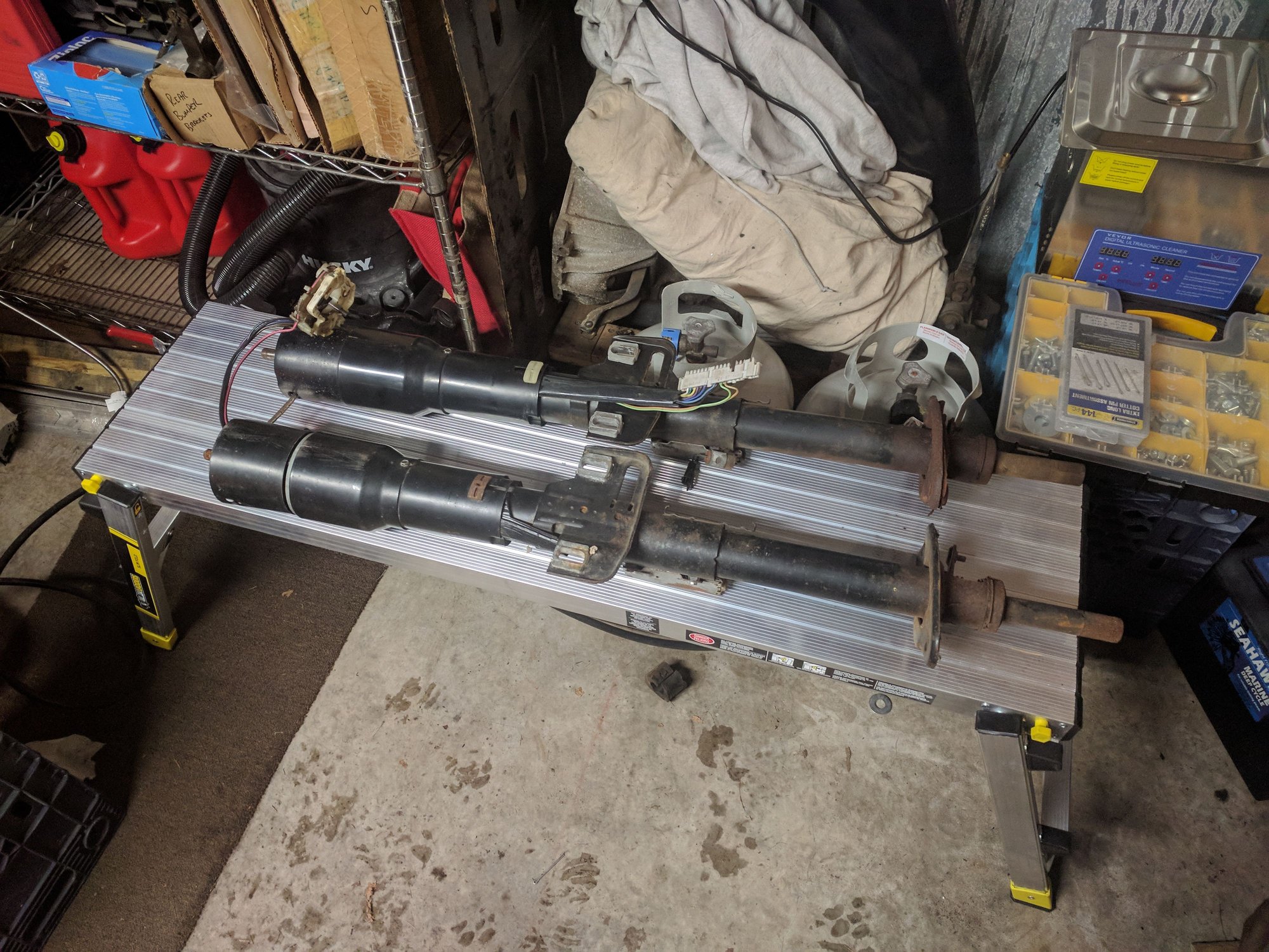

Time to work on the steering column
I'll make 1 good 1 out of the 2.
New cylinder in, some other small odds and end parts I needed to order.

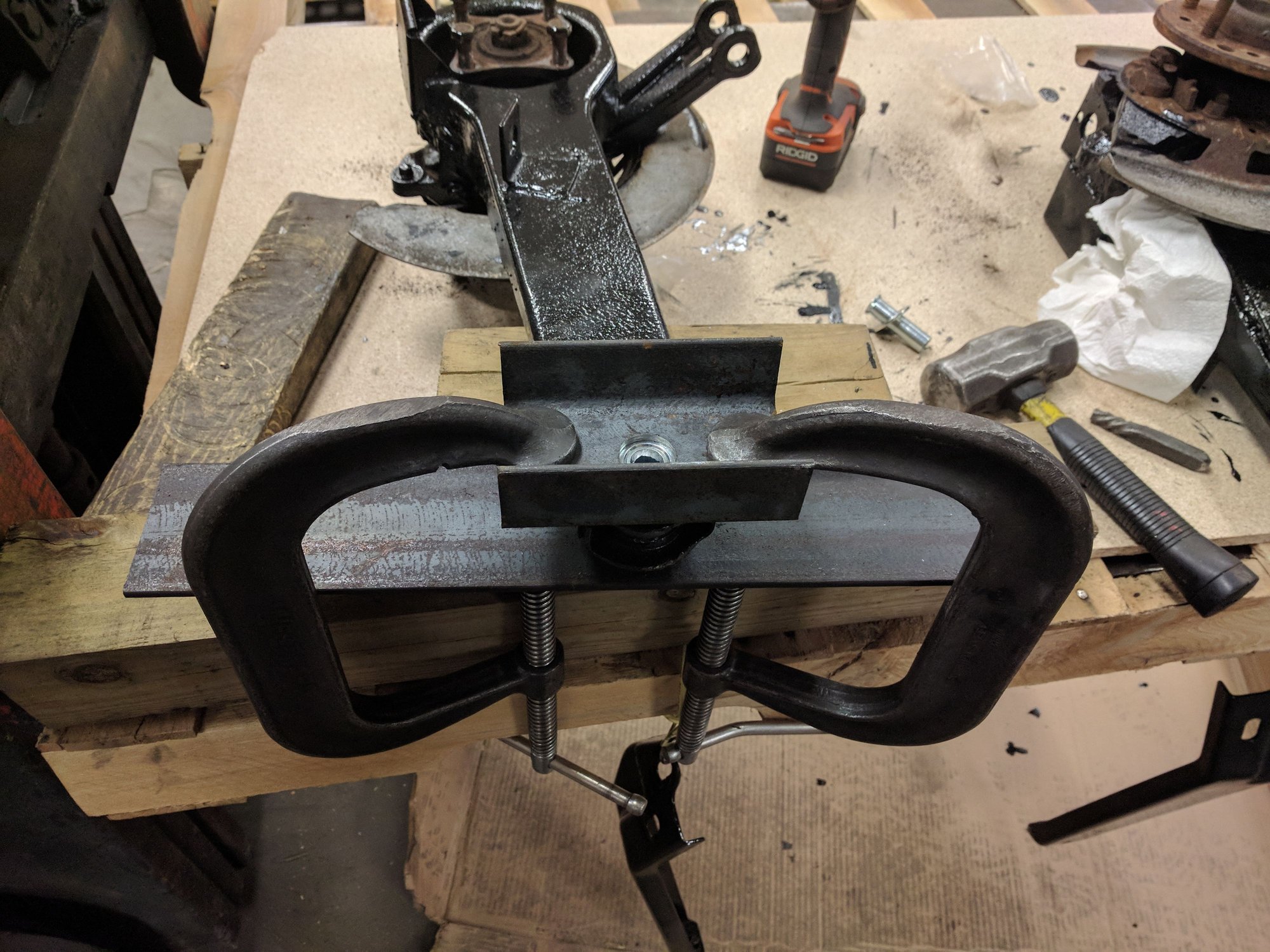

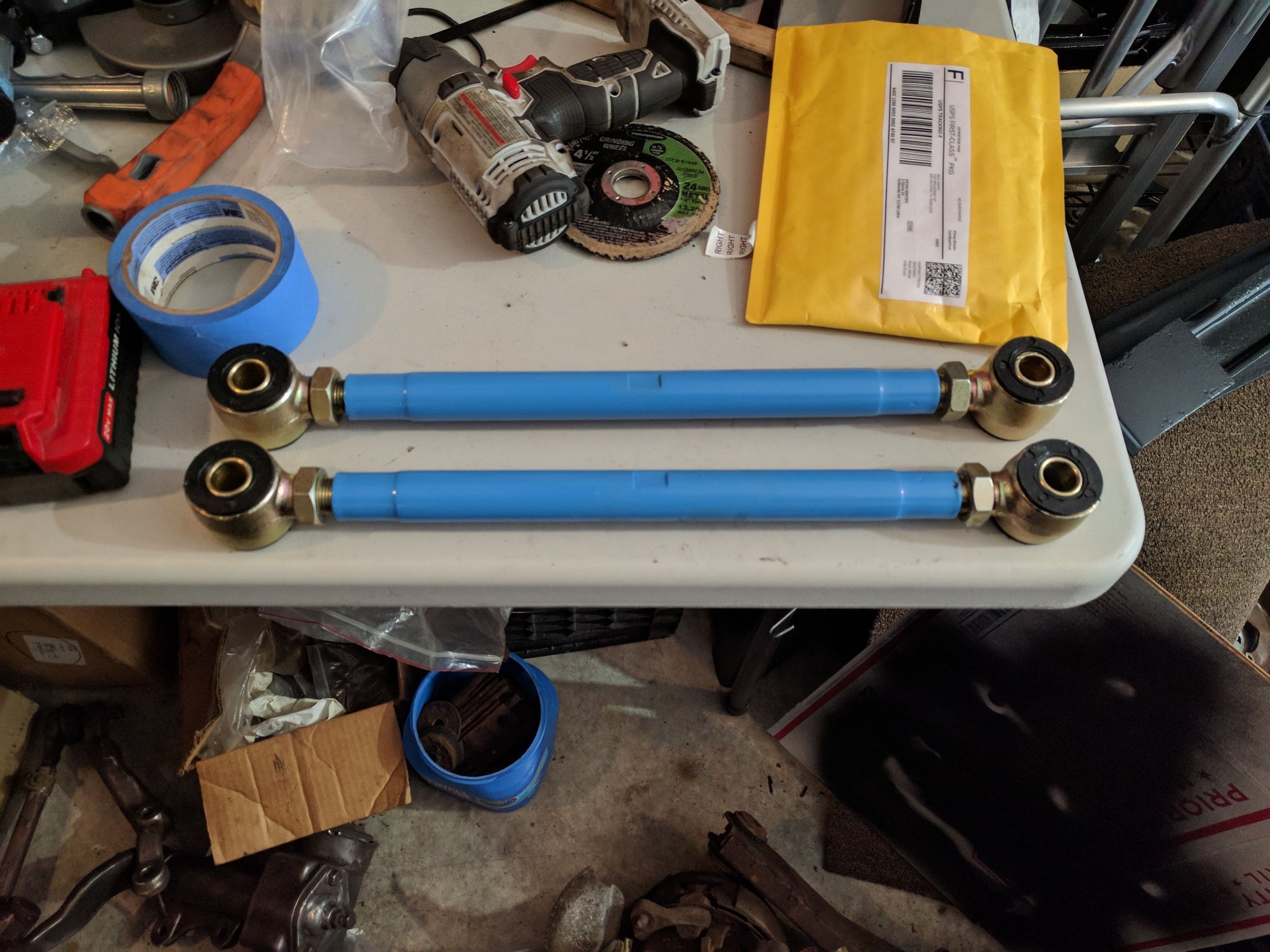

Replacing the trailing arm bushings. Easy tool made out of a piece of channel with a hole drilled in it. Old punch that I rounded the end on. Couple good wacks and it came out perfect
Safety Blue

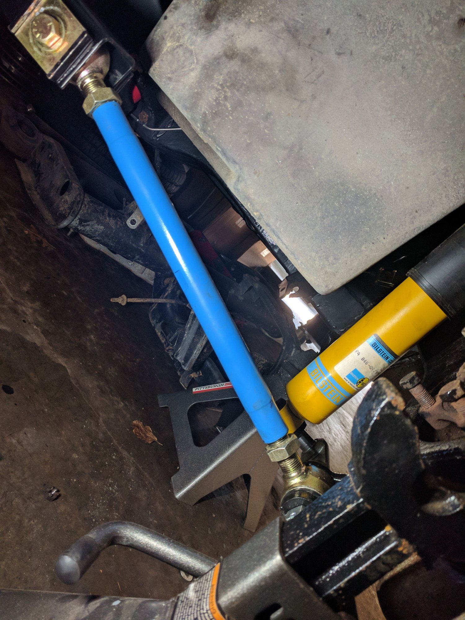

Some VBP upgrades arrived. Spring, front sway bar, and rear sway bar.

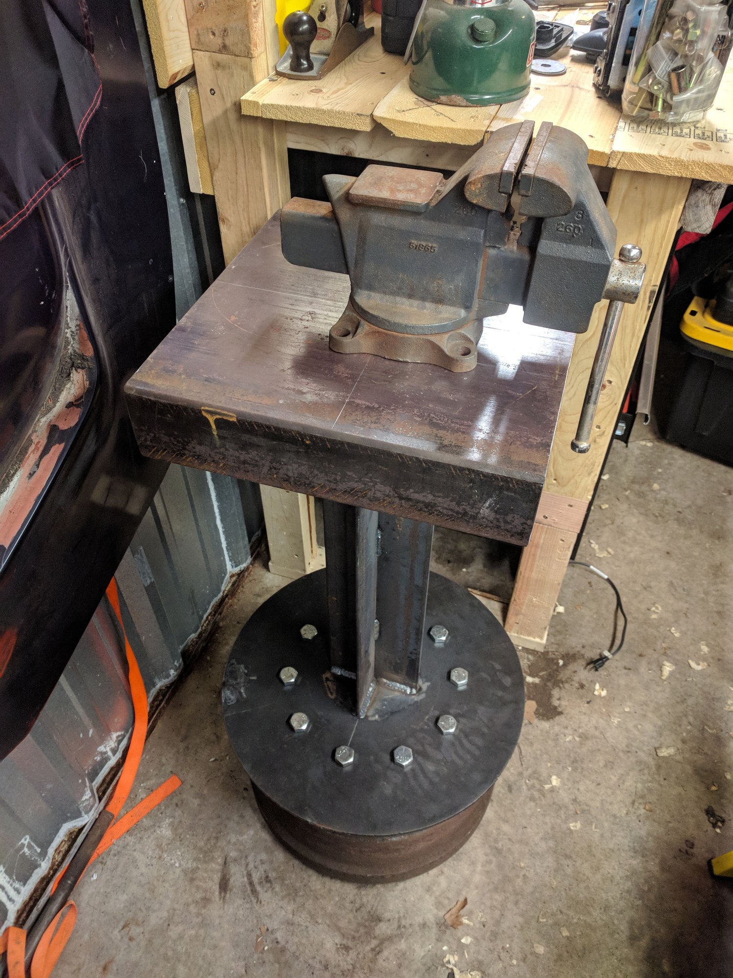

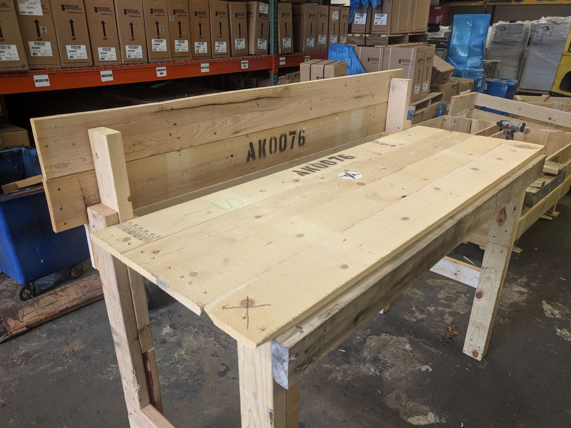

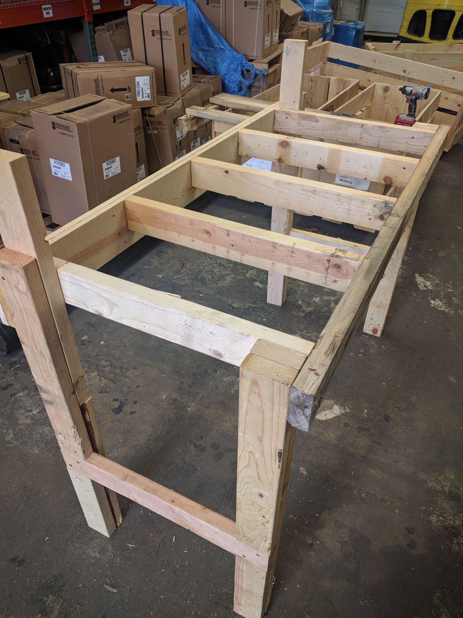

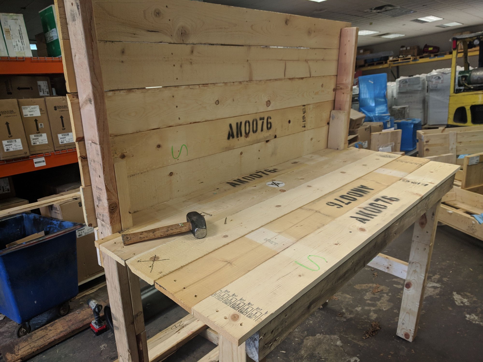

Little time building a workbench out of some pallet wood
I know it's going to collect clutter but it looks good now
Also made a vise stand from a tractor trailer drum

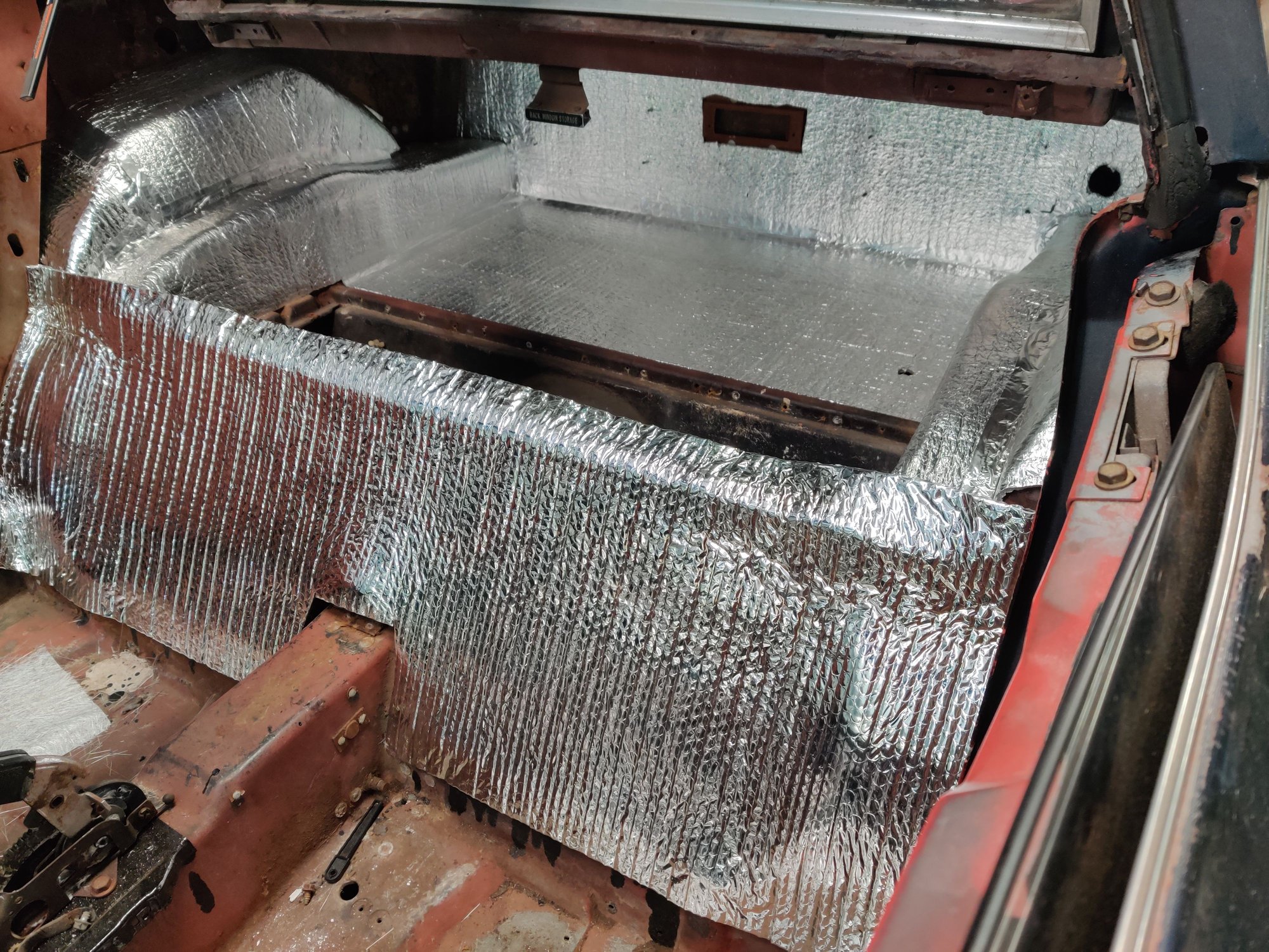

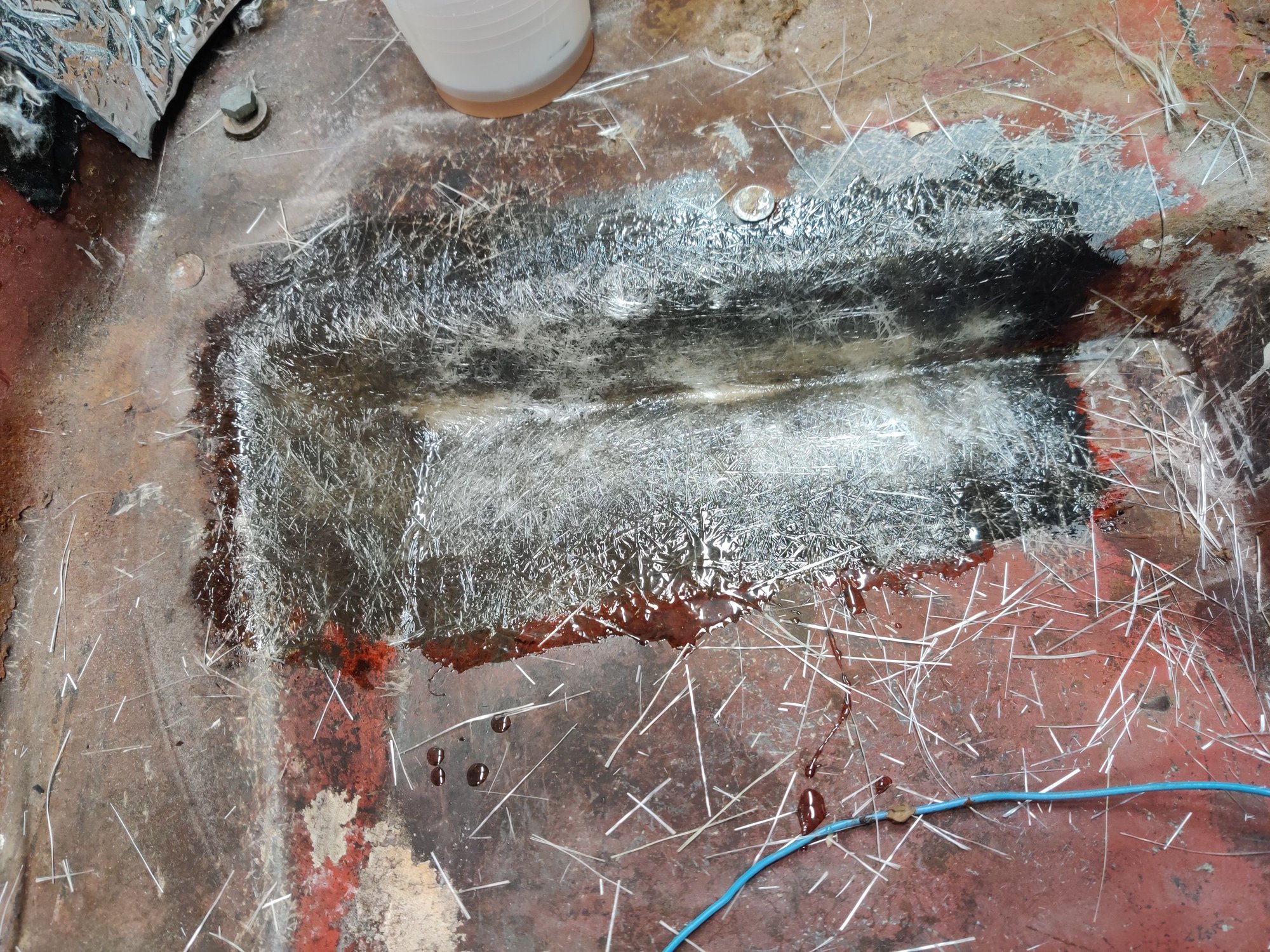

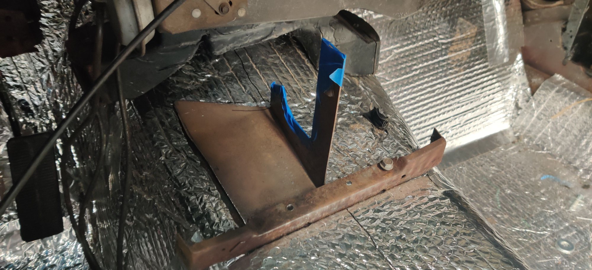

Time to tear the rest of this stuff out
Getting ready for my first fiberglass repair
Doesn't look great but it holds.

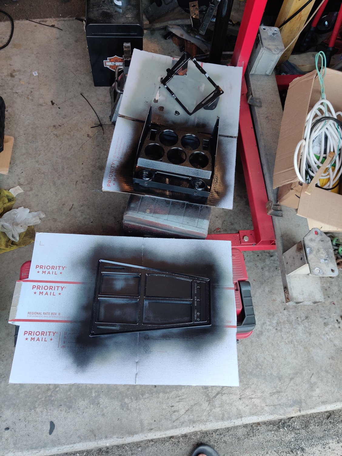

Old Sep 8, 2020 | 10:42 PM
LINY Kevin's Avatar
LINY Kevin
Joined: Feb 2017
Posts: 75
Likes: 16
From: Holtsville NY

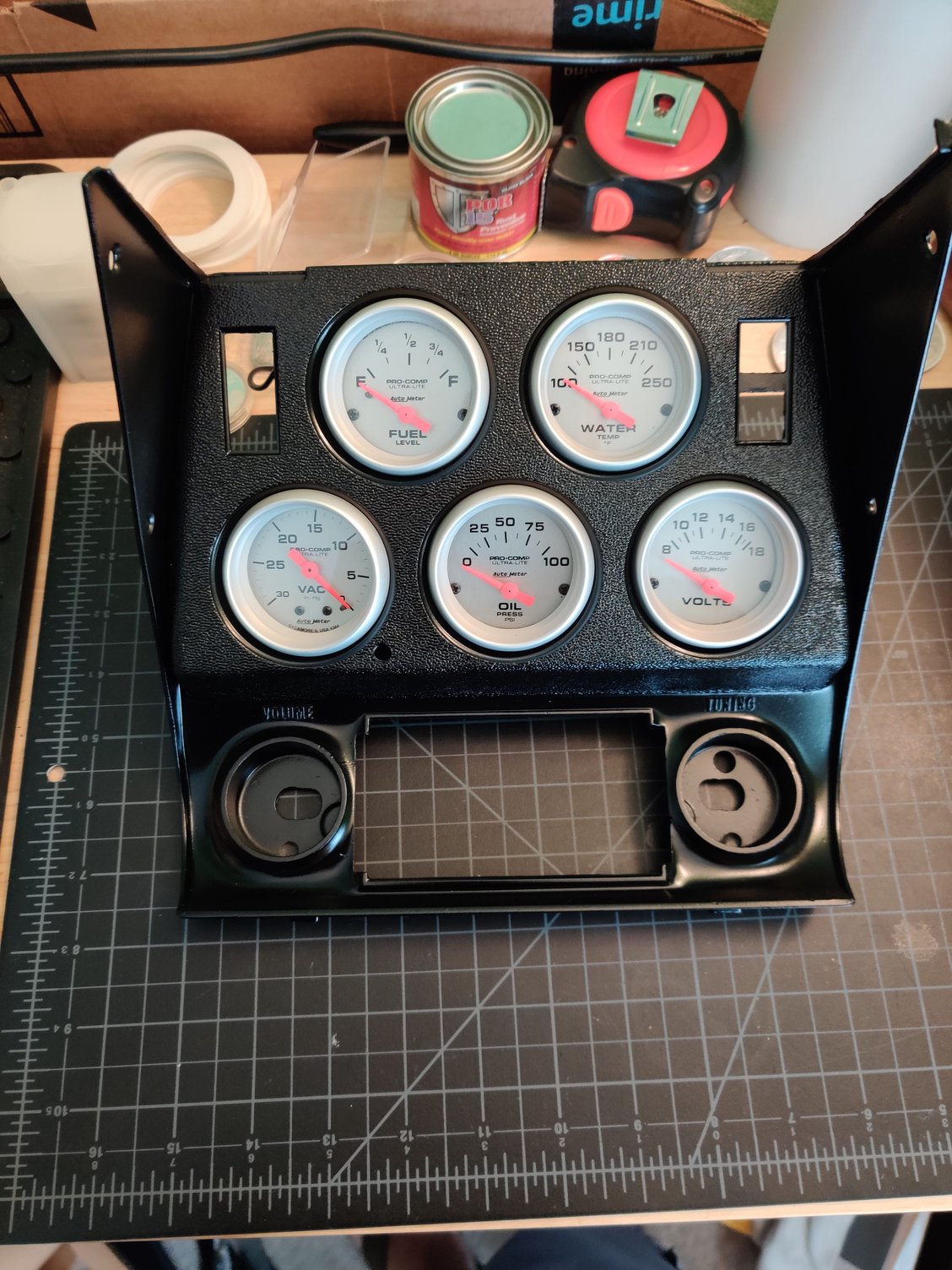

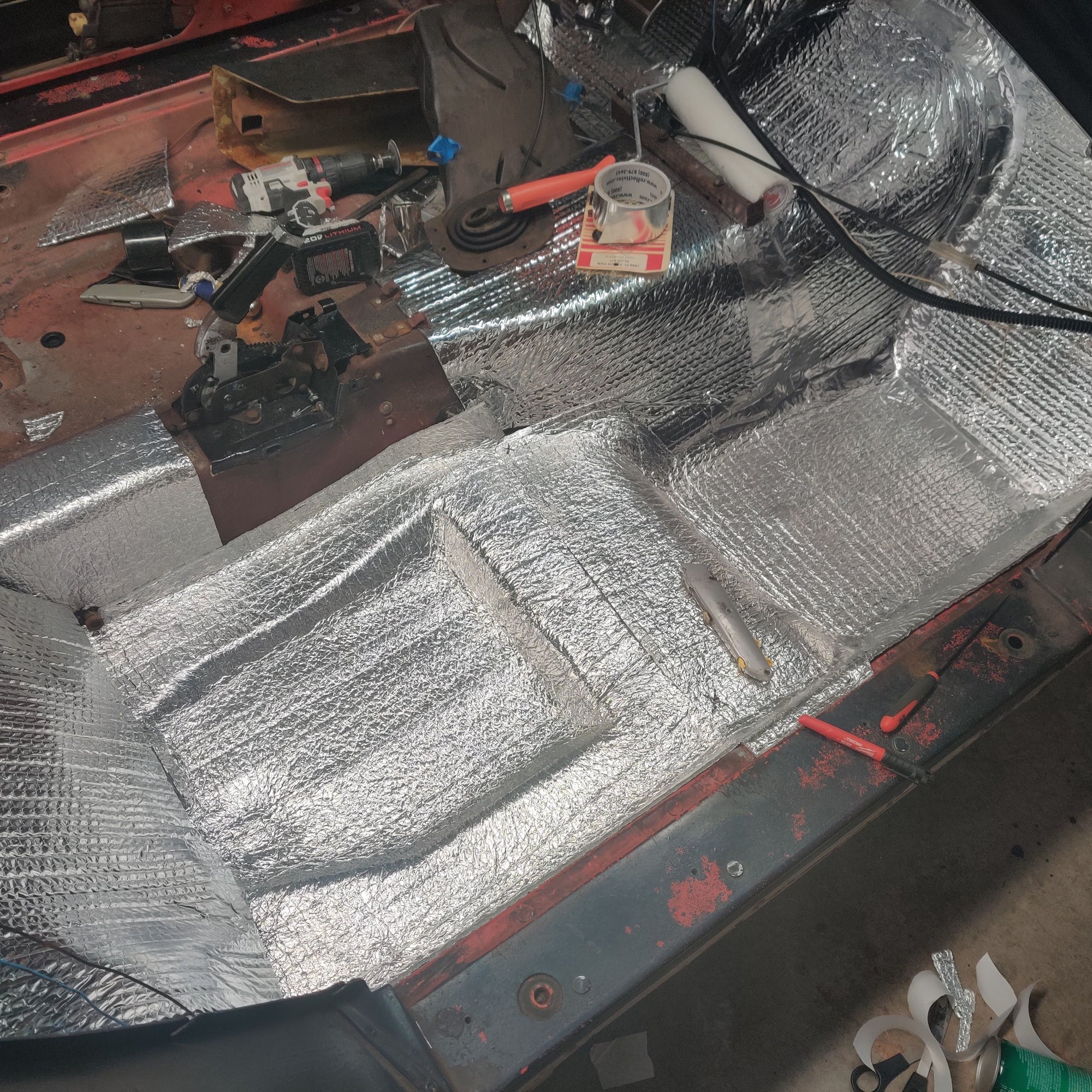

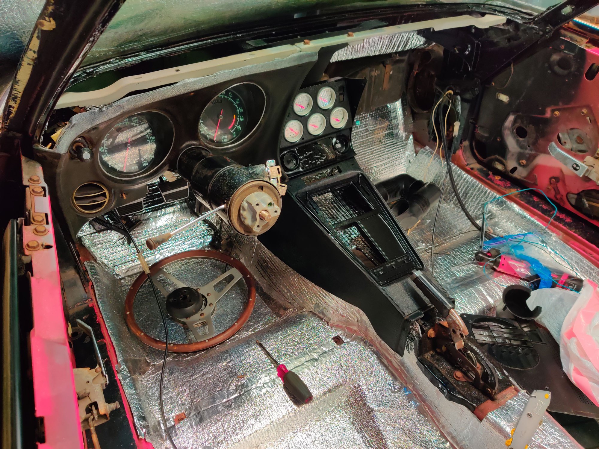

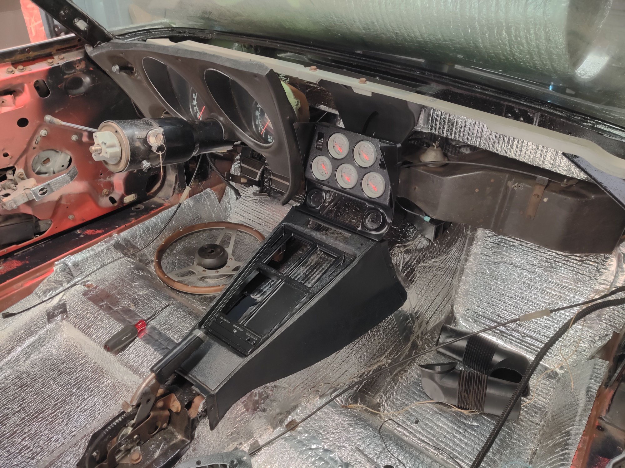

Some interior pieces getting some paint

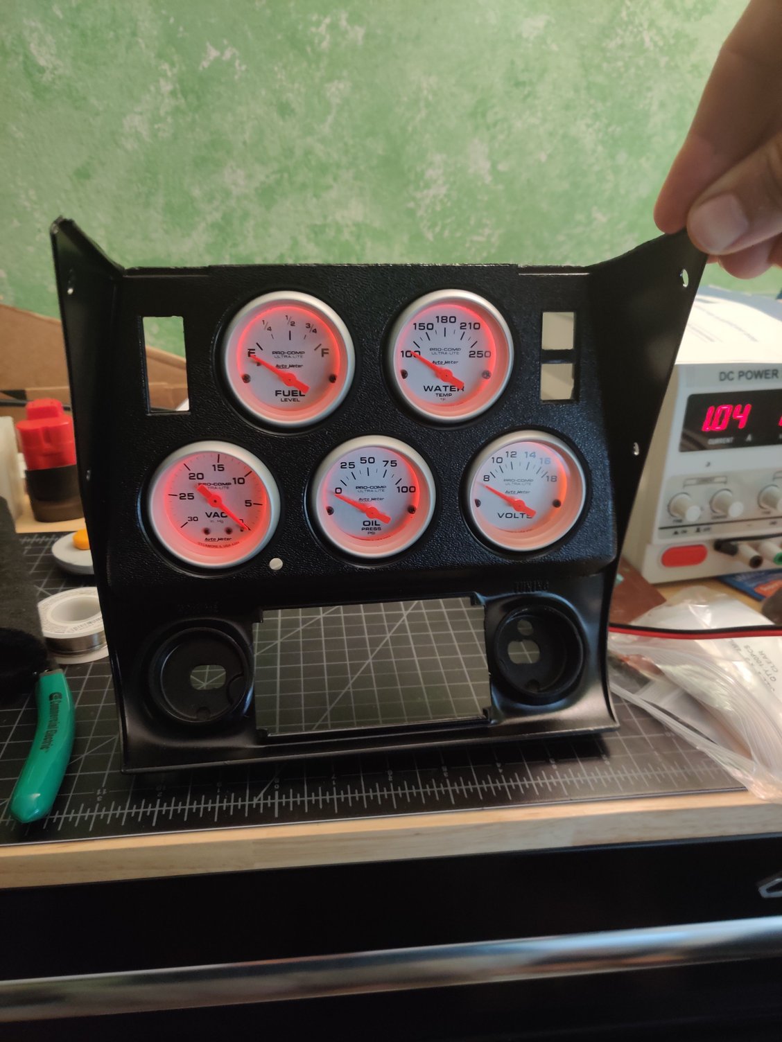

Time for some new gauges
Autometer Ultralites

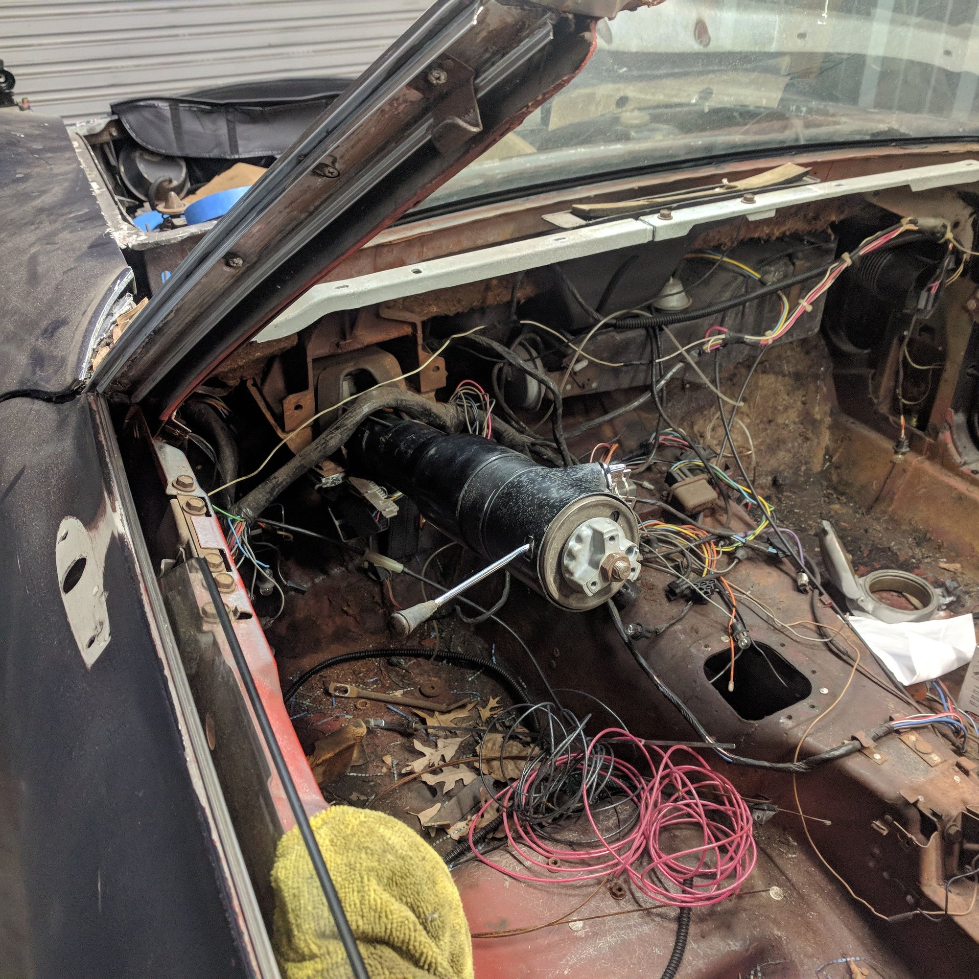

Old Sep 8, 2020 | 10:49 PM
LINY Kevin's Avatar
LINY Kevin
Joined: Feb 2017
Posts: 75
Likes: 16
From: Holtsville NY

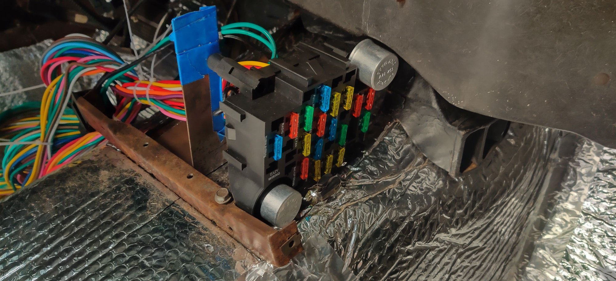

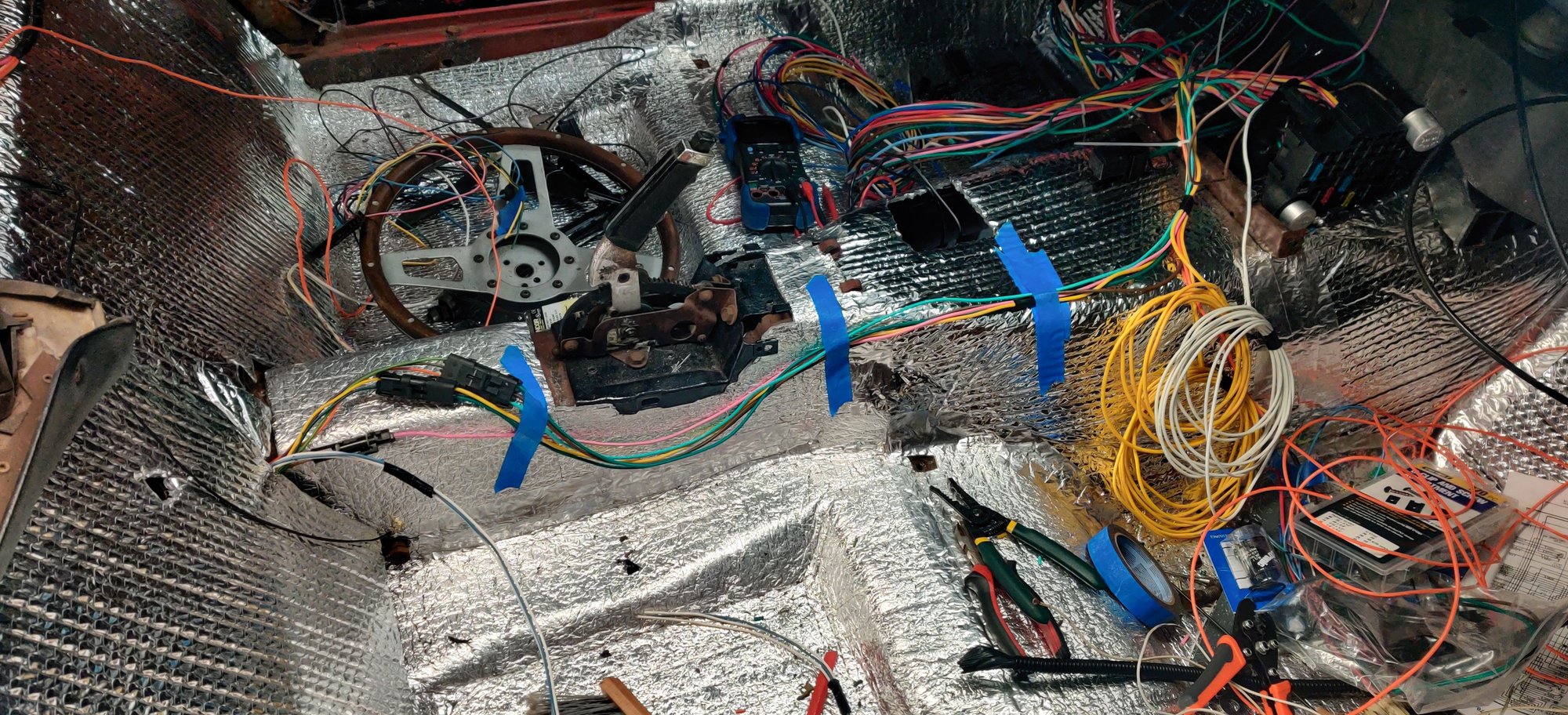

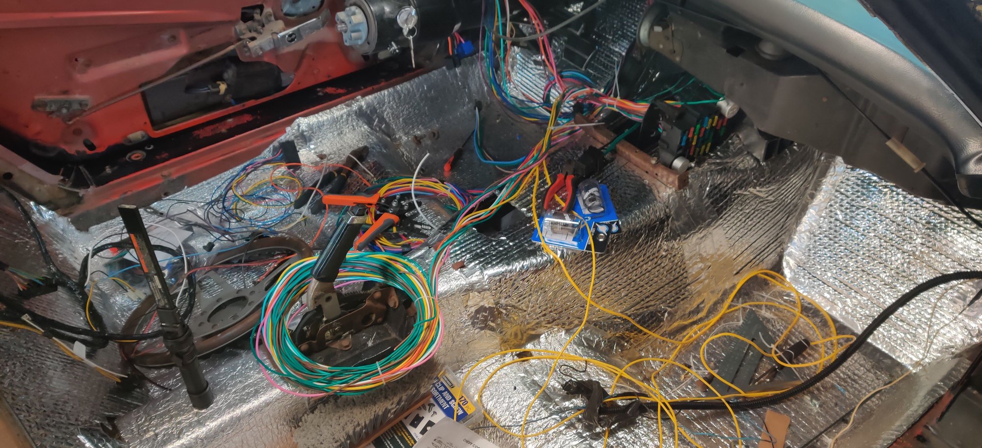

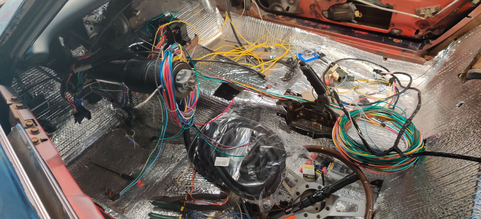

Getting ready for the custom wire harness. Looking like a car almost.
Bracket for fuse block
Routing some wire.

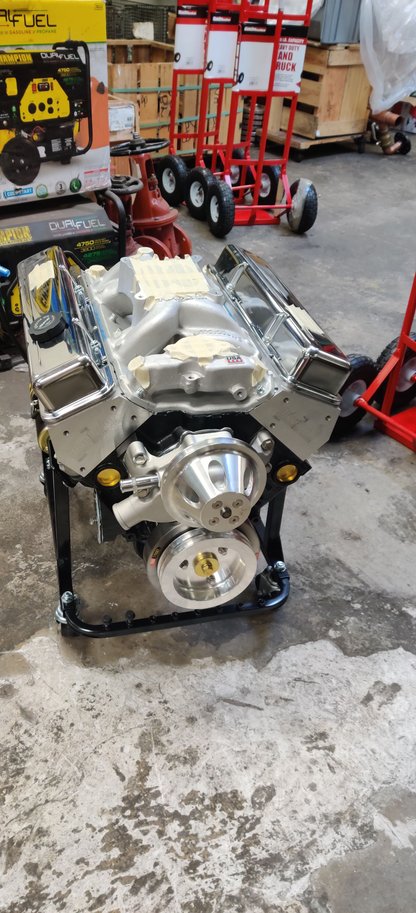

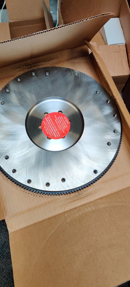

Engine arrived
Along with some other parts
