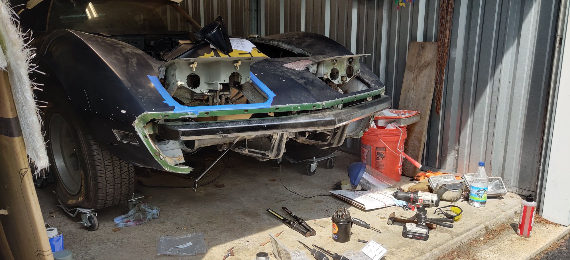

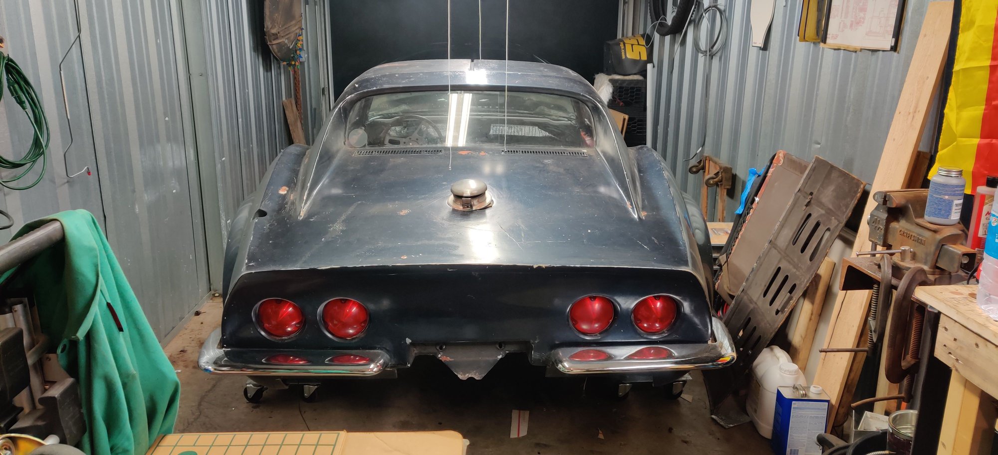

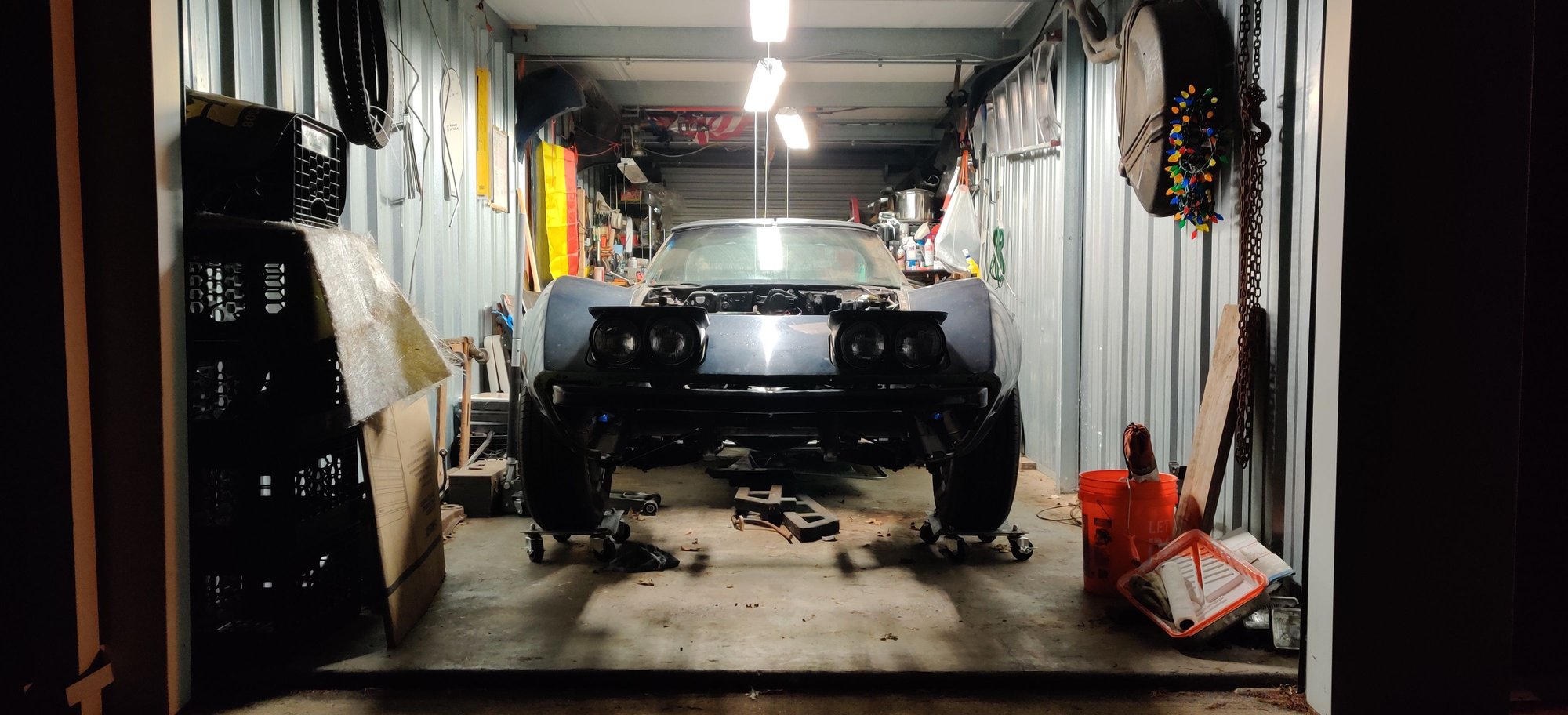

Removing the square headlights. This headlight project took longer then I'd like to admit. Took a few hours a day for a good 2 weeks. All the hardware pretty much snapped off and a lot of drilling and tapping took place.
But it was worth it. I like the round headlight look.
Same with the tail lights. Lots of cleaning and snapped studs.

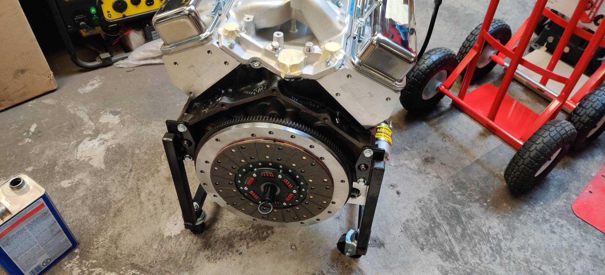

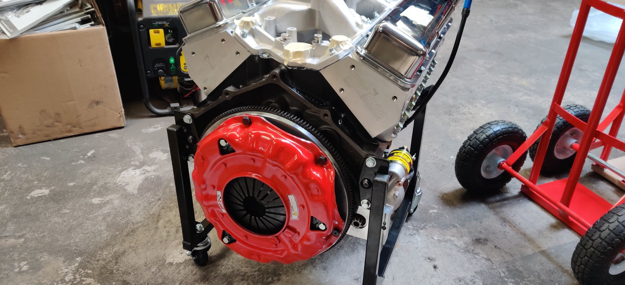

Flywheel and pressure plate installed.

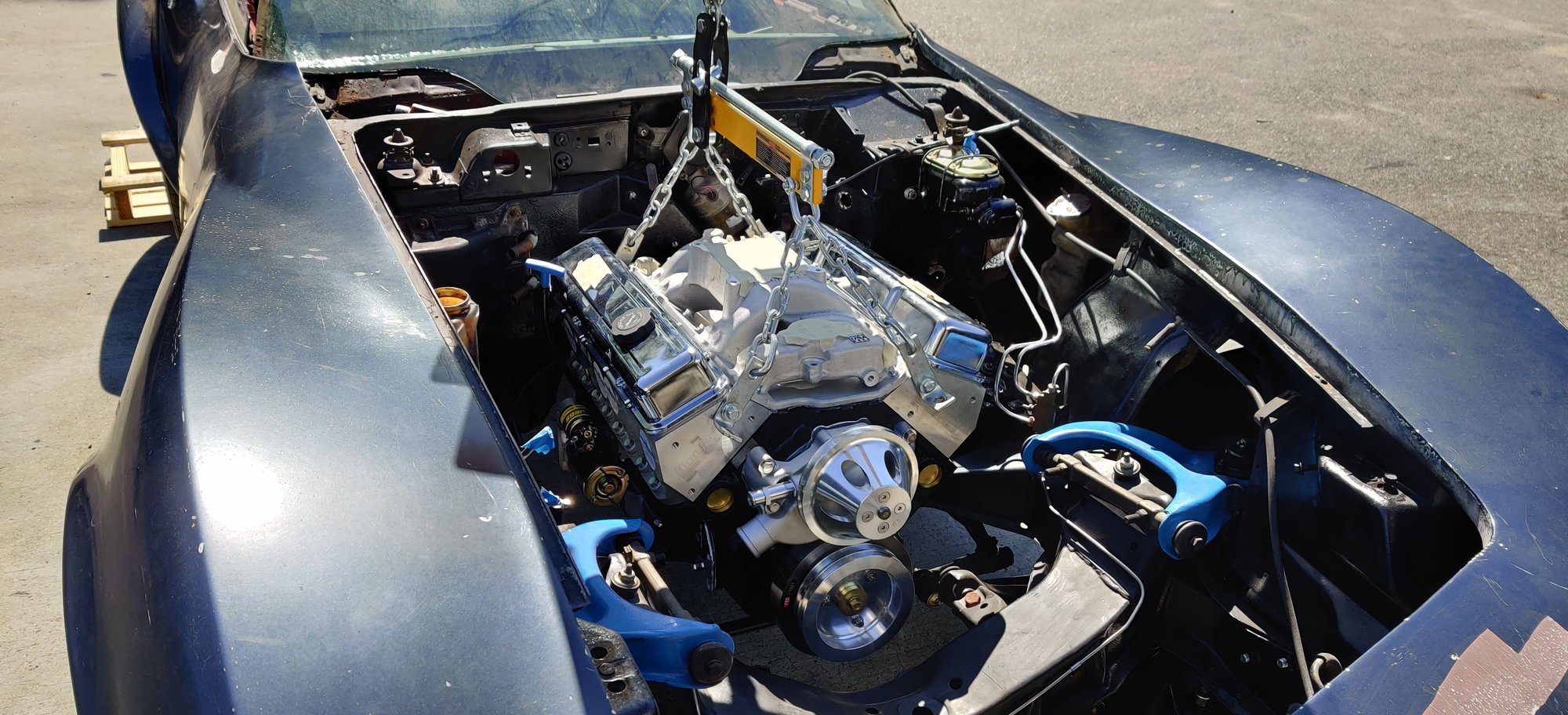

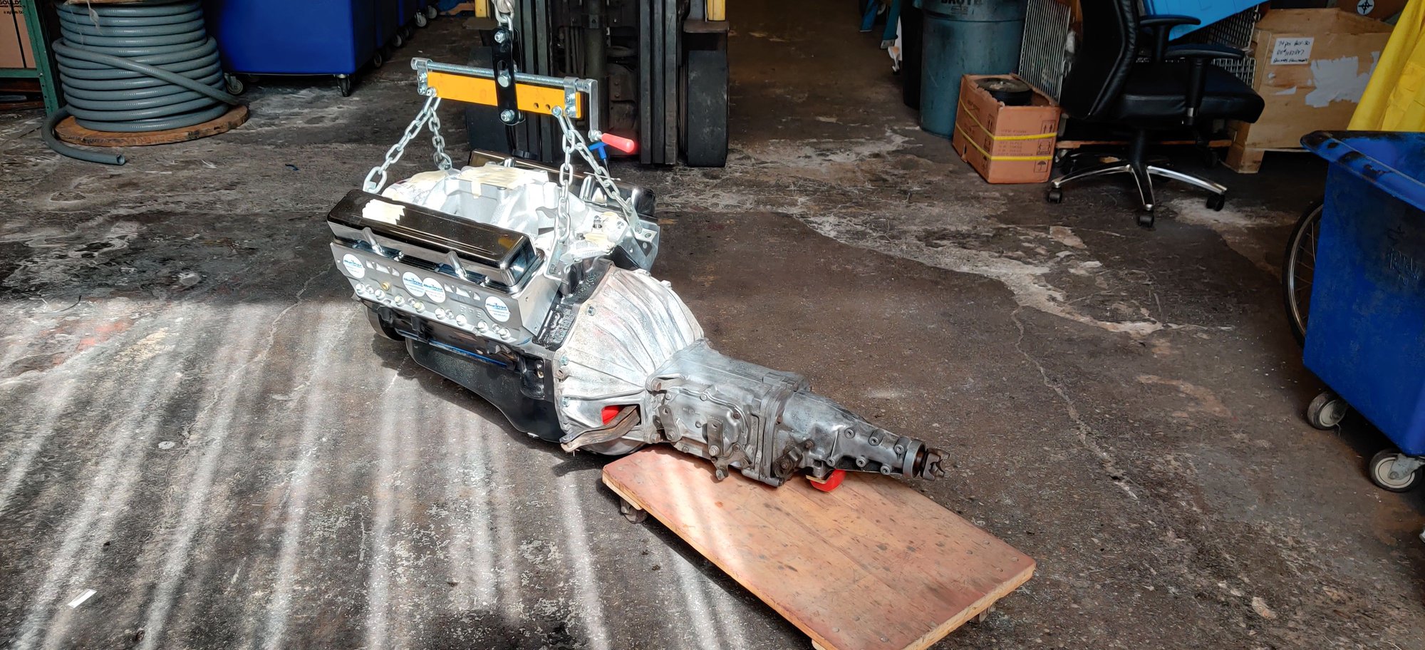

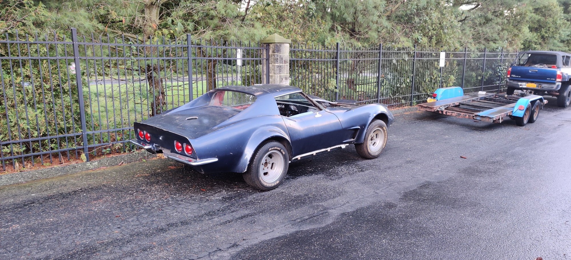

Tomorrow is the big day. Getting it's heart
Loading up again
Fork lift made this easy
Back home

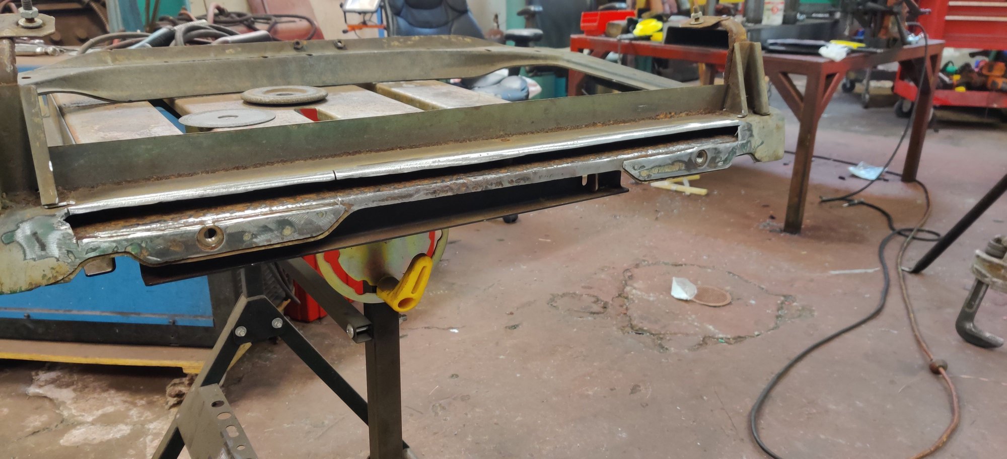

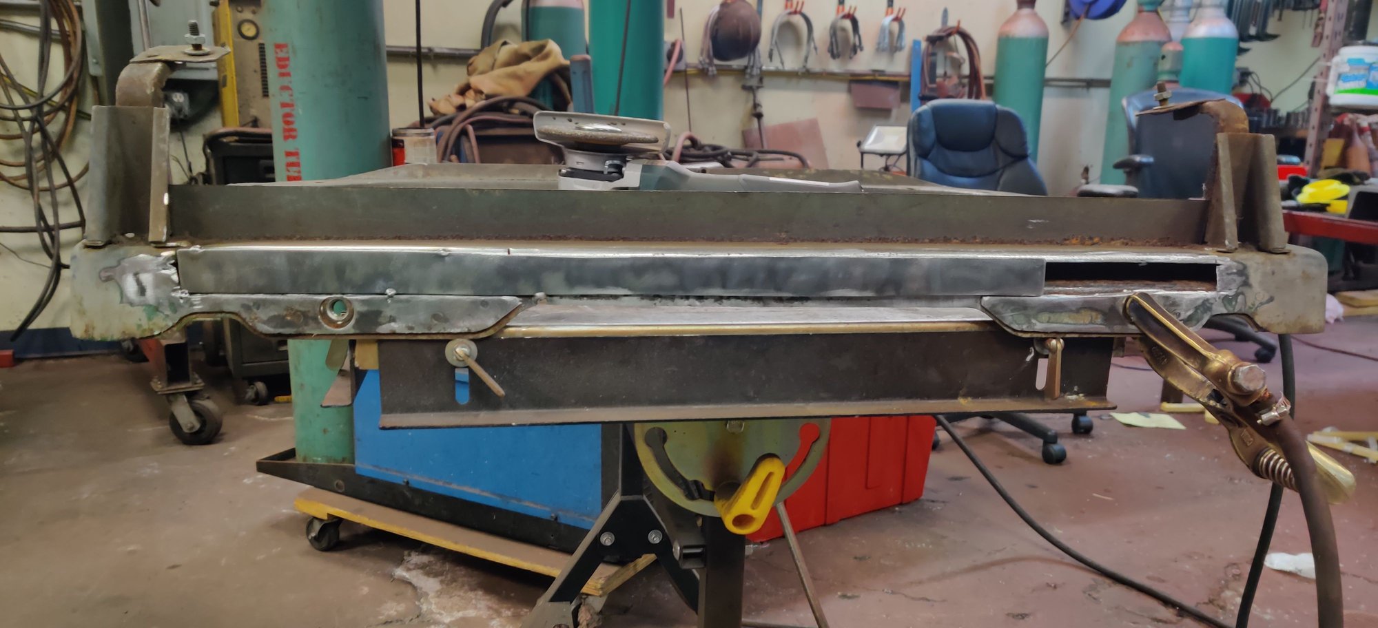

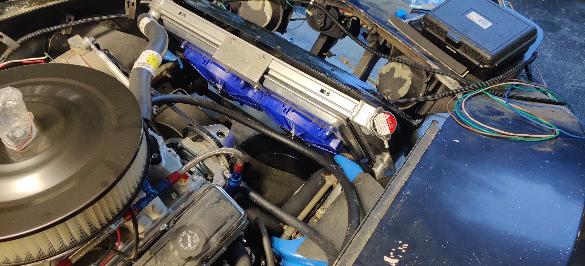

Inside rot

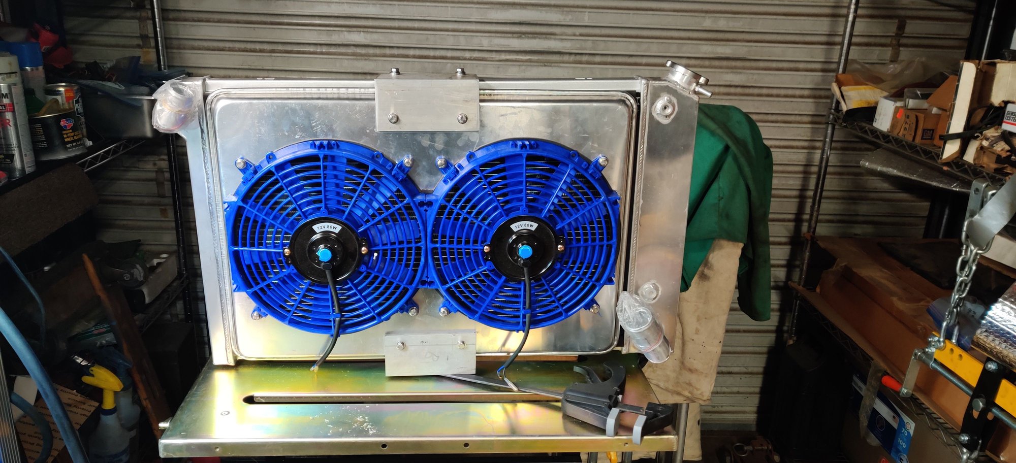

Clean it up. Notes to build a replacement at a later date

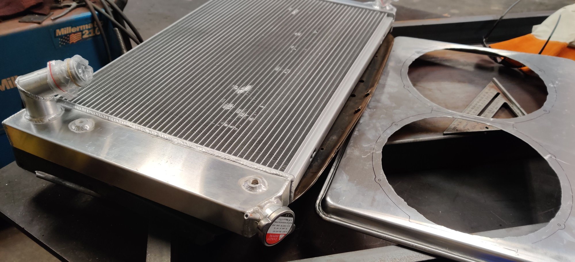

Baking sheet radiator fan shroud

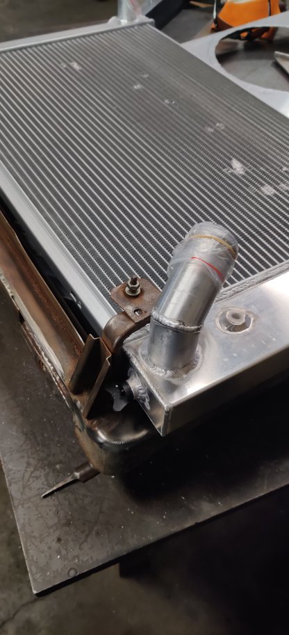

Relocate brackets as I purchased the wrong year radiator 2 years ago
Some paint

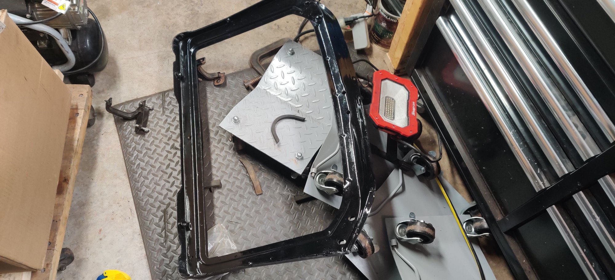

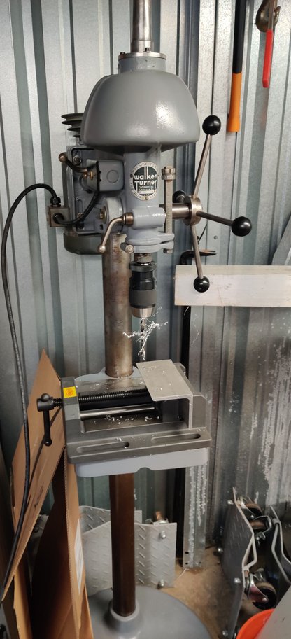

Time to make some brackets on the restored drill press

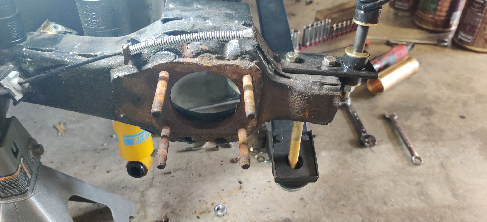

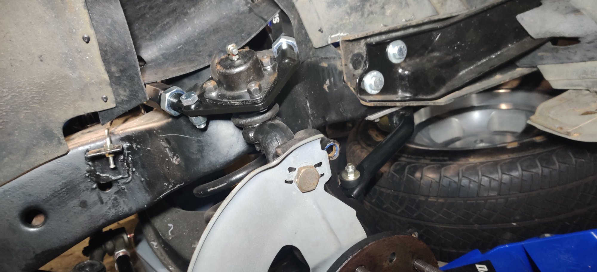

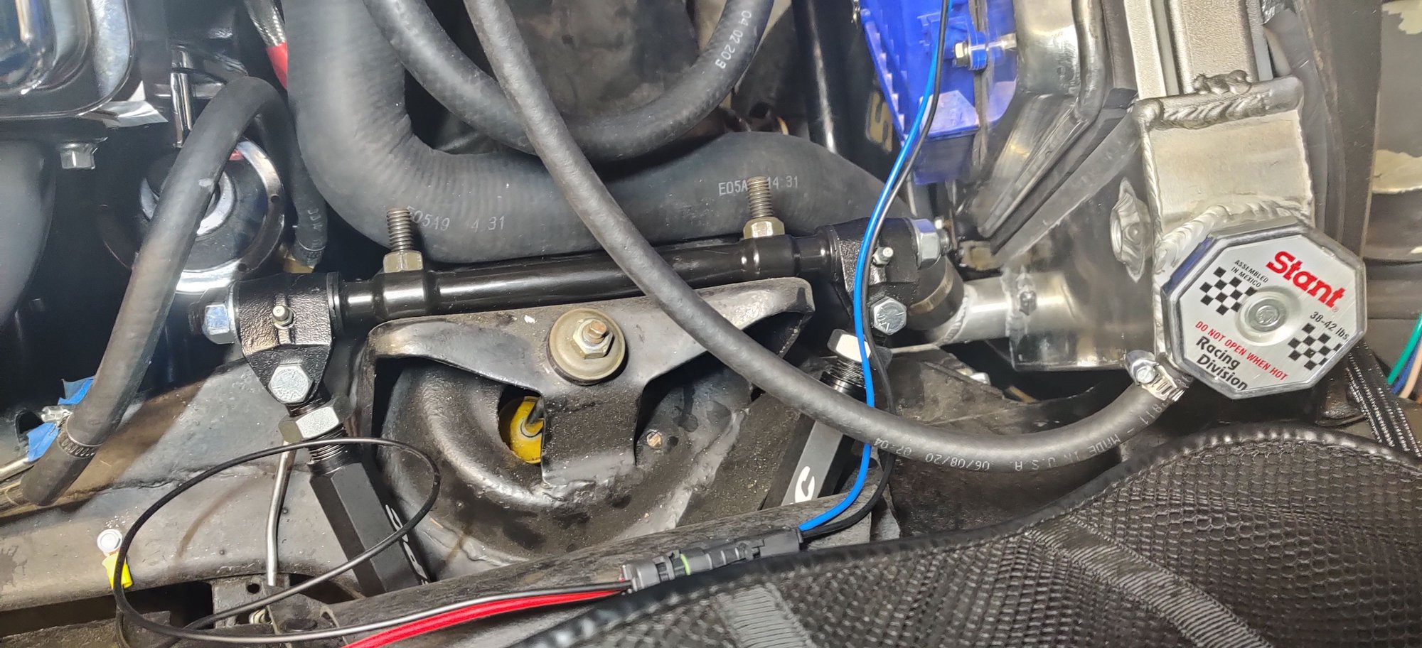

Jumping to present time. I have tons of other photos that build up to the point I'm at now, but I think it's best if I pick up here. Installing the SPC UCAs. Seem to be going in easy. Pulled the new Moog BJs from the original uppers I built a few years ago. Funny that I don't even have a mile on them yet and I'm pulling them apart to upgrade. I'm starting to wonder what the advantage is of the longer ball joint and if I should use them instead of the stock length ones.
Boot seems to squish a bit at full droop. But I don't hit the frame with the control arm using stock length Bilstein shocks. I'll have to make note if I decide to go with adjustable coil overs later on.

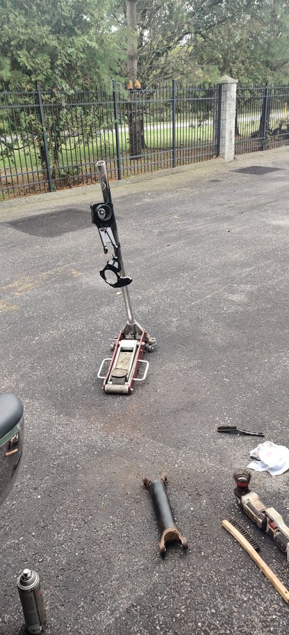

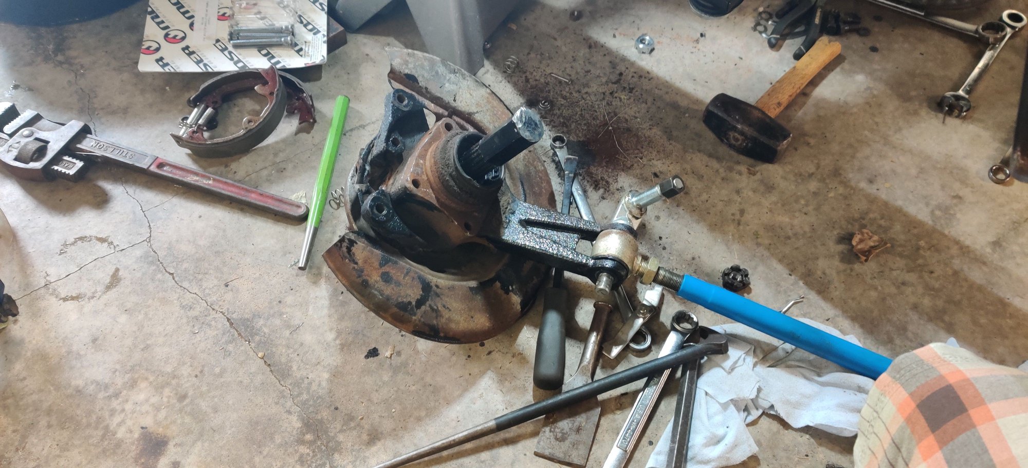

Starting to rebuild the rear wheel bearings. I didn't believe the stories I heard of how difficult they are to remove. I'm a believer now. Look at the wear on that race. I'm wondering if Maybe the castle nut wasn't torqued to the correct setting. The nut seemed to come off easier then expected.

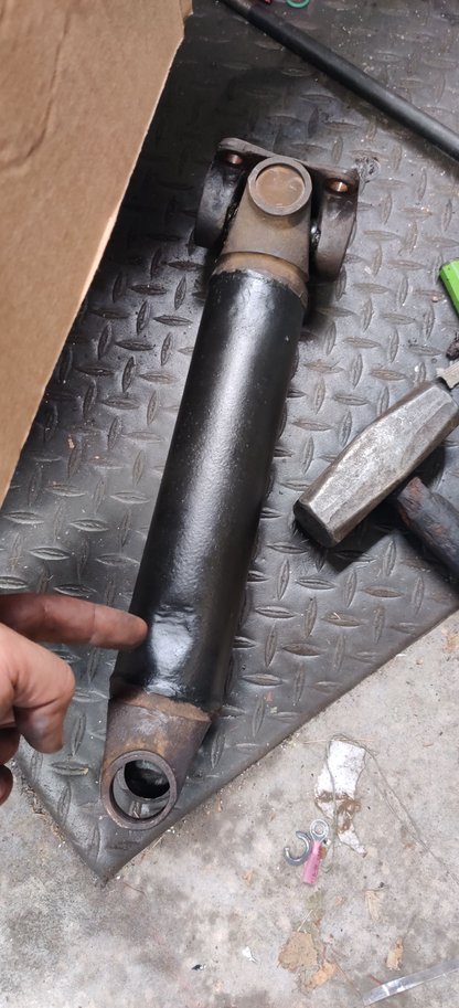

Driveshaft. Huge dent. Debating if I should just replace the ujoints and run it or maybe upgrade to something better/stronger. I did get my safety loops in just as a precaution. Can't wait to get it all back together.
