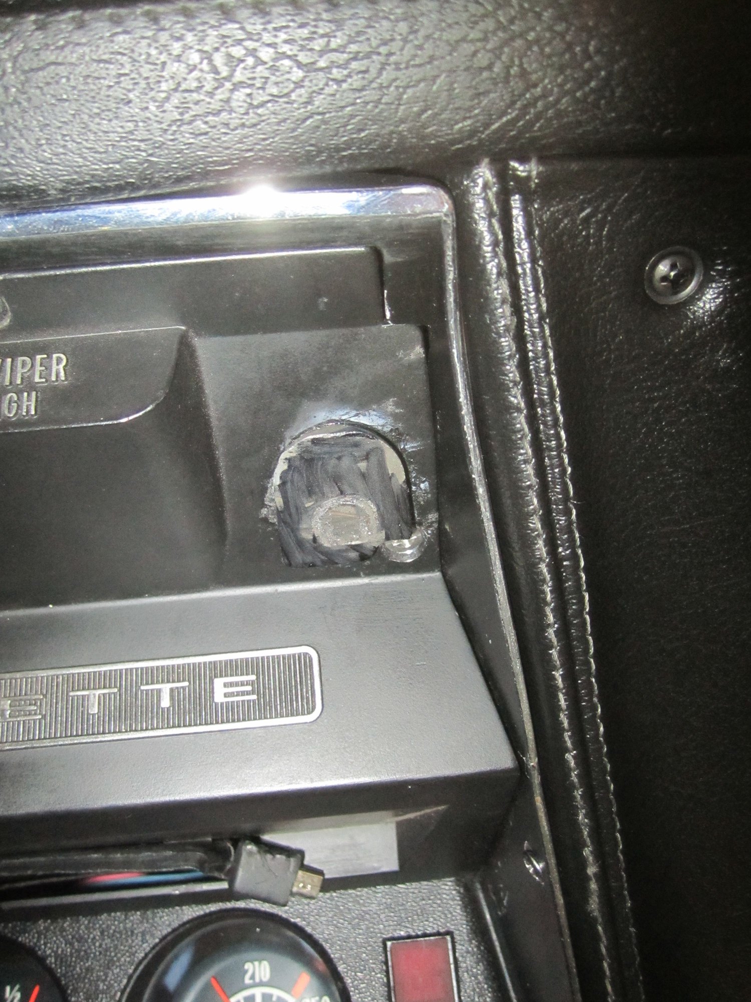

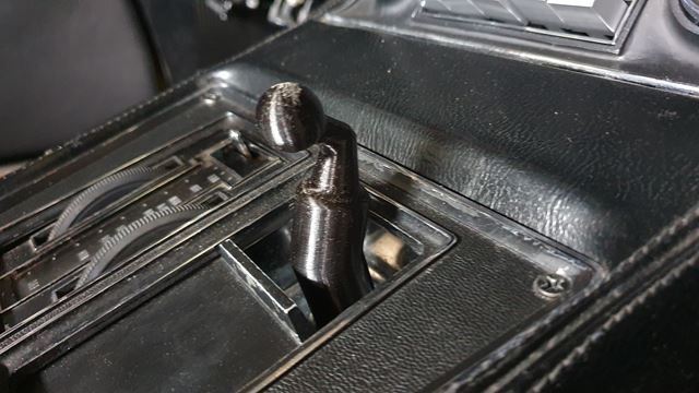

Don't know if this helps at all (I don't use a cell) but I used a windshield mounted mirror setup to create a mount for my small GPS.
Super-glued the part that would be on the glass to the underside of the wiper switch plate, had to clean the paint off in that area, this is the mock-up. 4 years now and it's never come off yet
Here's the part from the mirror, ground down the ball end that would be attached to the mirror swivel to pop into the GPS holder
Works, up where it's visible and doesn't block any gauges
Originally I just snugged up the screw and I could loosen it and slip it off the mount when i wanted to but later on I drilled and epoxied two rare-earth magnets, one on the mount (you can see it in the first picture) and the other in the arm, that way they snap in place firmly but I can remove it without loosening the screw
With it removed you can't see the mount from outside the car to speak of
Anyway, something along these lines might be possible?

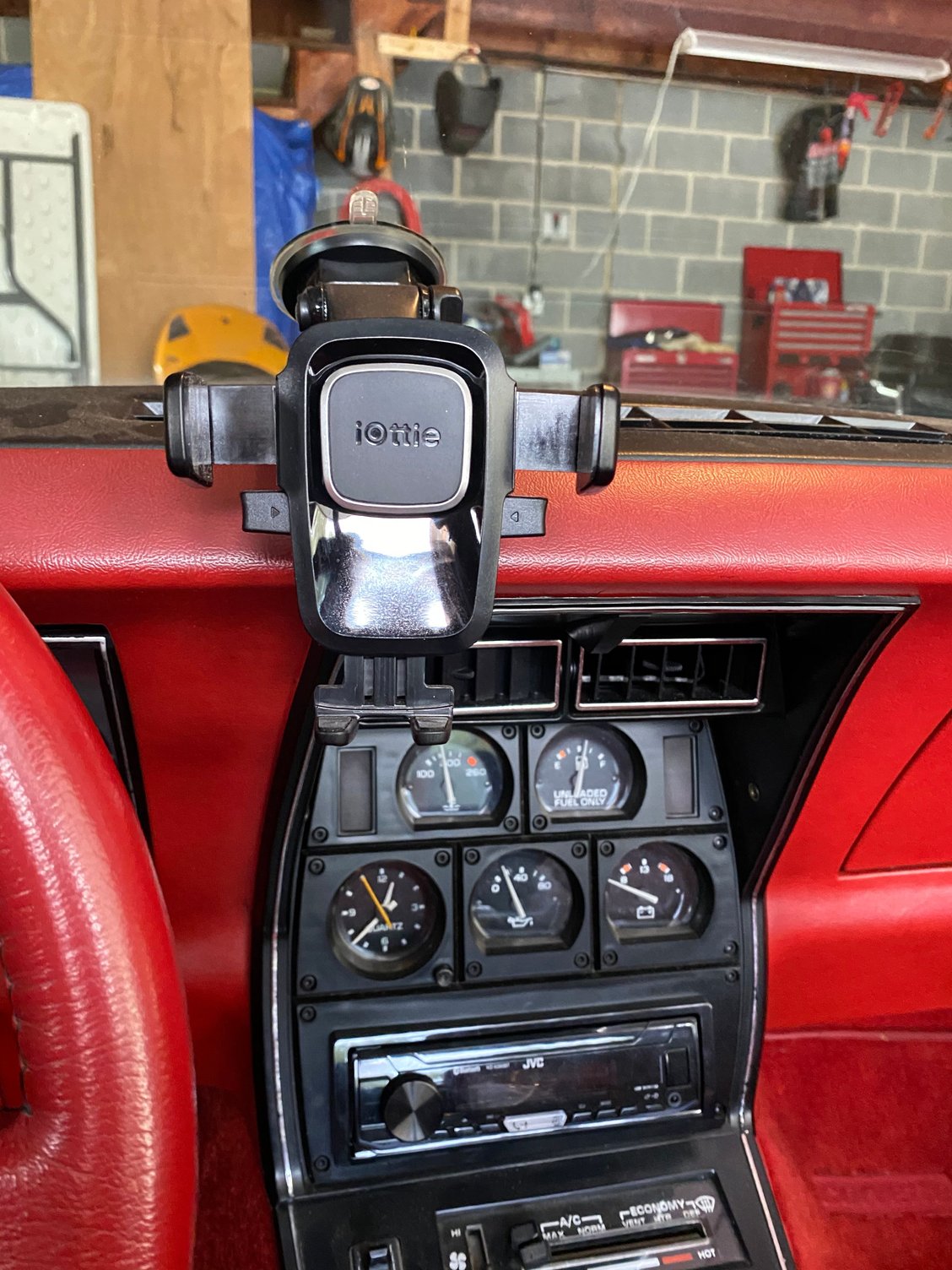

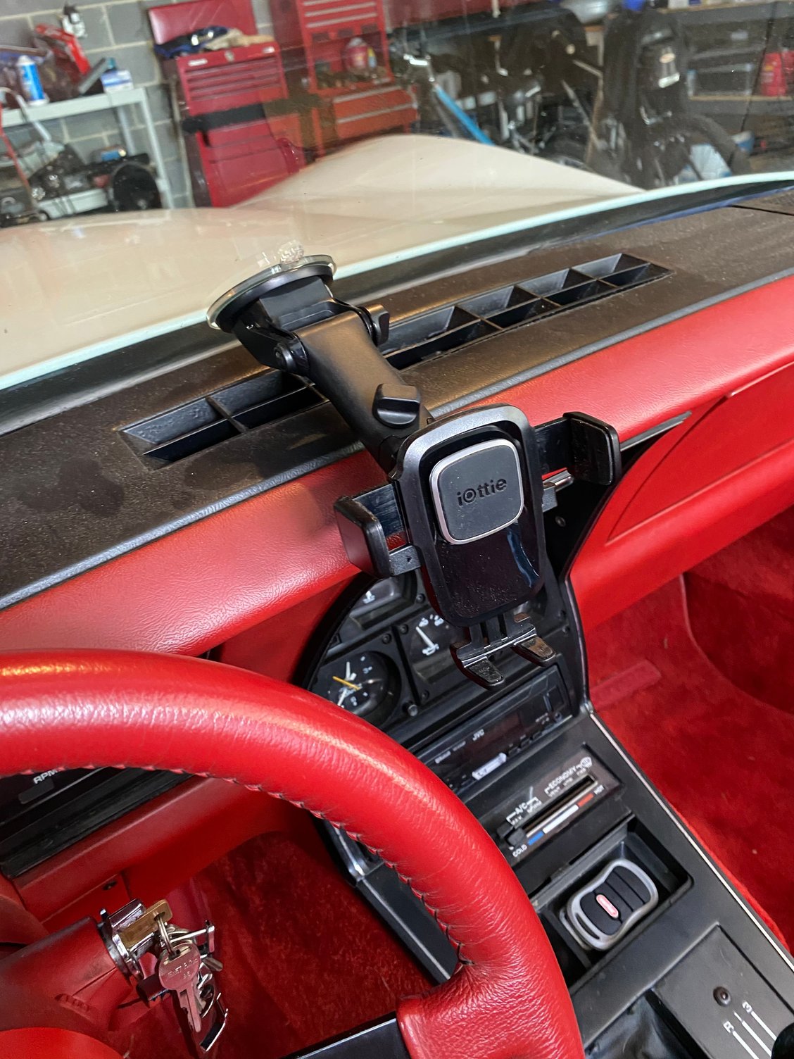

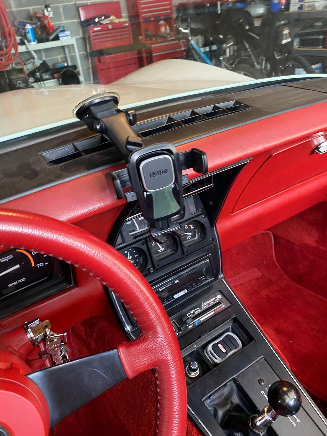

https://www.amazon.com/iOttie-Dashboard-Windshield-Samsung-Smartphone/dp/B076B27WP6/ref=mp_s_a_1_1?dchild=1&keywords=Ottie+Easy+One+Touch+4+Dash+%26+Windshield+Car+Mount+Phone+Holder+Desk+Stand+Pad+%26+Mat+for+iPhone%2C+Samsung%2C+Moto%2C+Huawei%2C+Nokia%2C+LG%2C+Smartphones&qid=1600347211&sr=8-1 https://www.amazon.com/iOttie-Dashboard-Windshield-Samsung-Smartphone/dp/B076B27WP6/ref=mp_s_a_1_1?dchild=1&keywords=Ottie+Easy+One+Touch+4+Dash+%26+Windshield+Car+Mount+Phone+Holder+Desk+Stand+Pad+%26+Mat+for+iPhone%2C+Samsung%2C+Moto%2C+Huawei%2C+Nokia%2C+LG%2C+Smartphones&qid=1600347211&sr=8-1
I use this one in my Vette and all my other vehicles. It suction cups right to the windshield. I will get a pic when I go back out and send it to you.

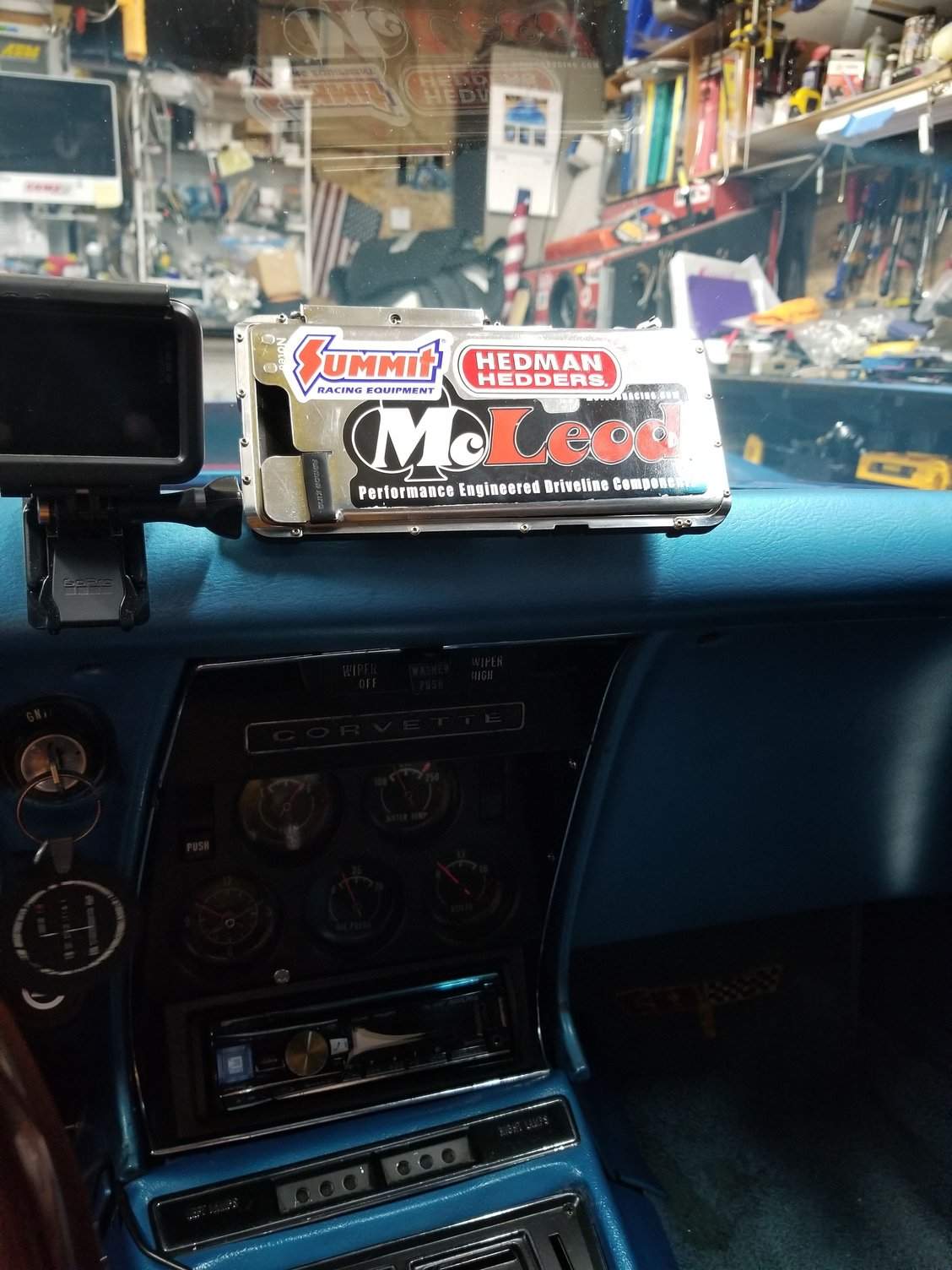

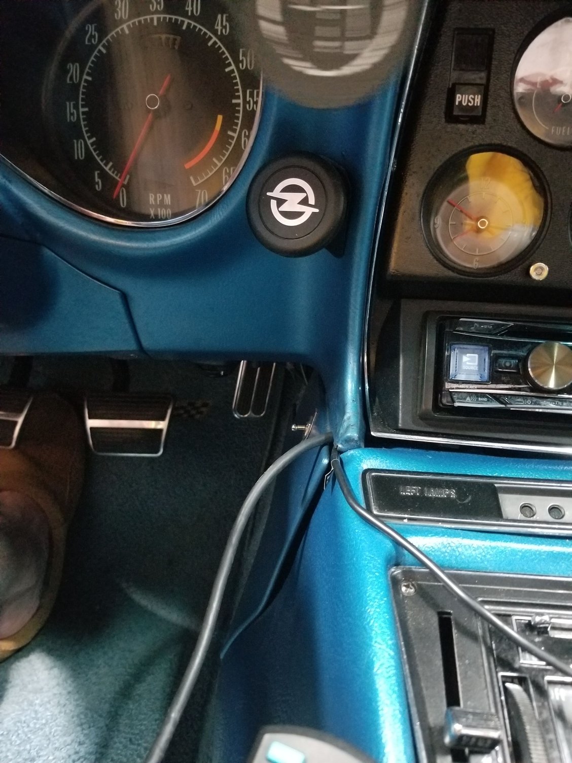

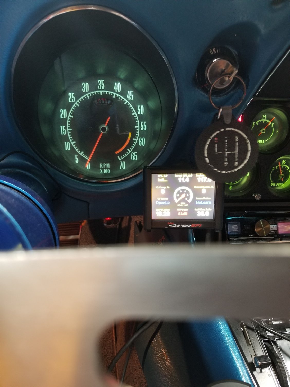

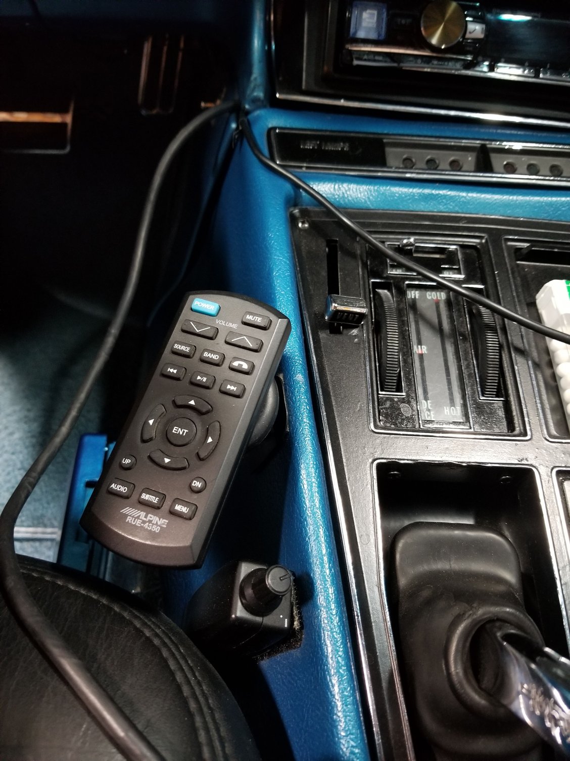

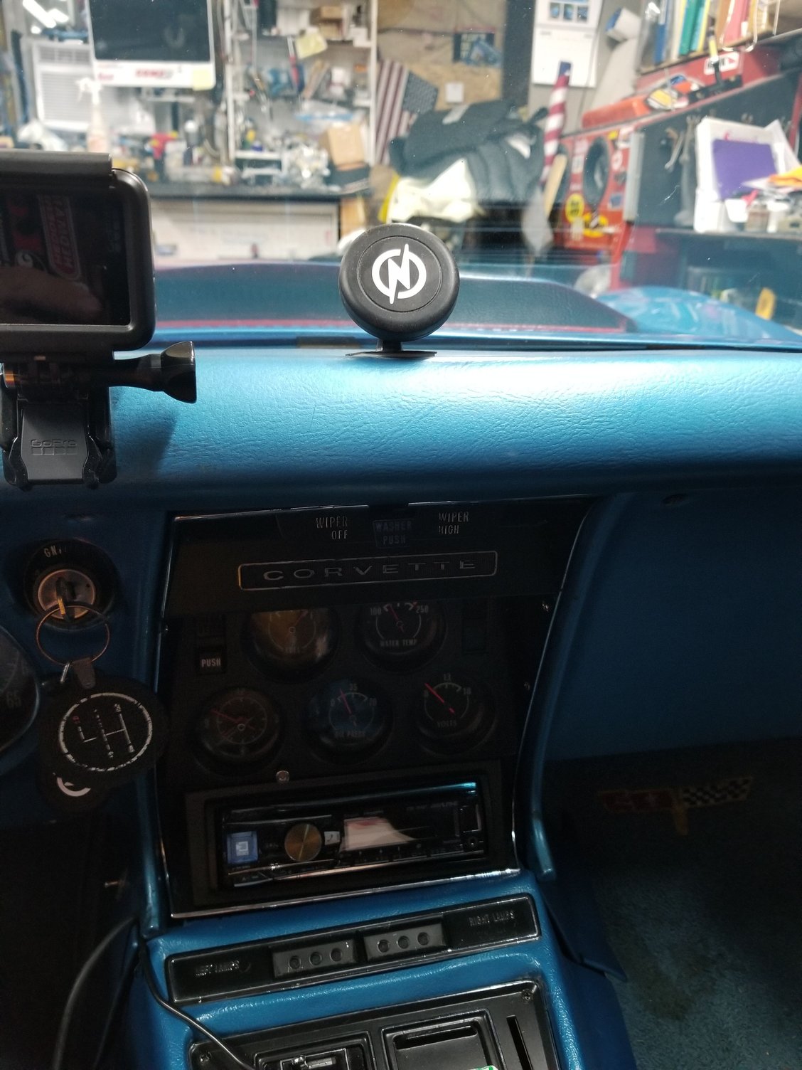

I have a magne mount that is double sided taped to the top of the dash so I can use my maps function. I have a second one buy my leg for my stereo remote and a third I just added below the ignition on the dash that I have my Sniper touch screen on. And they are all interchangeable so I can put my phone down low when Im concentrating on my tune and just using the phone for music

Here are a couple pics of what I use

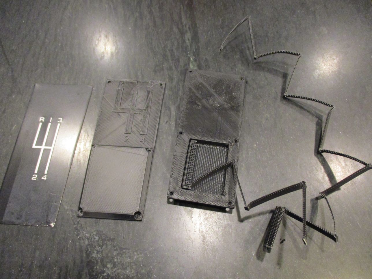

I 3D printed a new shift pattern plate, and embeded some magnets into it, then I have a thin piece of steel that goes between the phone and the case. Here's a previous prototype from when I was experimenting with fonts. This exact pattern will only work with a 77-82.

It comes with some extra tape and extra steel plates
