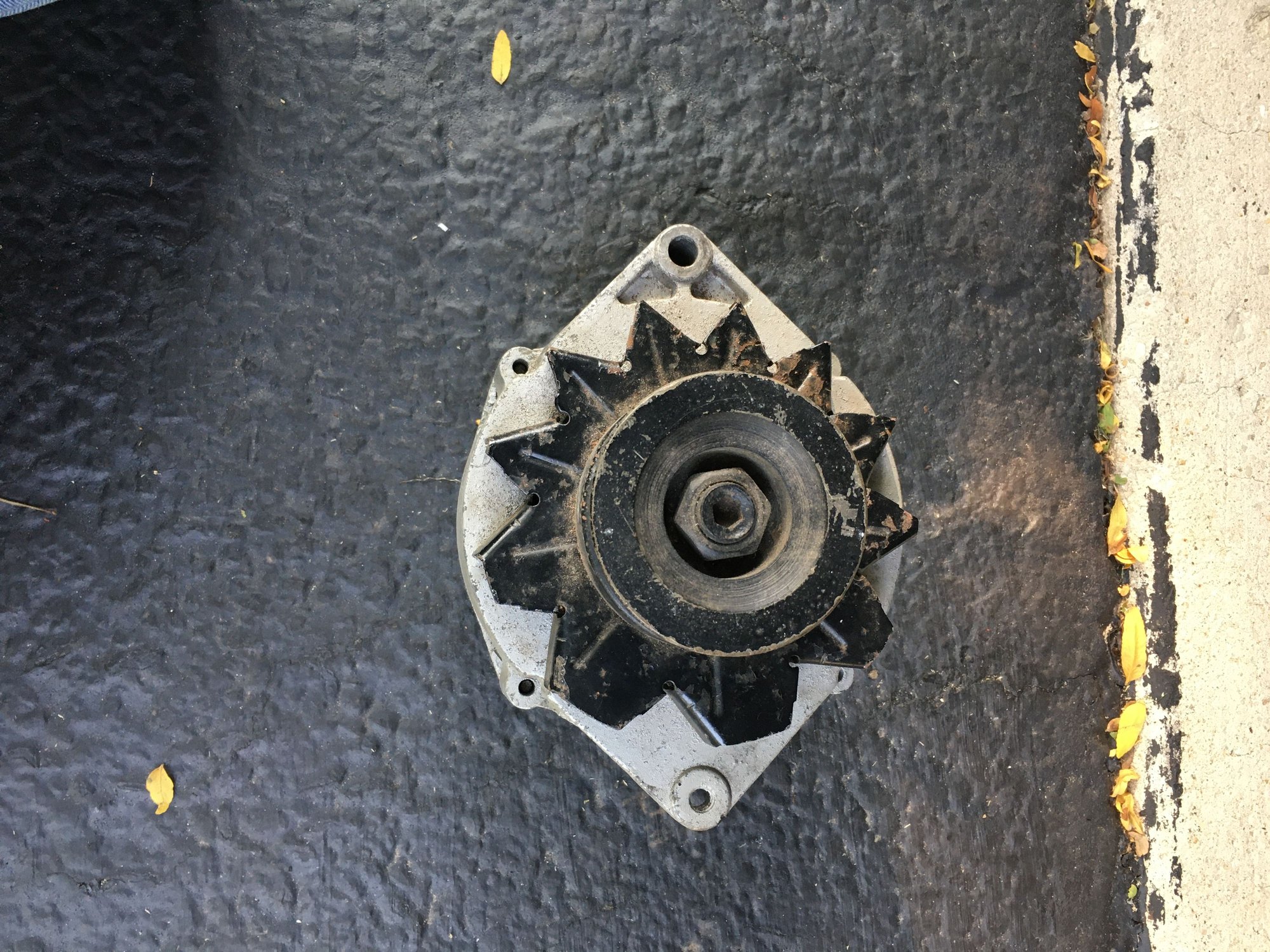

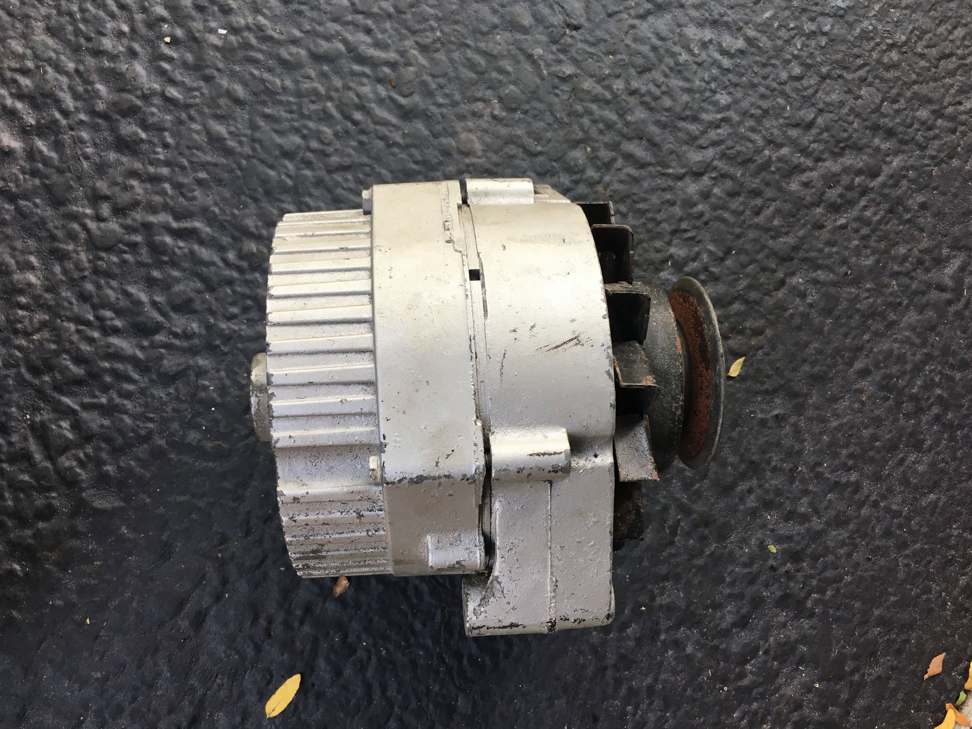

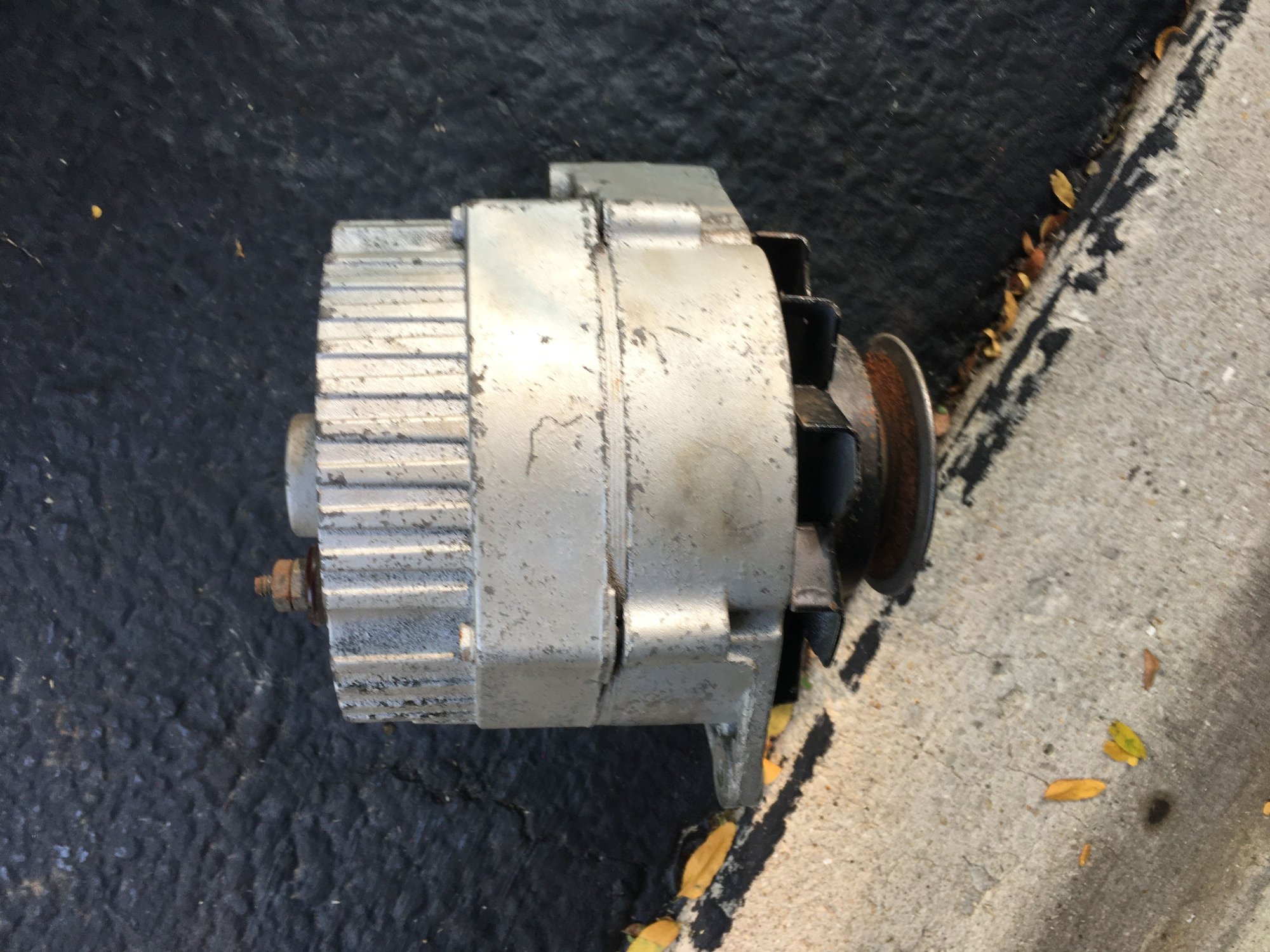

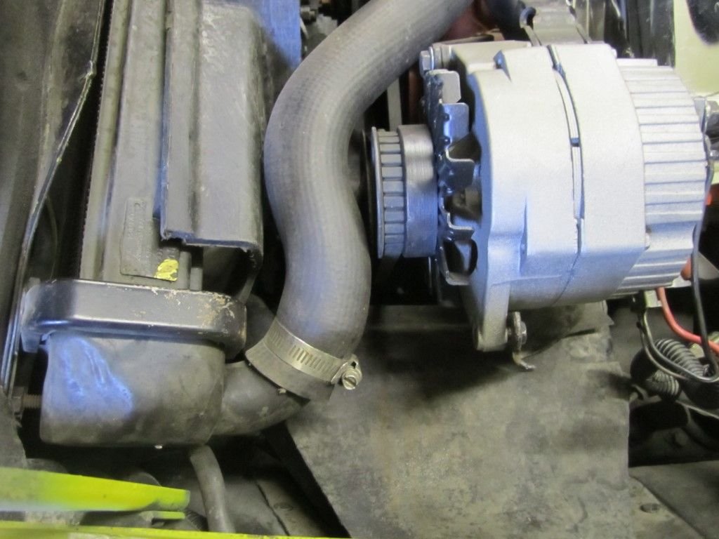

Hello:
I am looking to try to identify a alternator which I believe to be from my 1969 427/390 Corvette. The car was sitting disassembled in my Dad's garage for years and I am in the process of getting back on the road. I was at a alternator shop and showed it to the counter guy and he says he believes it is from a Corvette but doesn't believe it has a Corvette pulley. I was hoping someone here can help identify it. I plan on putting a higher amperage unit in the car put want to use the original pulley system.
Thanks
Tom

FWIW, Pulley actually looks right, should be about the length of a two groove one but missing the rear groove since there was some weird belt routing

I see no numbers stamped in the case. I assume it may be a over the counter replacement. The pulley doesn't look like any others I have seen posted elsewhere but I believe it is the alternator we had on the car years ago. I am trying to be sure the right pulley goes on the new alternator.

Thanks for the photo of the alternator on your car. That makes sense to me. I will mockup the brackets and pulleys to be sure of the alignment but it looks like it will work. Trying to piece this back together after all these years is challenging but this forum has been a great help!

OP, That rear casing with raised "fins" on the alternator is a good sign. Also, there is no raised "rectangle" under the Delco Remy which I think indicates a 69. With that said I think the front case should be "open". That is where the numbers are stamped.
Look REALLY close for the numbers. They may be faint. Should start with 1100***. It will also have the amps ( ie 61a) and a date code which will be a combination of a letter and numbers.
Again, It may be faint. Let us know. Good luck.

The front of the case is open so I believe you are saying the numbers should be stamped on the front of the case under the fan. The counter guy thought it was Corvette based on the fins in the back. I will look further into it. Thanks again.

Frequently they are stamped on the body just under one of the mounting lugs.
I'm not sure I've seen one with those raised fins but it's certainly outside of my (very limited) year range knowledge

I would stay with the 3 groove pulley regardless because they will line up with the pulleys as per factory. If you start trying to switch out to a 2 groove you will find things may not line up as it should and that’s not a good thing. A water pump belt breaks or slips off, car overheats, problems....
Also the Alt pulley looks just like what’s on both of my big block 69’s.
And the front part of your alternator case is not original, so the numbers, if there are any, will not be correct for the 69 L36 or any 69 corvette.

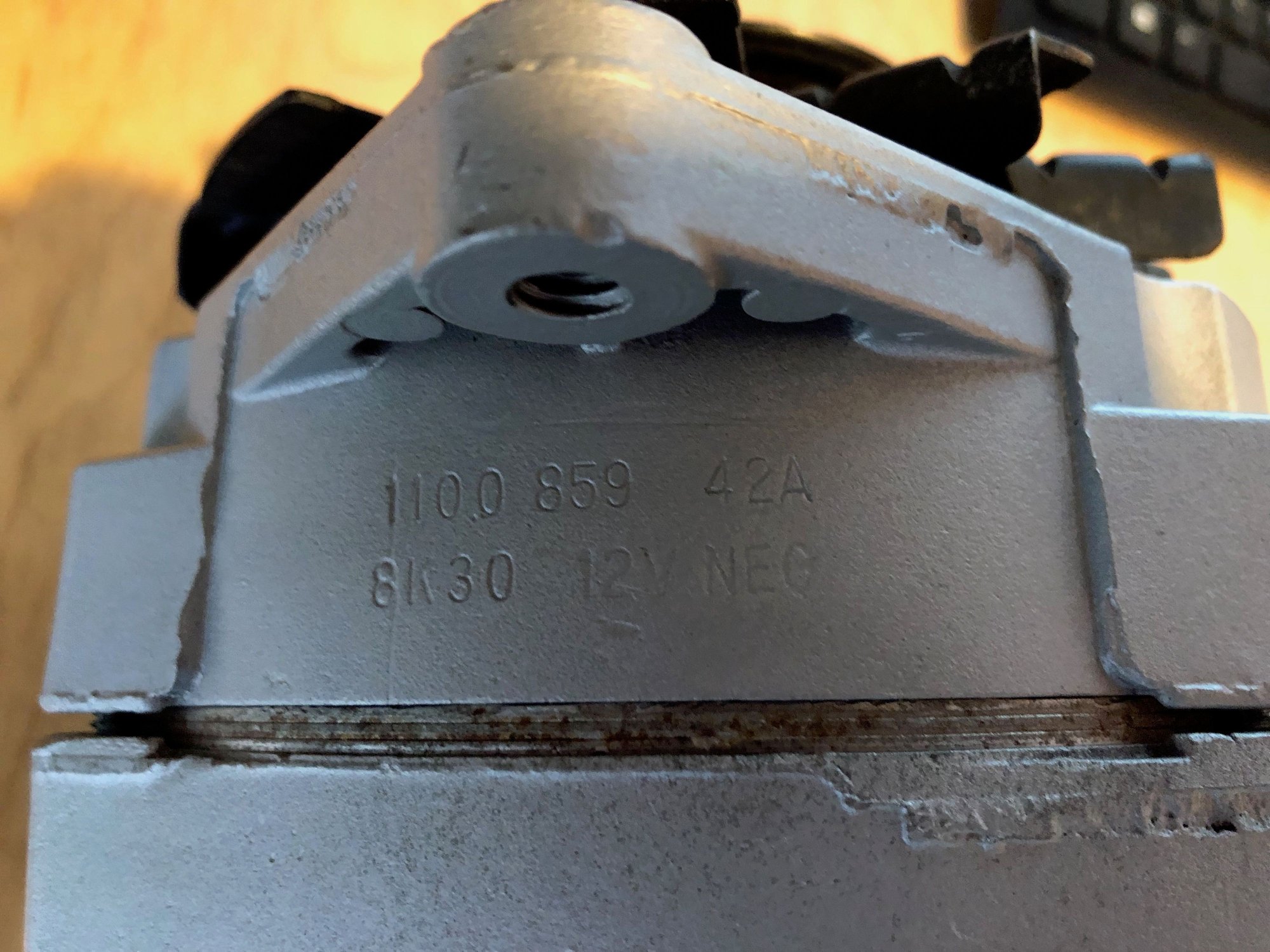

Here is an example of the stamped alternator numbers and location.
Old Sep 22, 2020 | 12:36 PM
tkucala's Avatar
tkucala
Joined: Apr 2018
Posts: 295
Likes: 46
That area on mine is blank. It was suggested that the front half of the alternator was not stock and may have been replaced at sometime. Thanks.

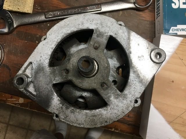

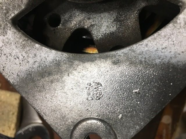

I pulled the pulley and fan off and the only markings are as pictured. Maybe it was replaced before I bought the car in 1974. Does anyone think it would be of any value to someone who is restoring a car? I would be willing to sell it for a reasonable price if so.

It has value just for the correct back case for a 1969 model year Corvette up to about Sept 69. After that the back case has a raised little box under the words Delco-Remy. There is a nice one on eBay right now that is in really nice condition with a blank repro front case for $350. You could probably get $300 for it now just for the back case. I see guys “asking” more for just the back case but I very rarely see them selling for more than $300.
