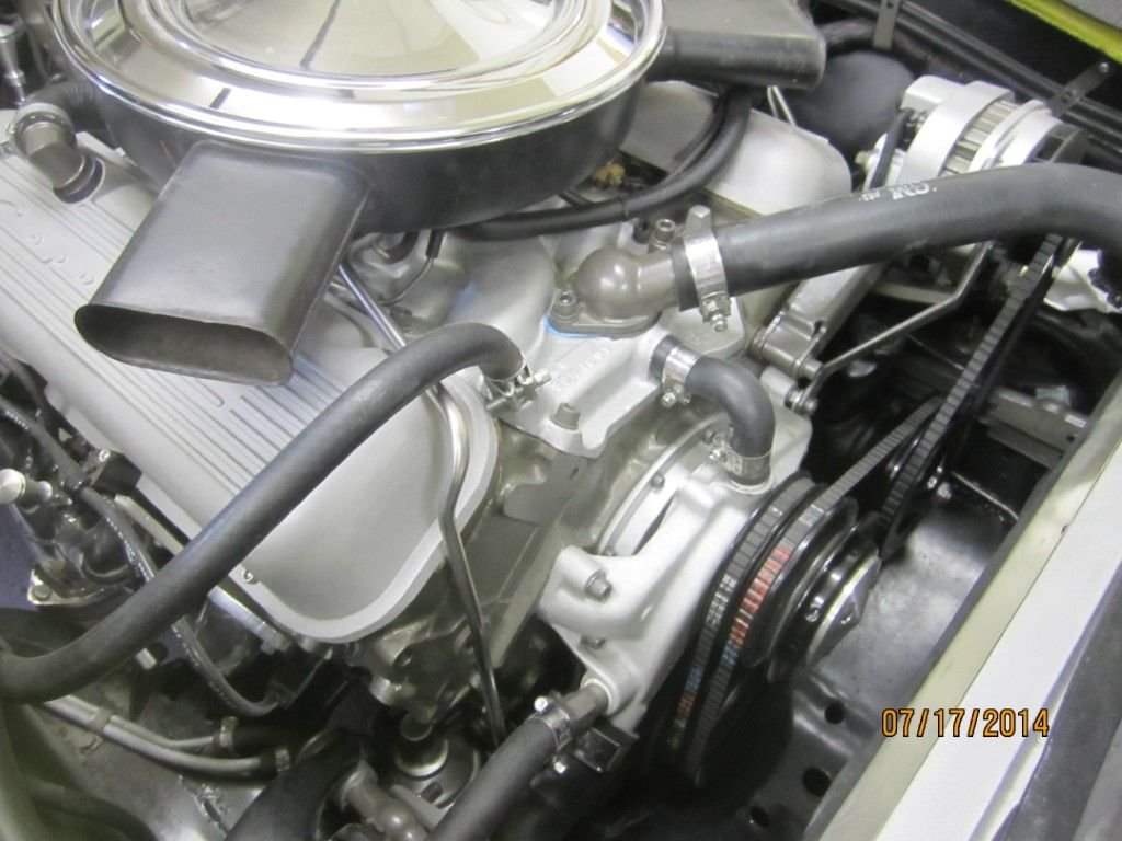

Hi All,
I was looking at the fan belt layout and it didn't seem to line up with what I am seeing in the AIM.
As per the picture I have two belts.
1) Water pump to power steering
2) water pump to crank to power steering to alternator
Is this current setup ok?

I don't know if it's different but the 72 BB would have 3 belts
One at the rear from the crank to water pump
One from the crank to the water pump to the power steering
one from the power steering up to the alt
there was another groove at the front of the water pump for the AIR pump on the passenger side as well
M

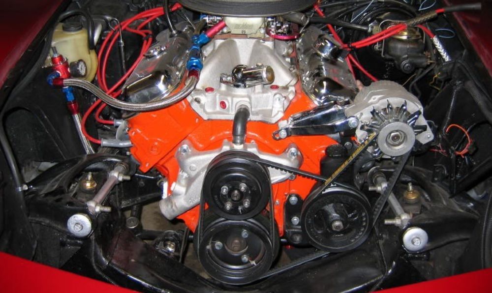

Originally Posted by NJey1985
Thanks those part numbers make life easier.
For the other two belts the power steering pulley is adjustable to initally remove the belts and then to adjust the tension afterward with the new belt?
Yes, PS first then the ALT, but there's not a lot of adjustment and the PS pump is a rear treat to loosen off to allow it to pivot.
First thing though is do you have the right pulley on the alternator? The correct one has a large blank spot between the fan part and the groove, like another groove should have been there. If someone changed the alt at some point and used a regular groove pulley then the alignment to the power steering pump will be off. Can't tell from you picture as it's behind the hose
That's a CS144 alt but it's using the stock pulley on the CS fan
M
M
Looks like I have the wrong pulley. Alternator to power steering belt will only line up with the power steering pulley groove that is toward the engine block not the 2nd groove toward the radiator side as per the pictures.
Looks like my current setup is to accomodate the aftermarket alternator with incorrect pulley on it.

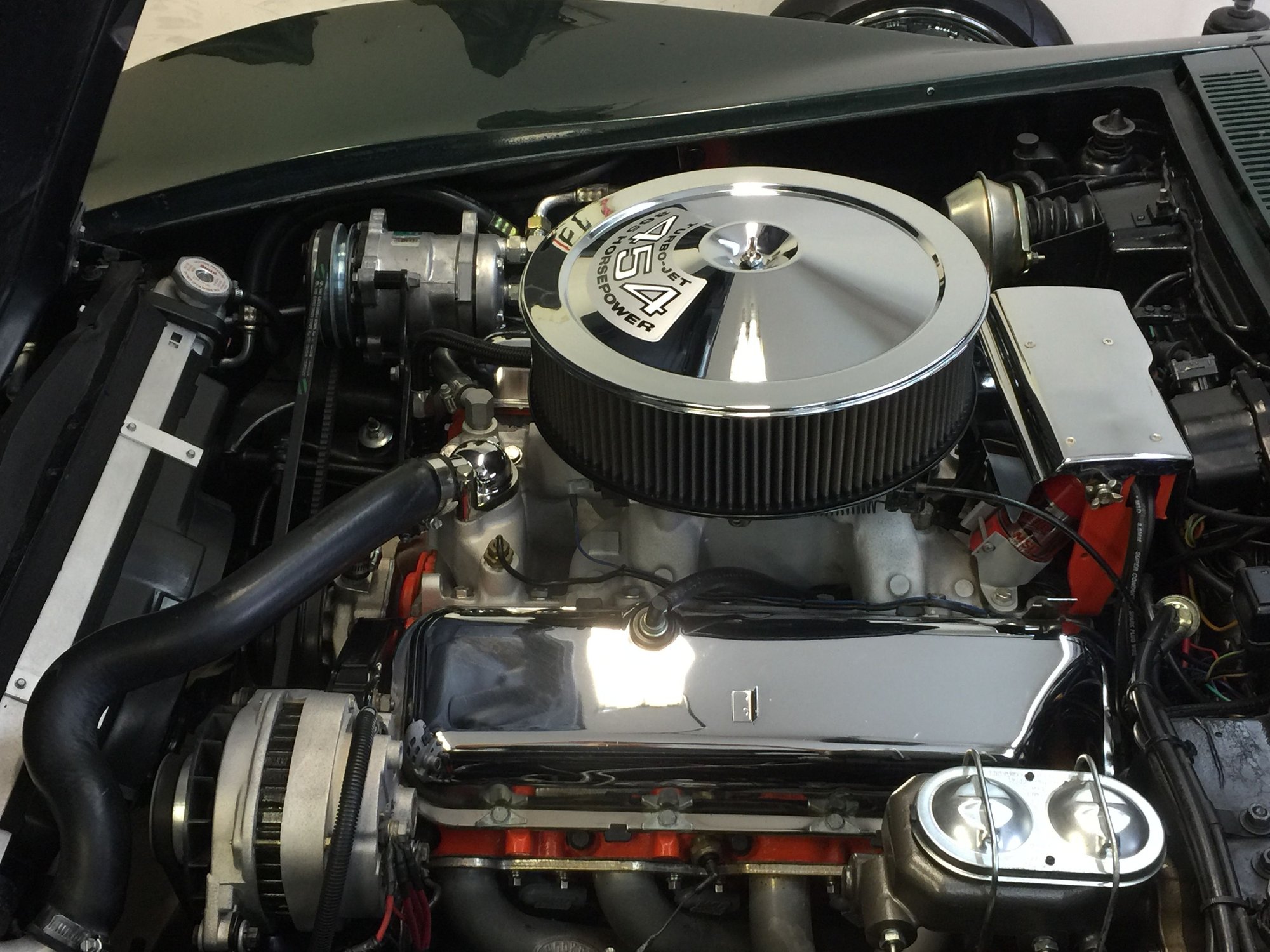

By the looks of things I am going to need a different radiator hose? I am not sure the correct alternator pulley will fit without rubbing on the hose.
Old Jun 29, 2018 | 07:06 AM
Mooser's Avatar
Mooser
Joined: Apr 2011
Posts: 11,183
Likes: 3,335
That's the correct hose and yes it's tight
You might have to turn it some or cut a bit off the end that goes to the rad to take some of the last bend out but it will work once you get everything in the right place
https://www.corvetteforum.com/forums...ator-hose.html
M
This is correct. That hose is too long, you need to take some of the bend out and it will give you clearance for the alternator pulley... Its still a little tight though.

Here is the correct hose and length, and correct alternator pulley for reference
