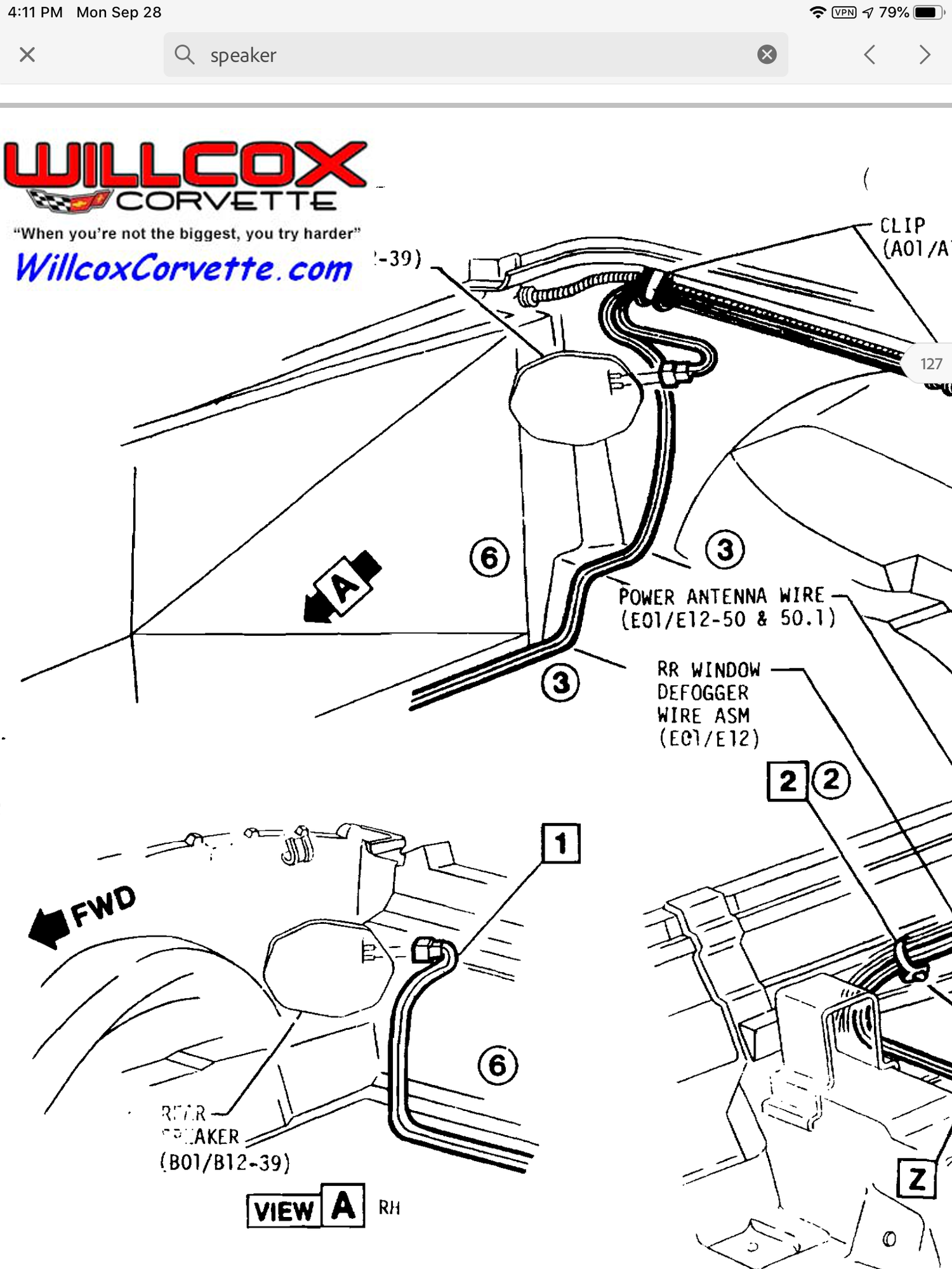

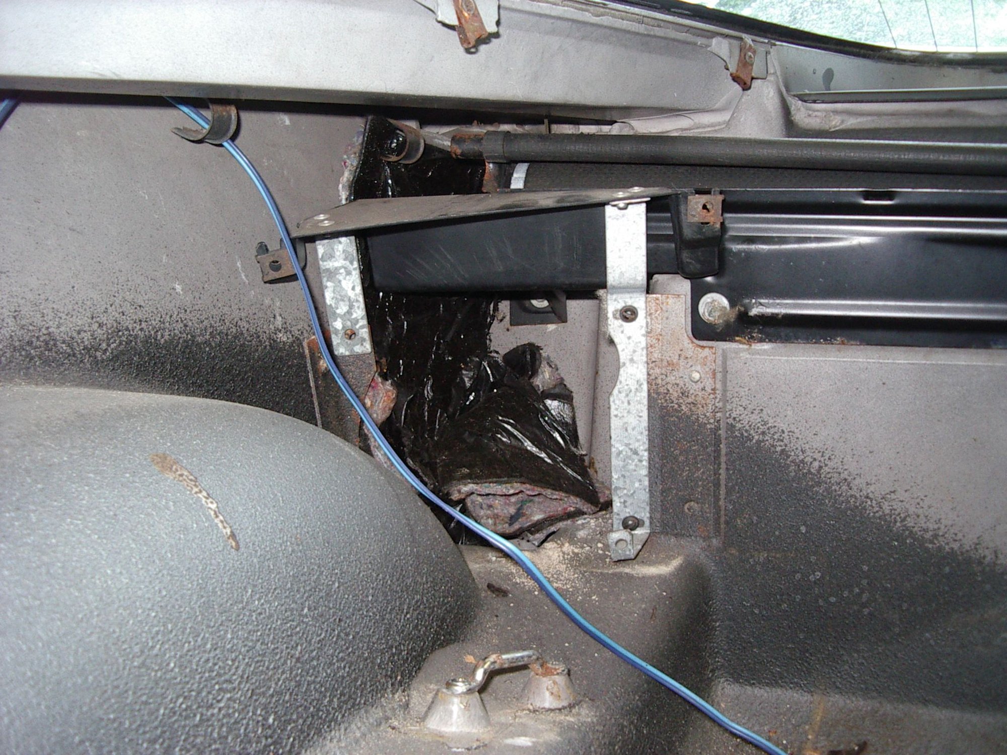

The speaker attaches to a plastic plate as in first picture and this plate attaches to the bracket in the second picture. I'm in the process of replacing the original speakers with some modern ones and I've had to cut away some of the plastic on the bracket to fit them in. It still won't line up completely so I'll have to make an infill panel and cover that in carpet.
