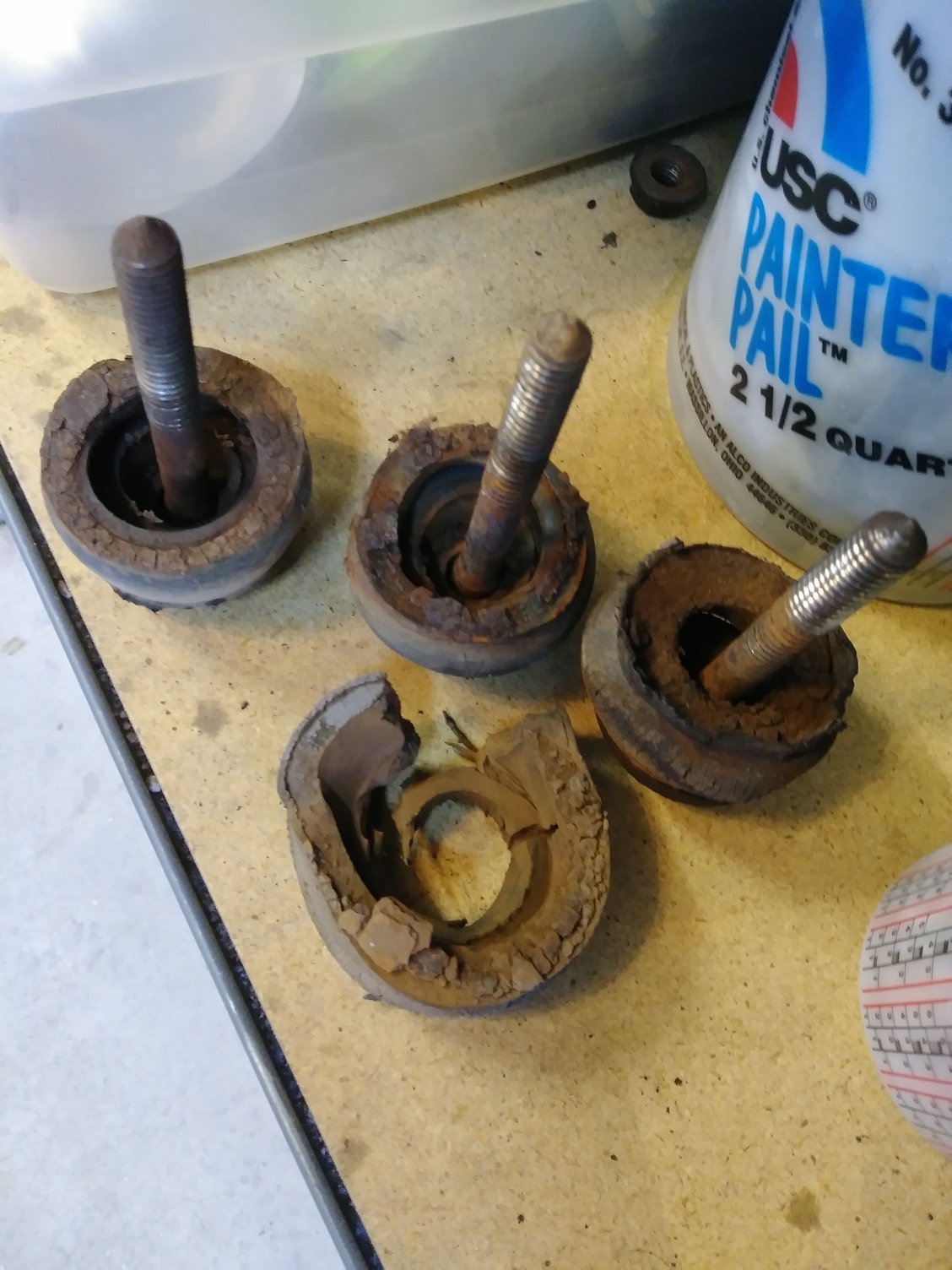

Hmmm... body to frame mounts look like they are due for replacement. Nothing like the desert heat to destroy rubber parts.

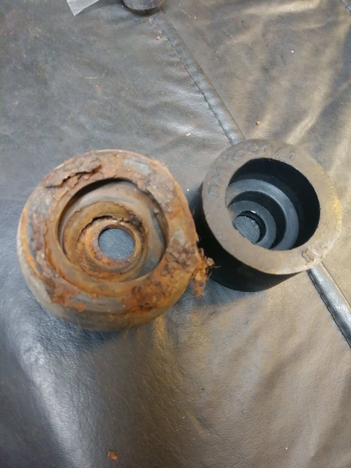

FWIW, I installed polyurethane replacement cushions.

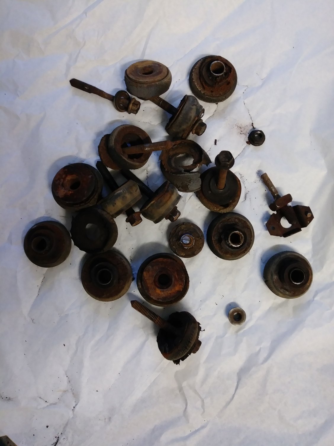

Old Sep 30, 2020 | 09:22 AM

Looks like they all screwed out OK , your lucky , there are some horror stories out there with rusted parts.

It's been a battle, but not nearly as bad as cars from snow country. Soaking the last bolt now - hopefully I can break that loose today and start replacing mounts. The rust on these from the bolts (and mostly the washers in the mounts) is the most I've found on this car anywhere. Gotta love desert Southwest cars.

Hey AJ - I have pretty limited knowledge of this project other than what I've researched for our '77. I do know that the early C3 cars had steel body mounts instead of rubber, but I don't know the details on that as far as if both parts of each mount were steel, what years they used steel etc. Maybe someone can chime in and give you a more knowledgeable answer.
I'm replacing ours because they were literally falling apart and I'm trying to bring back the ride quality to what it would have been new (or better hopefully).

What happens, is as the rubber disintegrates, and you're left with just the bolts and sleeves, which don't provide any cushioning.

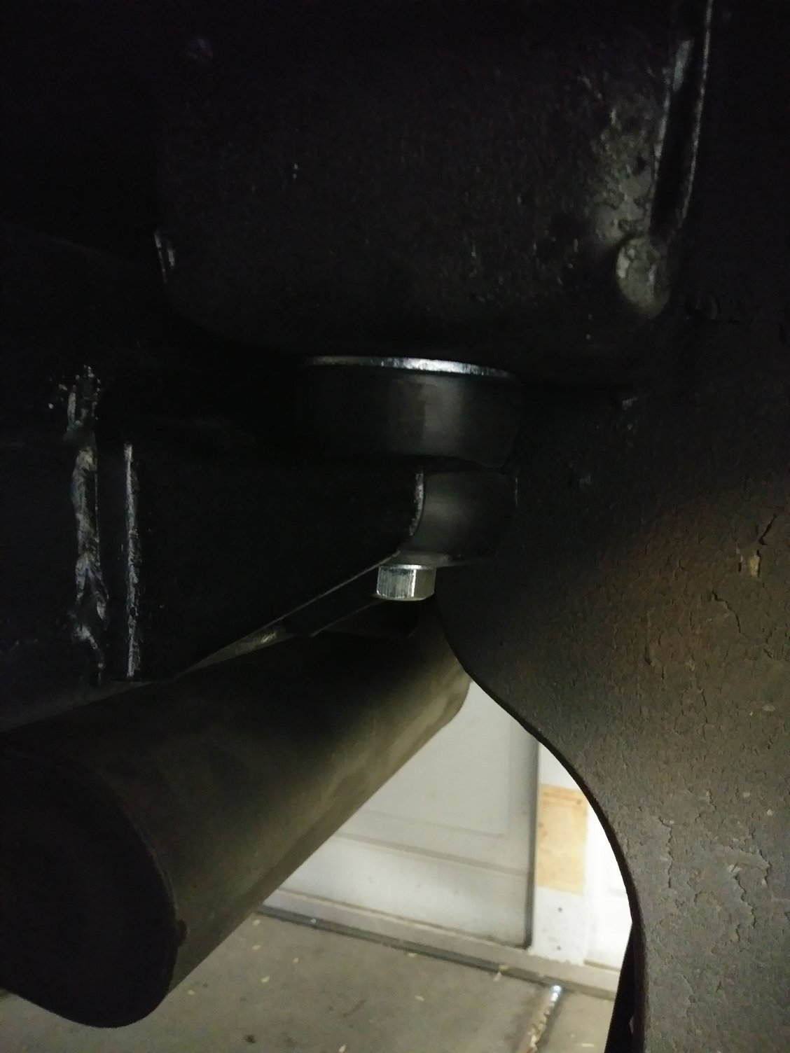

I have another question about this project. Being a "rubber bumper car" ('77), I'm wondering what I need to do with the rear bumper support. Do I loosen the bumper bracing from the mounting points on the frame? With the exhaust right below the rear bumper cover, I'm not sure how much room I would actually gain by doing this since there is really no room to move the bumper bracing once it's loose, and I don't want the weight of the bumper bracing hanging inside the bumper cover.
Thoughts / advice?

Another project done...
