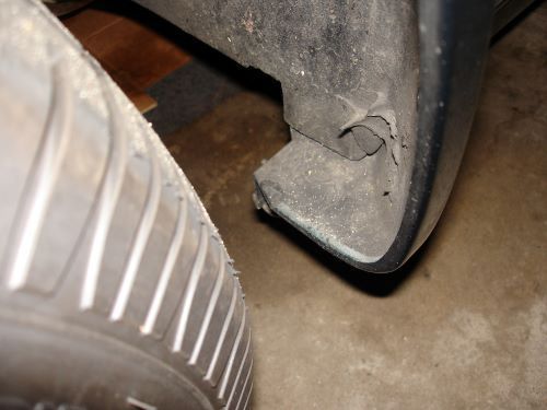

Originally Posted by brando.lee
I’m thinking about getting 255/60/15 for both front and rears, like yours. is there any rubbing from the front tire when turning or making sharp turns?
Mine is a 78 and 255/60/15s were ordered from the factory. When ordered like this the inside lip was trimmed backed from about noon forward & for the back of the opening a triangular piece was removed.
