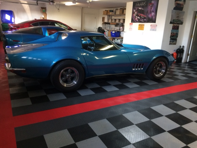

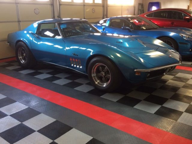

Here you go Rick. Just a couple quick shots, nothing special. Rears are 275/60/15s and fronts are 245/60/15s. I hope this helps.

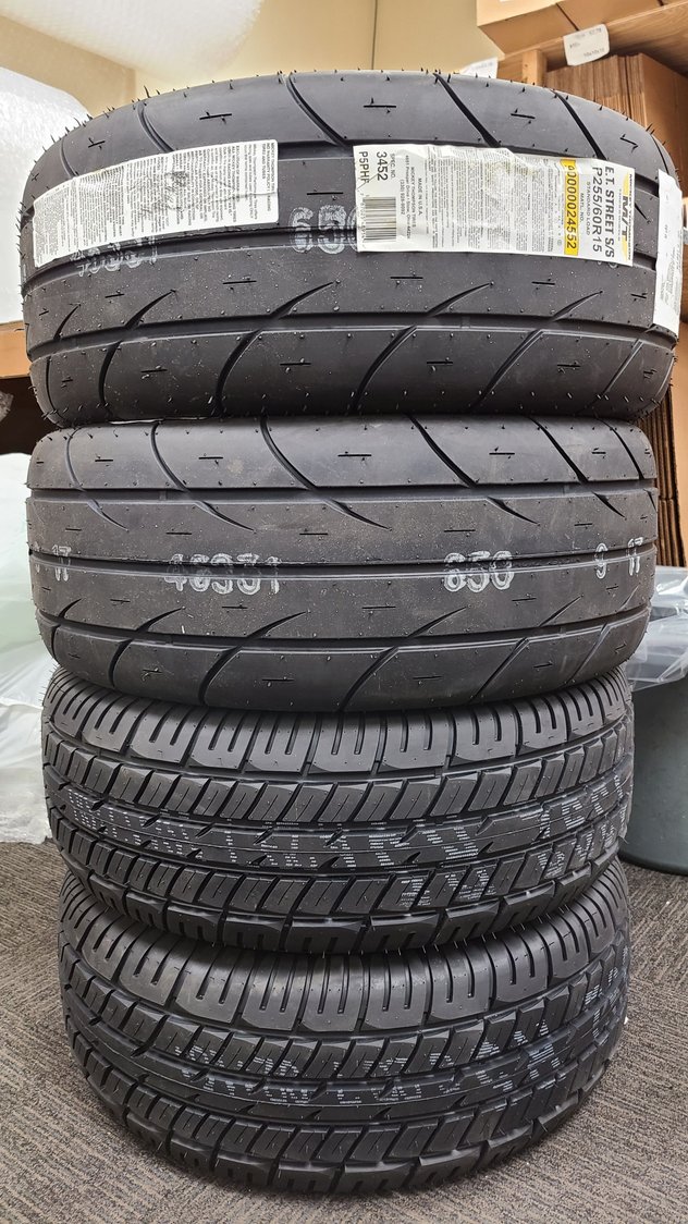

There in! I'll post a picture of them on the car soon.

Les, very nice. Mine just came in.

Les 275's fit without modifications?
Rick
Old Oct 17, 2020 | 08:40 PM
Les's Avatar
Les
Joined: Dec 1999
Posts: 11,094
Likes: 990
From: Sierra Foothills CA
Rick
Rick, it's been many years since I first started running 275s back there. I remember reading at the time that the E-brake cable bracket needed to be moved. I can't remember if I had to do that or if I just ground some of the bracket back for clearance. Just take a good look at it and account for some sidewall flex to be safe.

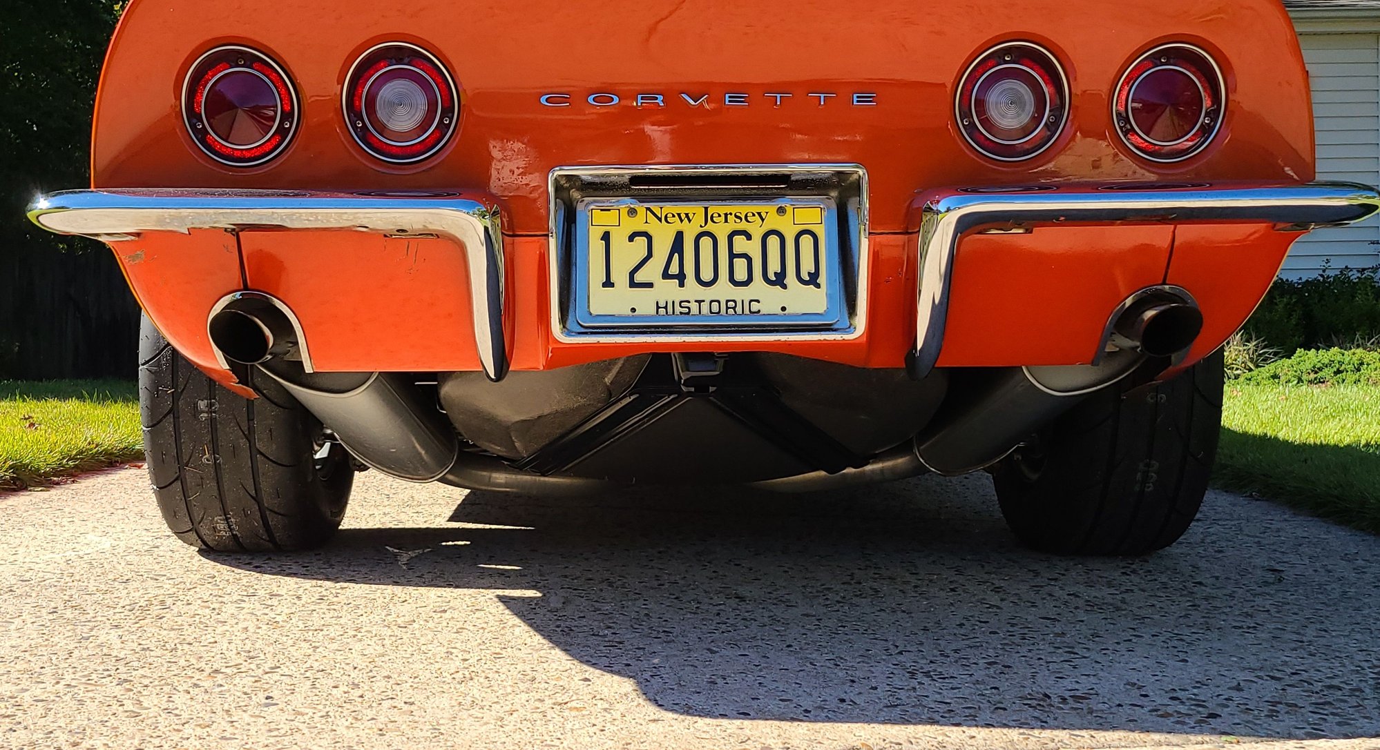

There on. Mickey Thompson tires with front Sportsman S/T P245/60R15 and rear ET Street S/S P255/60R15. Pics belowThanks for everyone’s help!

Looks great! How do they feel?
Old Oct 19, 2020 | 02:49 PM
RickDett's Avatar
RickDett
Joined: Aug 2013
Posts: 358
Likes: 22
From: Brigantine NJ USA
The grip is impressive over stock tires (am feeling like “oh boy I hope nothing breaks”). Regarding cornering I've played around with a lot of individual suspension setups (tweaks) including different rear sway bar thicknesses, I left it with a loose driving condition (my preference). Now with the grip of this new tire setup it is back to push condition, so I’ll go back to a thicker rear bar again to dial it back to looser condition. I'm glad I stayed with 15" tires.

Glad you're happy and that you know how to adjust things to your preference. Those drag radials will definitely add some grip and they should be fine at 30-32 PSI for overall use. I run less in mine because....well, big block. Enjoy!

why did you pick this set up? Are there benefits for putting sportsman’s in the front and et street s/s in the rears? Why not just have all four sportsman’s or all 4 ET Street S/S? Genuinely curious, I have a 77, I like how your fitment looks, I’m thinking about doing the same sizes to mine. 255 in the rear, and 245 in the front. For the rear did the tire stick out of the finder? It kind of looks like It doesn’t in the photo, but figured I’d ask. Since my goal is to get the widest tire possible without it sticking out of the finder.
Also did the front tires rub when turning or making sharp turns?
