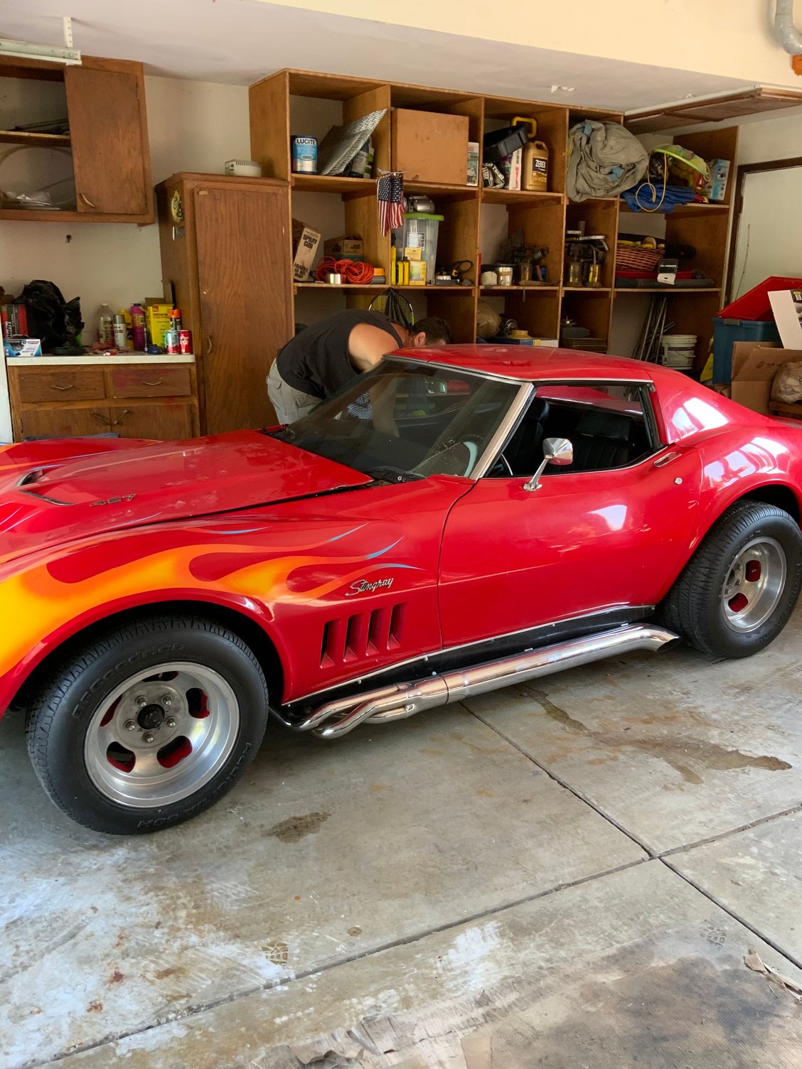

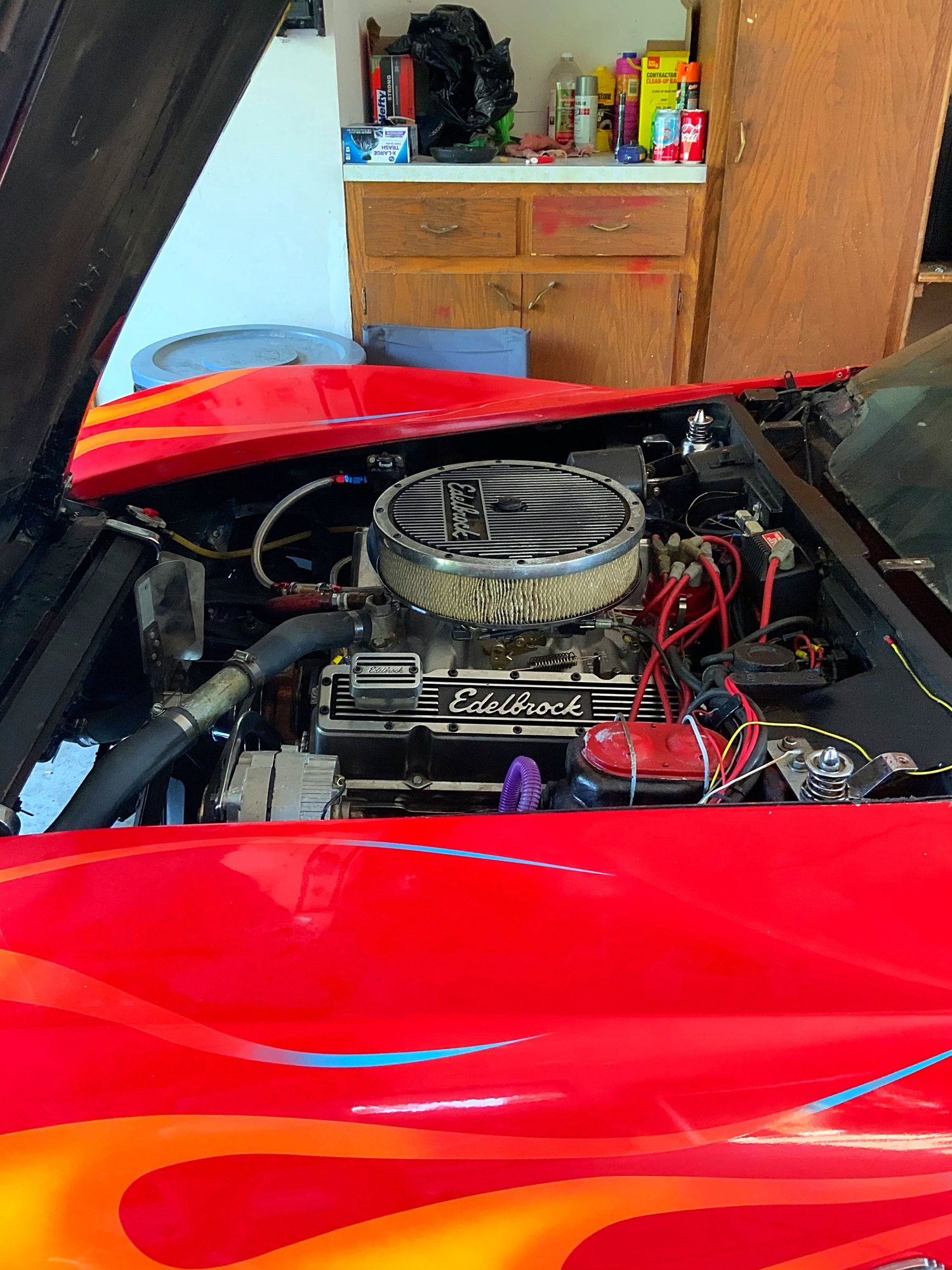

Looking for some advice on replacing Pneumatic headlight doors with Mazda headlight door mechanism on my 69. My guy and I recently bought our Vette and we are contemplating the Mazda light kit (huge question mark). Let me preface this by stating, we are at the starting gate with this car. I am happy with the purchase but the more we inspect and educate the greater our anxiety becomes. Both of us can handle easy/medium repairs. Heavy (hard) stuff, I hate to admit, we are going to have to recruit outside help. Say for example, the transmission. Anyone who has done the conversation from pneumatic to electric, your wisdom would be appreciated. More specifically, if you used a Mazda kit, thoughts, issues and advice.
