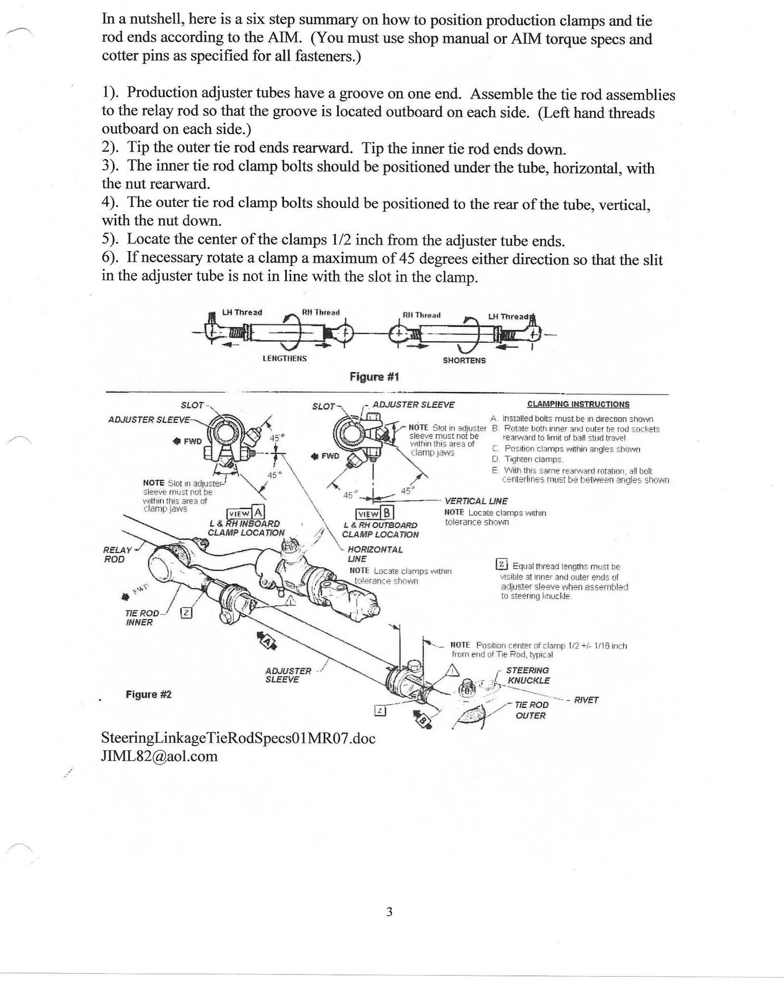

I just rebuild my front suspension. I checked my alignment and found out I have an 1-1/2 inches of toe-in! Oops. How do we I adjust the tie rods with out marring the new Moog parts? With lots of struggling my channel locks work and leave huge gouges. I've tried a strap wrench and cannon plug pliers but neither can get a grip.
Anyone have an easier way of doing this? Are the tie rods supposed to be this hard to turn (and yes I have completed loosed the clamps)?

Buy a tie rod adjusting tool, it grabs the slot in the sleeve.

Your local parts store should have one. Lisle makes them, among others.

Thank you for the tie rod adjusting tool suggestions. This looks like what I need.
