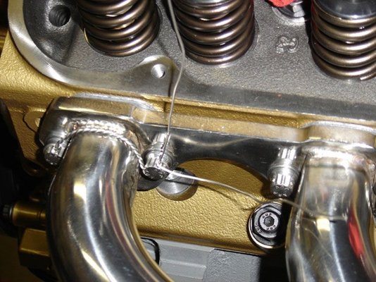

Depends on the header flange thickness and how you want to retain them. Personally (and due to access restrictions) I like drilled ARP bolts and then safety wired. Never really had any issues with bolts backing off (also using aluminum gaskets now) but don't mind the looks of wired bolts
(not my picture)
