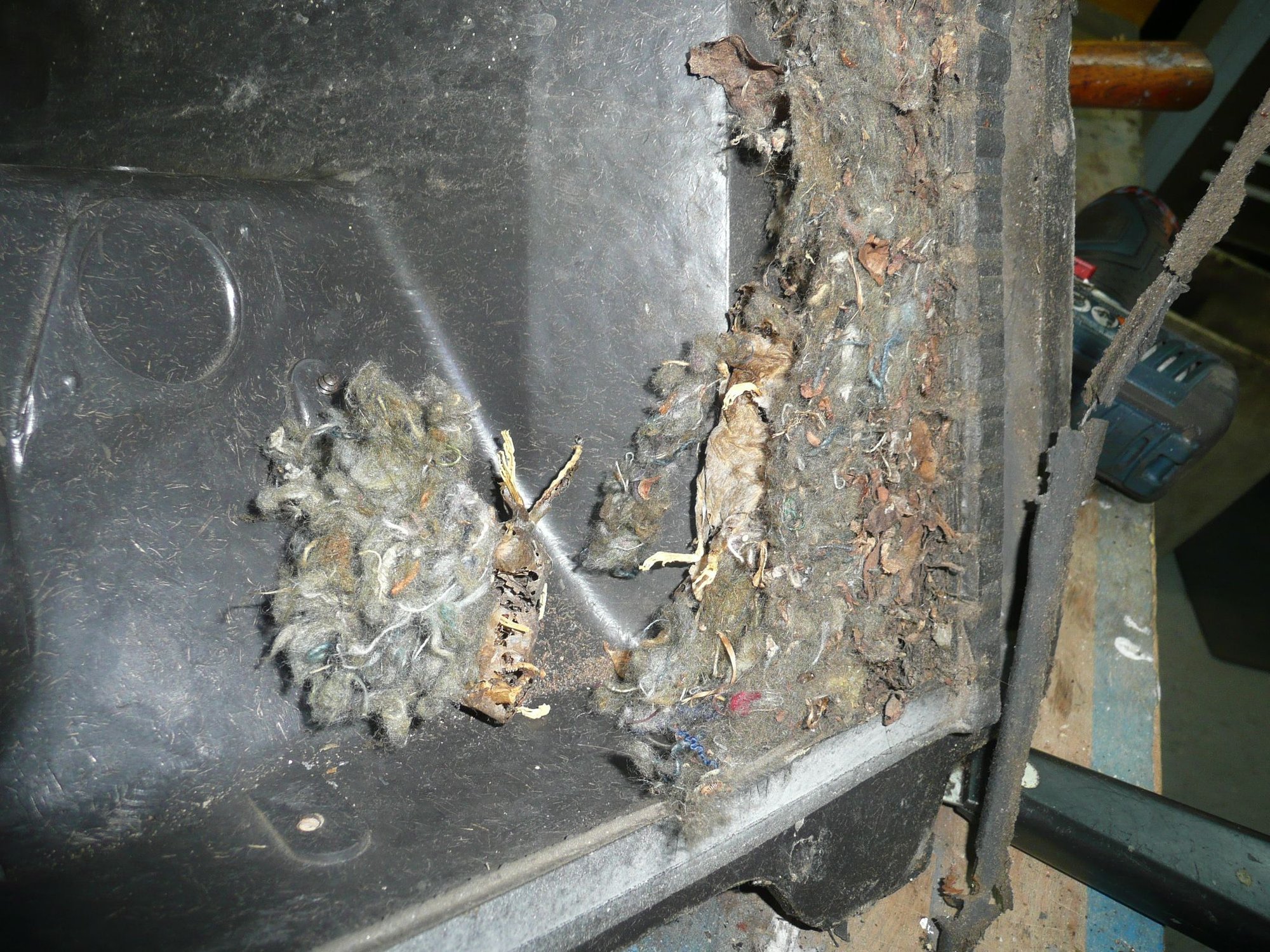

Here's where they were in my 79'

That's the part of the plenum that's on the engine side. They pee'd in the center console.
