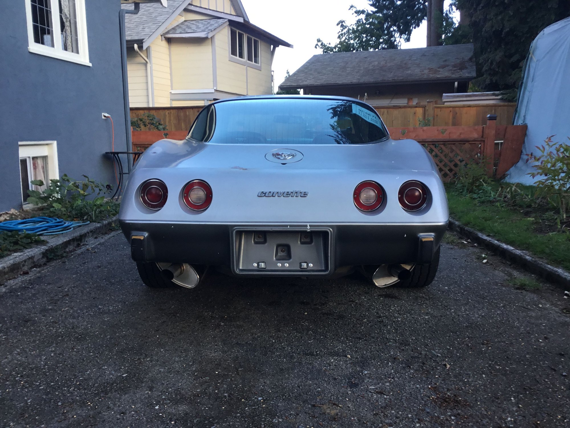

Okay so I just bought a new to me 78 C3. I would like to save the 43 year old paint. It is pretty sad, faded badly with some damaged spots that will need repair but it’s only original once. What are your thoughts about sanding with 2500 grit and clear coating with rattle cans. I don’t have a compressor. Be honest.

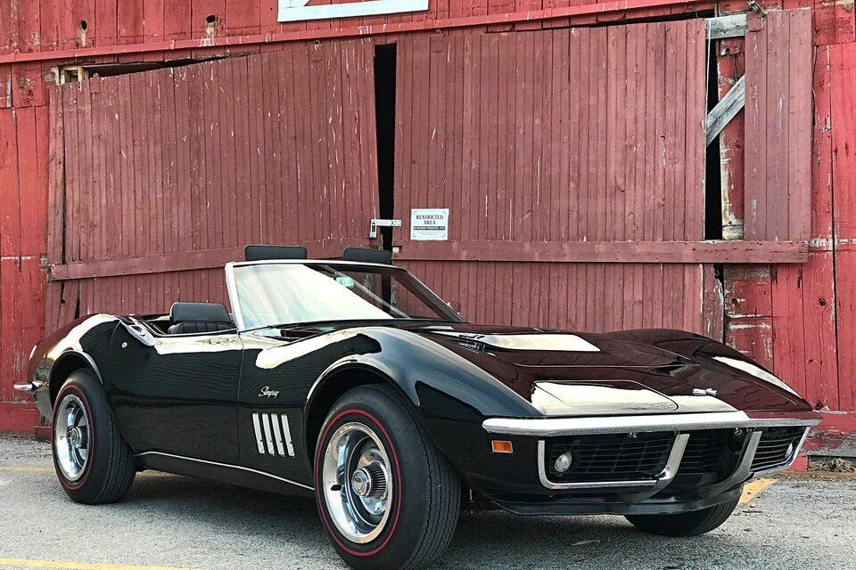

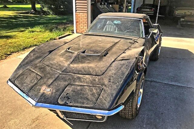

Here is a before an after of my barn find 69 with lacquer paint:
After using Meguiar's no 7 process and buffing out the paint.
