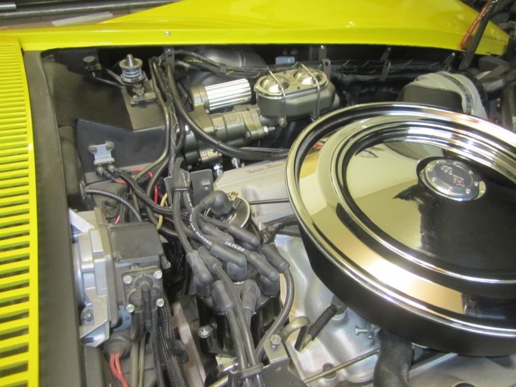

Considering a car but have noticed something that I'm not sure of under the hood, (in addition to the missing wiper door and vacuum canister).
I've circled the area of concern in yellow - the housing area behind the brake master cylinder - in pics of other cars I've seen this looks more box like, whereas in the pic below, it look less so.

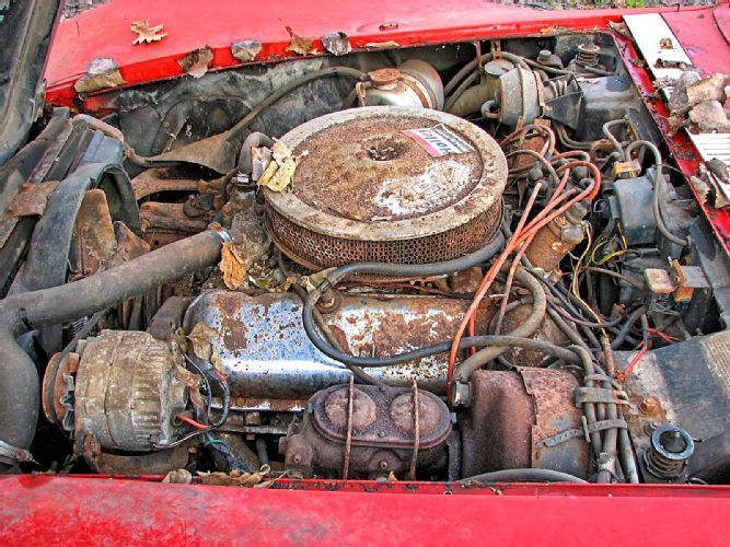

However, I found a pic of another BB, where the area in question looks more similar to the one above....
Burdened with inexperience and lack of familiarity, I'm not sure what is what in this area and if there were different configurations based on year, options and such like that might change the area in question - '72 454 in this case.
Any thoughts?

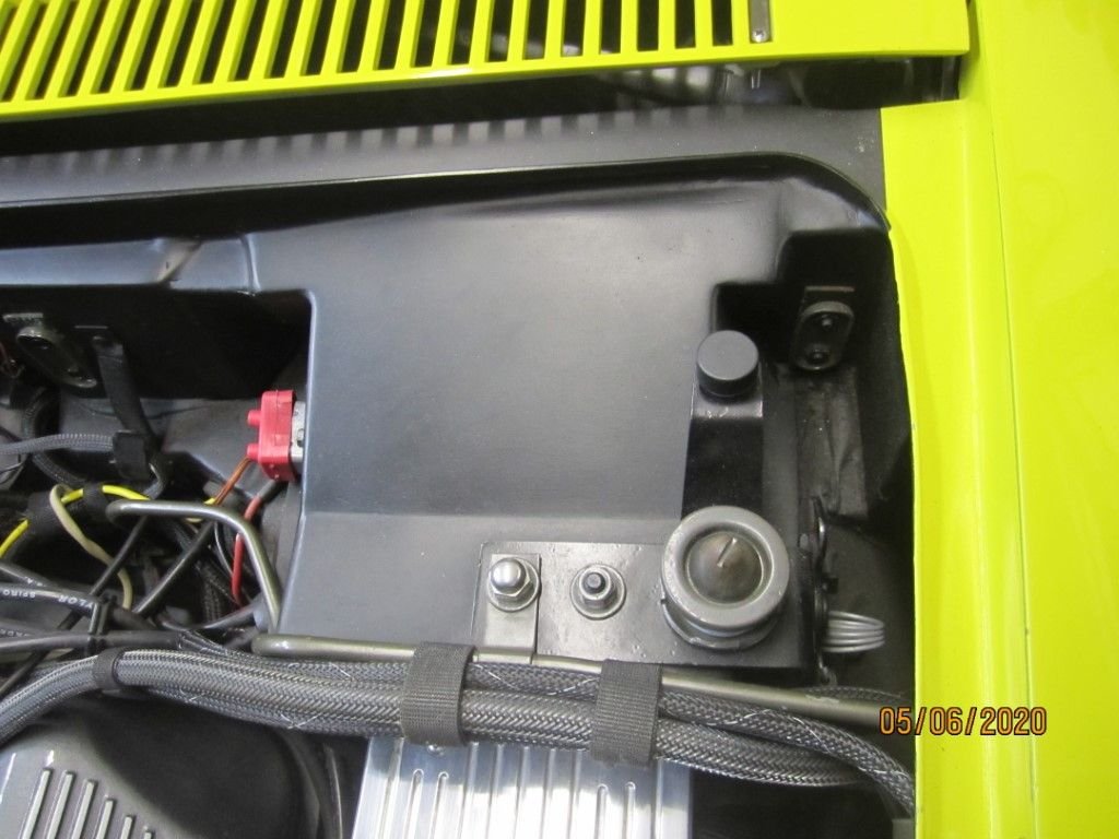

EDIT: Here is one I found where the structure looks far more box like...
Or is it just a case of bad light and poor photo?

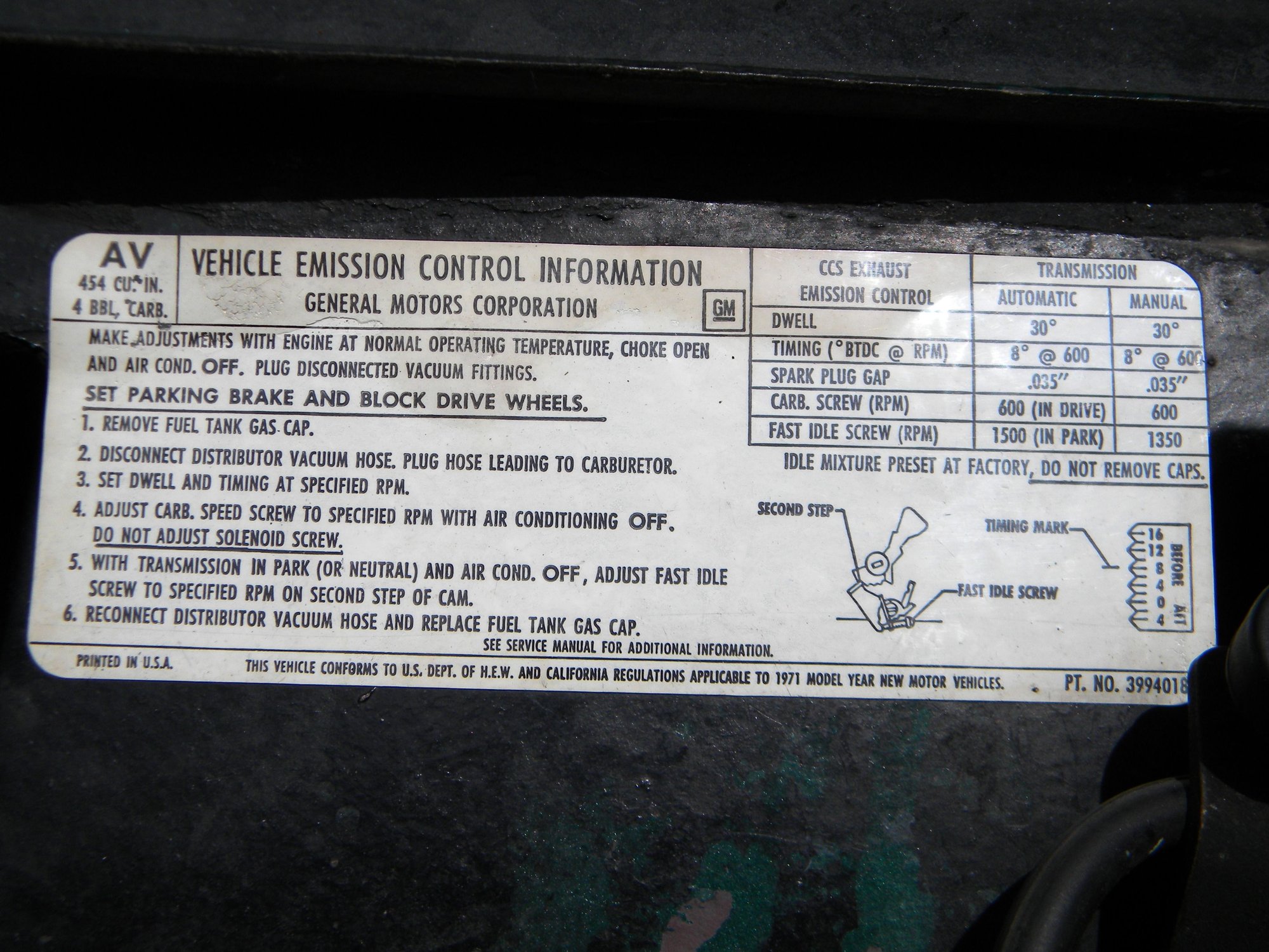

Yes with the exception the tune up sticker is often placed there.

I know what you mean, but i'm talking specifically about the area behind where the booster would go - in some pics it looks very square and neat, whereas in the pic of the one I circled, the pedal box housing looks more rounded and potentially butchered? Not sure if just the pic, my eyes or the car. Compare my circled pic to the bottom pic which is much clearer (of a different car0 see how the car in the bottom clearer pic has a pedal box housing that looks much neater and more square?
Hope that makes sense.

Yes with the exception the tune up is often placed there.
Tune up?
Sticker with specs on?

Emissions sticker on my '71 LS5:

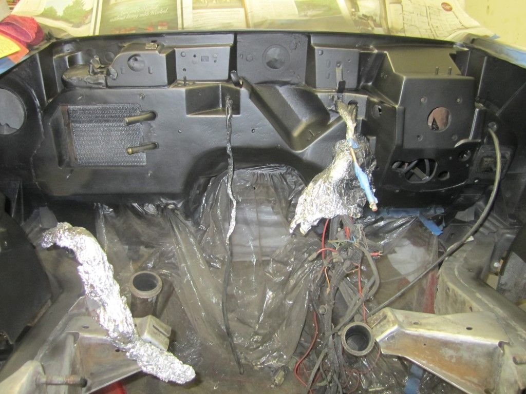

I don't see the crisp edges on the near edge of the box.Name:  photo784.jpg
It looks like it's had glass work done there.Name:  photo383.jpg

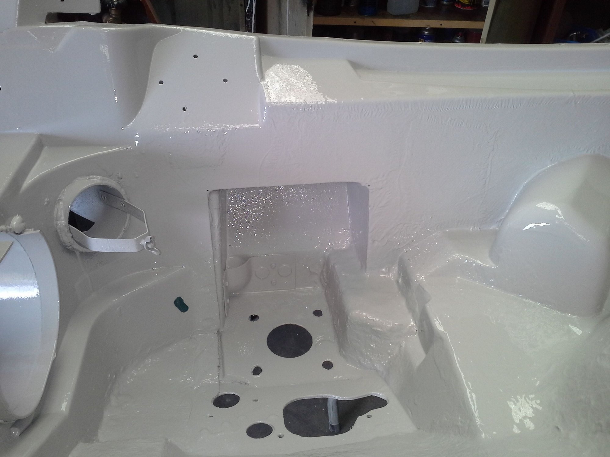

That area is actually a cap that was glued on after the steel plate re-enforcement (for the pedal box ) was riveted on . The rivets are down on the flat edge , there,s nothing up along the top edge inside . Only the mount for the hood hold down piece at the front
I had to modify mine to make clearance for some taller valve covers , so ignore the bottom right side of the area . that's with the steel plate out of the way as well.

I agree with Barry I do not see, unless it is a photographic illusion, a crisp GM edge there. It looks like there has been some sloppy repair done in the area. IKe
I wonder if someone had to get to the brake booster nuts and cut through the firewall box for access...

Make sure you have the inspector ask the owner what was done to that area when he or she inspects the car.
For me it looks like someone has been playing in that area with fiberglass.
When I built my 72 with 496 big block I had issues with tall valve covers in that area and considered making a modification to the glass but wound up getting shorter valve covers to solve the problem. Might be something this car has seen as well, but worth the ask.
I don't see the crisp edge either so it is worth investigating.
