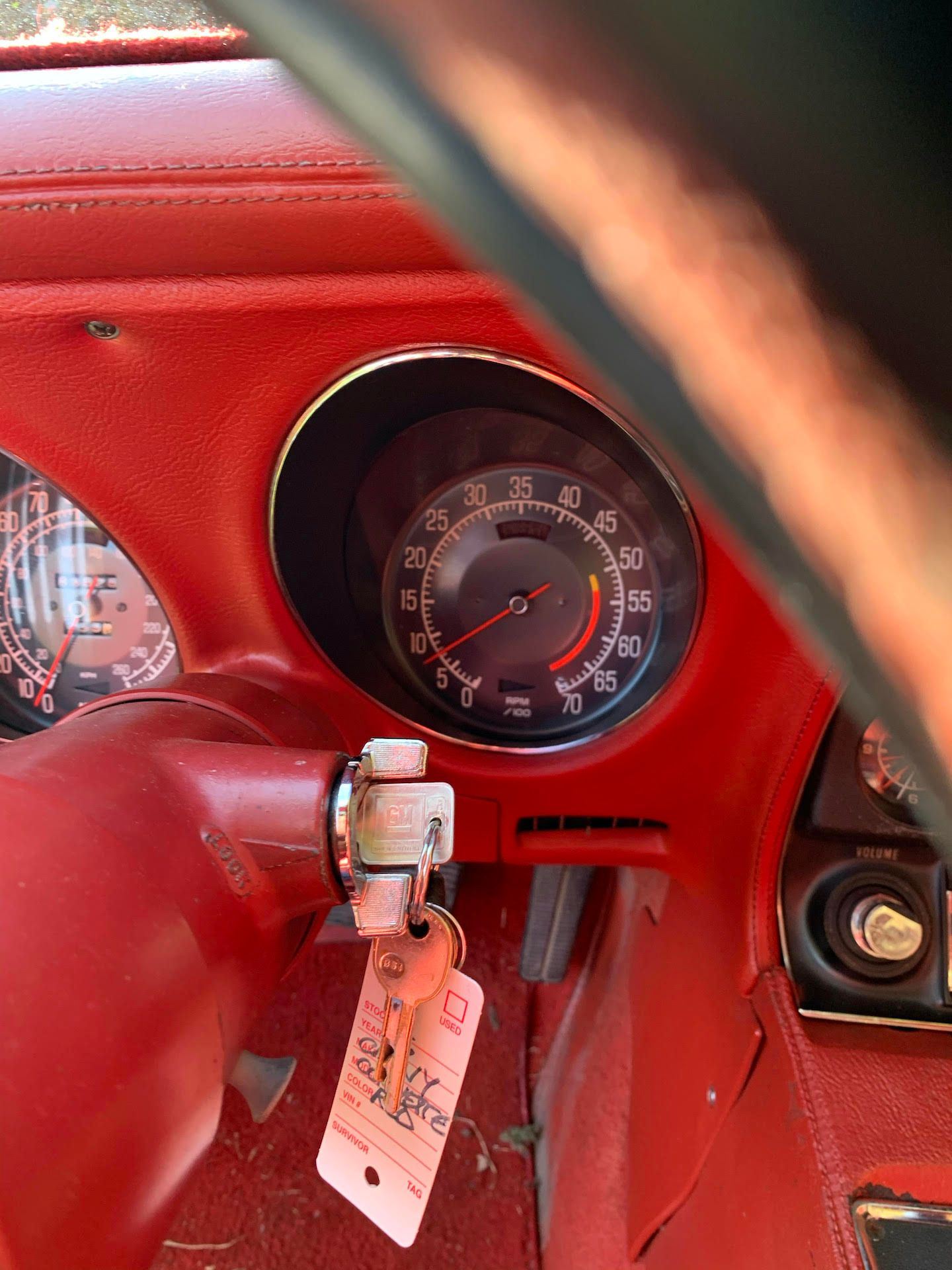

​​​​​​I was able to set the idle while warm and it sets great after it is warm as you can see in the picture it is right at 750. I did notice that the flap in the carb never moves when it is cold or hot as you can see in the picture.
its a bear cold and I can say the choke does not engage.
The guy who worked on it mentioned something about the vacuum being run back through the distributor no idea what that might. I will look at the accelerator rod and I will djust the choke some this weekend but I feel that a rebuild is going to be the only way. I do not mind sending it away to someone. I am in North Carolina near Tennessee is there anyone near me you trust. I want to stay as original as possible.

Send it to Lars in Colorado. PM him and get his address and info. It will get fixed, run on his test motor and come back like it was breathed on by Duntov himself. You can literally take it out of the box, put it back on your car and it will be just about perfect
If you are talking about the big flap in the rear that is the air door and it only opens when the 4 barrels are engaged adn the air flow opens it. the small front flap that is wide open is the choke and it it isnt moving you will need to study up on how your year choke works
