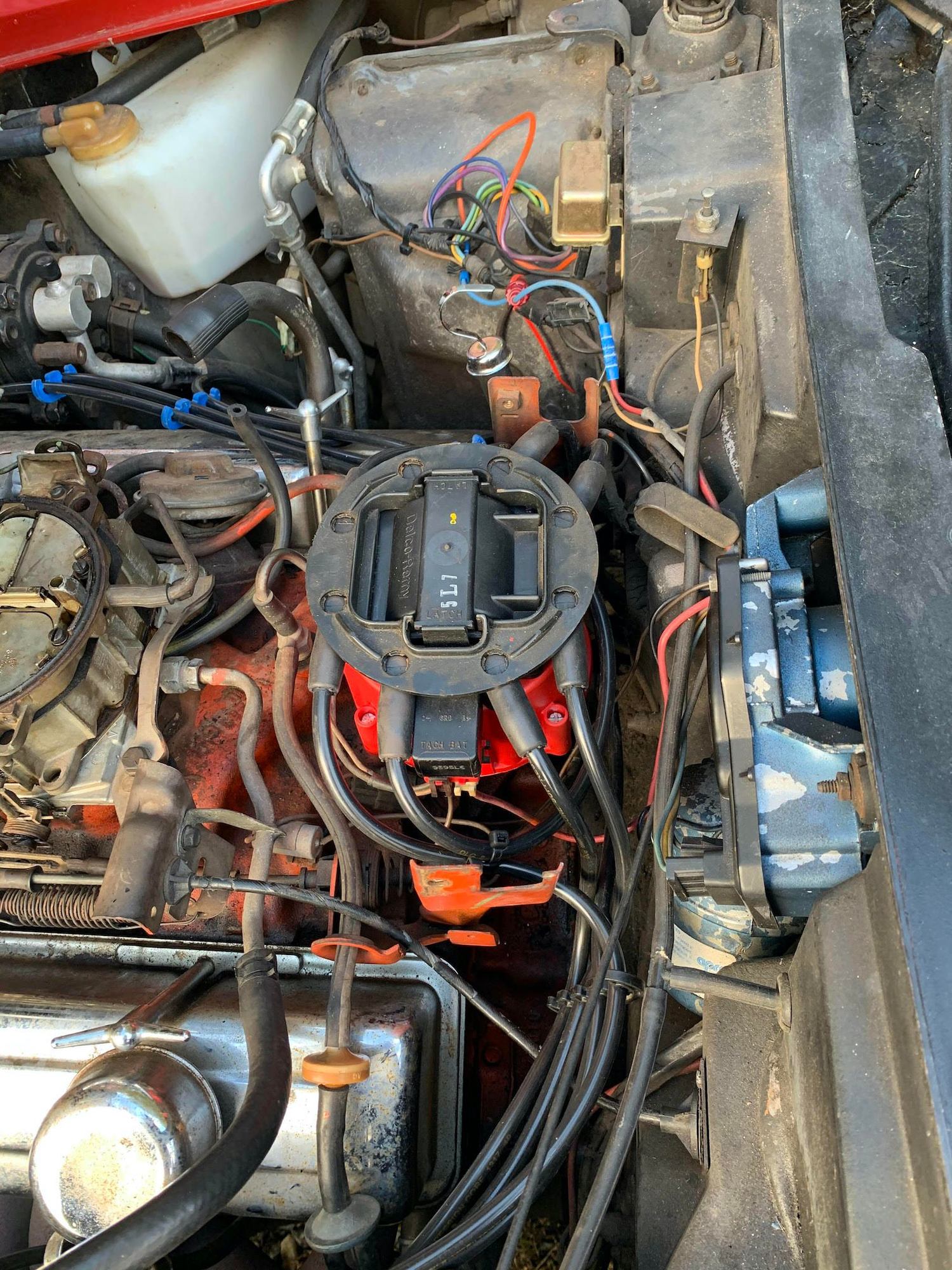

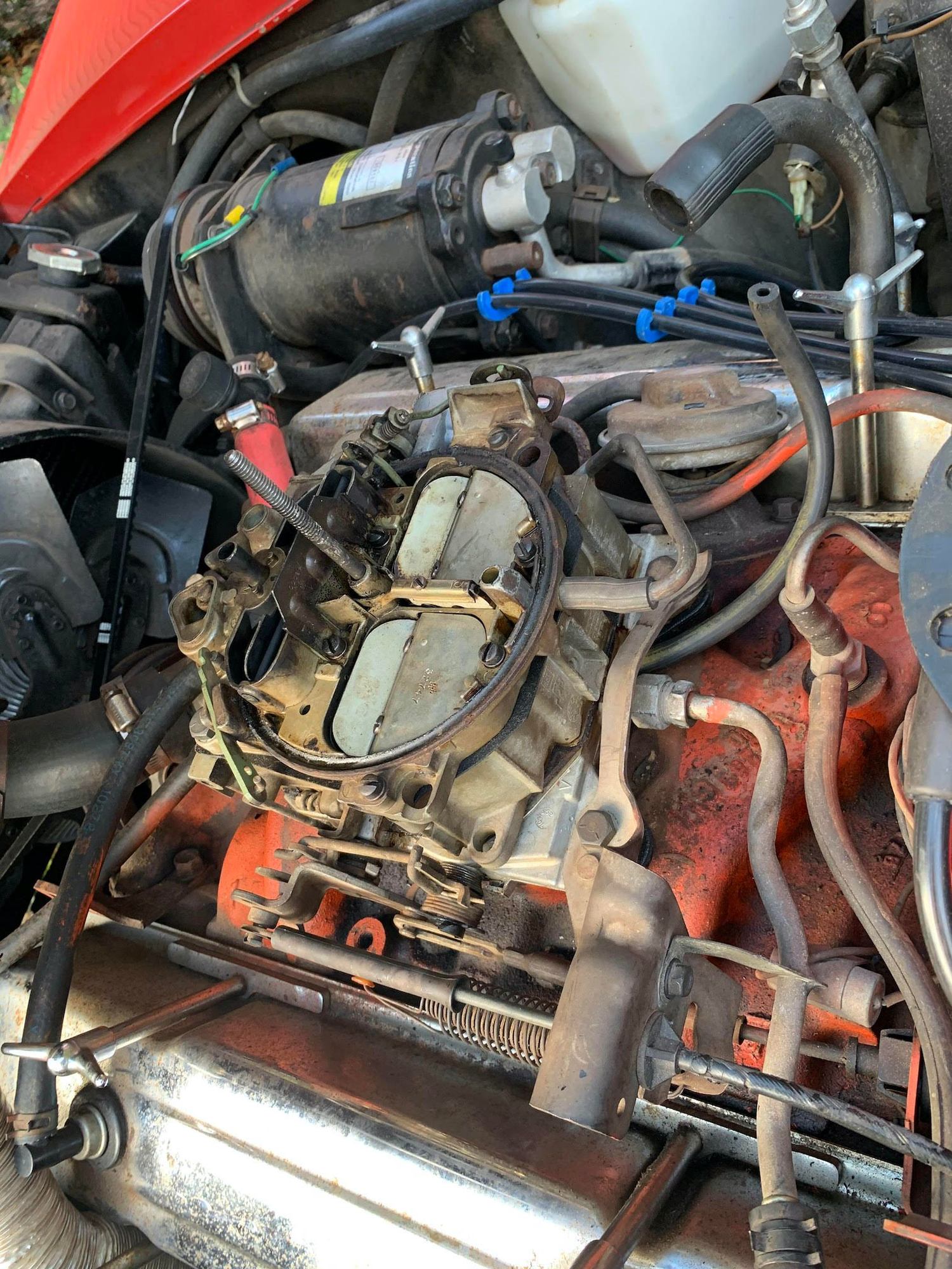

Can you post pics of the carb and the distibutor as well as a whole engine pic

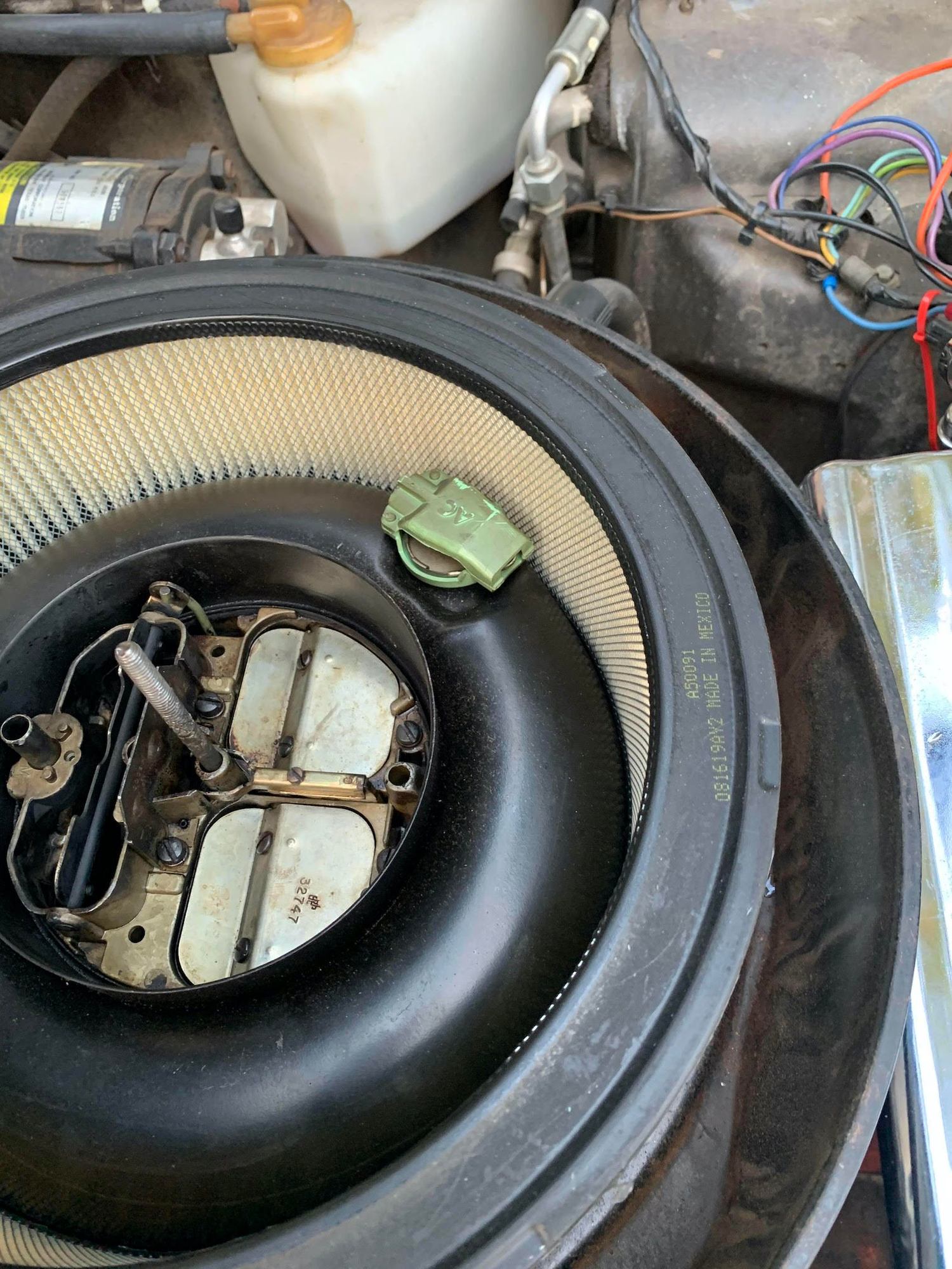

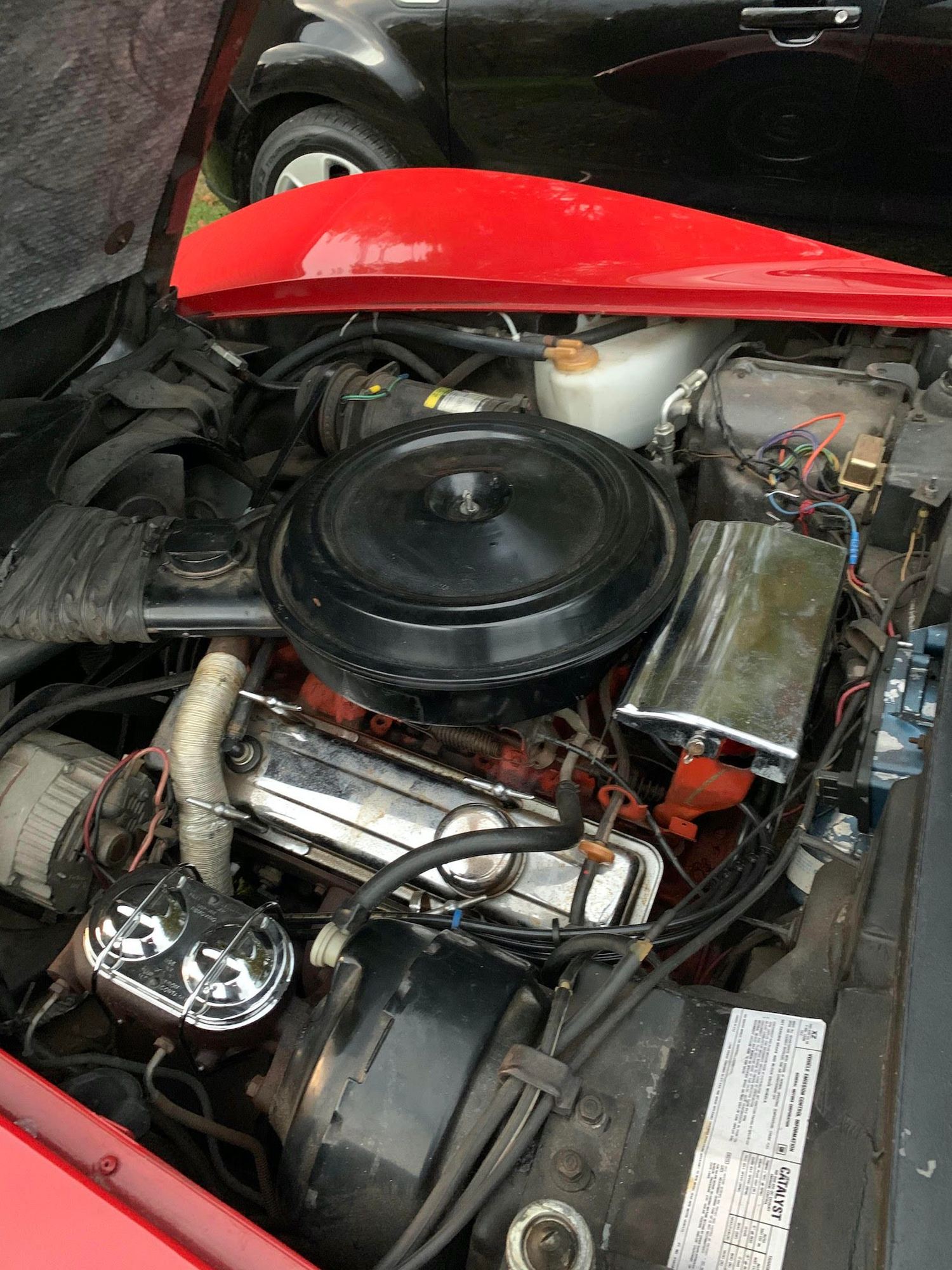

Here are some pictures with a few more questions. What does that green thing do that is inside the air cleaner. I notice one of hoses plugs into bottom but looks like it is really a plug. The silver tube coming out of air cleaner is that just for extra air. And the idle is about 6 is that to low.

That looks like a completely stock motor.
The silver thin metal tube is a hot air duct for aiding in cold strarts. It brings air up from th eexhaust manifold to warm up the intake air.
The green thing is a vacuum valve heat sensor for the front air door flap.It is related to the silver hose. If its not plugged in you will have a vacuum leak

When you say the idle is about 6 do you men 600 rpm? yes that is too low it should be atleasst 750rpm. Your stock timing should be at 8 but that is for emmissions. IT would be better up near 14 but you should go through the whole timing procedure that Lars pubishes.
The popping when you let of the gas could be as simple as moving the vacuum advance from ported vacuum (stock) to manifold vacuum (Lars-method). But you should get his full instructions and do the entire timing procedure.
Do you have a timing light? If your timing is jumpy, you may need to rebuild or replace your distributor (take a look under the cap for "rust" that makes the timing weights stick). Otherwise, start by looking for vacuum leaks.

The green sensor inside your air cleaner is part of what is called the Thermostatic Air Cleaner or (TAC) as Rescue explained.
If you remove the flexible cold air intake duct off the front of the air cleaner you will see the damper door.
It looks like all your hoses are there to the sensor and damper door vacuum actuator.
With the engine off the door should be open.
On a cold start the damper door should close, once the inside air cleaner temp rises between 85* & 128* the damper will slowly open. At temps above 128* the door should be full open.
Not that this is part of your lean condition, but I think your accelerator pump rod is in the wrong hole of the lever?
Yes, it is. Which is indicative that somebody who does not know what they're doing has been into the carb. That means that the carb has several setup problems that are causing the isues. The carb needs to be torn down, inspected, and all the issues (there will be many) need to be corrected and set up right. Once done, that stock Q-Jet will perform really well - judging by the photos, the carb is in really good, original, rebuildable condition. Somebody has just messed with it to screw it up. Judging by the black exhaust reversion sooting in the carb's primary bores, they have also messed up the timing - typical signs of retarded timing with possible vacuum advance issues as well. The car has overall tuning and setup issues not limited to the carb.
