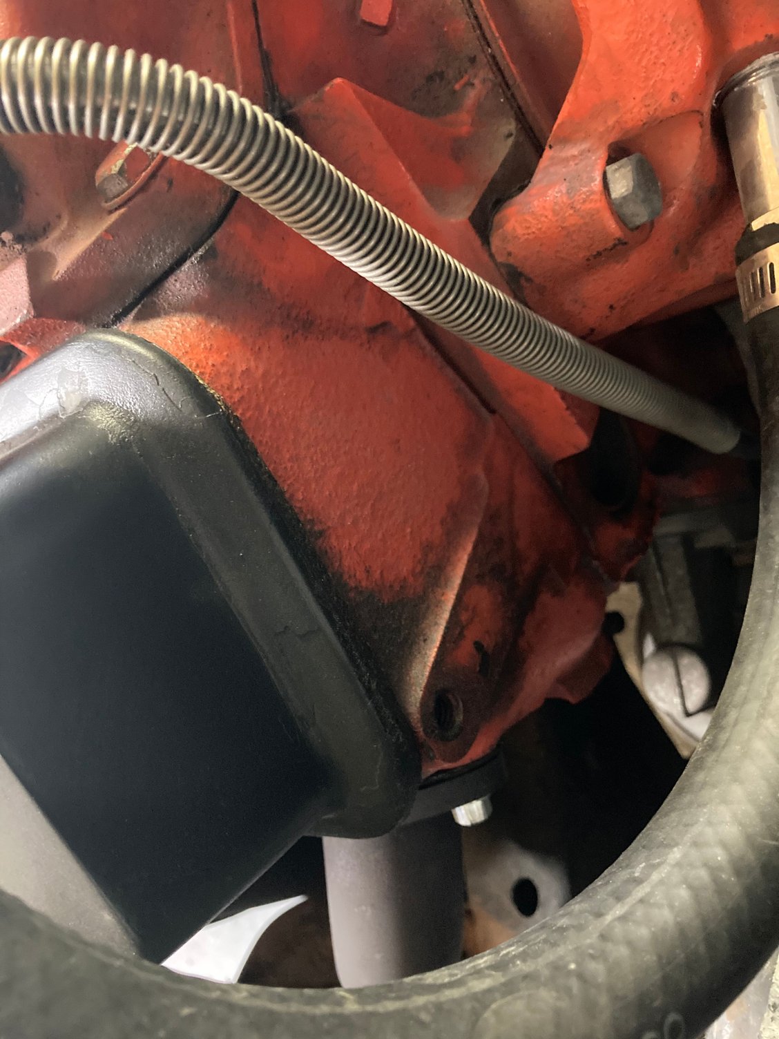

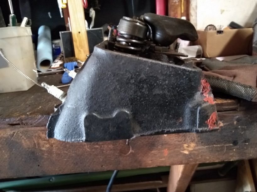

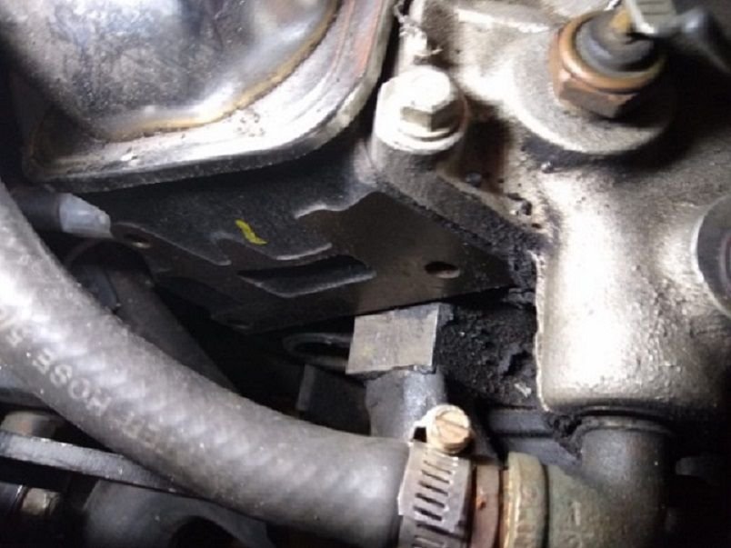

here are pictures of my no-hole 3927186 head. and also the Vortec head which I have now that does have holes.

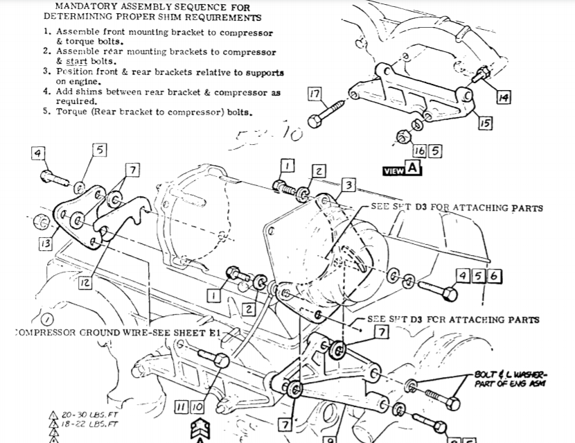

I went and looked at my 68 AIM and the brackets for mounting a/c really are a rube-goldberg contraption..... here are some pics from the AIM. You'd be better off with aftermarket brackets.... note that my aftermarket a/c (Sanden compressor) does not use the head holes. Anyway...here you are:

thank you for the photo. It shows almost exactly what I was questioning
