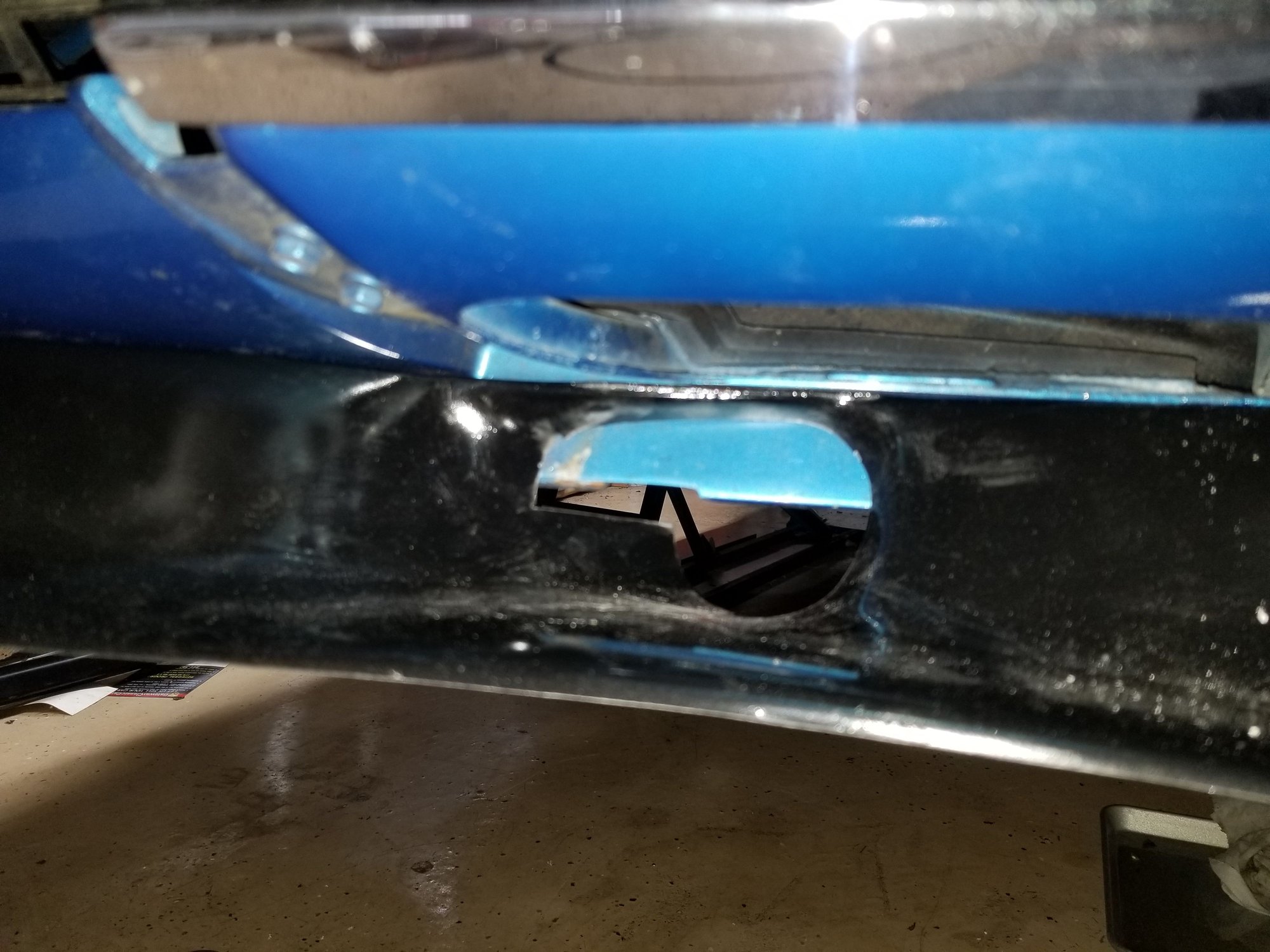

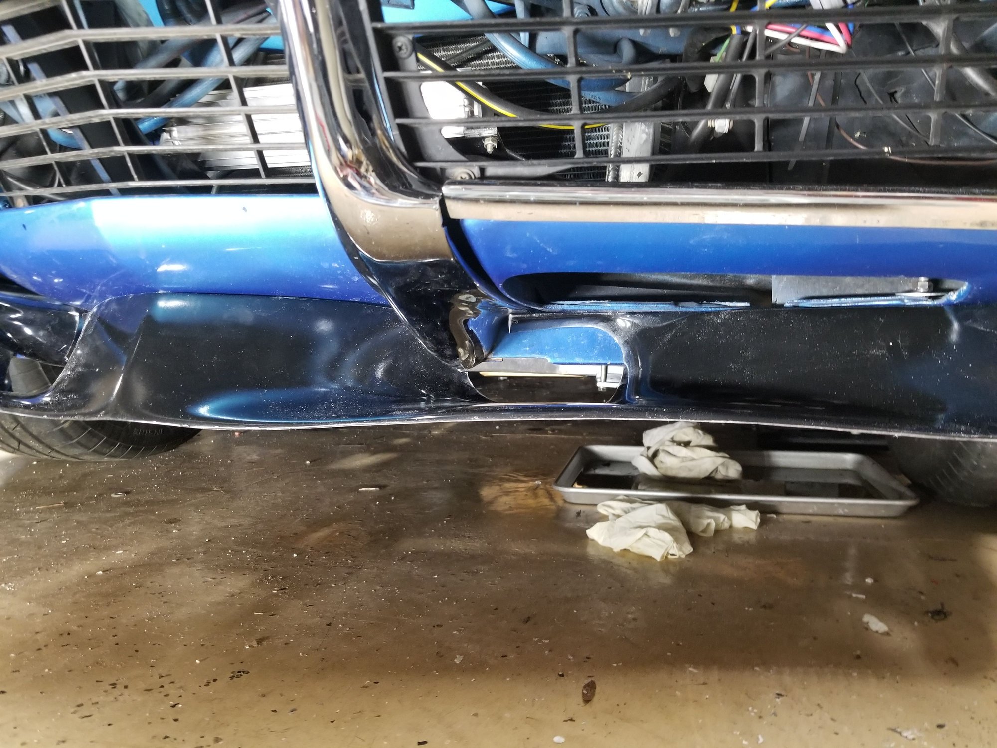

I think the front bumper is okay, as are the over riders from what I can see, if I ask my eyes to ignore the rest of the chrome and body work. I think the issue is the lower lentre piece of body work is raised up and twisted on the right hand side and there are chunks missing on the vertical flange/spoiler.
How does all this fit together? What does it look like without the bumper, grills and chrome?
Here is another couple of shots...

Paragon Corvette Reproductions Catalogue, page 105; shows the front end fiberglass assembly for a 1968-1972. The parts I think are broken include part number 7924 Front Lower Valence Panel ($242US); part #14207 Front lower valence panel seal retainer ($84.00US); part #4311 lower valence panel seal ($24.00US); part numbers 10802 and 10803 LH and RH lower valence bonding strips ($84.00US); and maybe part number 7444 front air damn ($45.00US). The metal parts all look complete to me though they need adjusting. The front bumper and both front bumperettes looks like they are in pretty good shape. Always hard to assess from pictures but it doesn't look out of the ordinary to me. So for somewhere close to $500 in parts, some paint, and adjustments I would think you could get the front end to look pretty much as it should.
Just my thoughts on the front.
Looks like a candidate for a good inspection if you can find someone to do it. If I lived closer I would offer to do it myself. Lots of members here on the CF, someone might be close and can offer some assistance.

Gaps in the grill molding aren't that unusual but it sure looks like it took a poke in the nose and it's askew. Also didn't look like the car was sitting level, but that could just be from the bad angle. I piled up an old Fury on a section of guardrail and that's just what the pic reminded me of, maybe less violent.

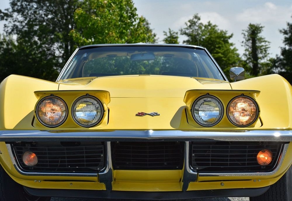

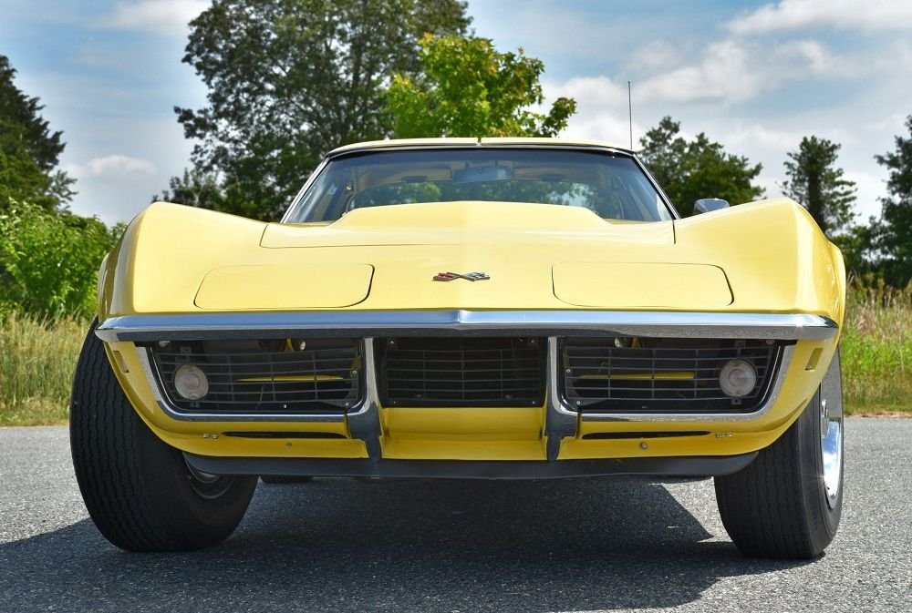

Here's are a few very good pictures of the front end of a 1969 L71 Coupe that went across B.A.T. this past July.
You can also view more detailed pictures of the car here if you care to. https://bringatrailer.com/listing/19...t-corvette-58/
Good luck... GUSTO

In stock form, there's hardly any placement adjustment of the turn signal grilles; the bumperettes have a little bit but not enough to align all of these components.
I'm not sure what's happening here... The right-hand grill is canted clockwise. Even that center recessed grill is crooked in its opening. It looks like whatever is going on is affecting the center and right side because the left looks pretty straight. I think the lower valance panel has been pushed upward just behind and to the right of the right-hand bumperette. This has caused the center grill to look crooked, opened the gap between the left grill and its bumperette, and the right turn signal grill to actually be crooked. Look at the gap between the top outside chrome and where it sits in relation to the main bumper; that's way too large. Because the vertical bumperette looks pretty good, I think it's not affected all that much by what happened.

It appears to me that the front end has taken a 'hit' and caused some damage, and the owner has tried to piece it together in order to sell it QUICK.
The protruding valence (part of the body) should be intact, and it is not. It is broken in some areas and missing pieces. If you purchase this car, you should expect to do some significant repair work to the underside of the nose area -- before you can even begin to properly position grillwork.

my chrome on my 68 was aligned like that. Its not really and issue to straighten it out. The airdam needs attention. Then you need to add a bigger dam to which may be why those 2 pieces are cut out. I have an ecklers air dam adn it had 2 scoops that hit right where those cutouts are. I cut and re fiber glassed the Ecklersair dam, not the car.

1. The car has been hit in the nose and repaired er-ah poorly. Showing signs of a bodyshop that did not understand Corvettes.
2. It looks MORE LIKE the pass side front spring has given up the ghost.
3. Someone DEFINATELY has to look at the car for frame damage in and around the 's' bends in the frame.
