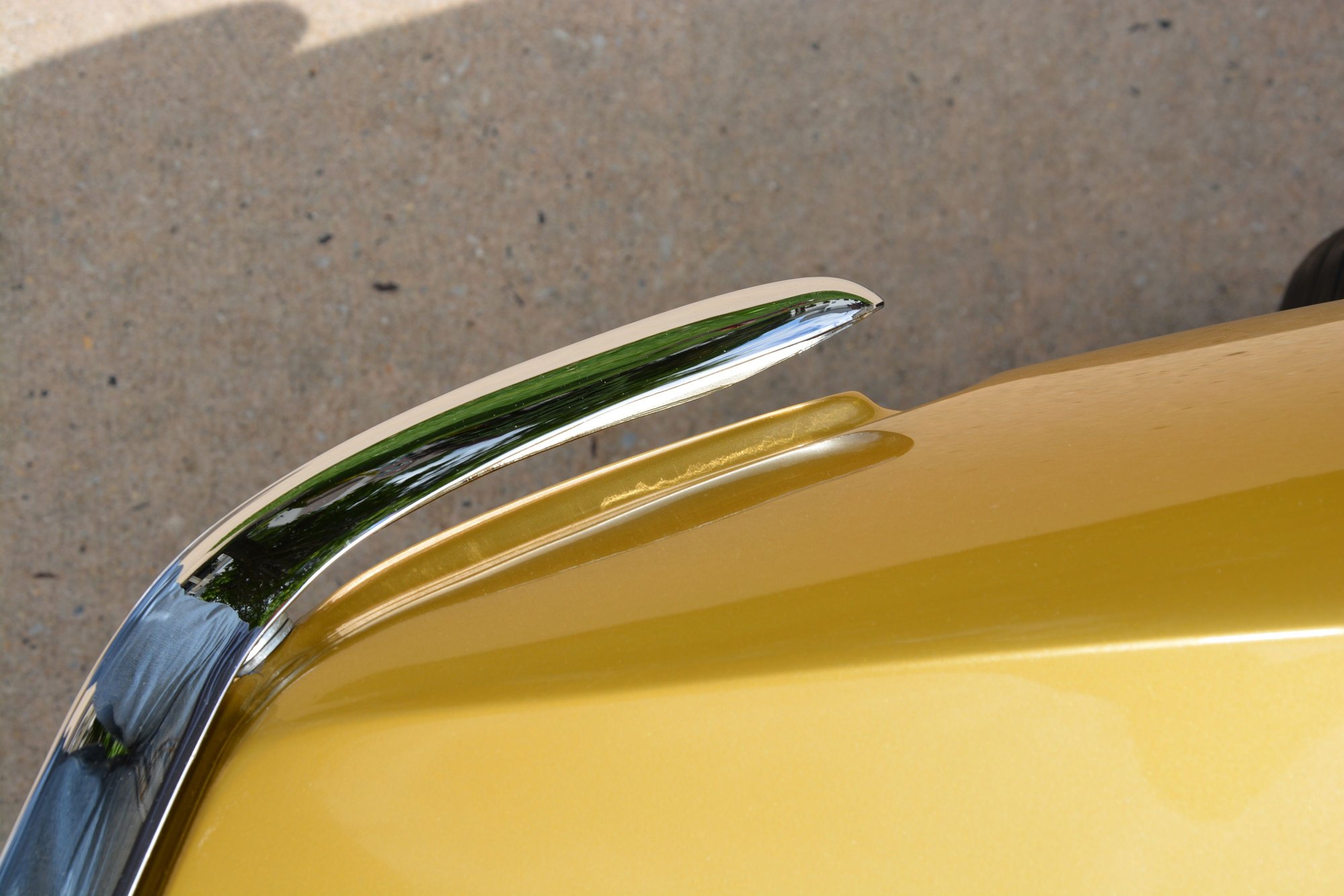

This is typical of how the $350 imported bumper fits. If you get it adjusted correctly across the front, it will usually stick out on the right side.

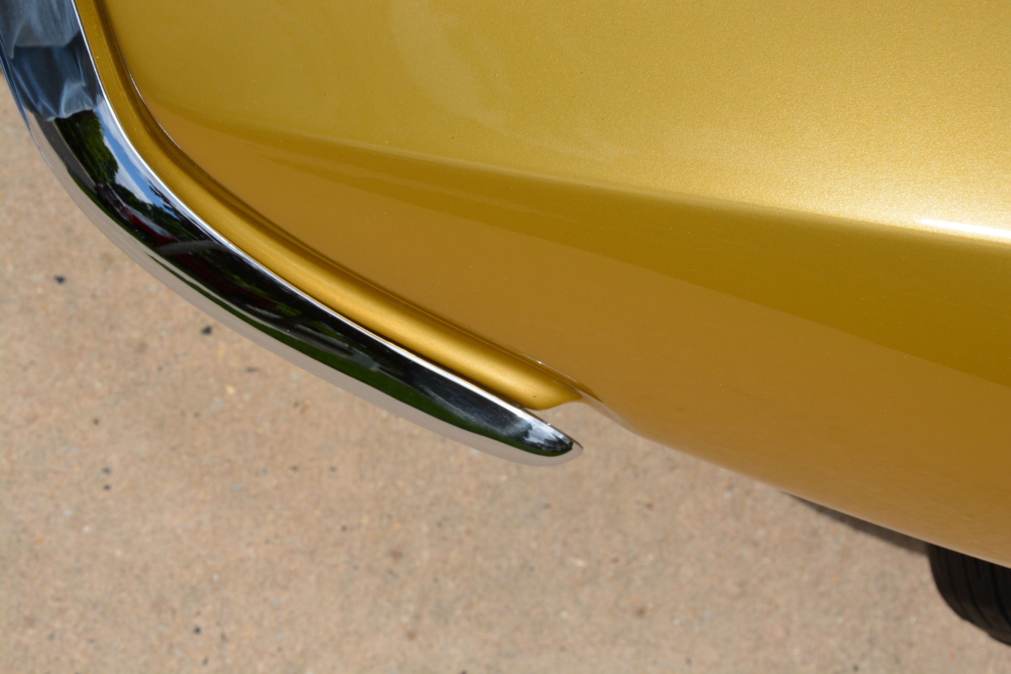

Left side of the same car. This bumper was on a 71 that I did a pre-purchase inspection of.
