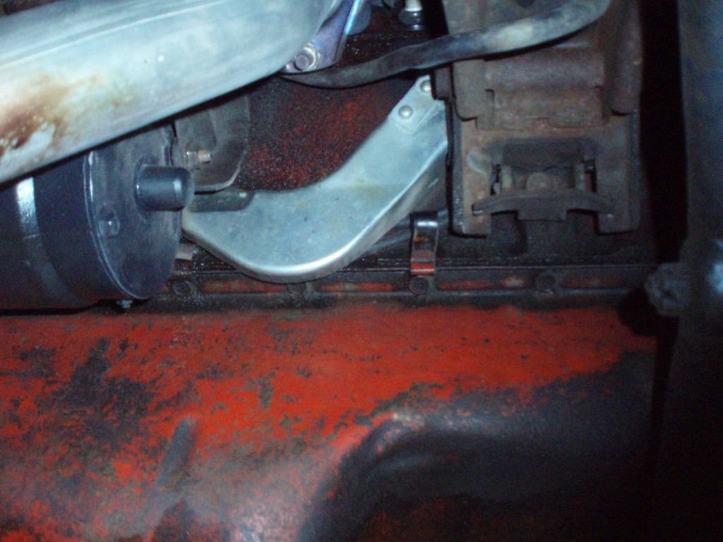

Would anyone have a picture of where the oil pan wire clip is located on a 68 327 L79. I cannot find any illustration. Ready to paint and forgot to install one on each side. Thanks in advance. Jeff

Jeff, Clip goes right at the bottom of the boomerang shaped heat sheild

Would this be the correct location Ralph ? Just found this.

Move it one more bolt towards the rear at the bottom of the heat shield

So, when I'm done, my wire routing will be similar to the photo that C6 Chevy posted, except without the boomerang shields.
I have the oil pan clip on each side, the long arm 4-slot clip at the back of the block on each side, and then the 2-slot clip above each motor mount for the 1/3 and 2/4 wires to clip into.
