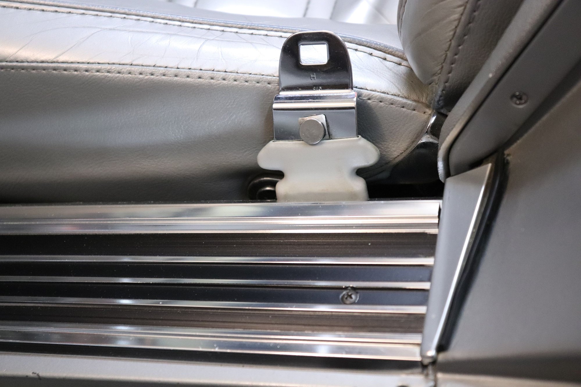

Male buckle of the lap belt from my '75 convertible, no optional A85 (shoulder harness) looks like this:
'75 convertible lap belt with pin
To answer your first question, it is my understanding the convertible lap belts all had the pins you reference, just like the coupes.
The set belt set in your picture is aftermarket. The seat belt lap extender in your picture looks to have an OEM style/shaped male buckle The missmatch between aftermarket female buckle and the OEM style male extender buckle is causing your issue.
