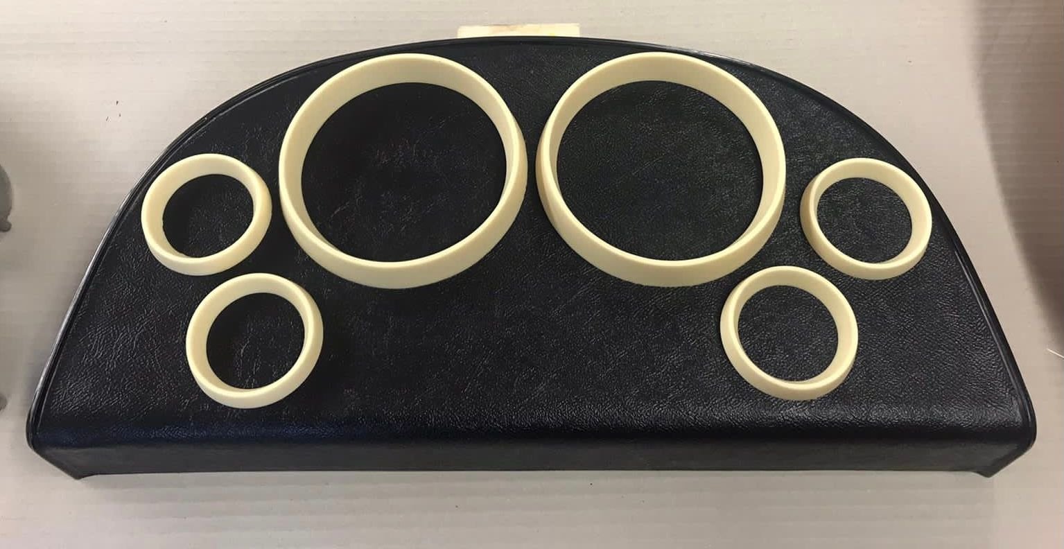

Good feedback - indeed, with parts I think we agree that NCRS enthusiasts need not apply, but we have been working to reproduce some of the more desirable parts that would at least make the car look correct to period. E.g complete moulded dash (incl dash pads) bumpers etc. They can use original hinges or adapt to more modern type kit car hinges. It depends on who is building for what purpose.
just this week we have refined a really neat gauge cluster replicating an original even down to the leather grain pattern all in fiberglass. The bezels are separate so could accommodate original gauges or the panel could take autometer (or even C3 gauges) were you so inclined.

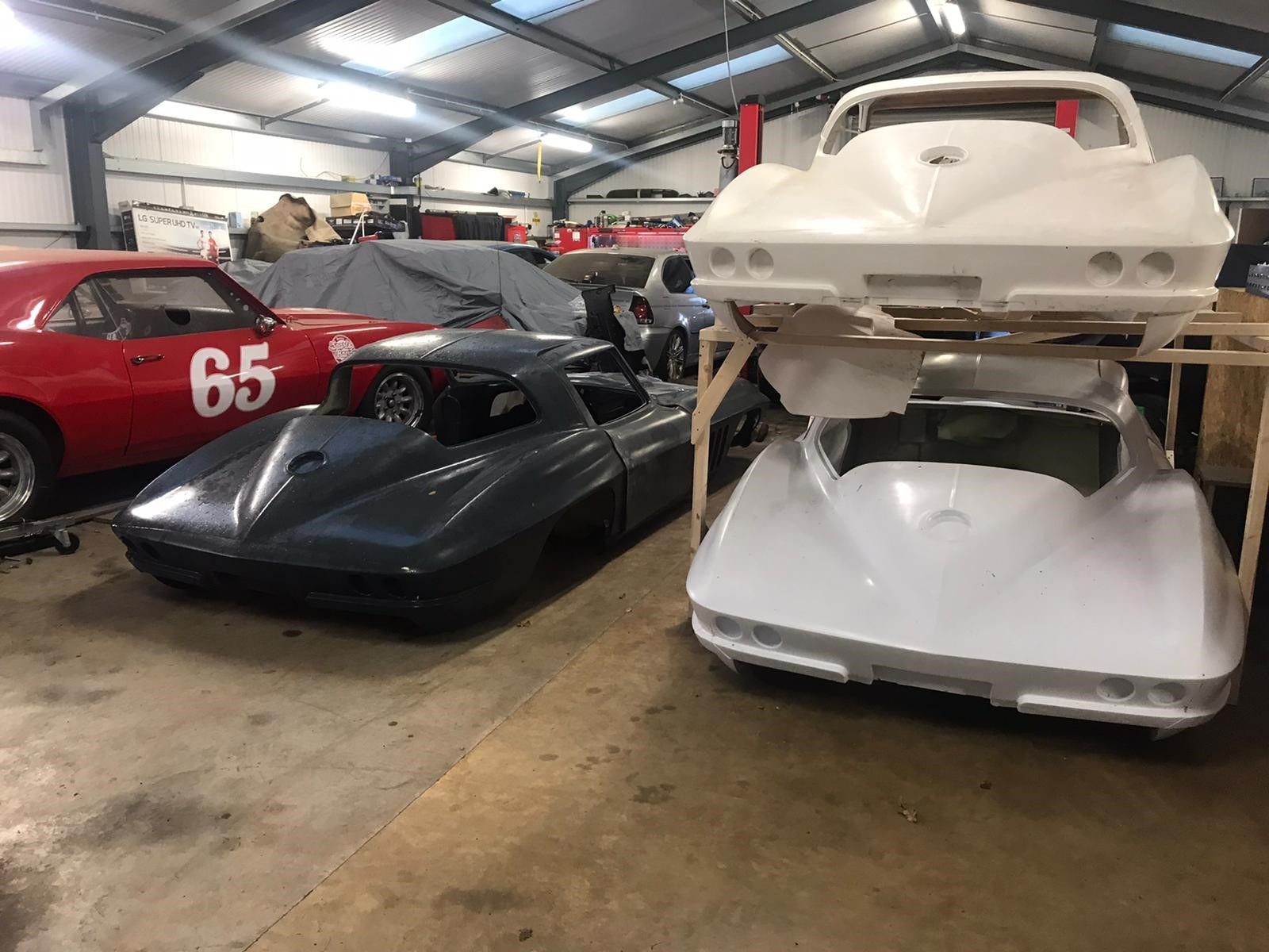

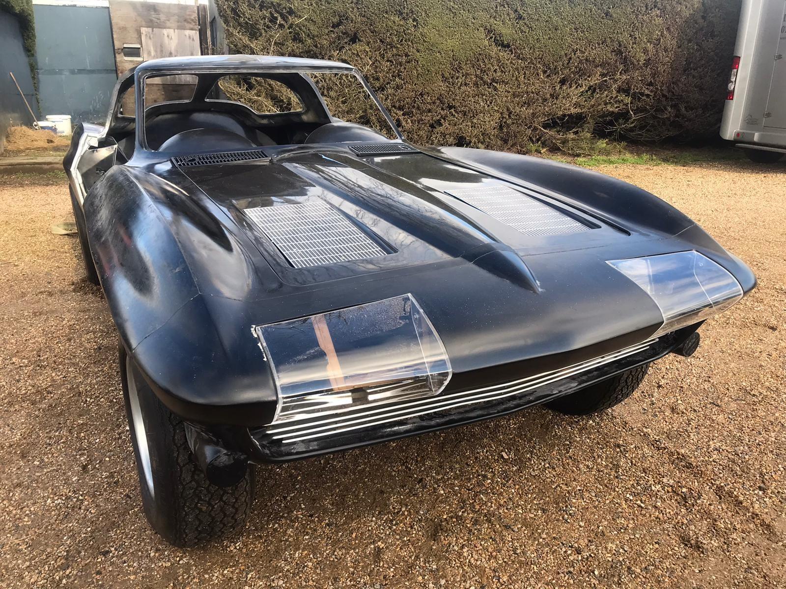

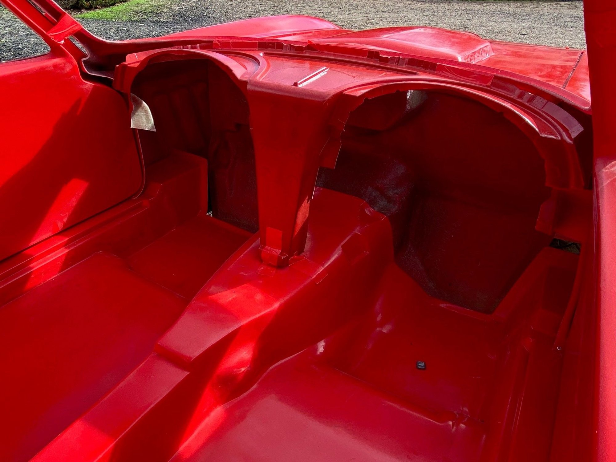

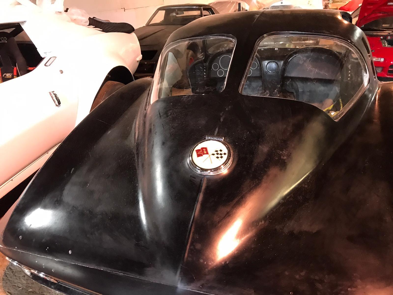

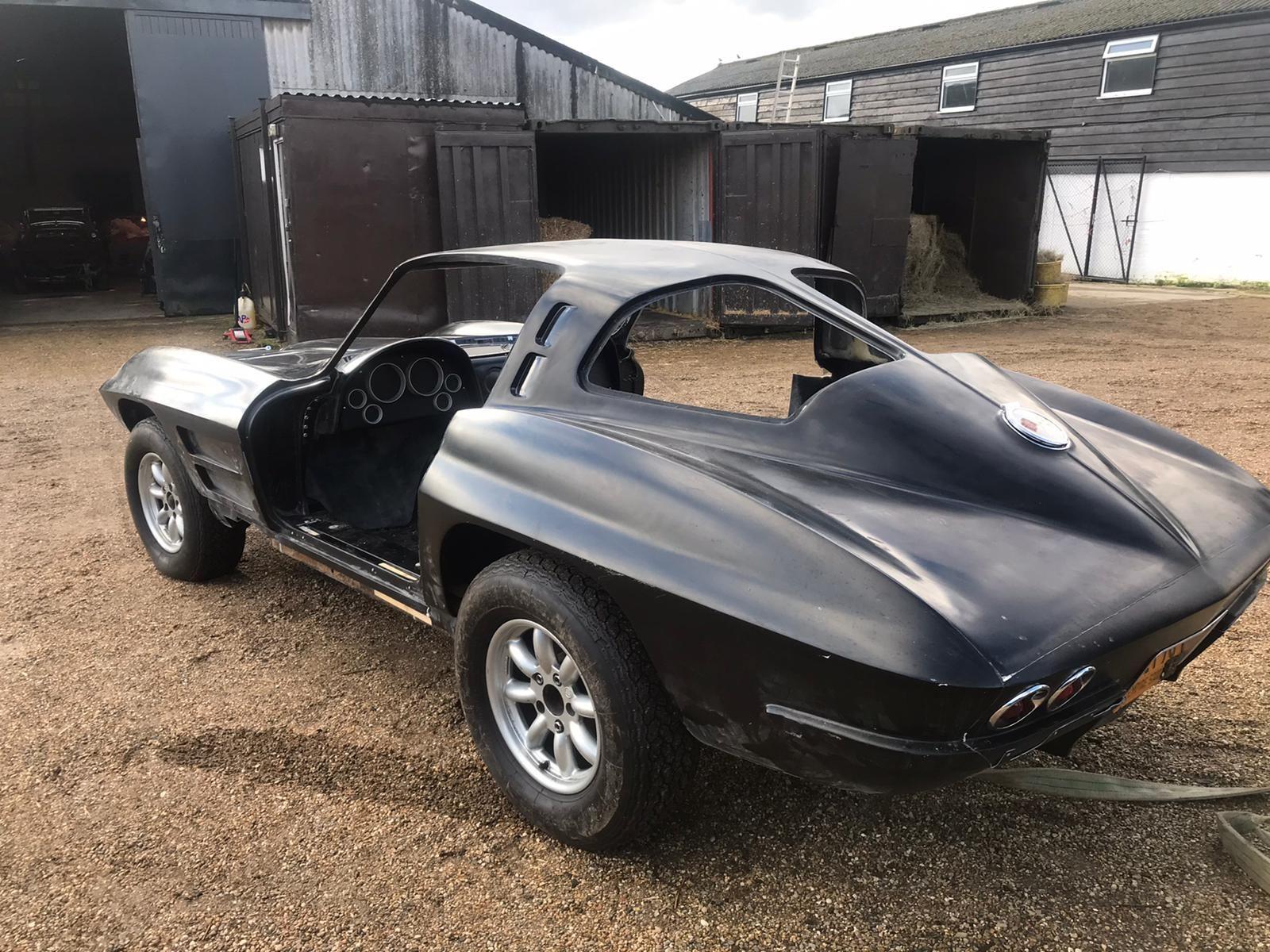

Yes! We have been busy. The our first few 63 Coupes have emerged from the mould and we have been working on refining them. Fitment is great and we now have a demo car that is pretty well assembled.
all original parts like lights, glass, trim, chromework etc fit nicely.
the body seen in the pics is mated to a worn out frame from a 76 that we use for mock up purposes.
the rear windows are poly laminate and we are exploring whether they should be bonded in or traditional rubber.

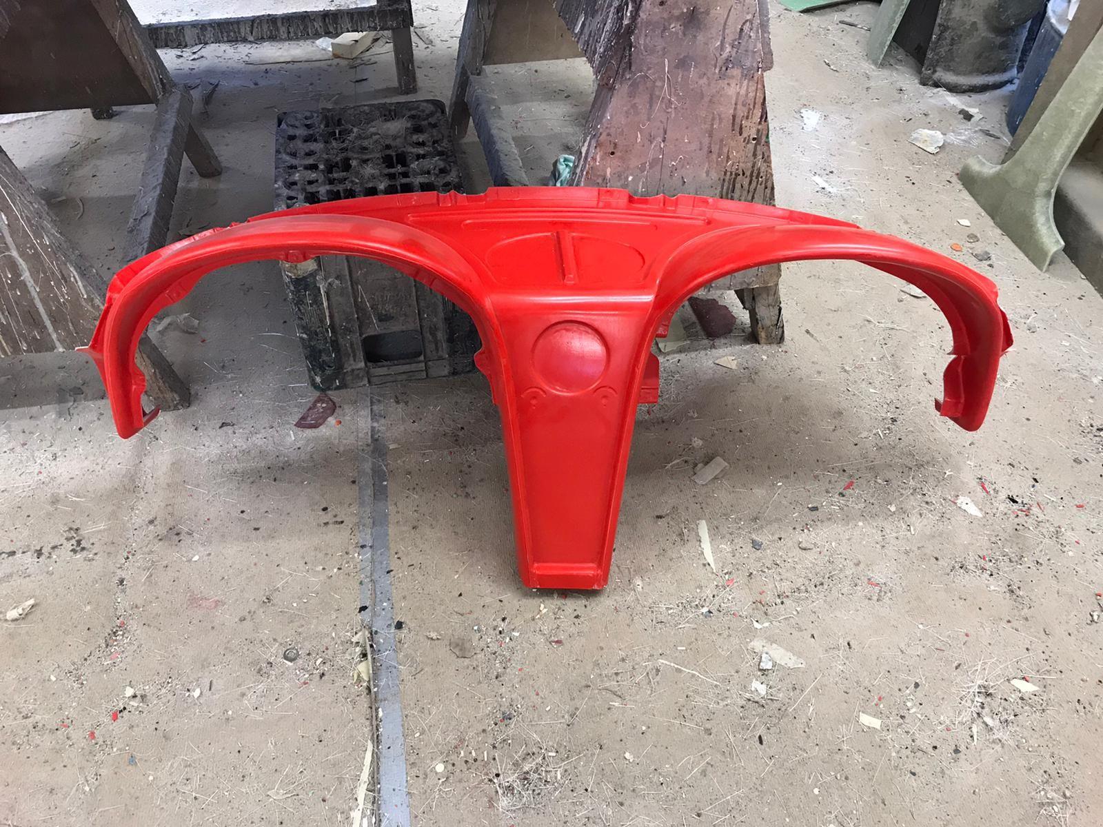

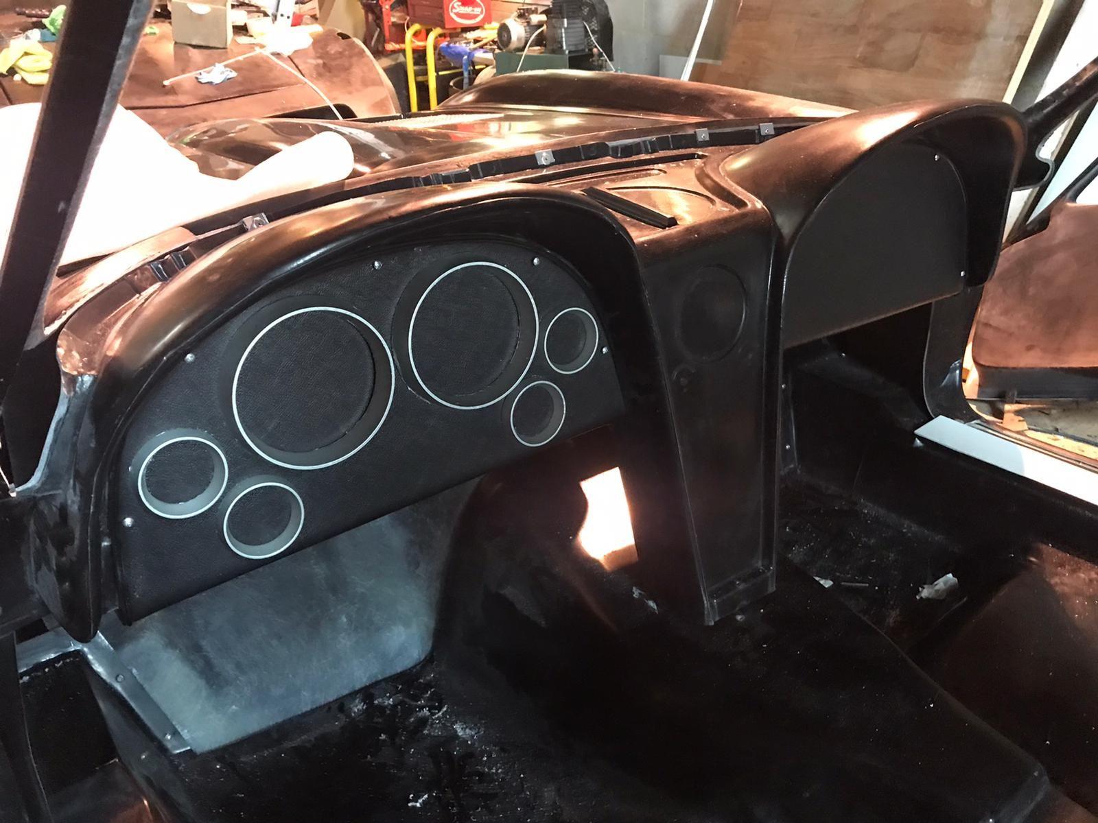

we have also been working on our one piece dashboards and glass front/rear bumpers.
here are some pics to whet the appetite...
