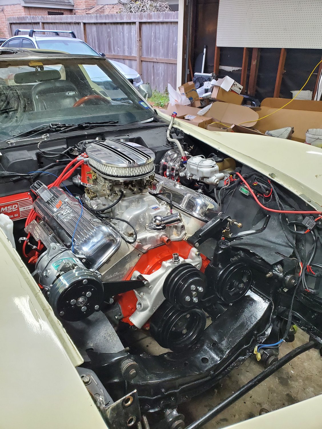

Hey guys,
I have a 1973 with a 454 with AC and Power steering and a left side alternator mount. The mount measures 7.5 inches between the mounting bolts.. however every alternator im finding for this car only measures 6.5 inches. The previous owner had a chrome alternator on this car but it doesn't have any model numbers or anything on it. Does anyone know what alternator I need? No one lists the mounting bolt widths on the specs.

Thanks. I know the block isn't original and it has a ton of upgrades (heads, intake, cam, headers etc...). The alternator bracket goes beneath the alternator rather than over the top like others I've seen. I had to replace the bracket as it was cracked. I only found it at corvette mods of all places..
You can see the bracket in the pic here

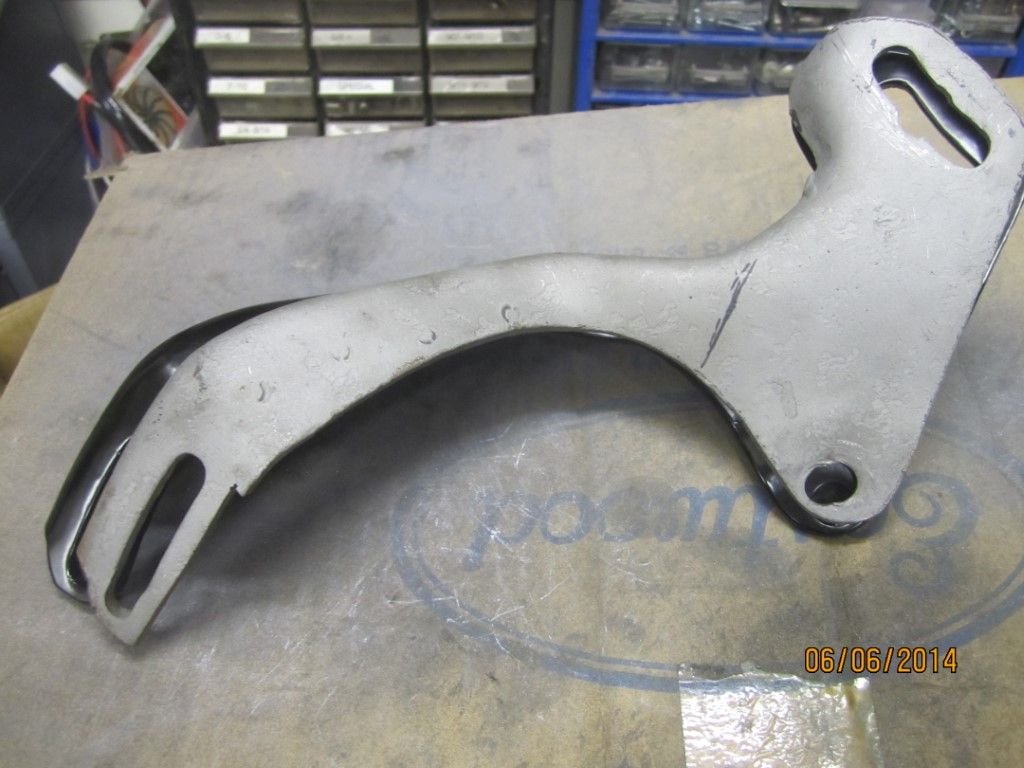

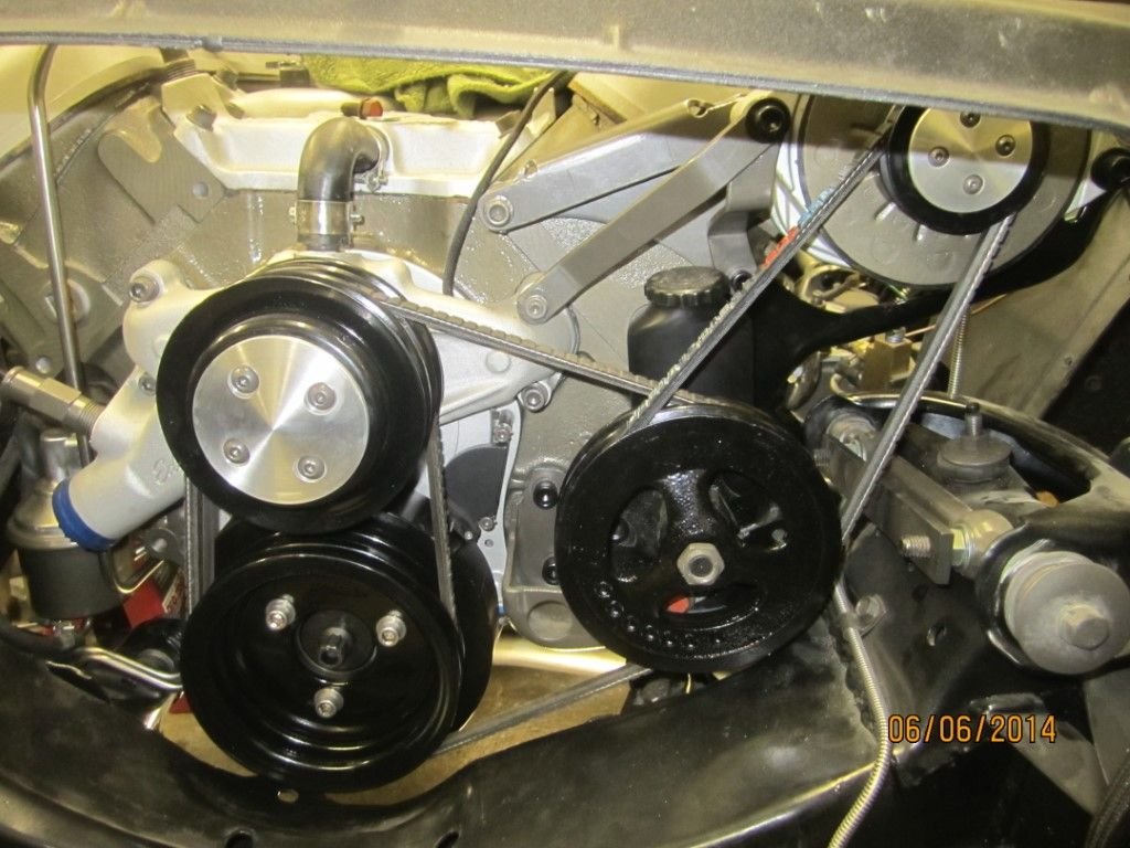

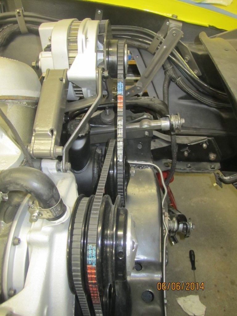

Here's the stock setup from my 72 except I extended the one bracket for the larger CS144 altenator

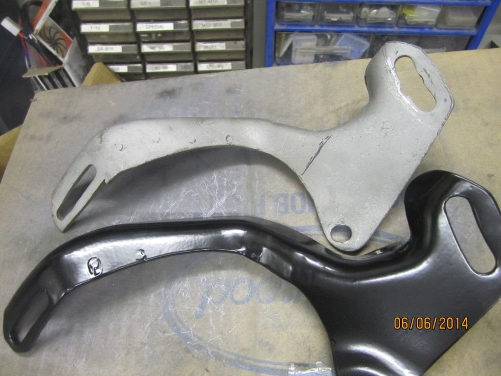

Then I'd say it's been massaged to fit the larger alt. I believe the bolt to bolt is 7.24" rather than the smaller original SI size of 6.6"
Blasted one is the original and the black powder coated is the extended
M

Again, strange that it's that big.
Anyway, make sure you keep the pulley from the old alt, the groove location is out farther since it's driven off the PS pulley instead of the engine/waterpump
