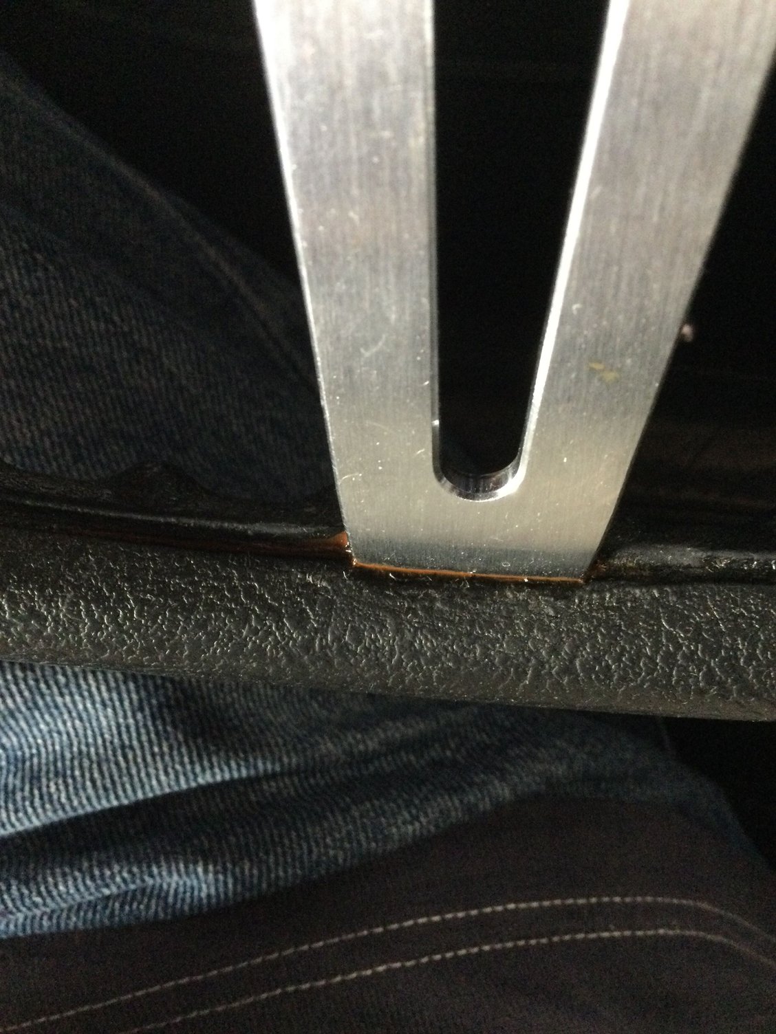

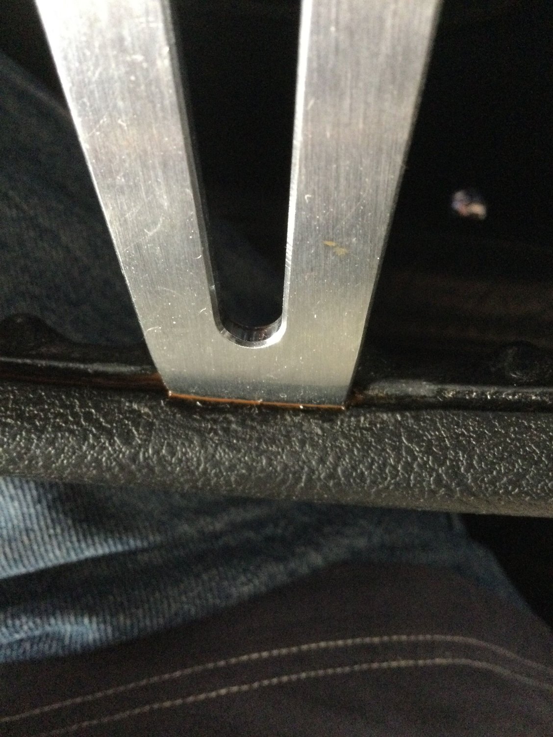

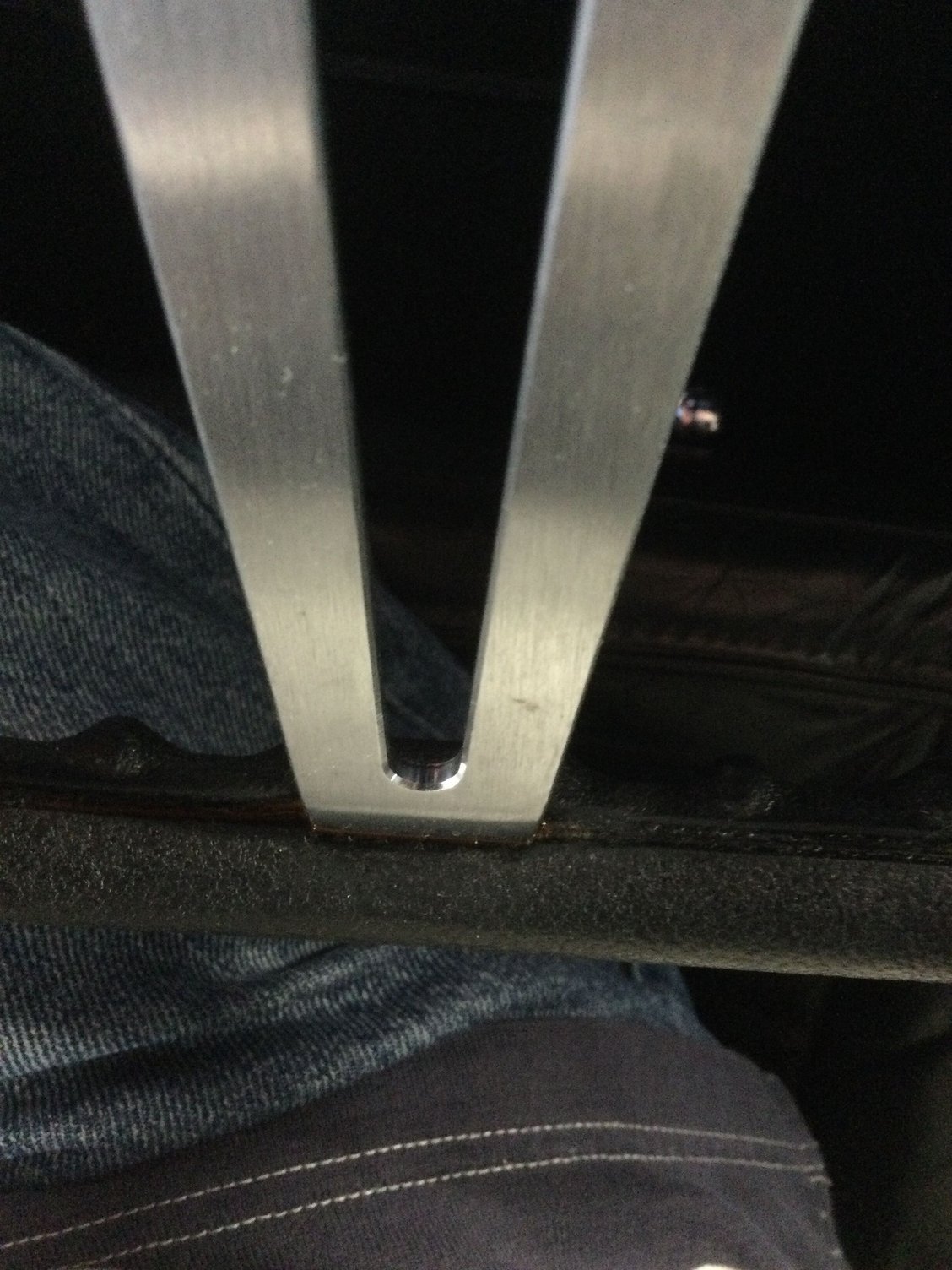

I have a 73 Convertible with a stock steering wheel that looks to be in very good condition. There is a brown substance that is “Leaking” at the bottom of the metal spoke where it meets the vinyl/black material. I clean it off, and it returns after a week or so, seems to be worse in summer, but still “leaks” during colder weather. This steering wheel may have been reconditioned,
Brown looking stuff where metal spoke meets black vinyl/rubber
The brown stuff is “leaking” on the front and back side of the metal spoke
because there are no cuts, scrapes, or splits. Just wanted to know if anyone else has this problem. The wheel is such good shape, I hate to change it. Thanks in advance.

Hello. Just curious if is only on one of the spokes?

The brown stuff is only “leaking” on the bottom spoke, which is the one that is Vertical when the car is parked (wheels straight ahead).
