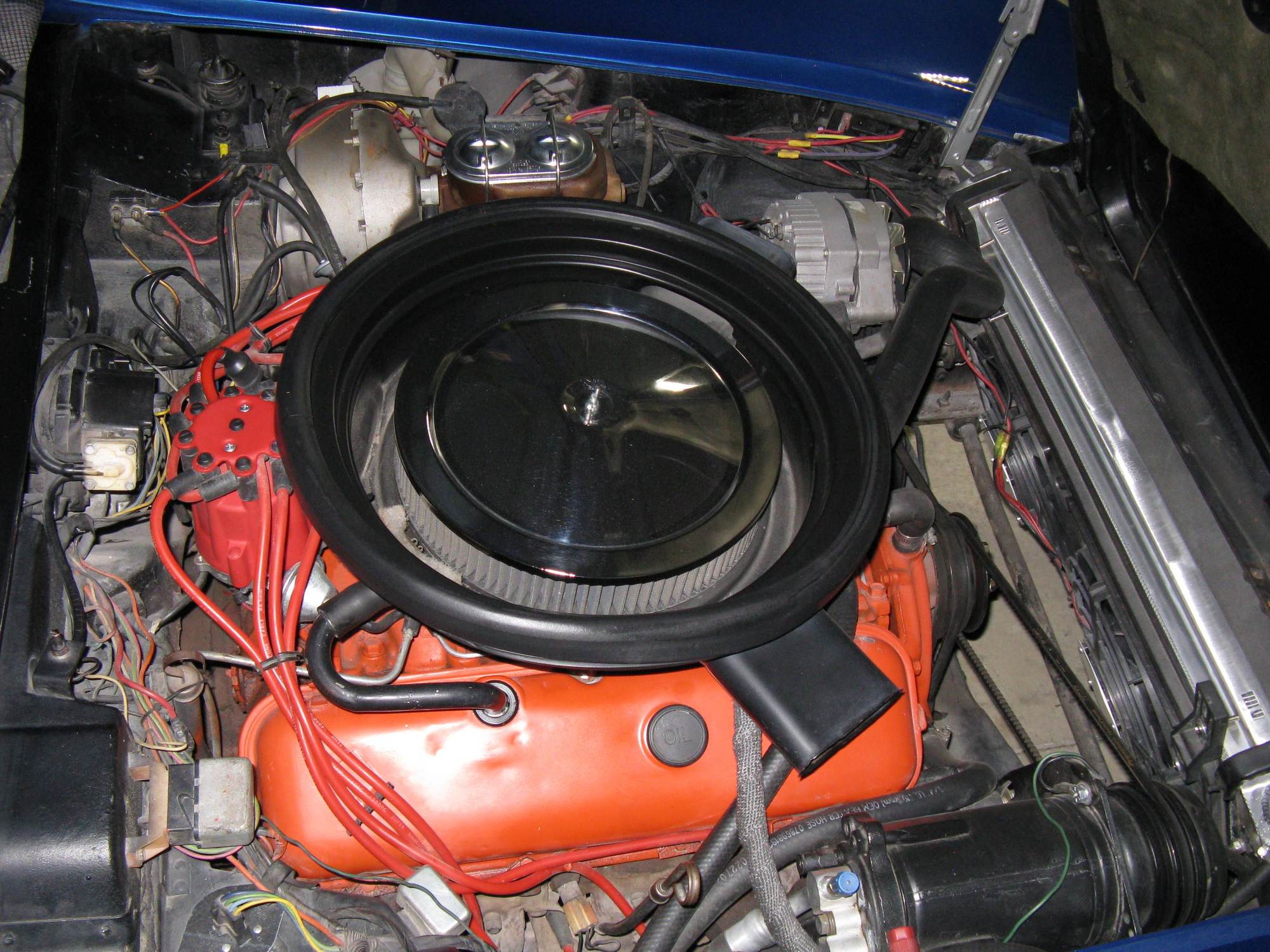

Those wires are from my aux fan, don't have them plugged in now. When I get my new switch installed will get them back under the fender. The blue wire I assume is ground for it.

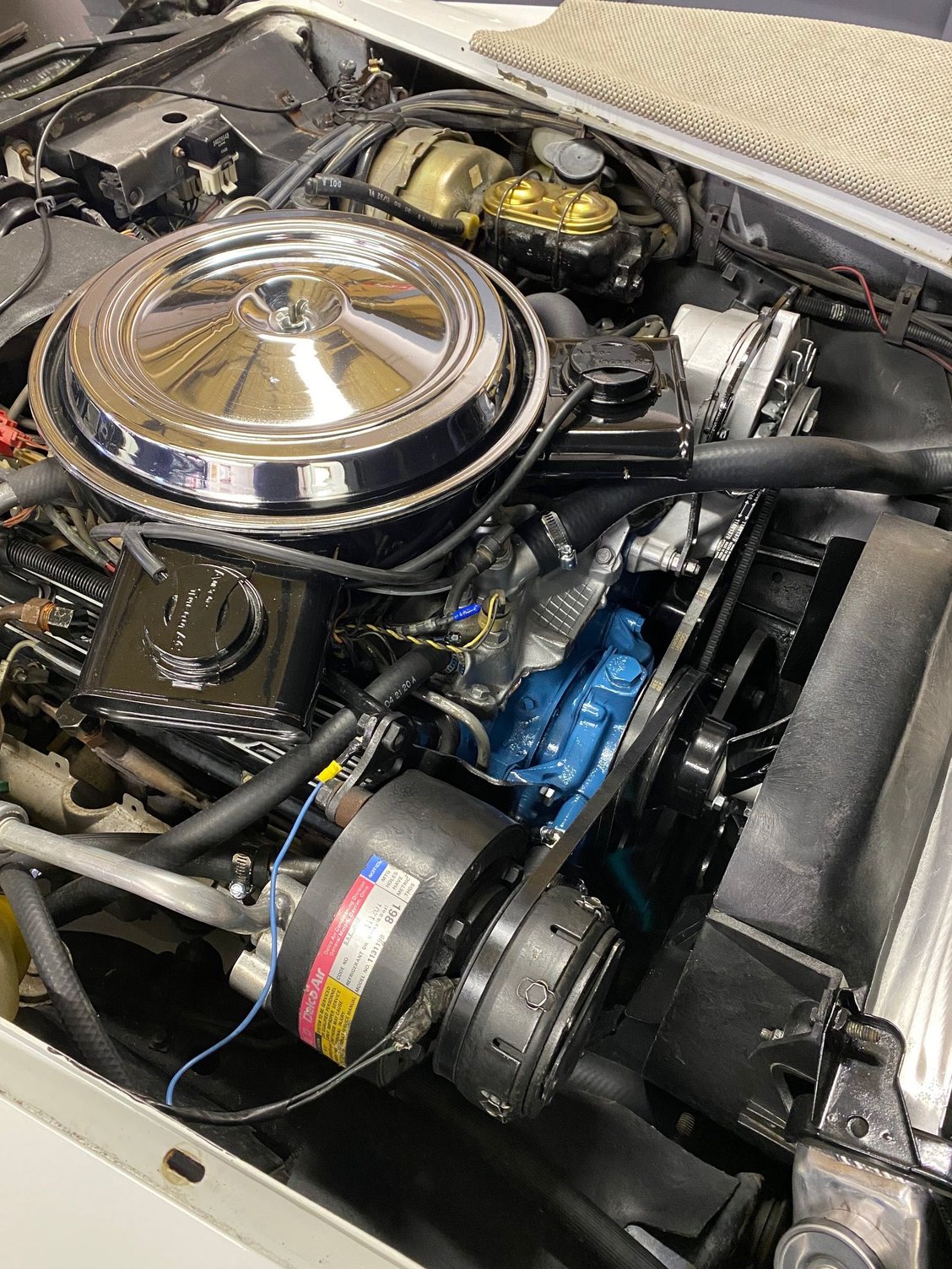

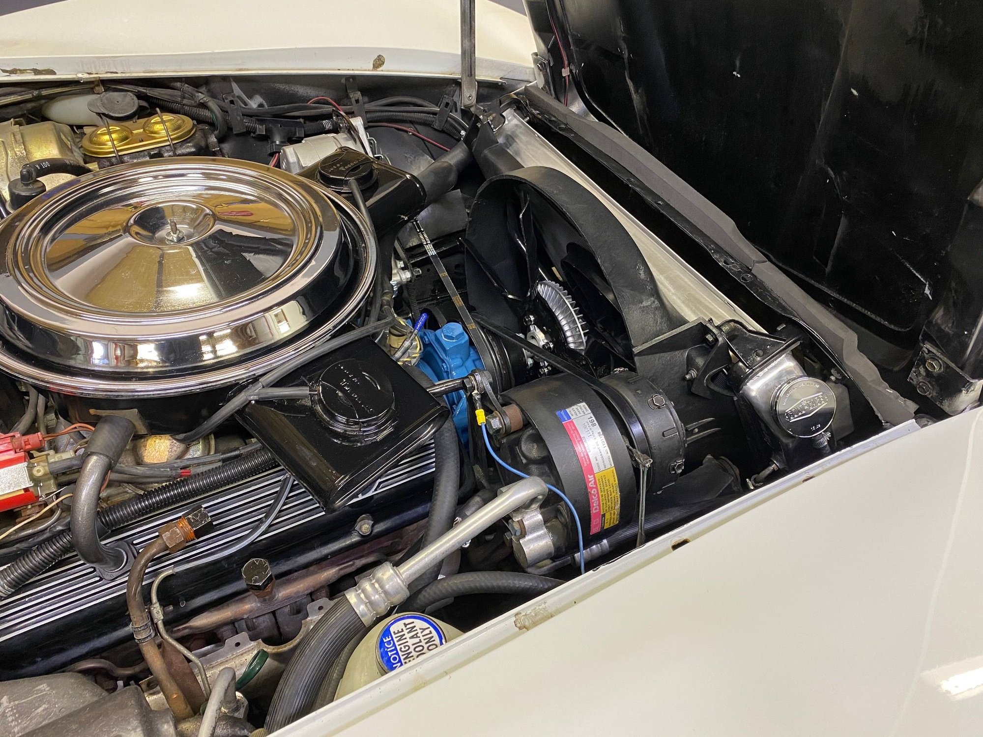

okay Tom...the dang trouble with Hi-res pix is I see THINGS! lol.
Fold the upper 'A' arm splash flaps UNDER the 'A' arm so you can see the top of the shock. This is what those 'T' slits are for.
When you DON'T fold them under, they can flip up at speed and get caught in the fan belt.

Appreciate the tip! was not sure how they worked, good to know! Thanks

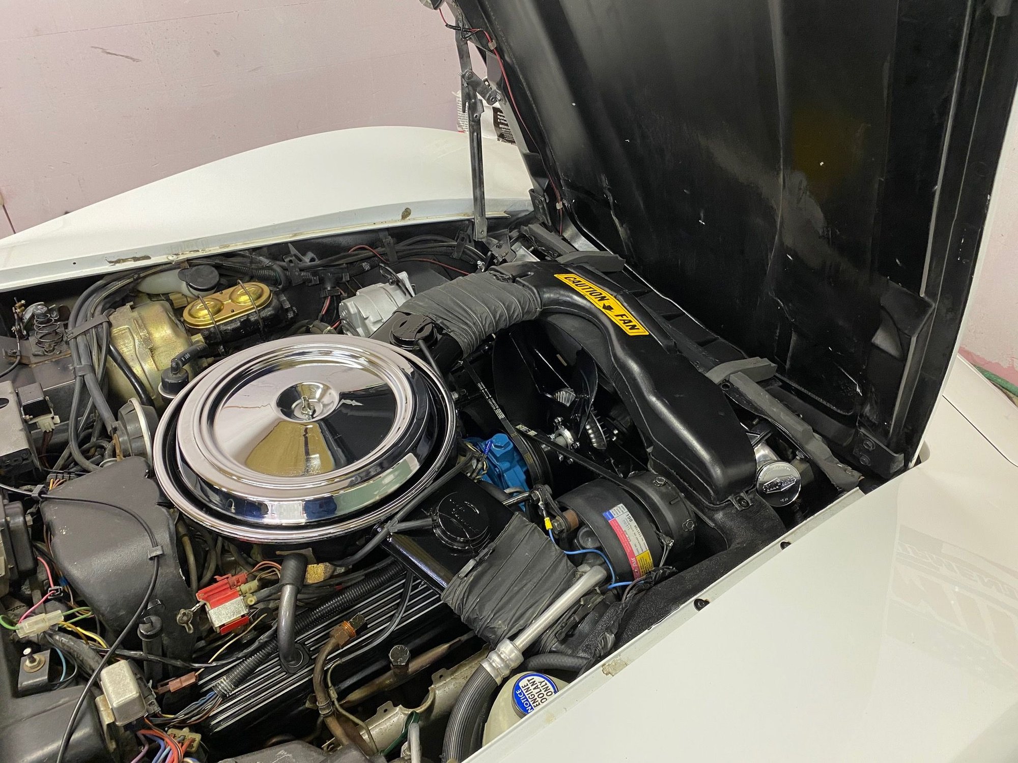

Here is mine after all finished, It was suggested to me to bring cool air in the way GM intended to do so mine is stock now. My little 190hp motor does not make much heat though, maybe someday! lol..
