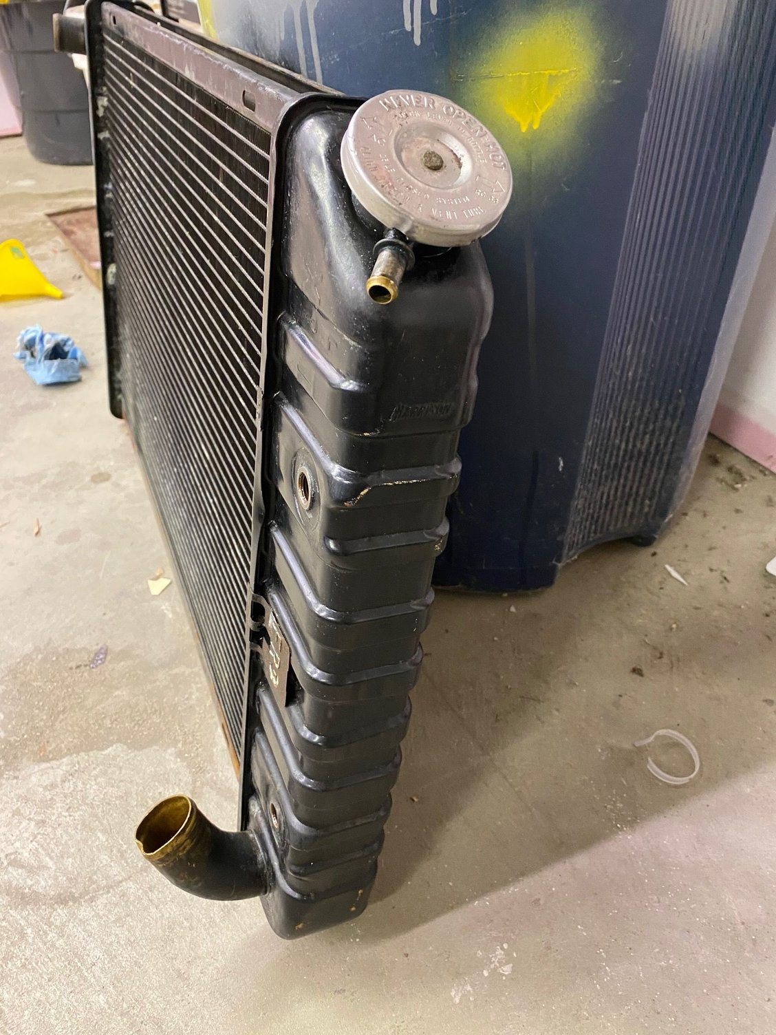

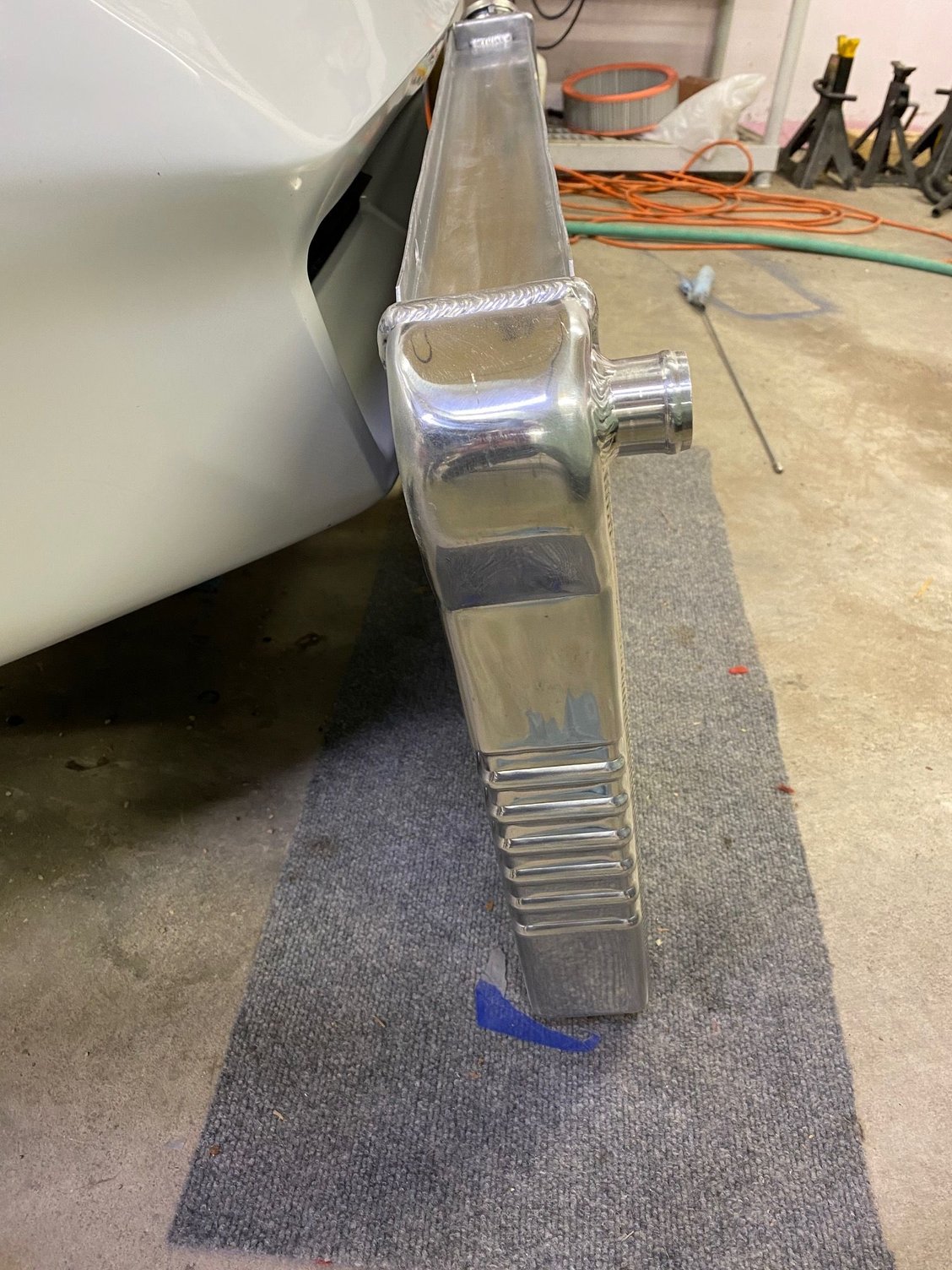

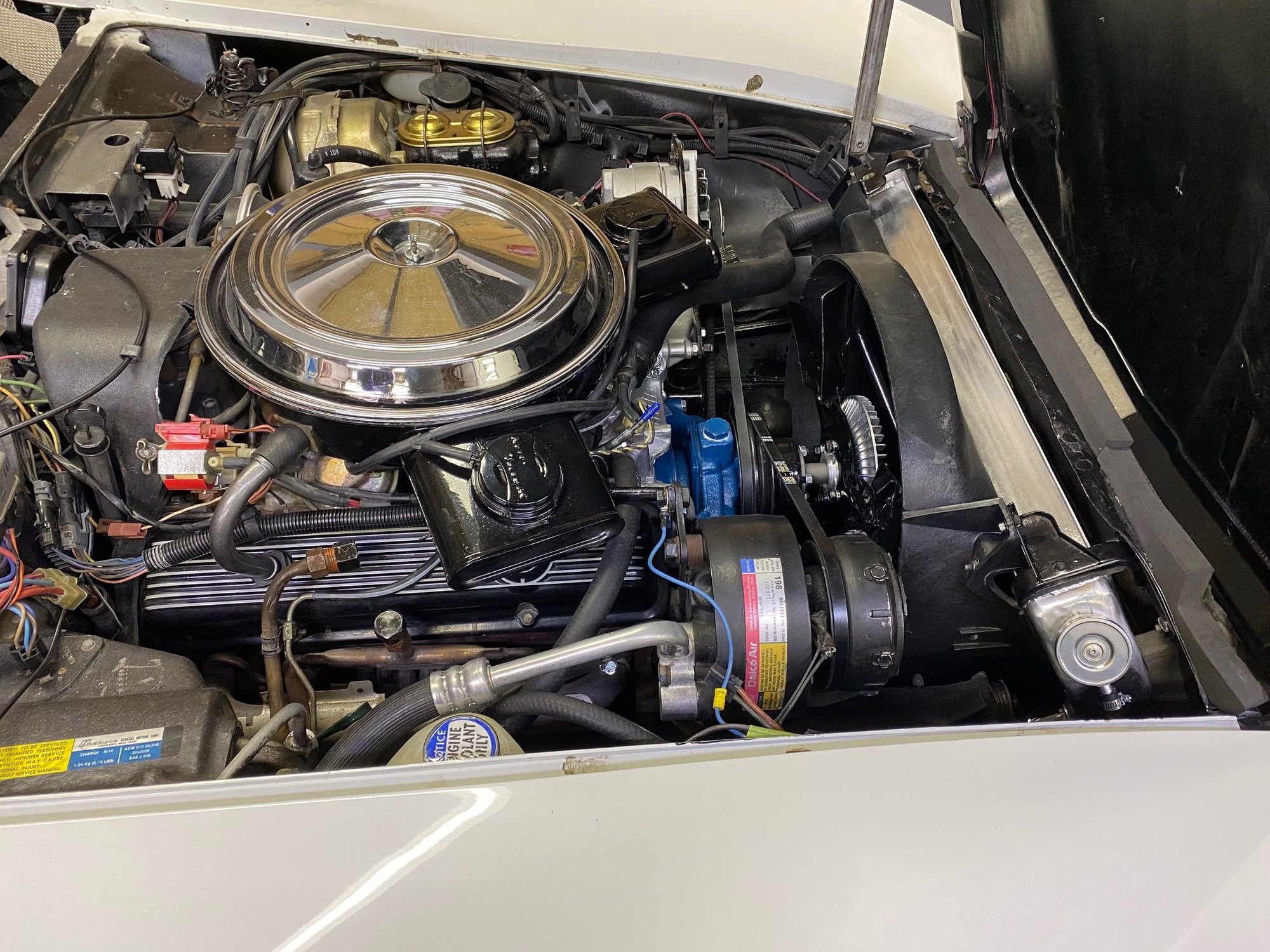

Radiator came today, CHV718A Cold Case, quality seems great with perfect condition as receieved. As for direct fit, well not so much...spent about an hour carving rubber mounts that I had to make fit. The tanks are about 1/4 " wider than my stock unit and the main core is over 1 1/2 wider. Looks like all should fit with my stock shroud, tommorrows project after a dry fit today. Summit got me a great price on their normal super fast shipping.

My '76 was a direct fit. Hope you don't have too much difficulty getting it in. It is a nice rad though. GL!
Is your outlet pipe dented a bit?

Pipe looks good, might just be the picture. Might have to trim the radiator mount base some too.. the drain plug seems real close

I am the second owner, car had 19,540 miles on it. I posted the radiator serial or model number on an earlier post and was told it was correct for a 79-81. The side tanks on CC are 1/4 inch thicker, the center core section is 2 3/4 compared to the old at 1 5/8. New unit has 2 core design with 1 inch tubes.

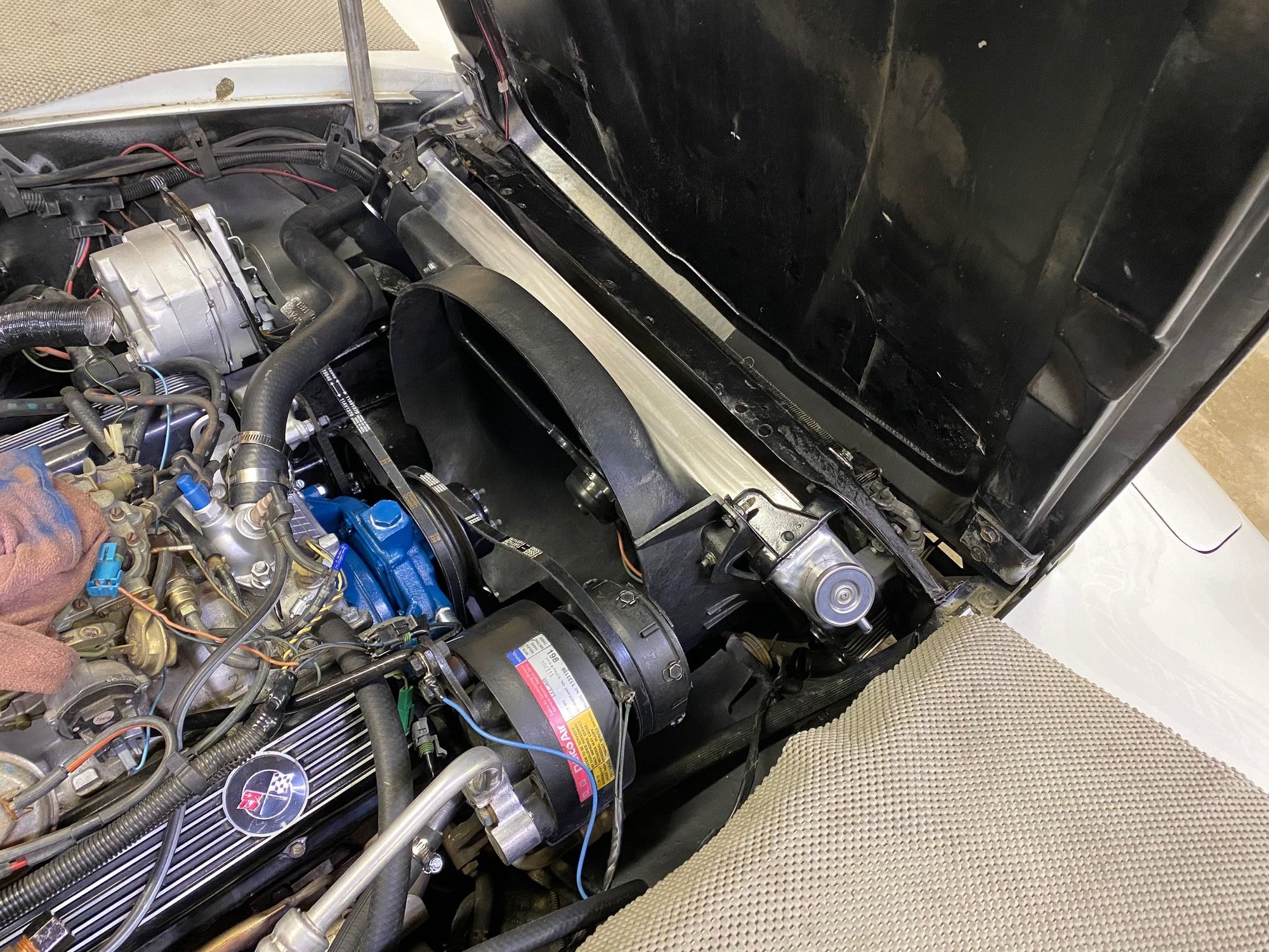

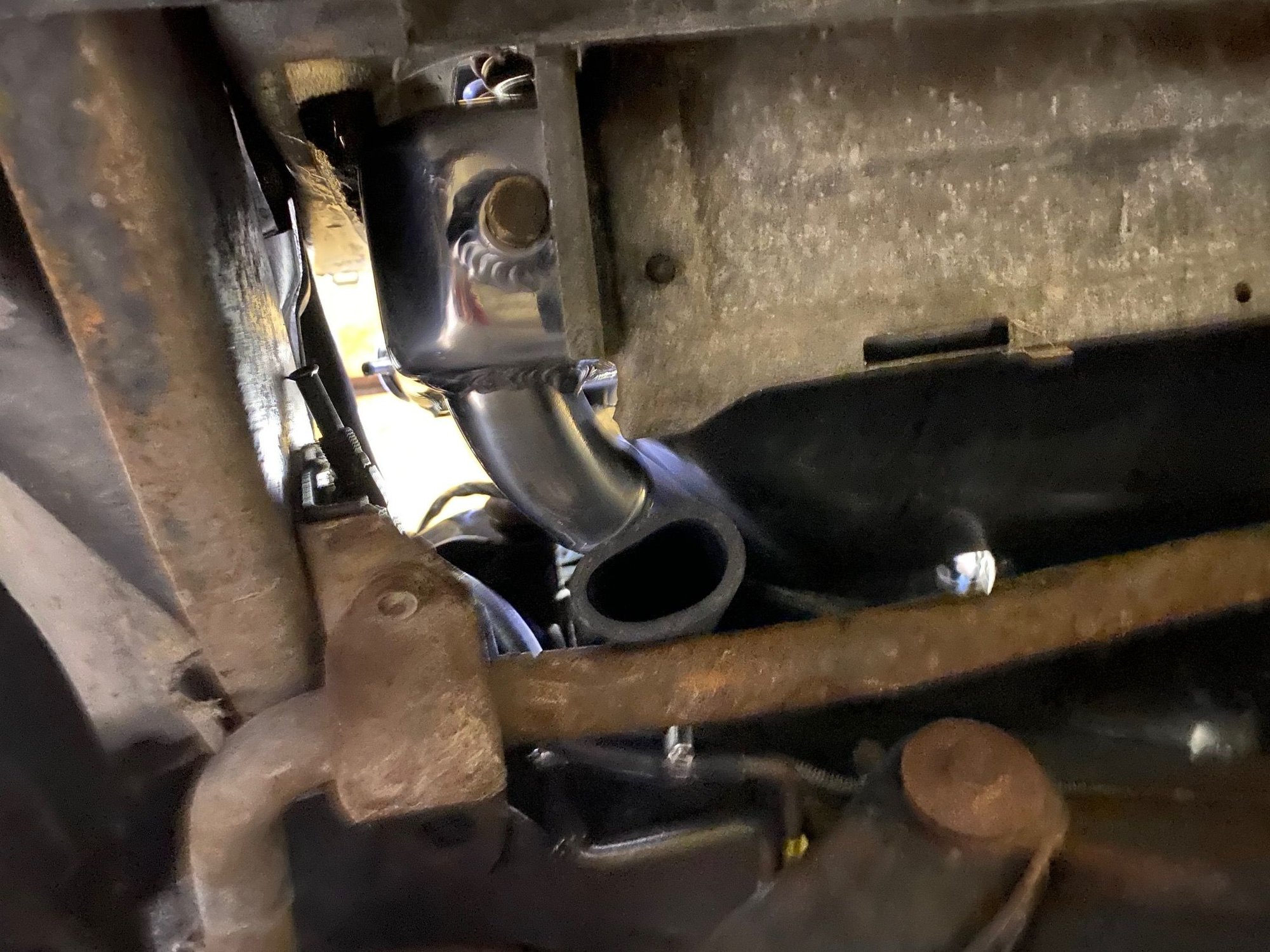

Took me a couple of hours working by myself but after a few dry runs got it in and fits like a glove. Only real issue was the upper and lower rubber mounts, had to trim all four to fit properly. Guess I could have stuck them in as is but wanted it to be right. Rookie mistake for today....thought I could put in the lower radiator hose after shroud and radiator installed. Survey said....NO! Out came the radiator and shroud then back in again. Got some new foam for both sides in between radiator and support too. My car is A/C equipped. Replaced drain plug with a new brass unit so can use a 1/2" wrench to remove. Done for today, tomorrow its hook up transmission cooler lines and lower hose...then fill her up. That is unless I forgot something?

Is pretty snug at the drain plug but think it will work without cutting any metal.

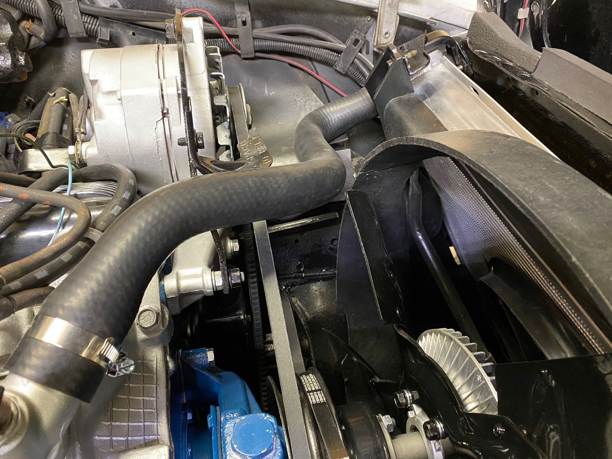

Well all finsihed today, except for adjusting the upper rad hose. need to turn it so its not so close to the fan blade.....who knew! learning a bunch these days. My aux fan runs all the time so ordered a new lower temp from Corvette Central, should be fun putting in! Thanks again to all for the tips and help....as Arnold would say: I'll be back! lol

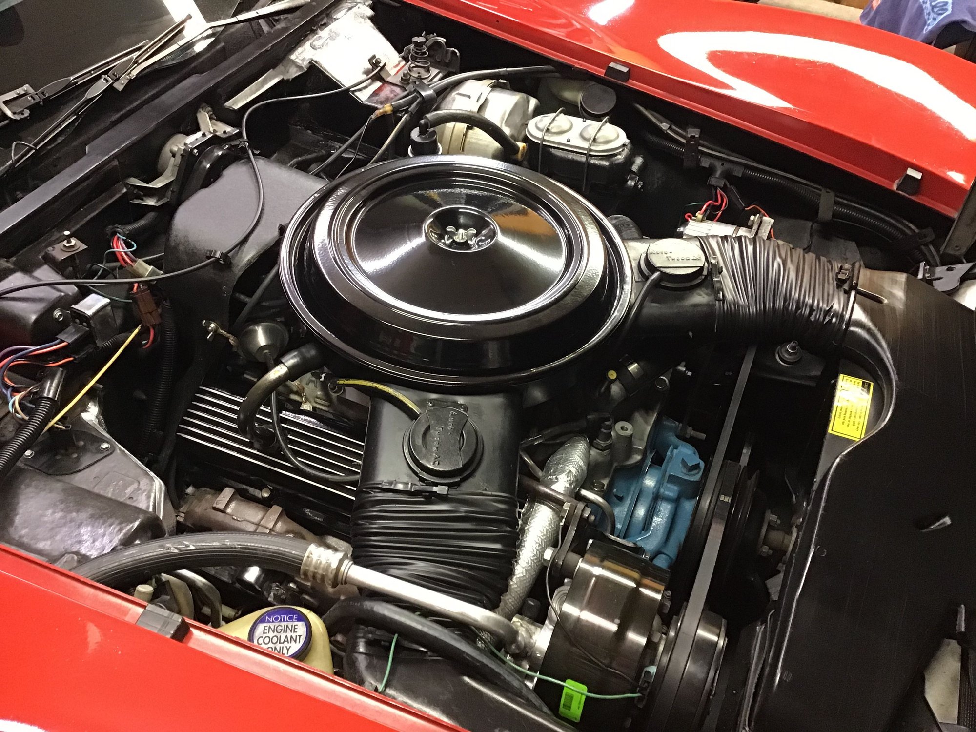

Yeah, so much for the local parts store having the right color! Told me it was correct but obviously is darker blue...cleaned and sanded the front of the motor then shot a coat and thought, hope this dries lighter to match the balancer..nope. Oh well, clean looking ...next time will order from Ecklers or someplace that has the correct color

Happens to the best of us! Bought a can of extra-high-heat SILVER engine paint. Schpritzed the whole engine (VW)...'geez this is loooking kinda greeny-blue!'
PONTIAC engine color in the can, with the wrong label. I know, I used to own a 69 GTO. Ram-air 3
#$%^ -it get a can of Chevy orange! {Some NCRS guy somewhere just had a stroke!}

so is your and your garage is too clean..
get the AIM for your car..
also take a look at this..circled..something weird.. look at my pic for compressor and only 2 wires.. yours has a loose connector? and splices? maybe to aux fan?
