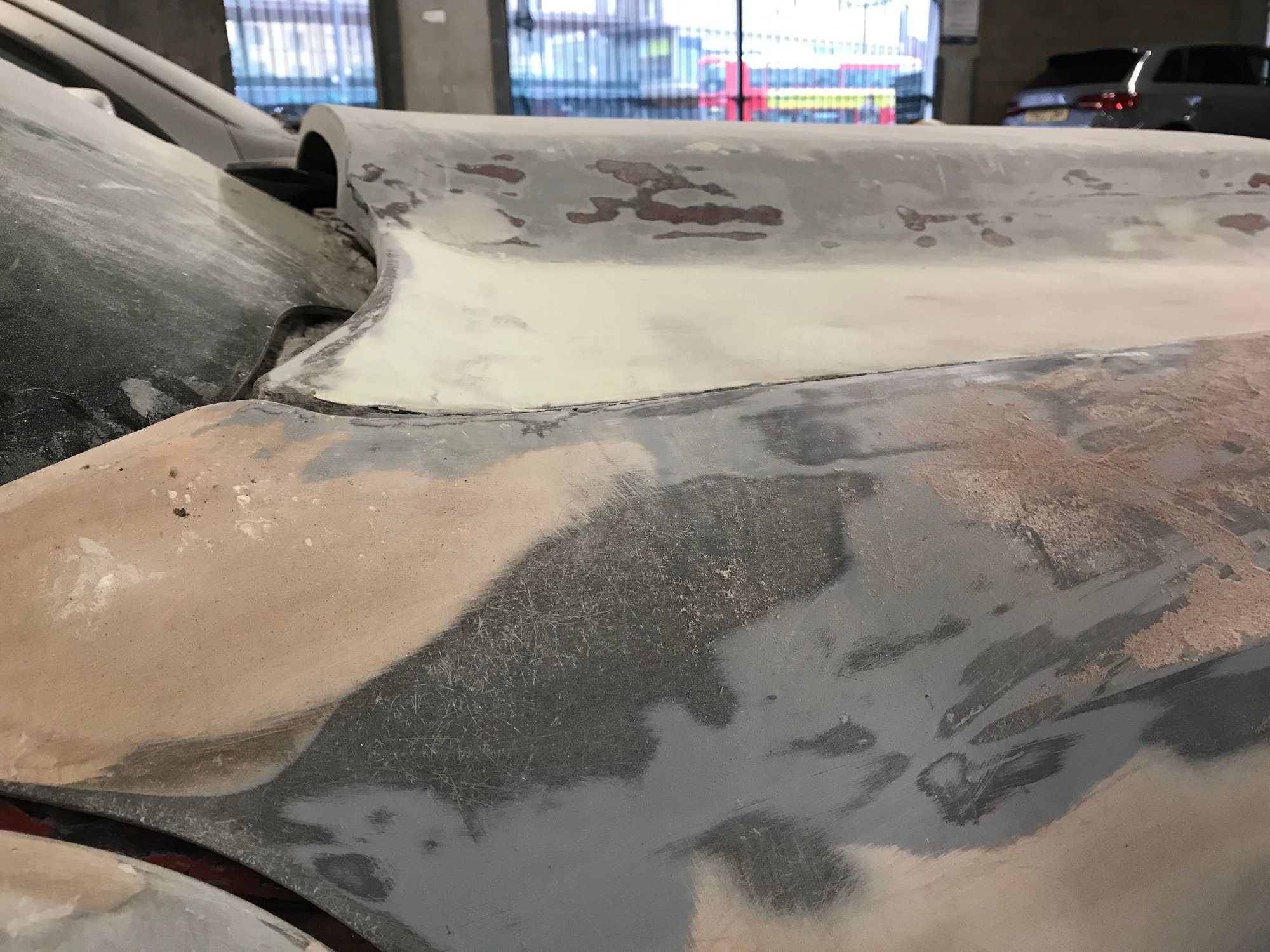

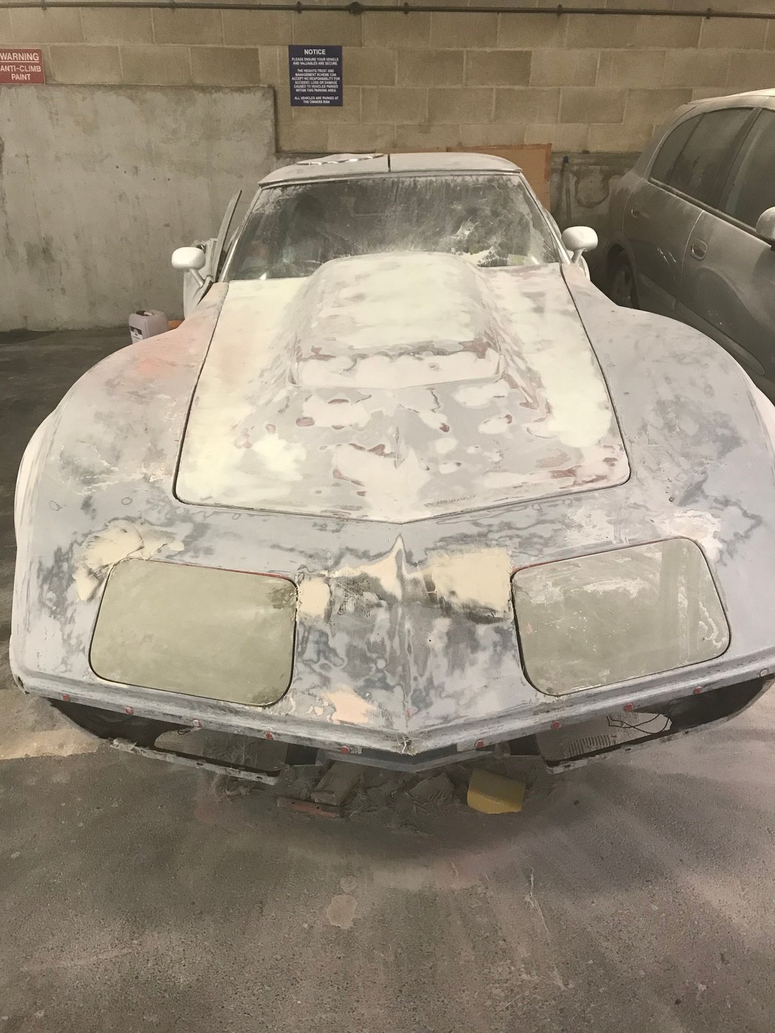

Any idea why the pass side of my hood is too high? Ive adjusted the pin so its at the lowest it can go and still latch but its still too high, all other alignment is perfect. You cant press the hood down any further I’ve not found any other posts about this before, only to do with the nose being too low.

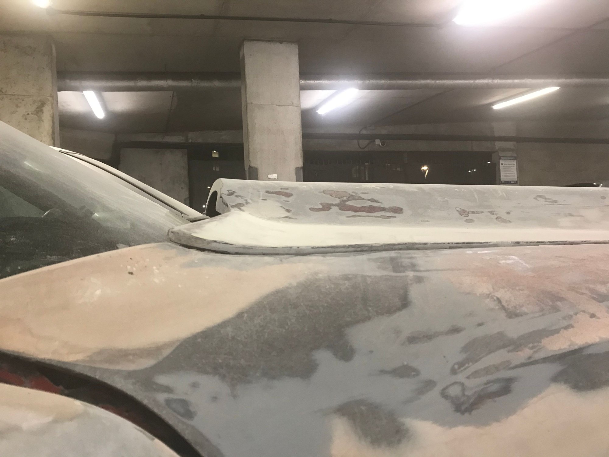

Removed the air cleaner and the rubber bumper but no difference. Upon removing the striker assembly the hood will press down around 1cm below the fender tip as shown in the pics

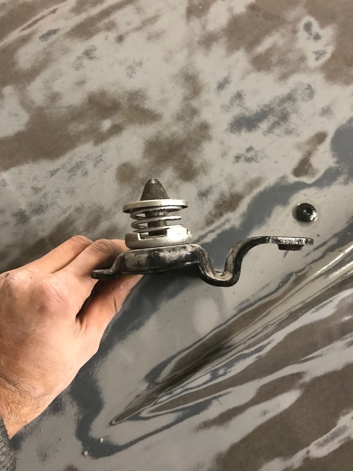

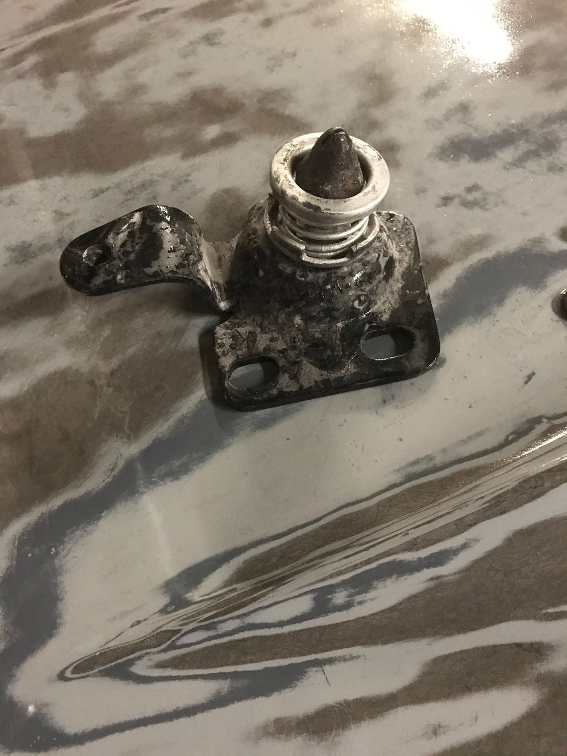

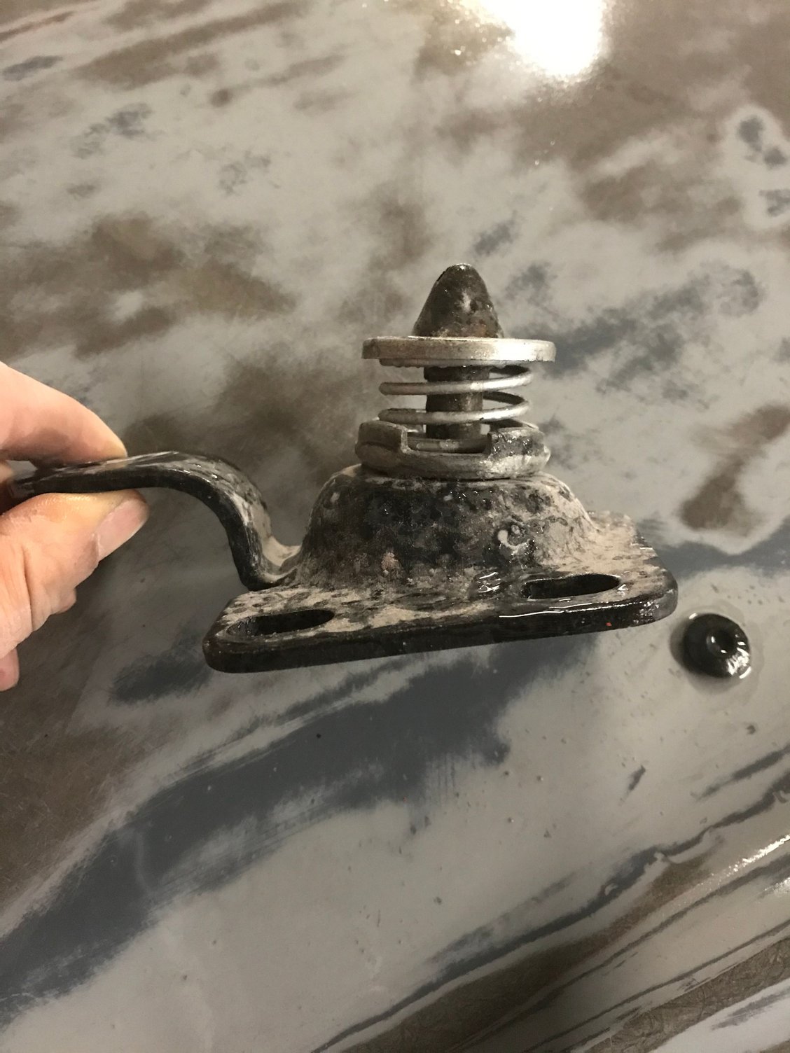

The car is a 71, didn't have a hood when I bought it and I have no idea what year this hood is from. Here is a pic of the striker assembly, you can see how compressed the spring is. I have a feeling it's an issue of the spring compressing and not the striker bottoming out but will investigate and confirm.

"Looks" like the right one for the 70+
You can try the bullet without the spring or the spring without the bullet to see where the interference is

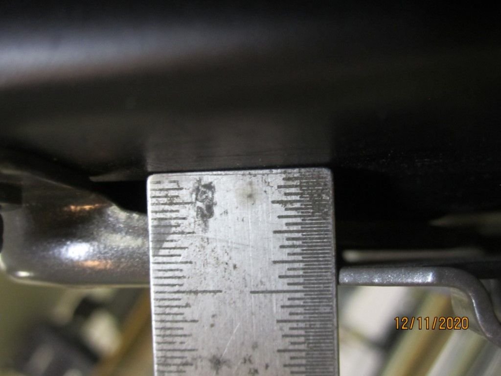

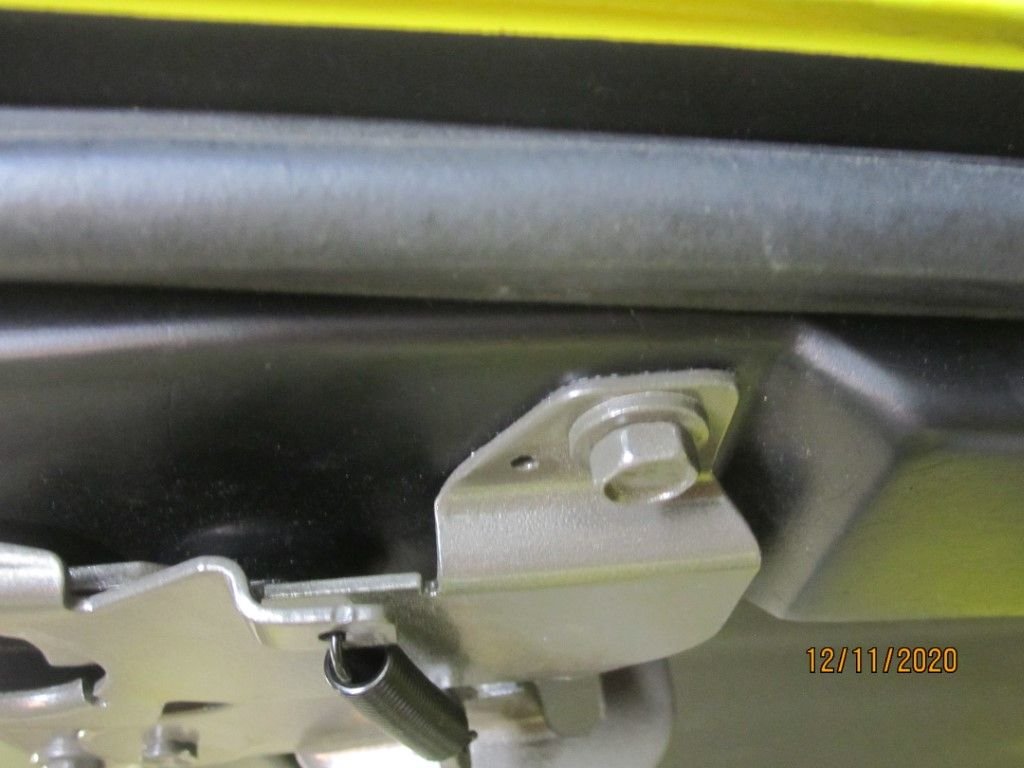

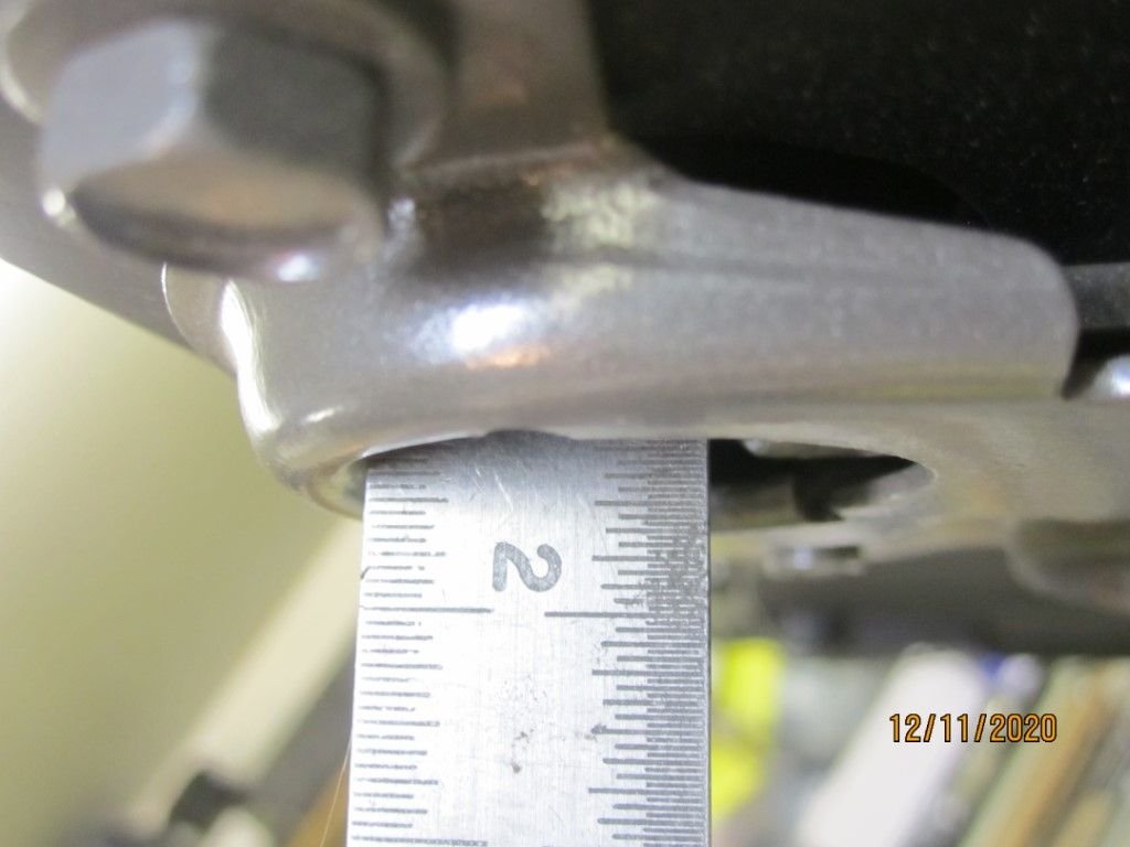

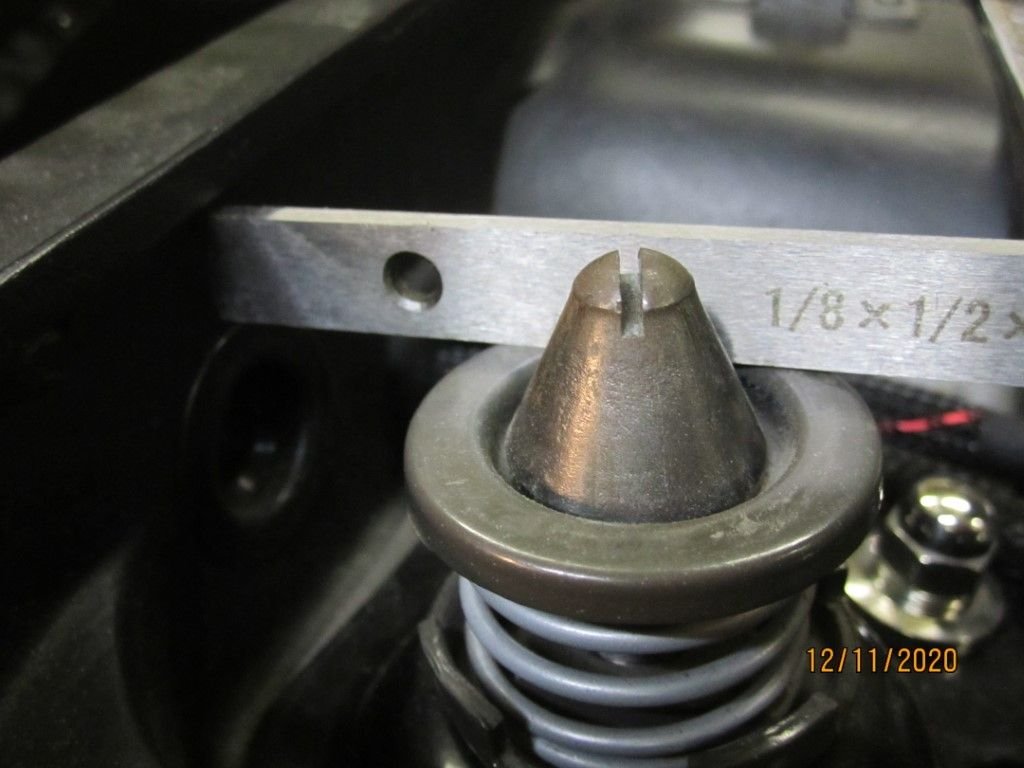

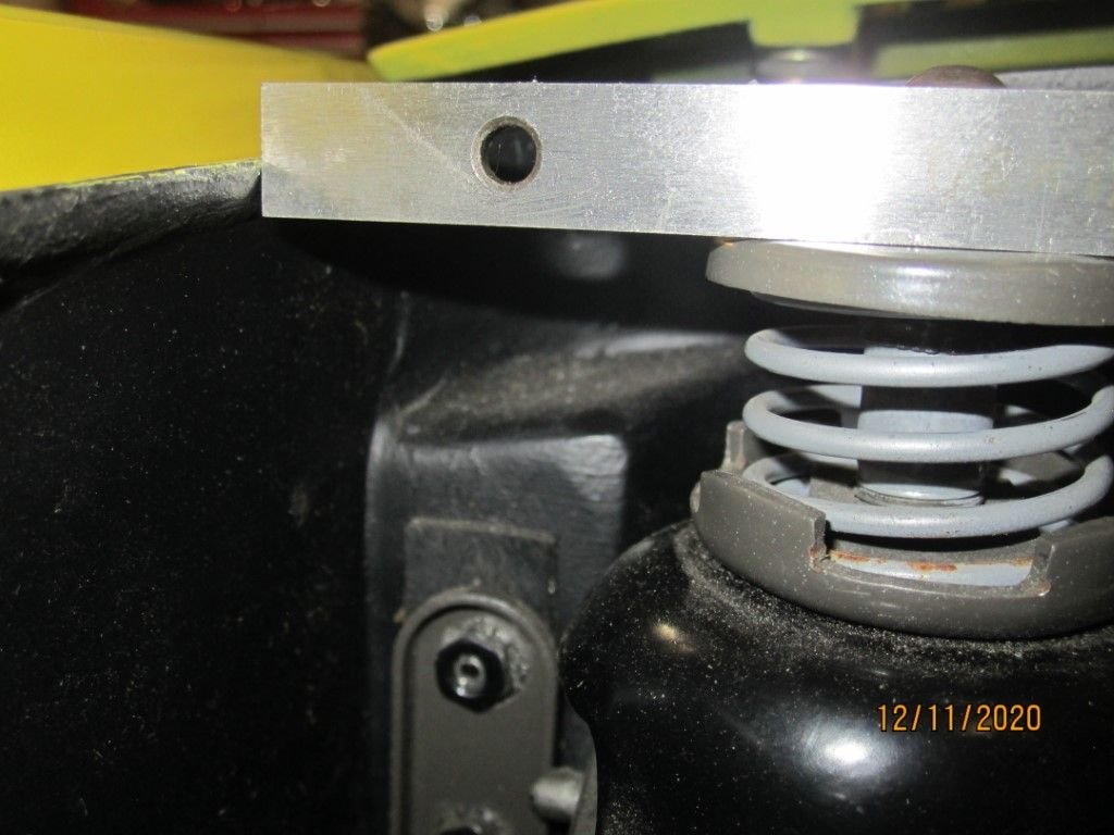

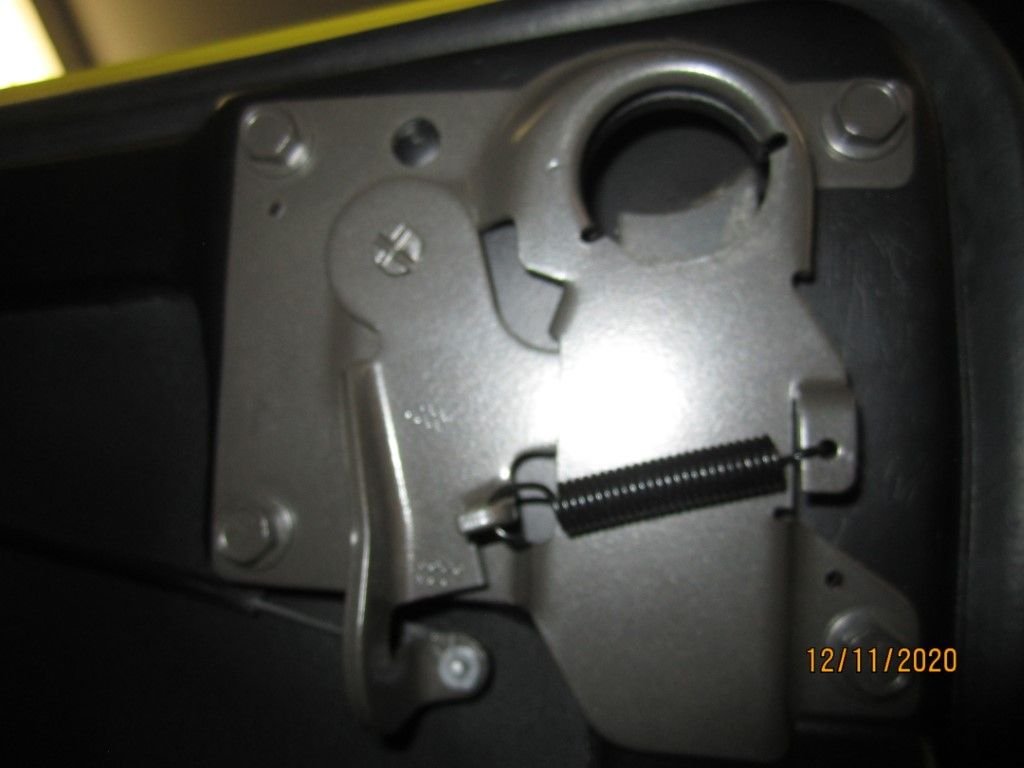

See if any of these help at all, these are all on my 72
Latch looks like this
Top of my spring plate is pretty much level with the underside of the side of the fender lip
Top side of the spring plate is a tiny bit more than 1/2" under the lip where the wall into the wiper trough is
Latch is not quite 5/8" deep to where the ruler hits the fiberglass that is the outer skin
Latch side by the fender is about 1/2"
Hood is notched down where the latch is locate
Not sure if there is anything else I can measure for you but if there is let me know
