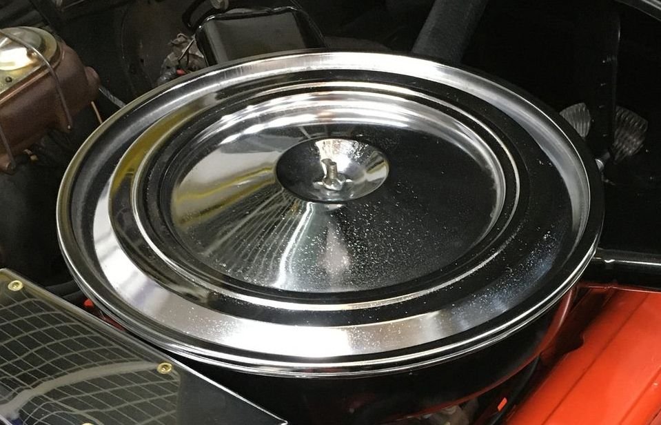

I'm cleaning up my engine compartment a little bit at a time. I need to refinish the air cleaner, so I thought I'd price out having the air cleaner lid re-chromed.
It still shines, but does have some pitting. I received a price of $300 from a shop in LA. They said that it is a hard part to do. Getting at any pitting in the "grooves" is difficult.
They suggested buying a repop, but I'd like to keep the original part on the car. Is this shop's price in line? Is it a major task for a professional to get rid of pitting?
I've no experience with having stuff plated, so any advice is appreciated.

Sounds like the platers were honest with you. Try a couple of other places and compare prices.

Likes: 273
From: Dunedin NZ.
Awkward piece to re-chrome and look good because of the internal curves, all of the pitting has to be polished out or they have to be filled with metal (polishing out the pitting will leave the item thinner too), plating hides nothing. A piece such as a vette rear bumper for example has external curves so a lot easier to polish.
You could ask them to strip the old chrome off and then do all of the initial polishing yourself to cut cost, the plating takes minutes the polishing prep is where all your $$ go.

I would also recommend to leave the original alone and purchase a reproduction cover. If you have not tried this get some 000 steel-wool and lightly go over the original lid it may reduce some of your issues.

I would agree with PJO(sorry)I have cleaned up a lot of chrome that had some damage that looks presentable and saves an original piece all that is required is a lot of elbow grease!! Ike

Thanks for the input folks! I'll give the 000 steel wool a go. The only thing that I've used on it so far is Nevr-Dull. Perhaps I can get it looking a little better.

The huge price is due to EPA regs. Hexavalent chrome is toxic as hell (carcinogen) and will contaminate groundwater in a flash. So they have to take lots of precautions. As far as the chrome process, they usually triple plate show chrome - first a copper layer to fill in the pits, then a nickel layer because chrome doesn't stick to copper, and finally chrome. Size matters somewhat since metals do cost, but the real cost is in the EPA precautions they have to take.

the only problem with 000 steel wool is it creates micro scratches that will make it rust faster ,, 000 steel wool is a easy fix short term but if you keep using it the problem only get worse
You can fix that real easy by putting a rust inhibitor on it - car wax, WD-40, anything like that will work.

great advice..
IMO
i would clean with wax and grease remover
soak in evaporust..couple days at 70f and above temp..
then i would use Flitz paste and hand polish..
this is as good as it gets and make decision from there..
the evaporust removes the corrosion best it can.. the flitz polishes and shines..to fool the eye (distinctness of image).. and protects it..
i would not use steel wool..
i would not re-chrome as it is sheet metal and not easy after stripping etc..and IMO will be probably better than OEM therefore kinda defeating the purpose..
as far as repo.. i would be ok with anything but China.. even Taiwan has decent plating...
