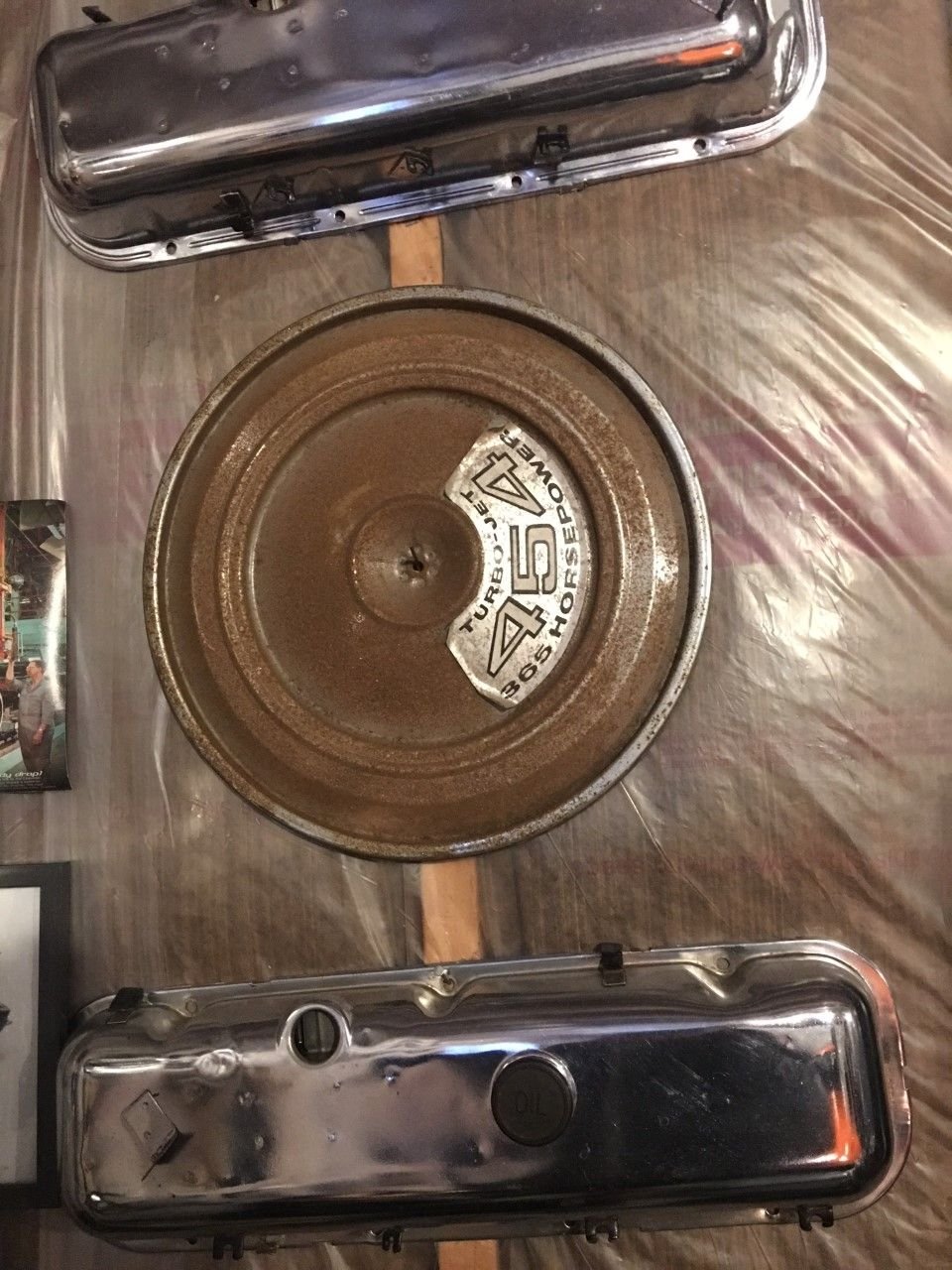

My original lid hangs in my garage along with the original valve covers. Pretty happy with the Paragon repop on the car and enjoy the garage art of the original pieces up on the wall. (The valve covers looked like the air cleaner lid before I used 0000 steel wool on them. They came out pretty good, but definitely left micro scratches, hence my decision to get repops of those as well).
I do agree that if your car is mostly original (and if it is, it's certainly well preserved!), maybe just leave it as is? Or get a repop and just hang onto the original.
