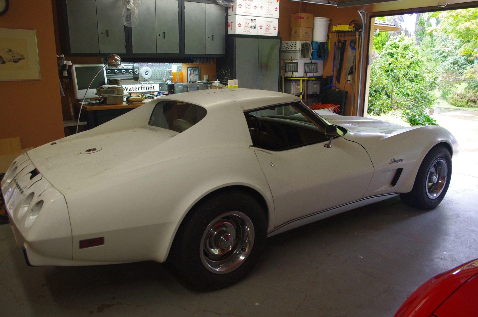

That's not a chance I would take. The pic shown below was taken in 2018; it shows the original rear bumper on my '75 at a point when it was just 3 years older than your '80 is today, Granted, we have a rear vs.front issue here, and Chevy did make better rubber bumpers in '80 than '75, but still, I wouldn't chance it. And just to be clear, these bumpers started cracking long before they became crazy brittle, which they were in this pic. Good luck.
