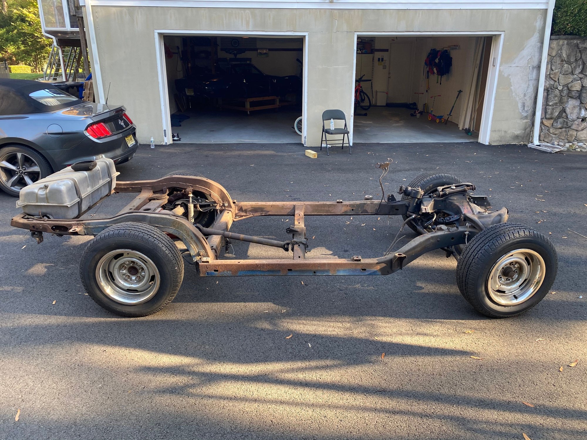

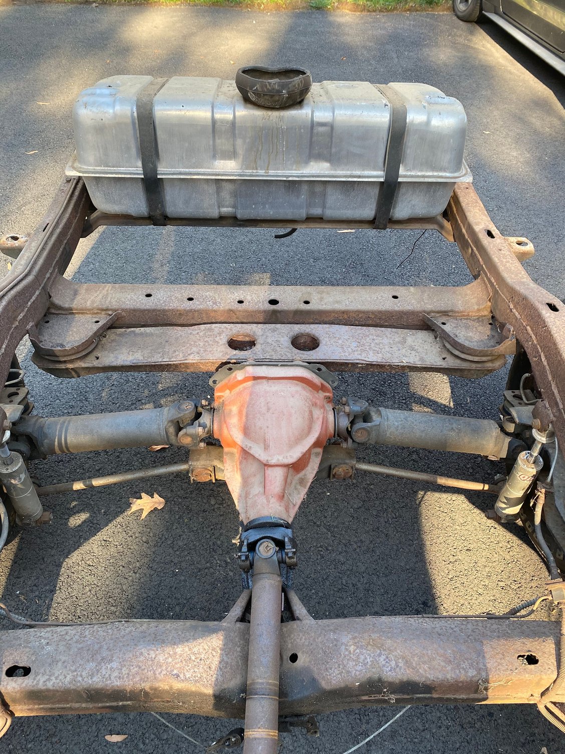

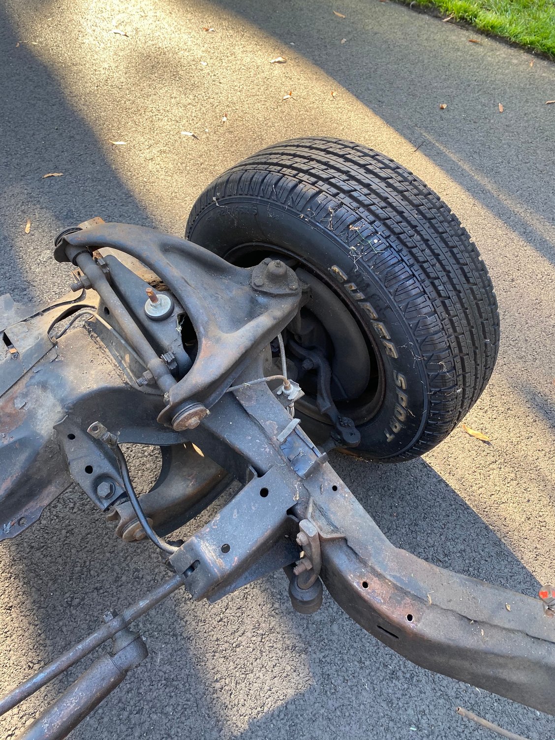

I recently took the body off my 68 convertible. The plan is to send the Chassis out to get restored and freshened up. The car has been off the road for several years now after we spun a bearing drag racing. My son is 15 and has been motivating me to get it up and running. Wonder why? I have been sitting on a new engine for a while, but cant drop it in before i make the car as safe as possible. Many of the bushing and mounts are original and in need of replacement.
I live in central NJ, does anyone have any recomendations for a corvette chassis repair? Anyone care to share what work they had done and cost? I am talking a full on tear it down, clean it up, fix, repair or replace everything on rolling chassis, with perhaps a few small upgrades.

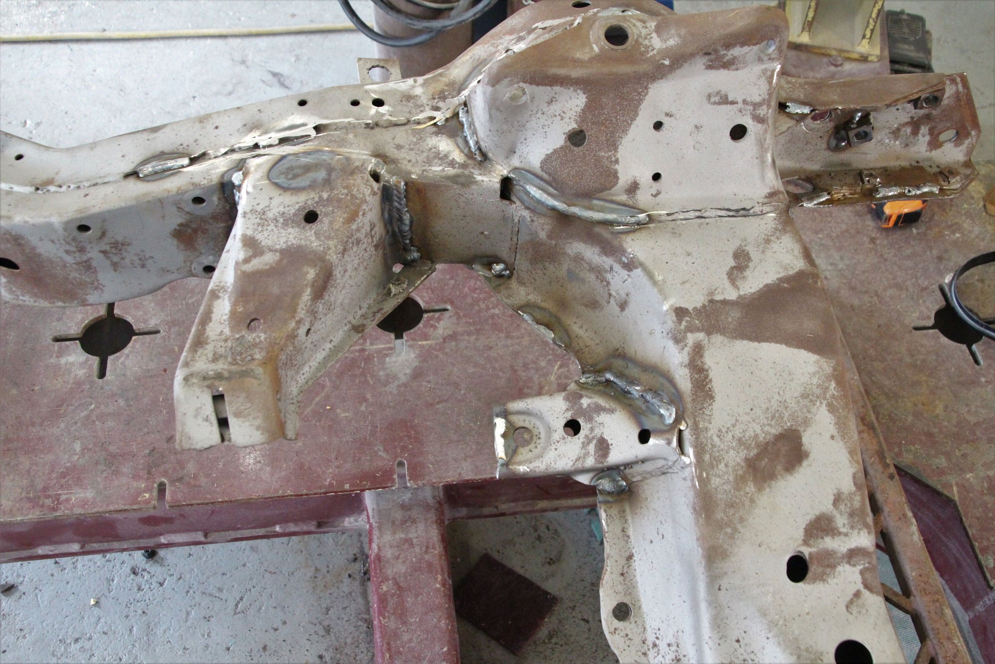

Good collision repair shop did the frame pull and welding. Spent one full day just reinforcing factory welds. Was slightly bent. Also had 5 cracks. Also had it sandblasted and powder coated.

Oh and they did find 4 cracked welds so a close inspection should be mandantory for all of these after rust removal

It looks like it is in great condition. Those eight body mounts look good, no need to replace good mounting points. Welds should be inspected and reinforced, especially because your car does not have the kick up reinforcements that were added in late 68 onward. This is the vulnerable area on the 68 in my opinion, so a close inspection in this area would be advisable. Nice rolling chassis which should be a dream to work with for any shop that has the time and space.

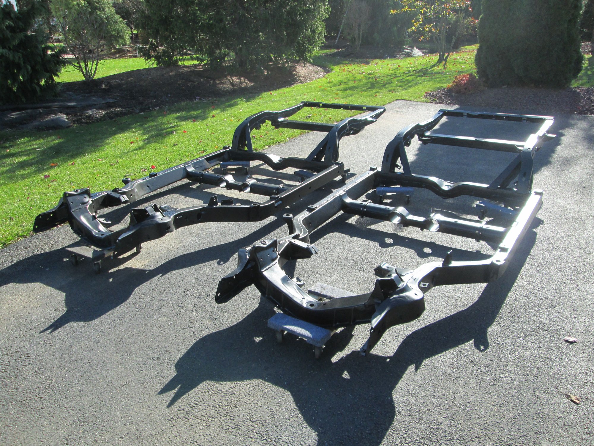

Left is a 1969-73 frame which will be servicing a 1972 coupe. This is a manual frame with the removable center section transmission cross member modification.
Right is a 1969-1973 frame modified from a 1975 to demonstrate that it can be done. This is also a manual frame made from an automatic frame and then modified to add the removable center section transmission cross member modification. Featured on Facebook C-3 Corvette Frame and Chassis Group.
Both were fun projects.
David

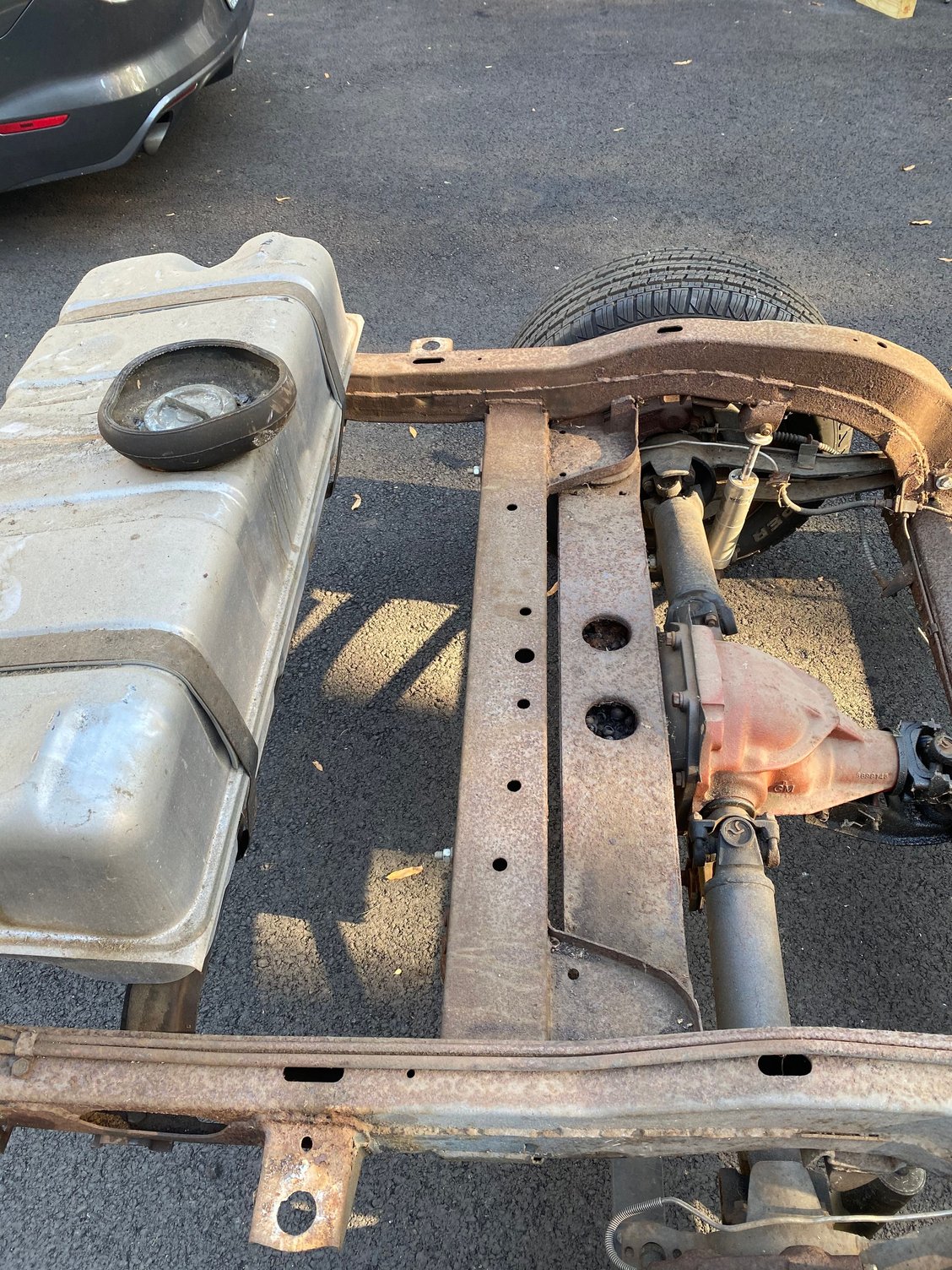

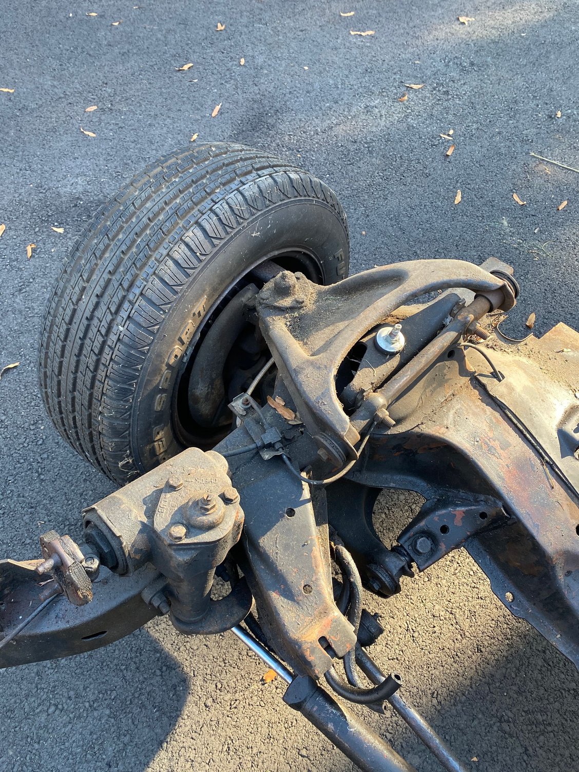

I was pleased that it didnt look too bad when the body came off. everything i was able to see before body off looked ok so i wasnt overly worried, but you never can tell. I figured the front of the frame got covered with so much oil, probably helped keep it from rusting up there.
yes, pretty much replace or refurbish everything you mentioned. Trailing arms were replaced maybe 15 years ago with offset ones. Gas tank is rotten, car did spend some time outside, replace fuel and brake lines. Would want new rotors, and calipers, if budget allows would upgrade.

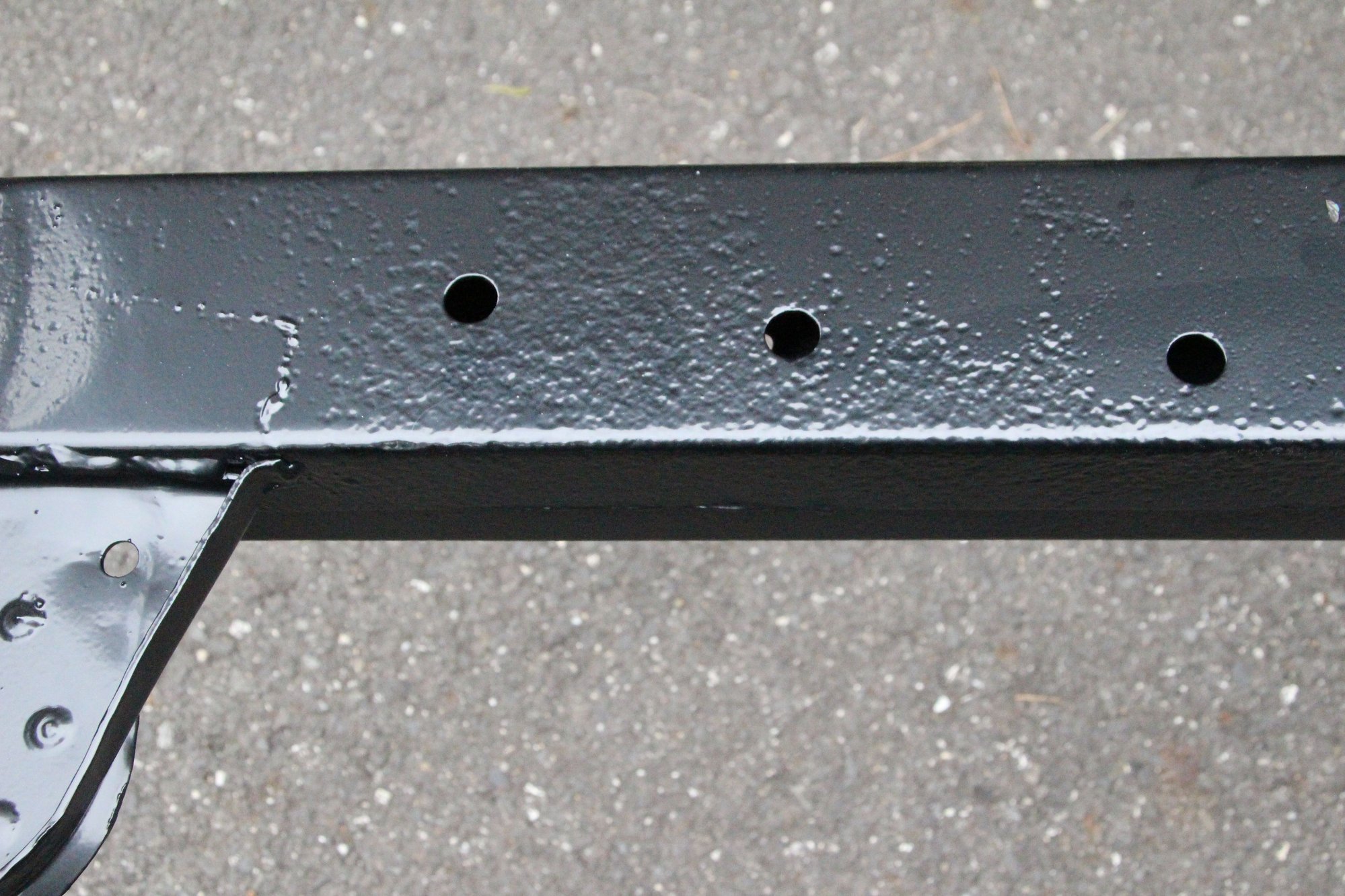

I went with Powder, it is slick and shiney, but being black it shows all the pitting in a frame like yours and mine.

Here's what I mean about the pitting being visible afterward.
