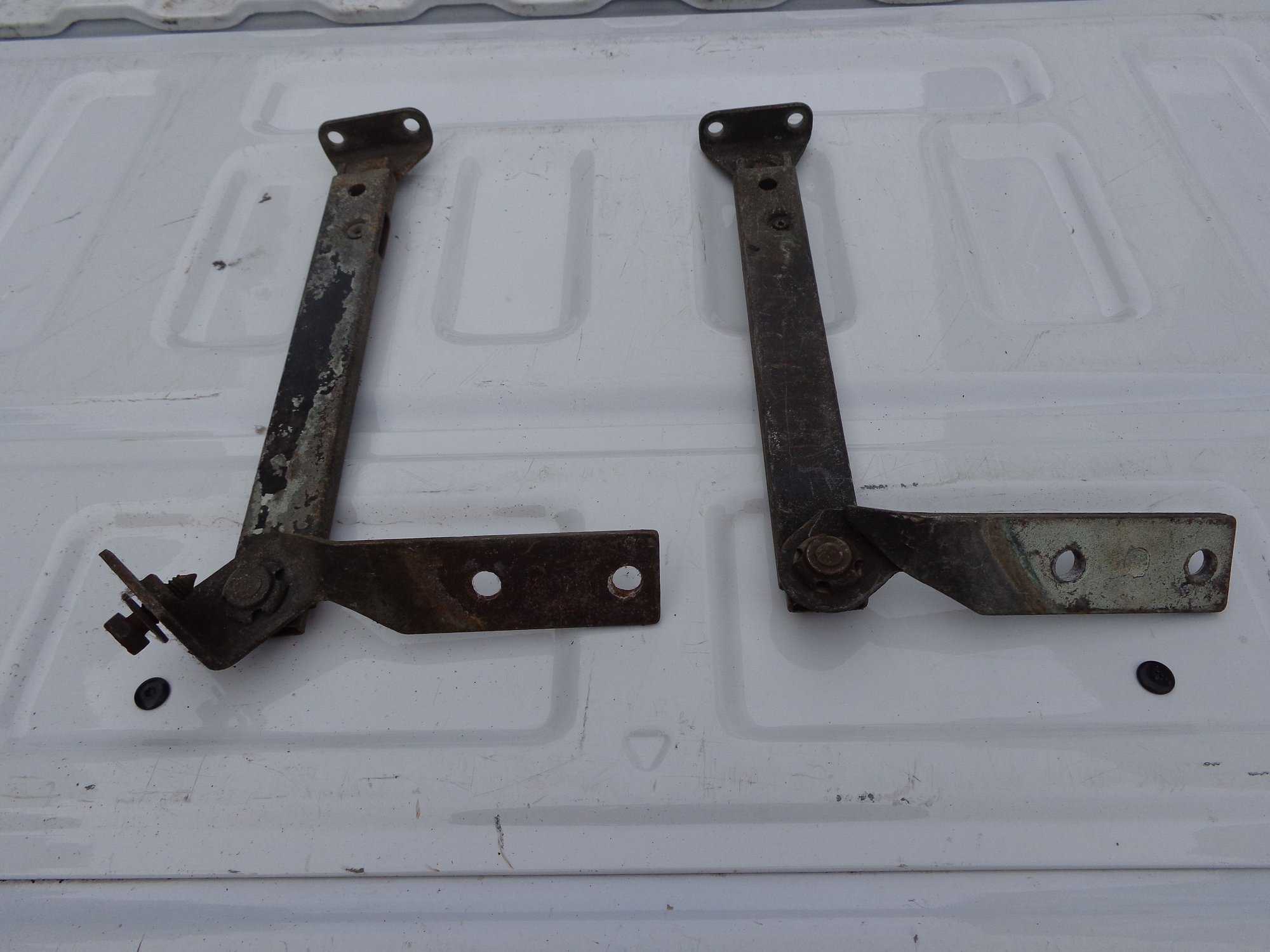

The one on the right is 1968

I just found 1 that is almost identical to mine only difference is the bottom piece on mine only has the slot hole and not the second hole it is in articles for sale by grantstigers under 72 hood support thanks Phil
