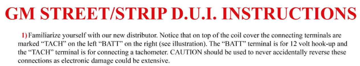

I am fixing to order a DUI w/ cross fire cap, so I have been reading reviews. One guy on another board says the DUI HEI does not have a tach connection? I assume he is FOS. Can you guys confirm?
For me, this will be going in a '79 Camaro with a factory tach (not mechanical).

I can't imagine it not having the electronic tach output but DUI would be the ones to confirm it with. The other thing I believe is that if you buy it from them they will curve it based on what you tell them the motor is but if you buy from summit/jegs/etc you get the "one size fits all curve" not sure if that matters to you or not

FOS.....and think about it, WYF would one do if it didn't? Crank trigger sensor? Nobody would buy the damn things without a tach output......
