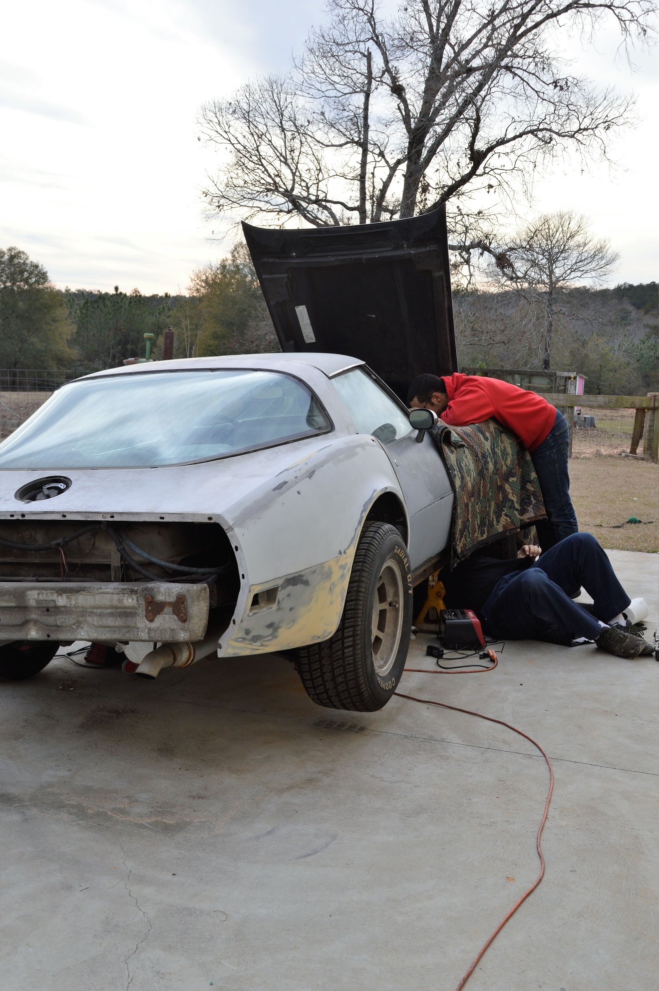

I just installed a new high torque mini starter on my 81 project Vette. The install was easy and made a huge difference. Before I could barely get her to turn over. Now she turns over and starts like a normal car. It was also nice to have help from my daughters boyfriend and be able to teach a younger generation how to work on cars.

Yes all connections where clean and I had already installed a remote starter solenoid. The old starter would also heat soak and not turn over at all after driving for a while.
Now if I could just get back into the bodywork and get her back on the road.
