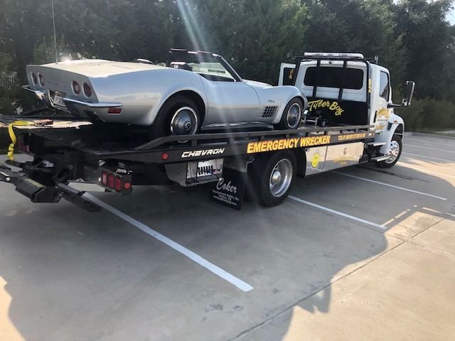

Unfortunately this was me a few months back. Would go with nothing but the flatbed and the driver/operator handled things perfectly.
