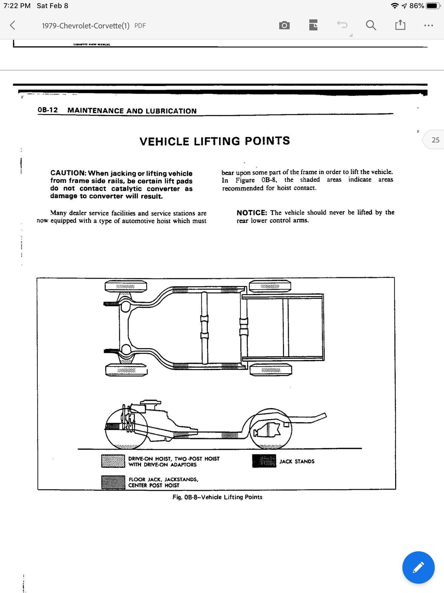

If the frame is solid and the body mounts are in good shape, nothing really moves.......my 72' doesn't move around at all, no matter how I jack it up.
I have a bit of a pickle on my car as it has a front monoleaf.......jacking it up via the front crossmember is not an option........I jack it up behind the wheel but do not like how far back those lift points are so after it is lifted, I put two tall *** HD jackstands under the front sway bar links......this is a great place to set them, and they are out of the way of suspension and the engine area underneath. This is the same area that shows above in the manual up front. The lift points in the rear leave a LOT of weight to hang out front of the jackstand......I had a 76' here a few years back that you could physically see the front end droop.....didn't attempt to open the doors LOL!
Jebby
