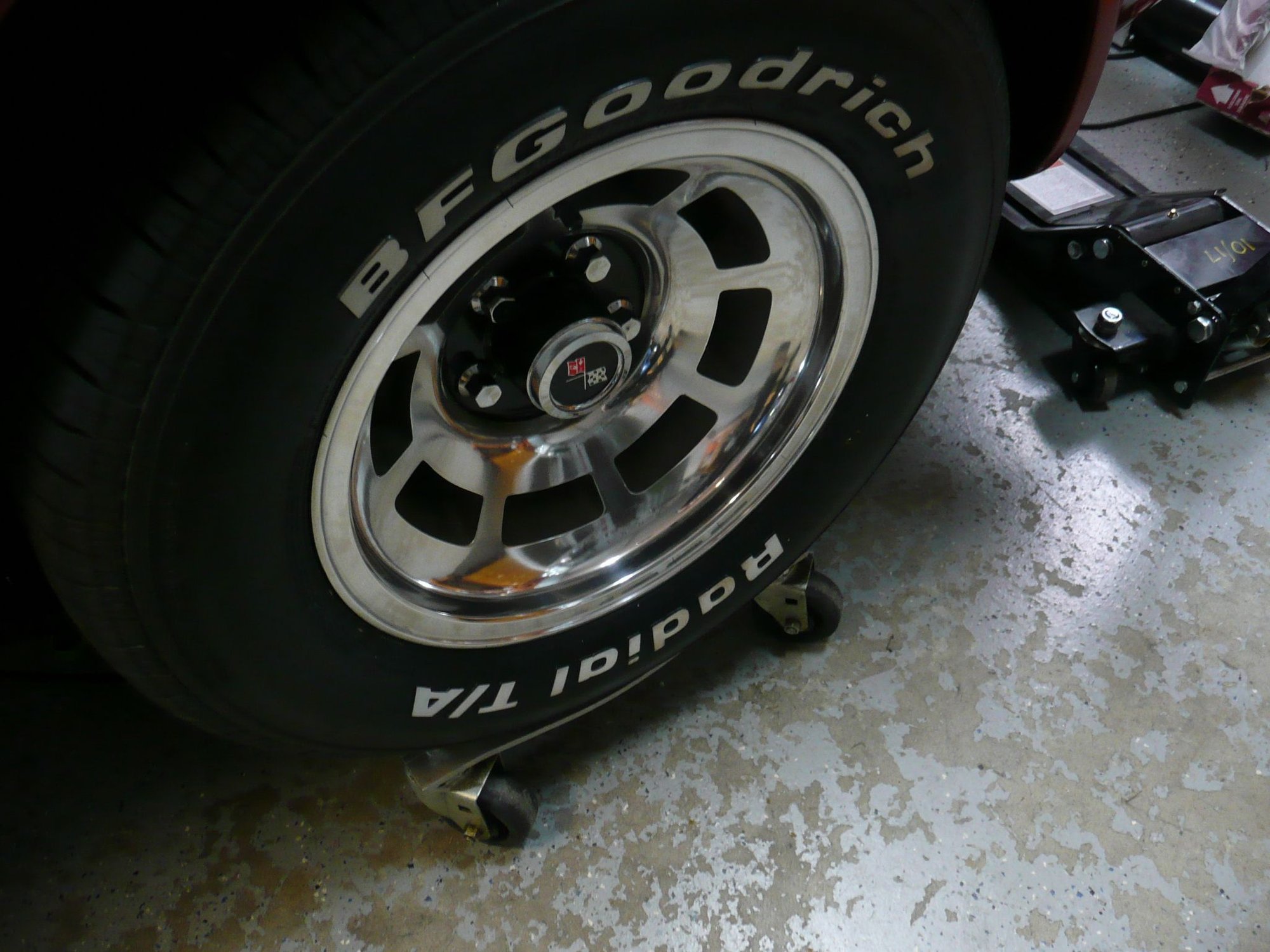

OCD level - clean as above. Assess pits, scratches, gouges, etc. Carefully file down with jewelers files. Sand out wet with progressively finer grits, ending up with 2500 grit. I typically have used 400, 600, 1000, 1500, 2000 then 2500. Polish with Simichrome and wax.
My nearly 50 year old American 200s wheels have a semi-smooth machined surface so never will look like a mirror but these have been restored using the basic process I outlined above.

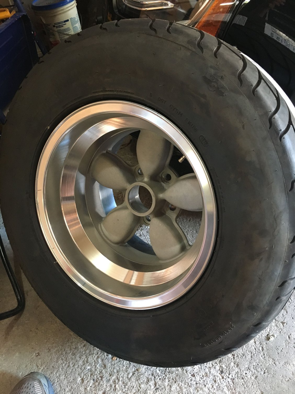

Here's mine after hours and hours of sandpaper, buffing and polishing. Had to start with 400 grit the machining was so poor.
