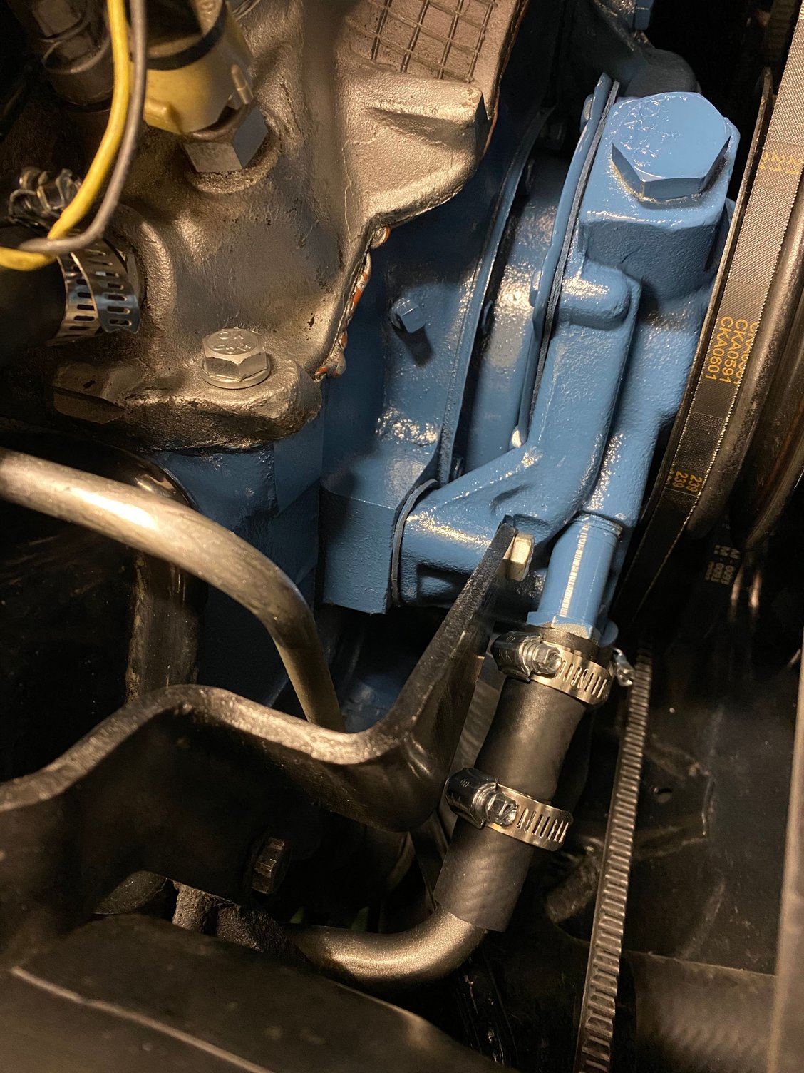

Is this where the numbers are? I repainted the front of the engine and think I covered it up! Lol
Old Jan 27, 2021 | 01:01 PM
KingRat's Avatar
KingRat
Joined: Jan 2002
Posts: 2,076
Likes: 1,192
Yes. That is it. If you decide to remove the paint... you might consider paint thinner and NOT an abrasive. You do not want to scratch up the pad if you care about numbers.

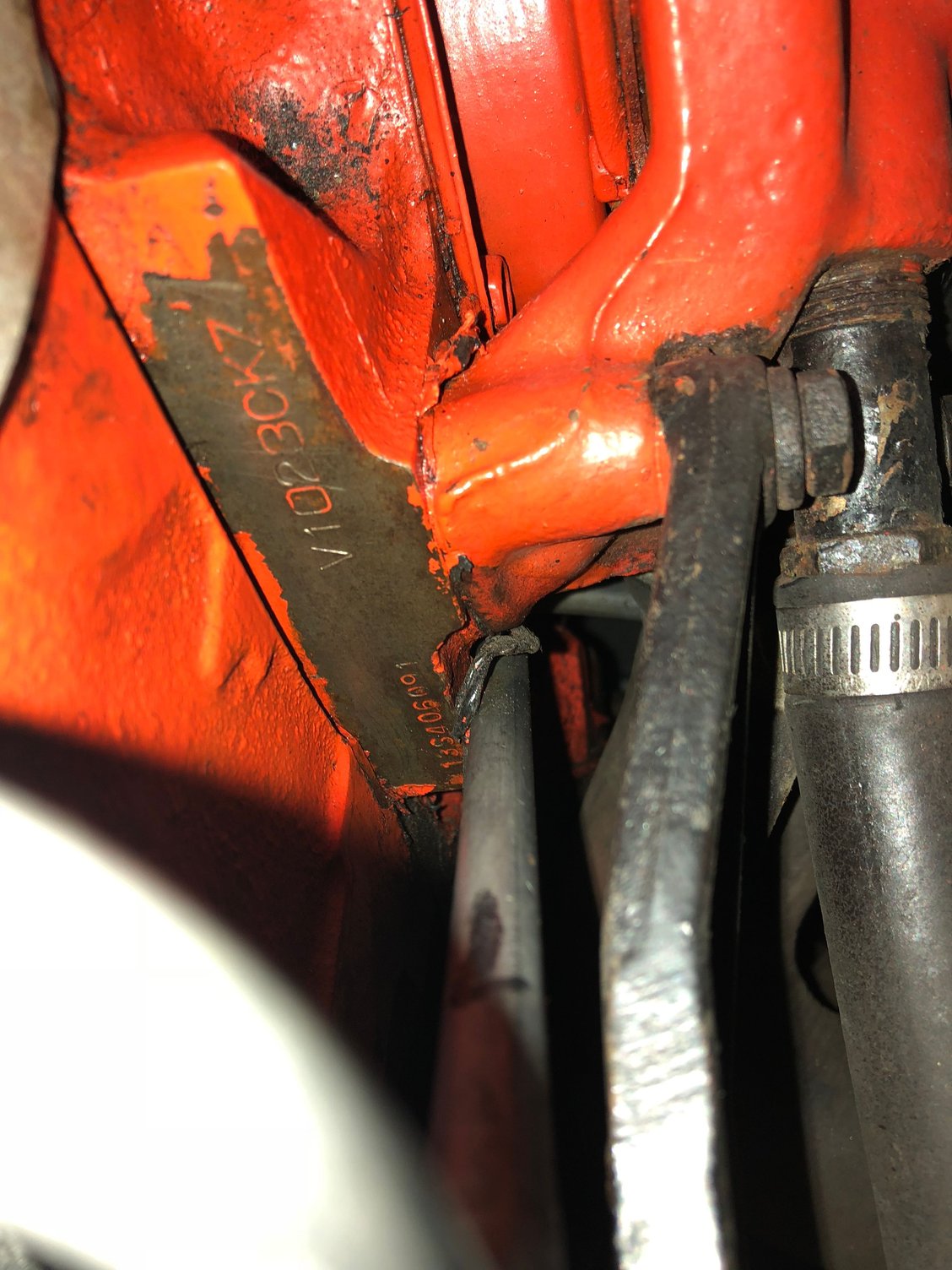

Here are the numbers on my small block.

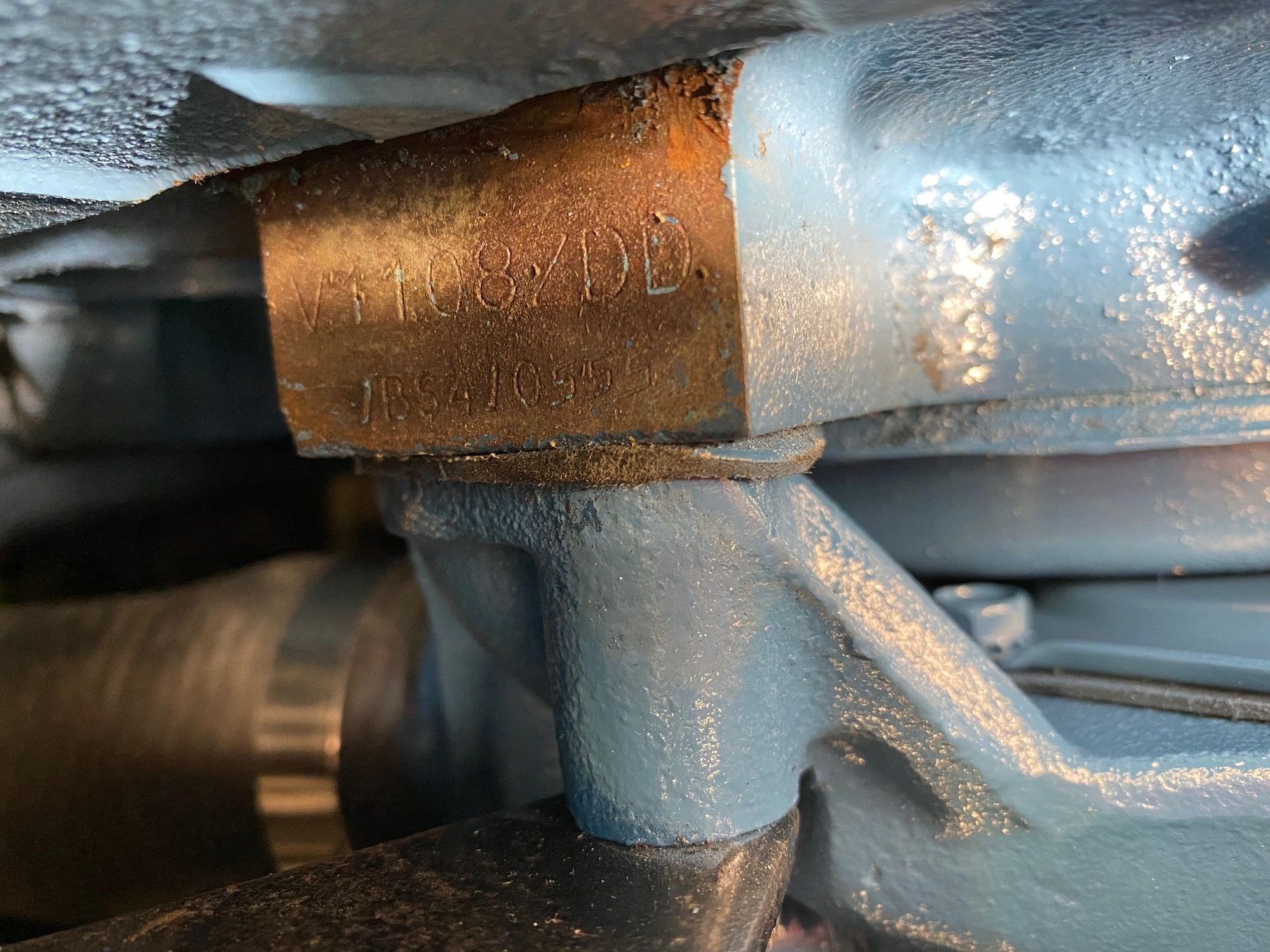

avalonjohn, yes its my 81. Going to my garage today to remove the paint there and see what the numbers are. Thanks to all

paint thinnner did the trick, top letters V1108 then maybe ZDD? Bottom number 1BS410555 which matches the last numbers on my vin. I found on the forum information on the top, V = flint, 11 = month, 8 = day...don't know what the last ZDD stands for though?
Old Jan 28, 2021 | 02:43 PM
gbvette62's Avatar
gbvette62
Joined: Oct 2000
Posts: 12,687
Likes: 3,139
From: Shamong, NJ
"ZDD" is the suffix code for a 1981 Corvette 350, 190 hp, with Federal emission equipment and a TurboHydro automatic trans. A Federal emission 4 speed would be "ZDA", a California emission automatic "ZDB", and a California 4 speed "ZDC".
Flint November 8th is correct, and is the date the engine was assembled in Flint MI.
Your VIN decodes as follows:
1 = Chevrolet
B = 1981
S = St Louis assembly plant
4 = Is a control number found in all 81 St. Louis built Corvettes. That number is a "1" on Bowling Green cars.
10555 = is the build number, or the 10,555th 1981 Corvette built in St Louis in 81. The C3 Birthday Calculator estimates that 10555 was built around November 15, 1980.
