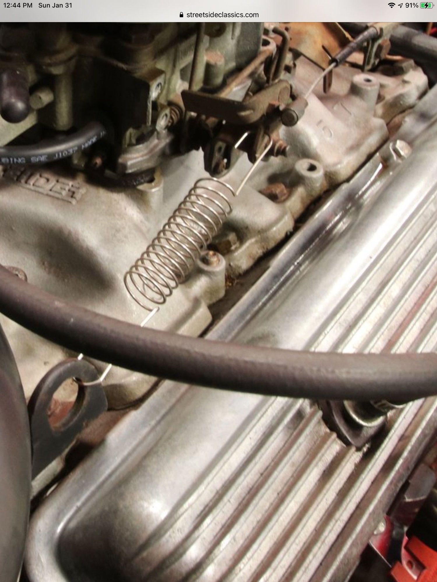

Click on the pictures and note the position of the left front wheel vs the right front wheel in their respective wheel wells. I didn't even look at the remaining pictures. I would imagine most others wouldn't either. Looks like whoever gets this one will become another disgruntled Corvette owner.

Is this right on the spring?
