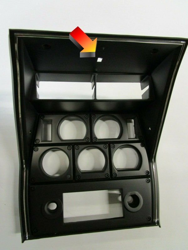

Check the ground wire for the light on the gauge cluster right at the top/center.
