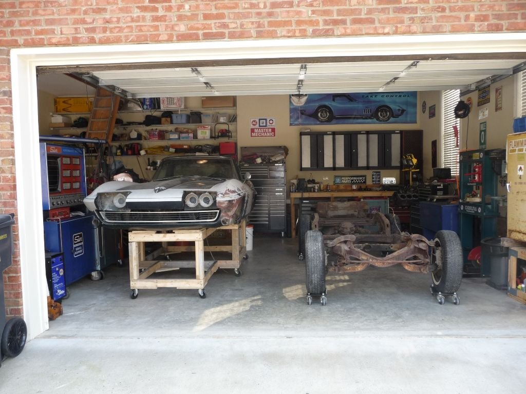

Twinpack if I still had my last oversize 3 car garage or your garage this engine would be on the stand. I now have a small 3 car garage and the vette is in the single side. I let go a 30 year collection of big garage stuff when I move but kept all my tools.

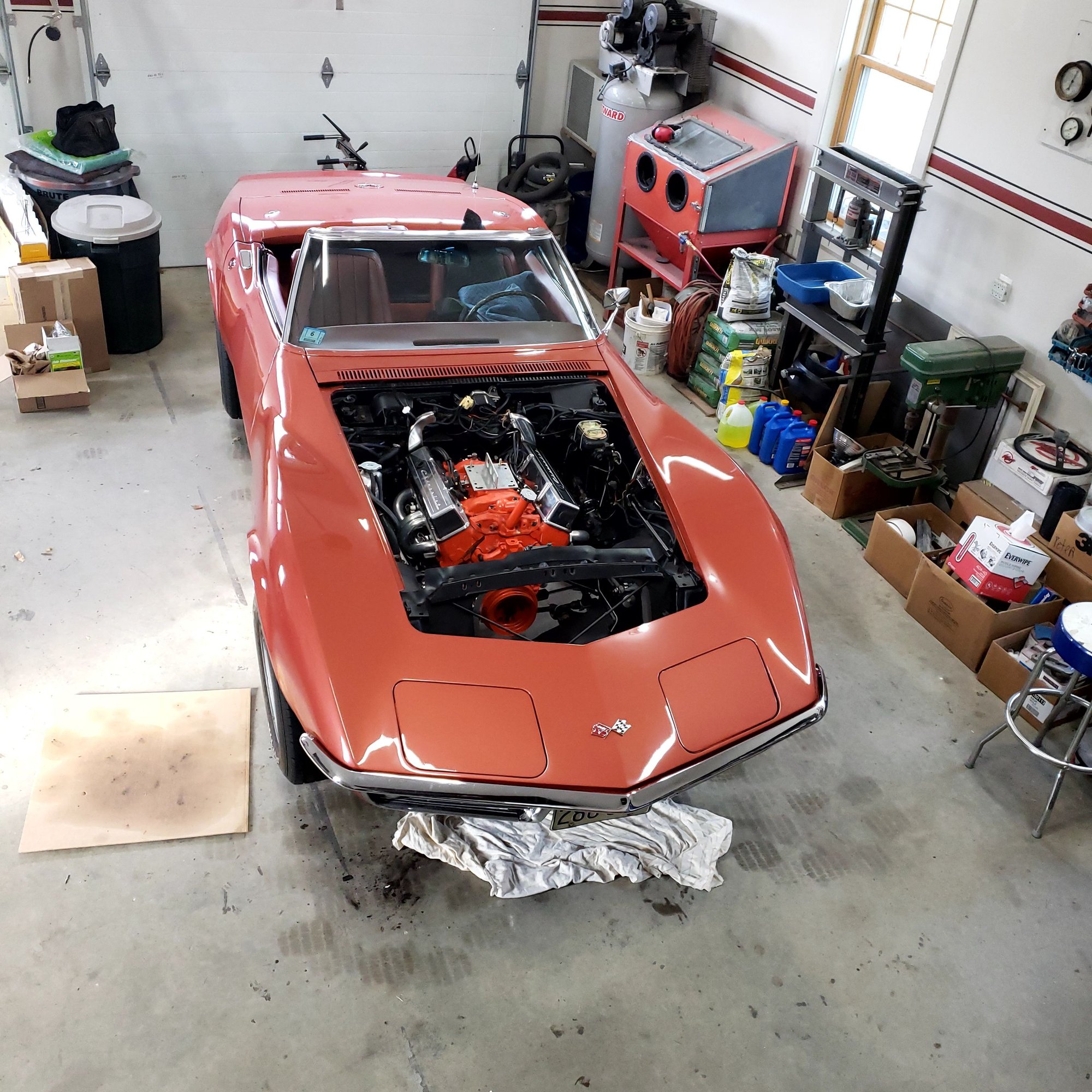

i pulled the engine out of the 71 last winter almost by myself. not a terrible job. biggest pia was the rad and fan shroud by myself. took the hood off first then waterpump and fuel pump. removed and tied off power steering and ac compressor and hoses. left bellhousing and 4 speed bolted to motor and lifted out as one unit. took top 2 bolts out of rad support and loosened the bottom ones and pushed it front with condensor still attatched. gave me enough room to lift out radiator and shroud. did this while the car was on a 4 post lift so it was pretty easy to disconnect everything underneath first.
