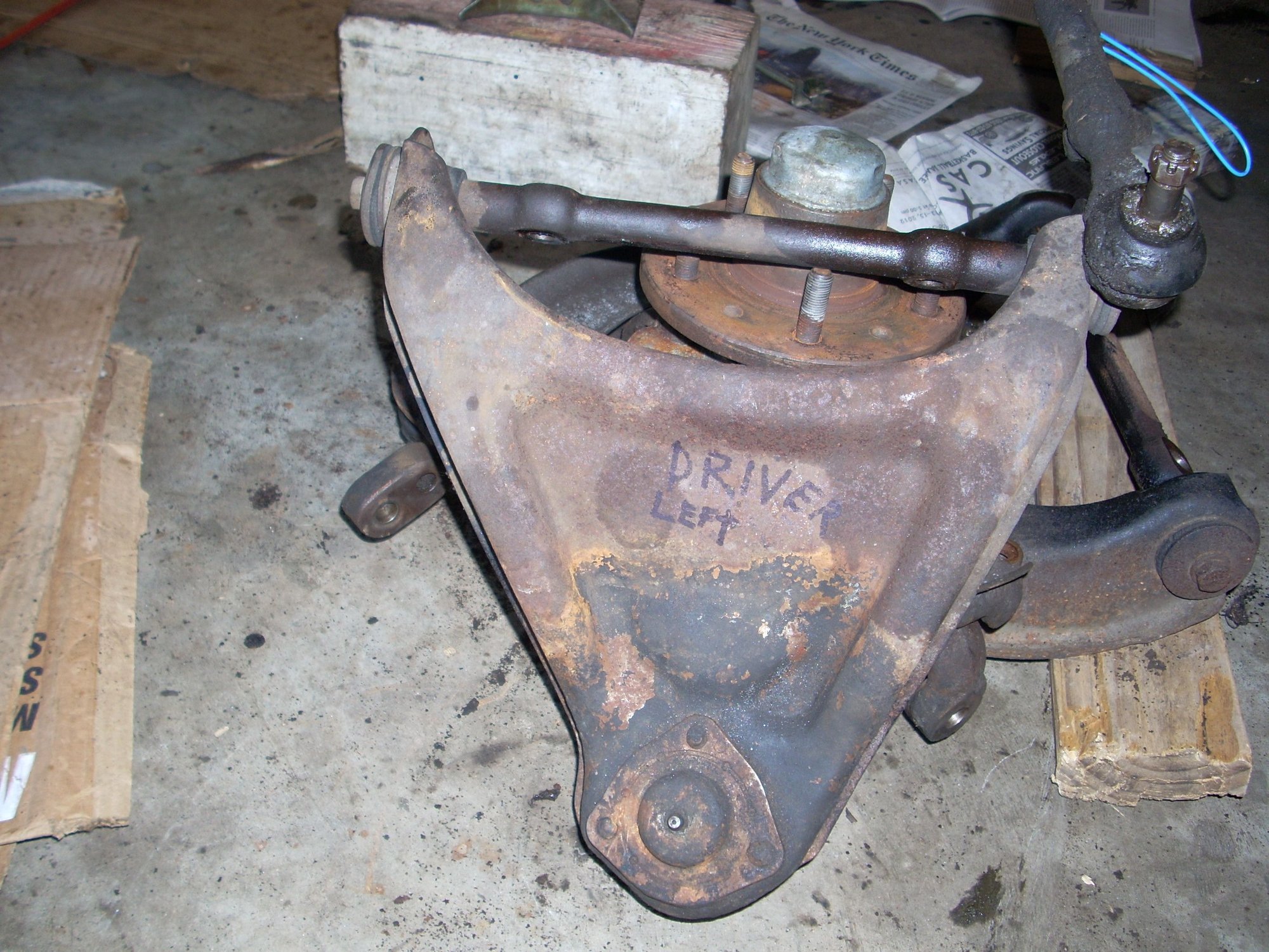

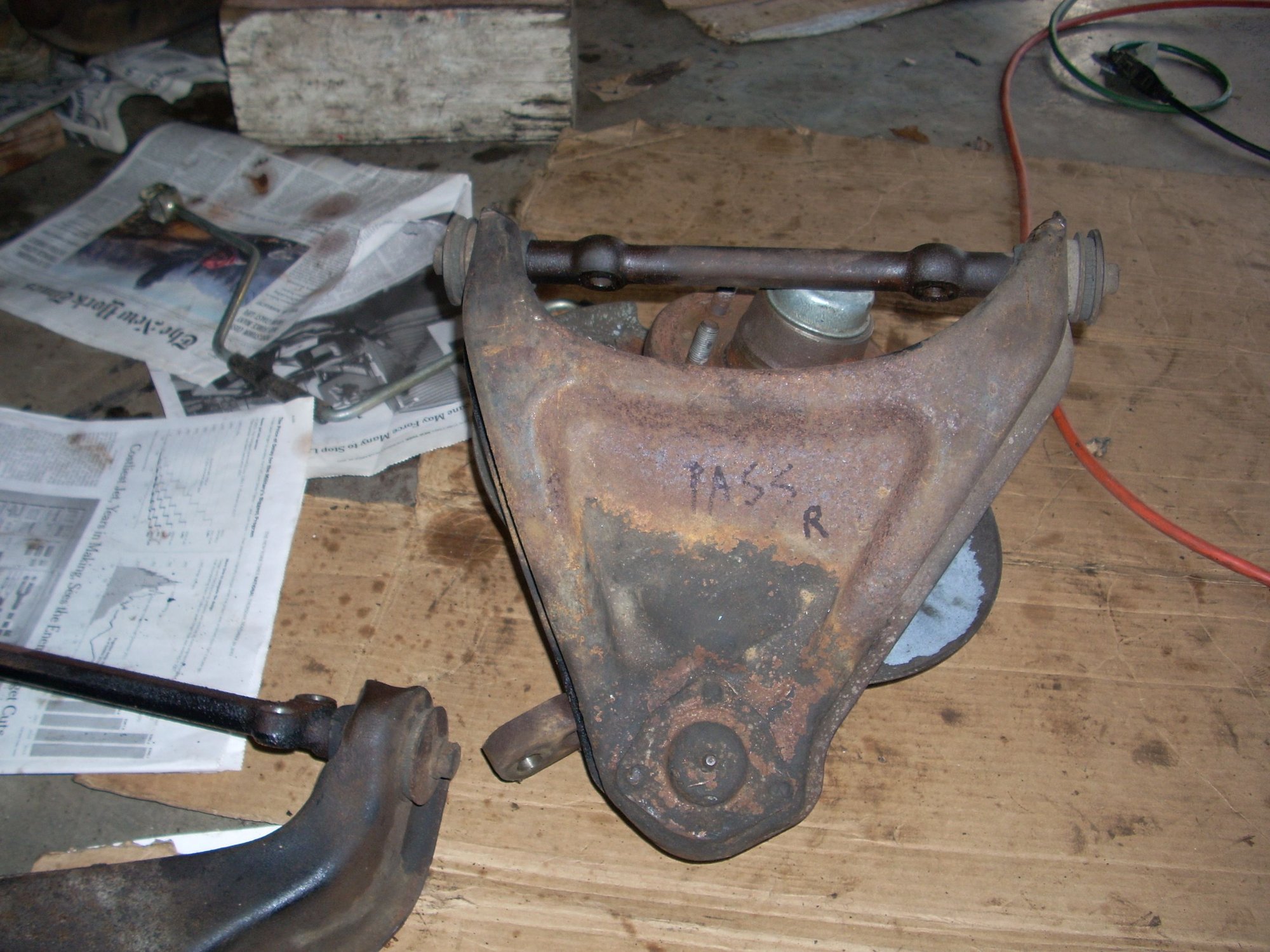

Pretty easy for me to get mixed up. So, saved these photos:
