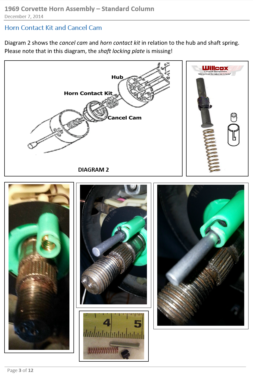

1981 w/tilt column........I need a exploded view detail of the horn contact Pin. When I took it apart the spring flew out and I have no idea which goes on in which order. Metal pin, spring, plastic bushing. A detailed view of just that assembly would help. A detail of the horn assembly doesn't zero in enough to see pin detail.

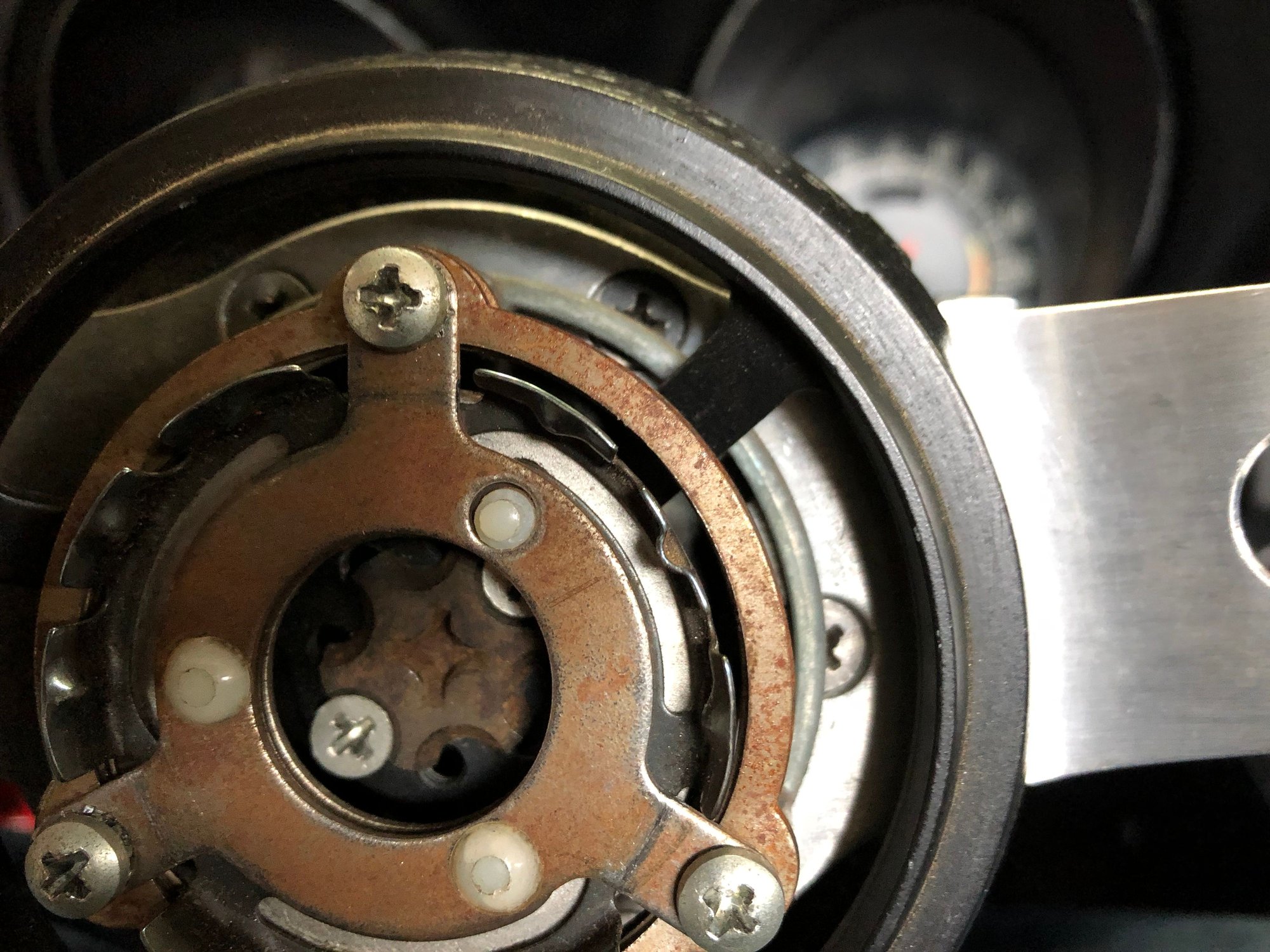

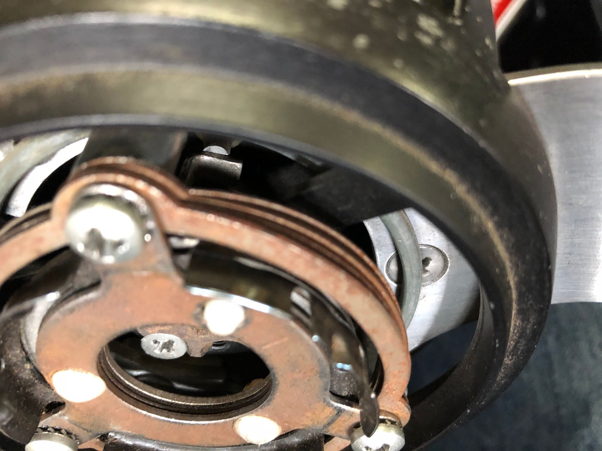

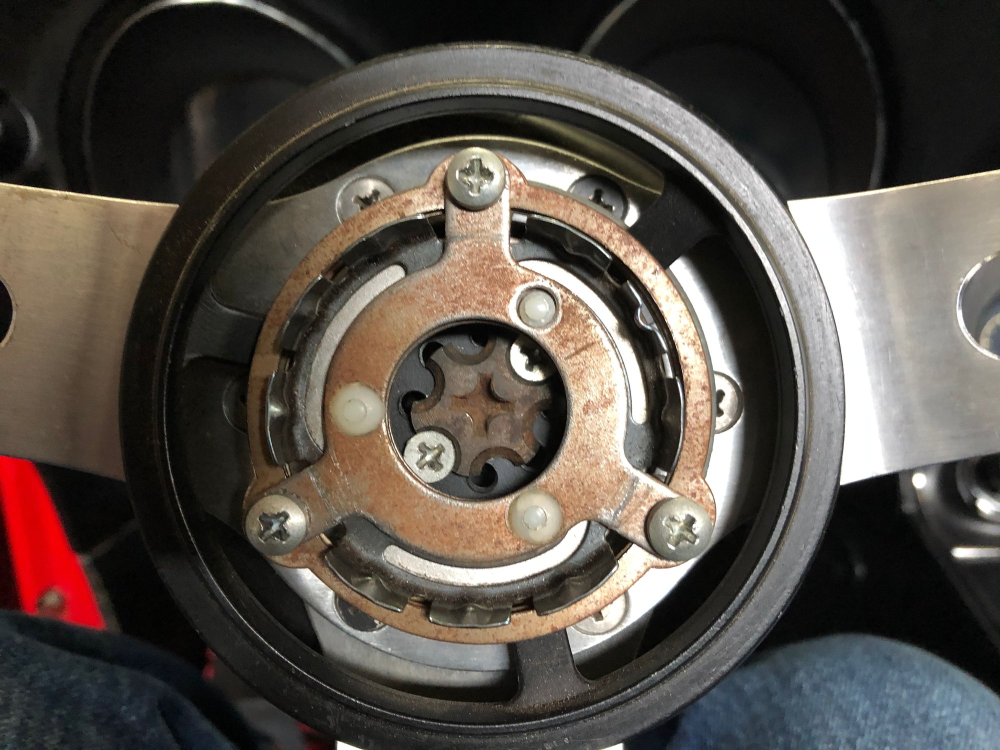

Here are pictures of the parts on my 73 T/T. Not sure if they are the same as yours.

Not sure if this from my 69 will help but can't hurt At a minimum it may get someone else to respond.

Thanks CYa......That's exactly what I was looking for.
