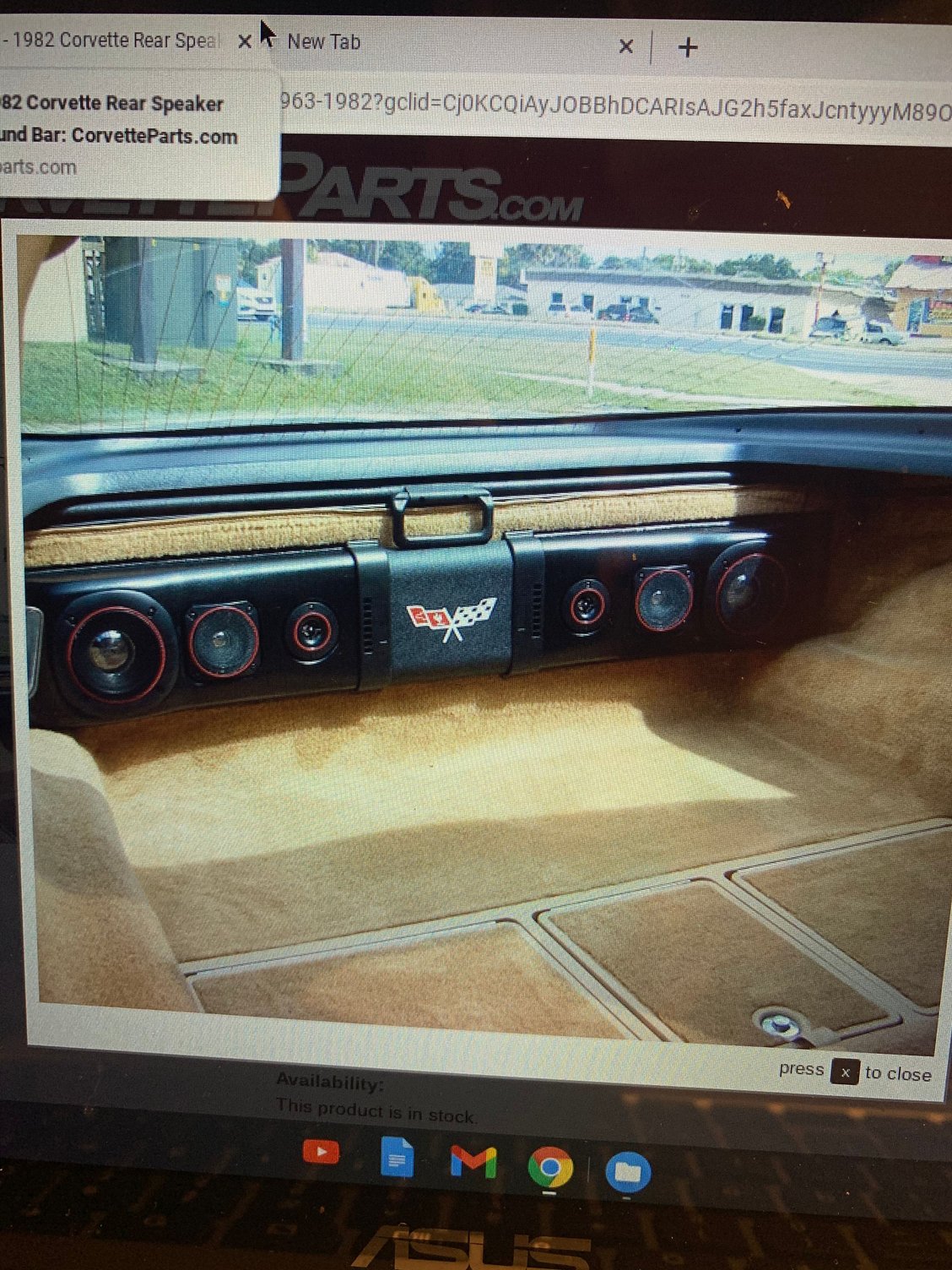

I dont have a problem putting them into the kickplate, I would cut out plate and mount cover onto plate. I would prefer round speakers though. I believe a 6.5" would fit. I was also thinking of getting rid of the rear speakers and installing this bar. Clean look. If i were to install the 2 front and the speaker bar, would i still need the amplifier?

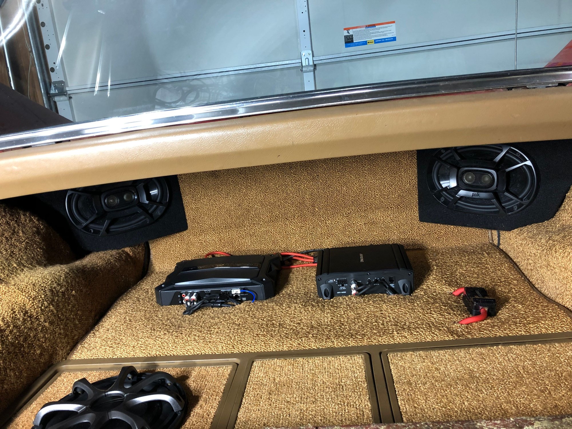

I went with two 5 1/4" in the kickpanels. That is all I could fit behind the panel and still get it in place.
Then I had 2 6x9s in the back and an 8" sub.
The speaker amp is 100 watts x 4 and my sub amp is 250 watts. It sounds amazing in my garage! But with a 68 Big Block and the tops off, no matter what, it is a little quiet.
I'm still glad I did it though. Kenwood single DIN head unit (receiver - no CD to keep the size down).
